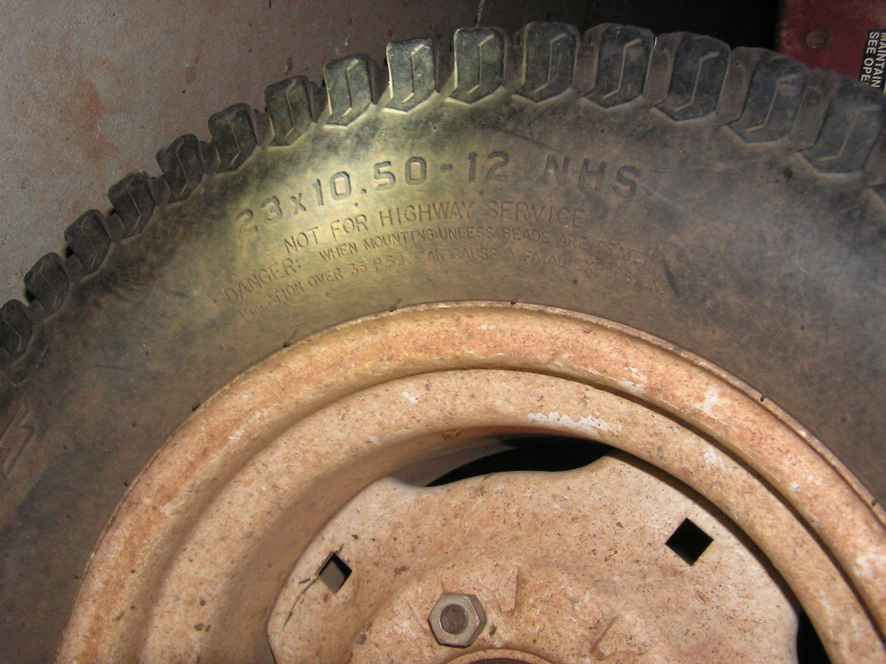

Has anybody installed wider wheels and tires on them? Our old John Deere 400 had much wider tires which cut down on tracks in the soft yard. Those were 26 x 12.00 x 12
What do oir Toros have? Would something like that fit?
Are there rims available?
Drawbacks?

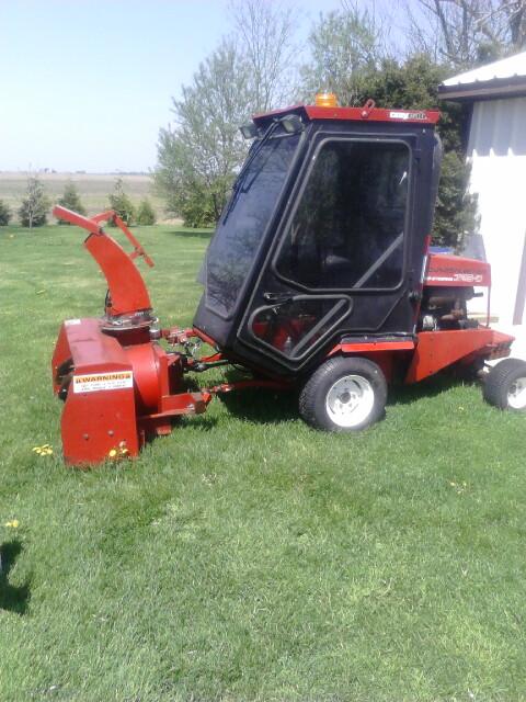

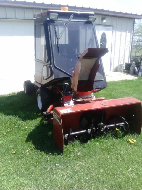

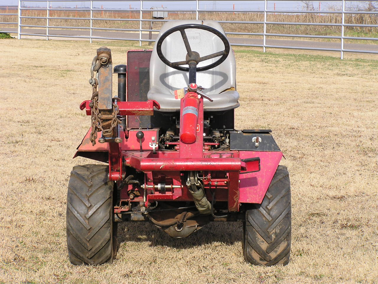

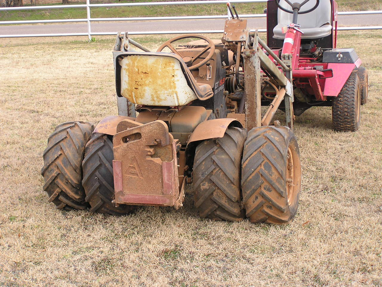

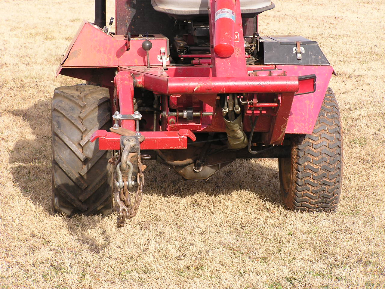

Yep, I put wider wheels and tires on the 322D before I put the loader on. they came off of an old Craftsman garden tractor:
You could also try duals when using a snow blower:
View attachment 737970View attachment 737971
You could also try duals:

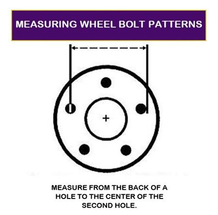

Do you know the lug pattern for front wheels on a Toro Groundsmaster 223D or 325D?
Is it 5 on 4.5?
What about offset? Is it a maximum 5" offset?
I have 23 x 8.50 x 12
The John Deere was 26 x 12 x 12
Is there a wheel tire combo that would be about the same height or shorter than stock but as wide or wider than the 26 x 12 x 12?
Is it 5 on 4.5?
For 5 lug measure this way to get the bolt circle diameter:
Don't know, whatever I used never rubbed the frame.
Probably. Look at trencher tires and zero turn tires.
23x10.50x12 is the widest that I used:
