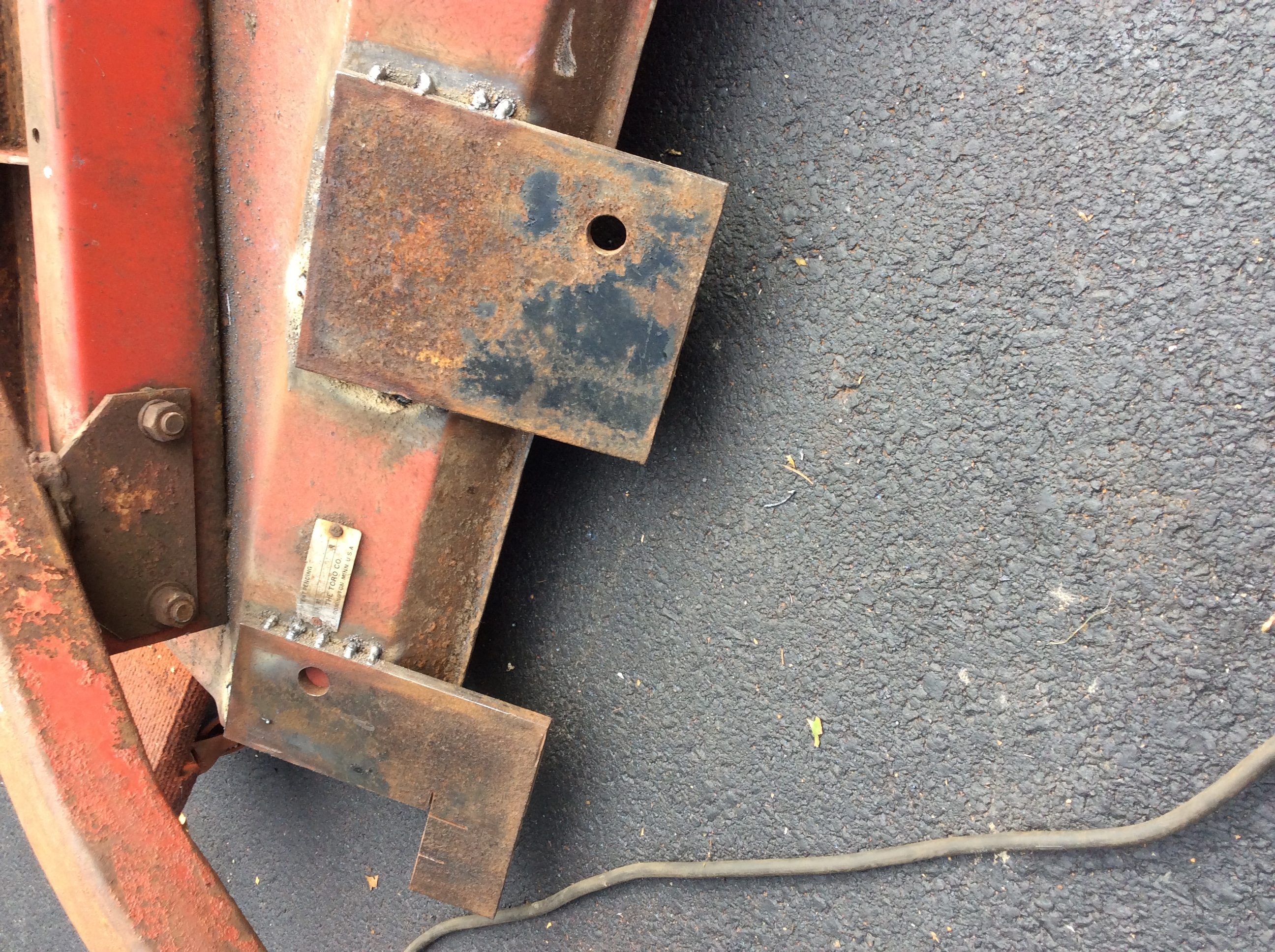

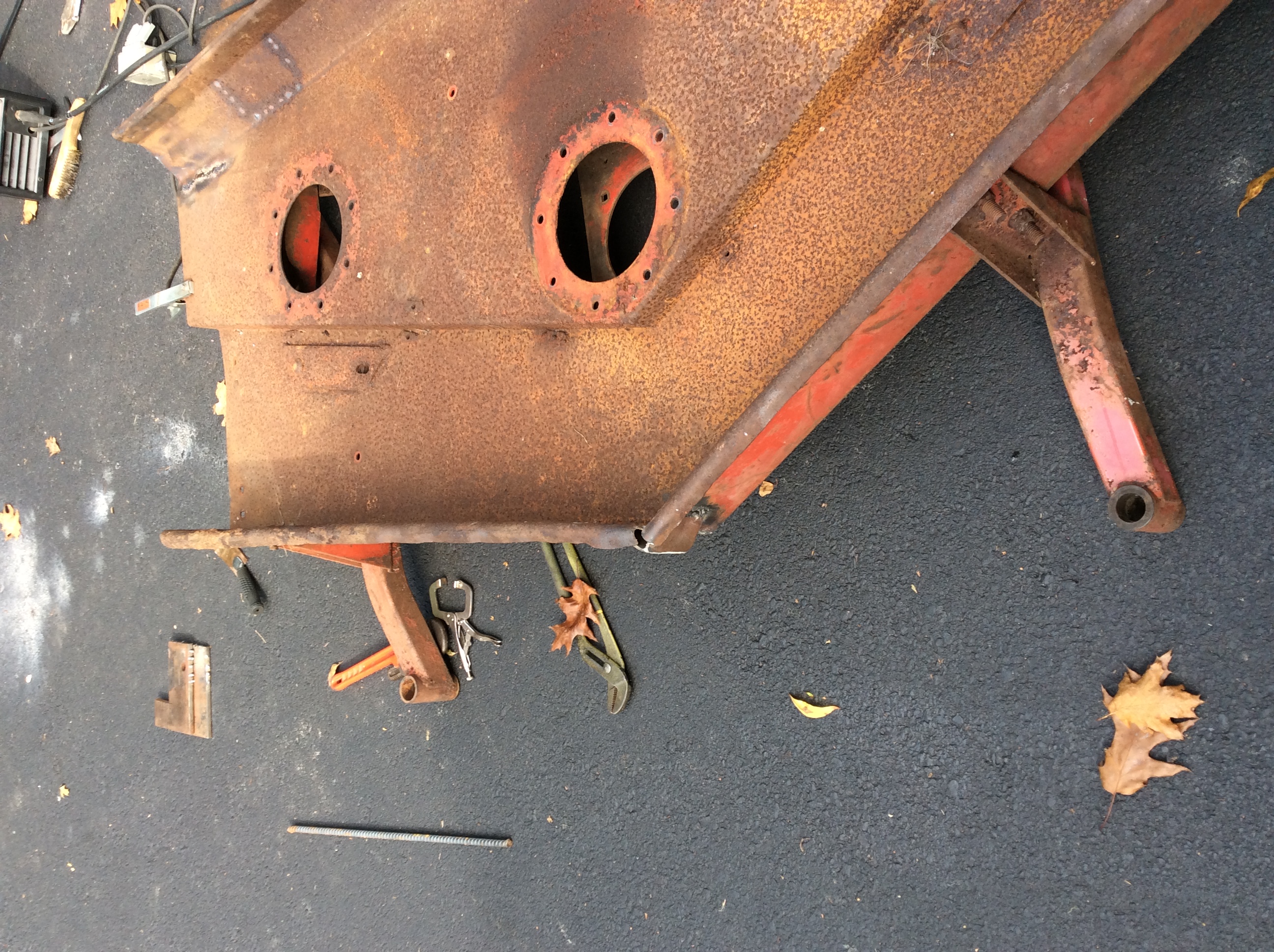

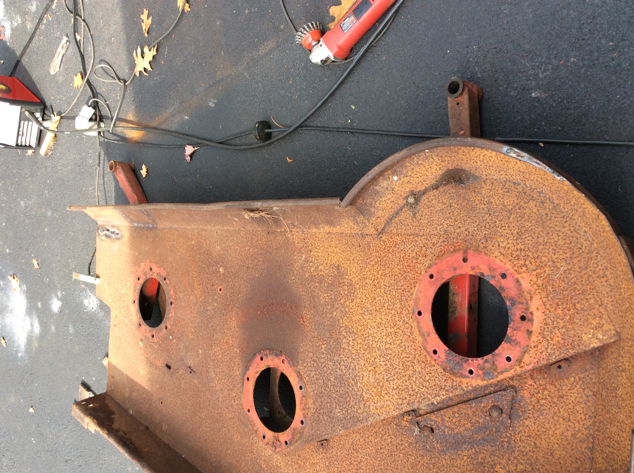

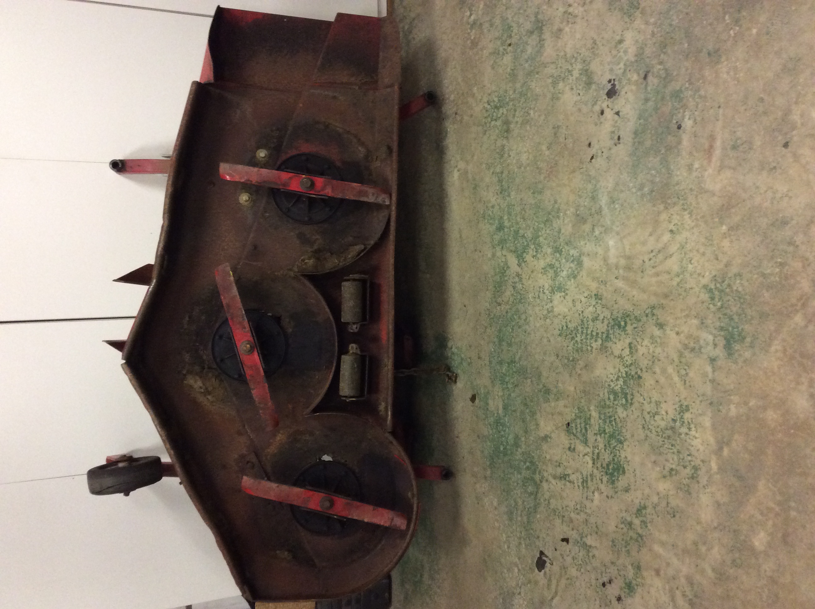

Howdy, has anyone tried to use a deck from a manufacturer other than Toro on their groundsmaster? Mine didn’t come with one and there is a front mower ford cm274 for sale locally cheap. It’s non running but does have a deck, brush, and snowblower. I’m in Kansas and I rarely see anyone selling just a deck in my vicinity.
   / any toro groundsmaster fans on here? #1,029
I think anything can be made to work. Just allow plenty of time and extra money!
   / any toro groundsmaster fans on here? #1,030
Not too familiar with either mower you mentioned, but in case they both have a mechanical PTO output, I would first check couple of basics like PTO rotation direction of Ford CM274 vs. your Grounds Master?
Also the lift capacity of your Toro vs. the Ford deck weight etc.
Some cutting & welding will likely be required to make the lift arms fit.
   / any toro groundsmaster fans on here? #1,031
looking at the deck on the ford verry similar mounting to the Toro, if it was me I would fabricate whats needed and make it work, not sure about rotation but Im sure the blades could be found, PTO hook up you may have to change the mounting end and length
go for it you likely will pictures of progress, just finished mounting a Case 422 blower to a Deer F725
