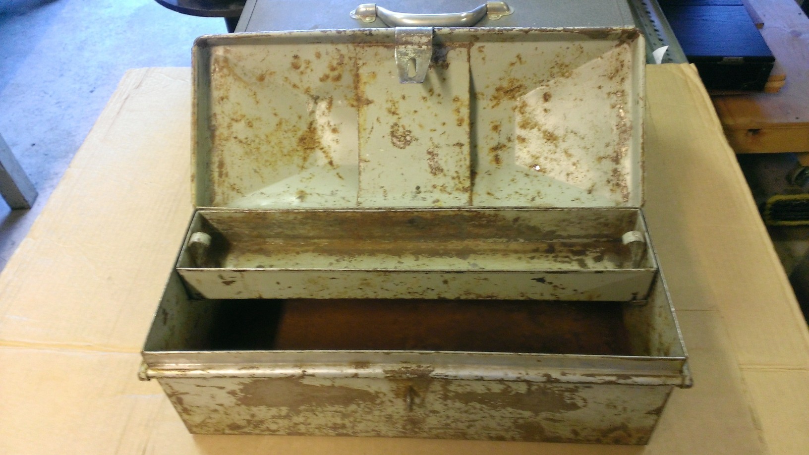

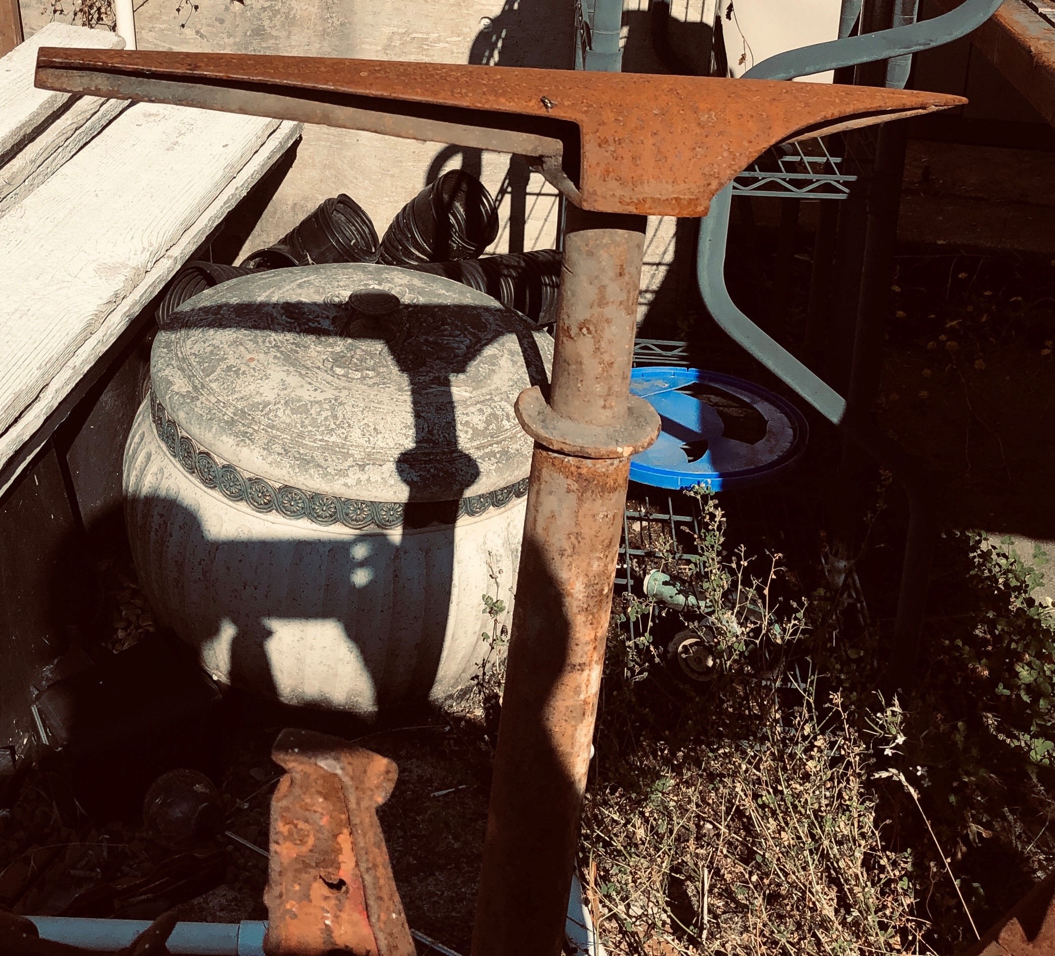

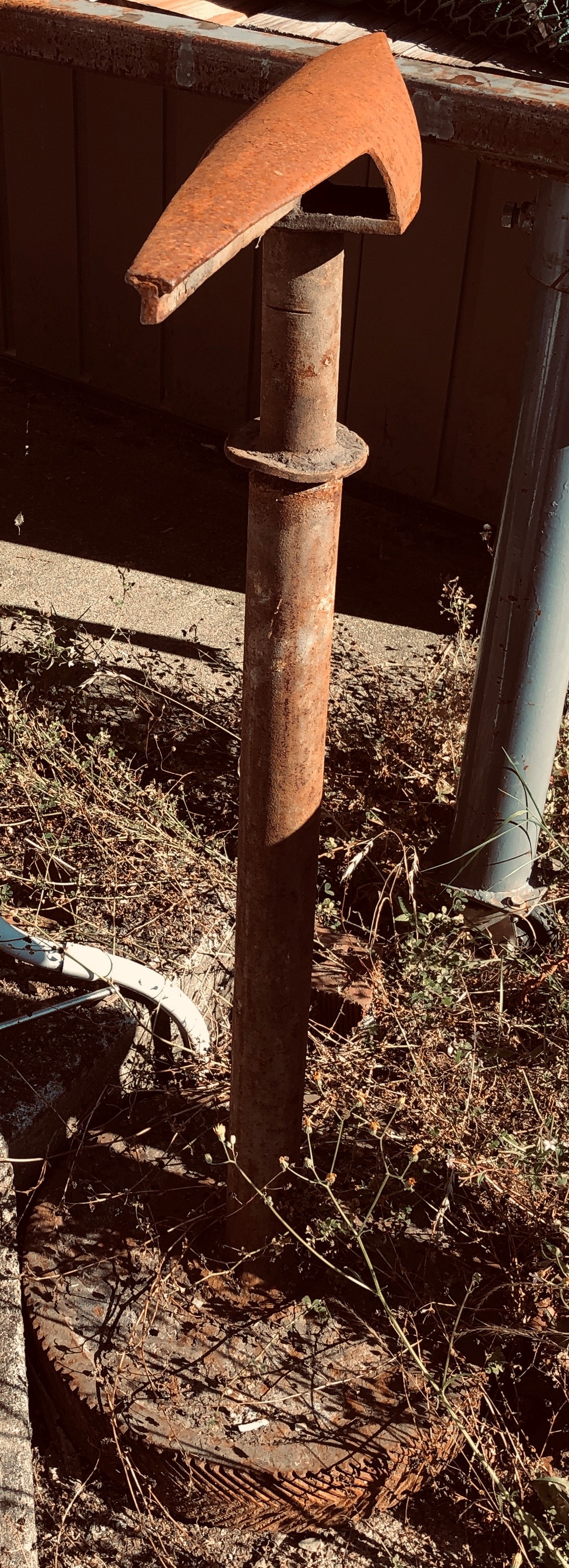

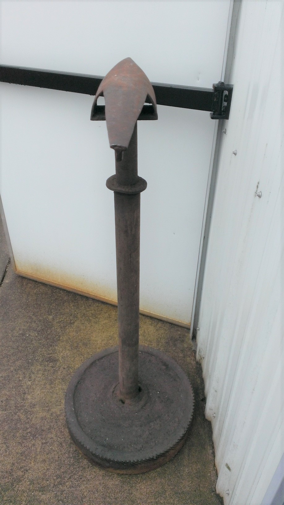

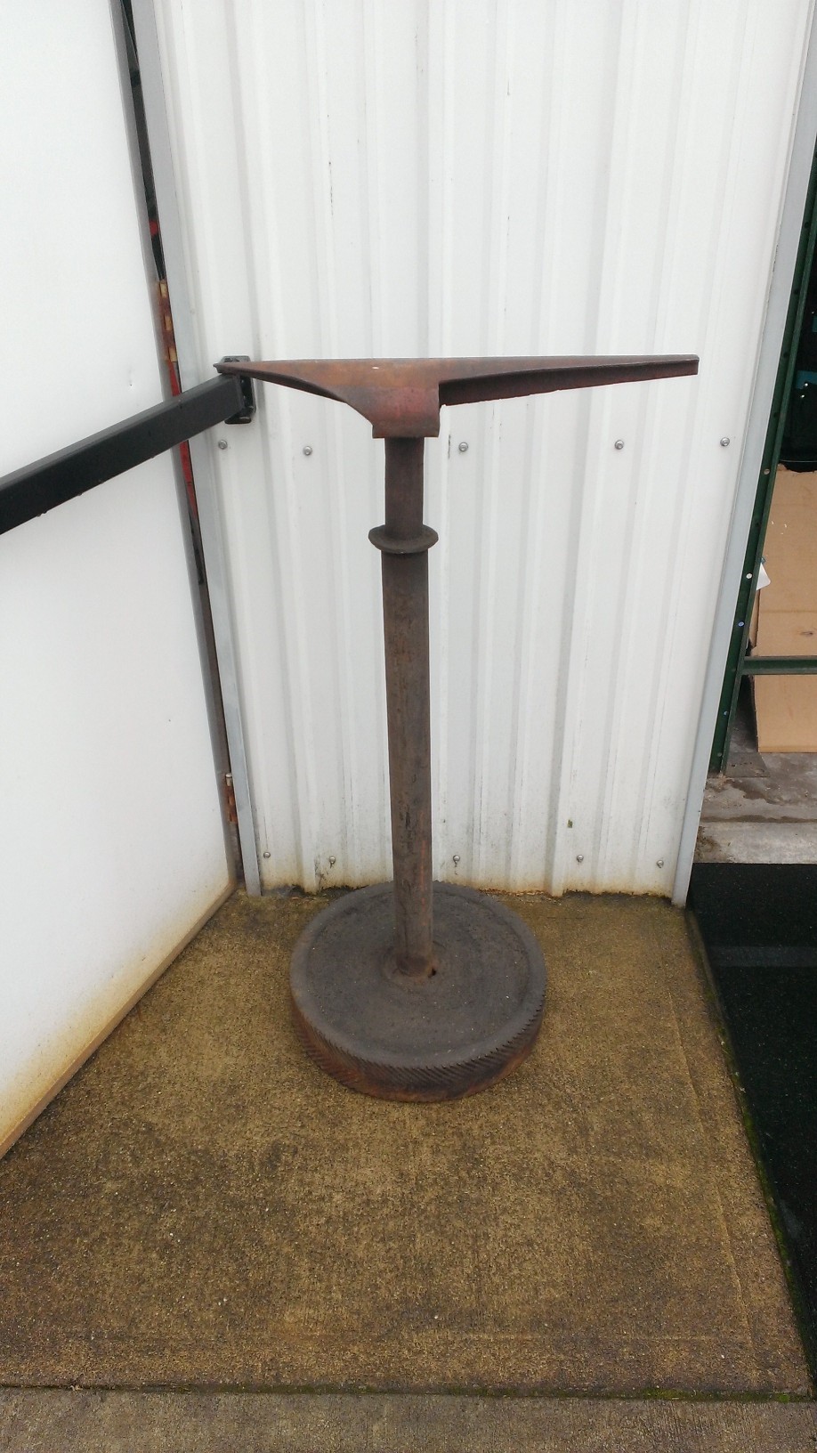

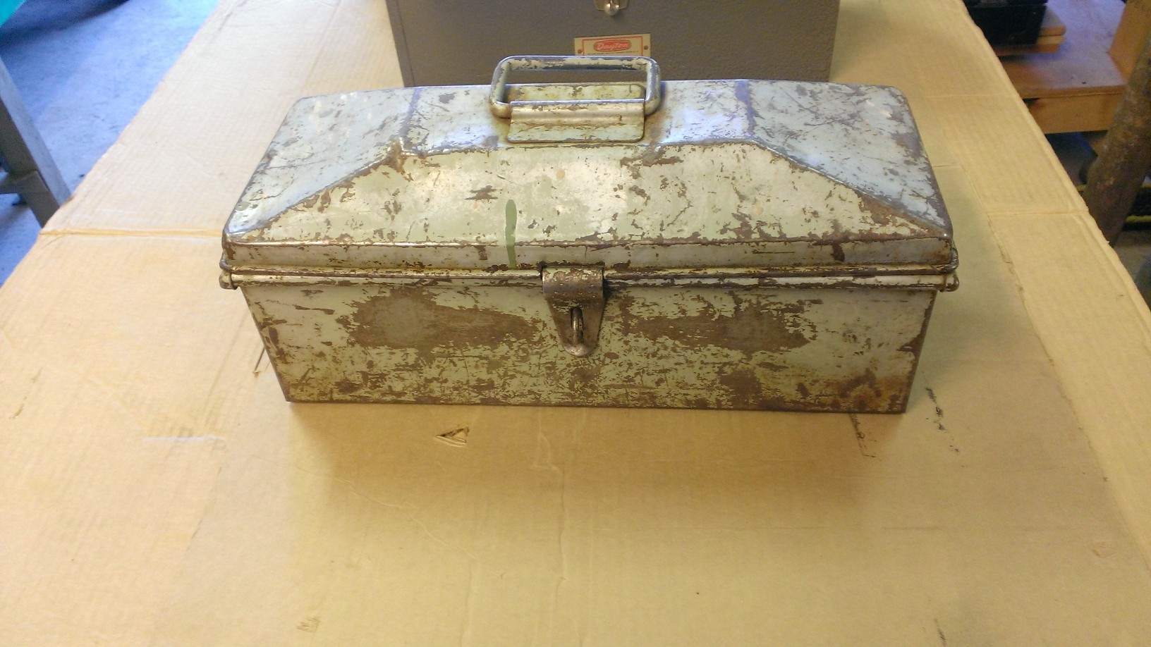

ALL: i'm hoping to maybe pick up a few things on this thread from the pros cause having this skill could be very useful in some of my DIY projects. I picked up this Tin Knocker's anvil that sits on I think and old Model T gear and maybe one day I'll shine it up.
did any of you make toolboxes like this in class or for your tractor? I think they also call them a preacher's box?
View attachment 637030View attachment 637031View attachment 637032View attachment 637033
Starting in the trade, you made your own personal tool box, exactly like the one in the picture. Joints were soldered to make it rain proof. Full of you basic hand tools it weighted in around 50#. The last picture shows a mold we used to shape different shapes by hand like a square to round transition. Shops had a bench made purposefully to mount a wide variety of those hand molds. All a lost art now. I have looked at the 3' brake HF has but have not bit yet. Reviews are very mixed.

SeaBee: when you say starting in the trade i'm guessing you are talking about in the 1960's or when or are there still tin knocker's classes now making these toolboxes that are built like a tank?
Yep I've seen a lot of hardies for benches and anvils that are similar to my old tin knocker's anvil on it's stand and I know it will come in handy one day if I need to shape something.
I can see the Southworth ferry from my living room across the sound from you so you're not far.
did you make one of those PREACHER'S TOOLBOXES or let's call it a Tin knocker's toolbox? and do you still own it?

I had one my Dad made when he was in the CCC camp learning the trade. It is long gone. By the 40's when I worked with him starting out he set me up with a kit of tools and that box. Till you brought it up never thought anything special about it. I went to a vocational high school in Phoenix AZ and learned the right way to do what we had been doing my dad's way since I was 10 years old. After high school I drifted into the refrigeration side of AC and gave up tin knocking. That eventually led into being an industrial pipefitter. Long story. Learned welding as part of the sheet metal course. Last 30 years of my work days I drifted into general construction Project management and my own consulting company the last 10. Im guess I should write a book before the good Lord carries me home.
