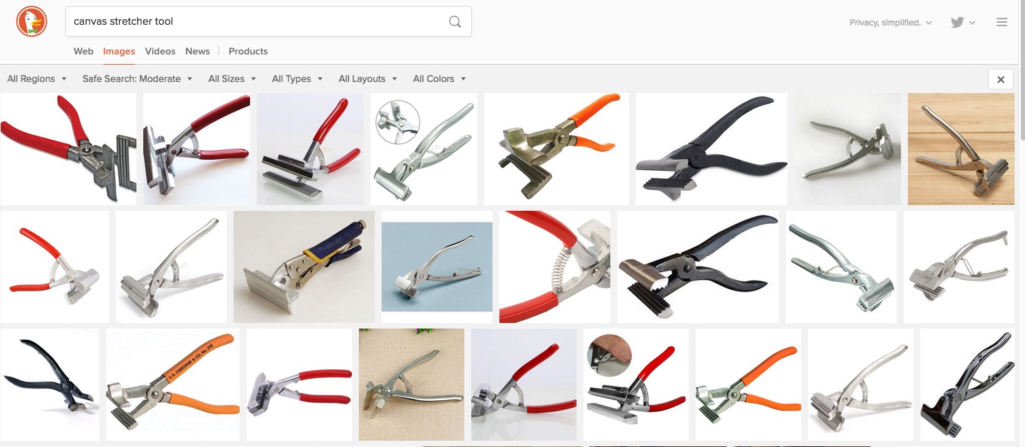

Could one of these work? Many widths are available.
Bruce
/ Any Tinners out there #9
There was one of those in my dads tool box that I inherited. Never knew what it was.
/ Any Tinners out there #10
I always called them tongs, go figure. Just googled sheet metal tongs and sure enough there they are, lol. thought I was loosing it, CRS,
