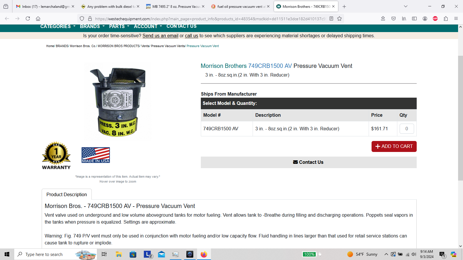

No problem at all. As others have mention home heating oil tanks are usually in the basement or crawl space of the home and have been for decades.
The only thing that I would try and do is to run the tank vent outside, and use a pressure / vacuum vent.
Also many outfits are getting fussy when filling tanks even one that they can visually monitor and are requiring whistles in the vents.
