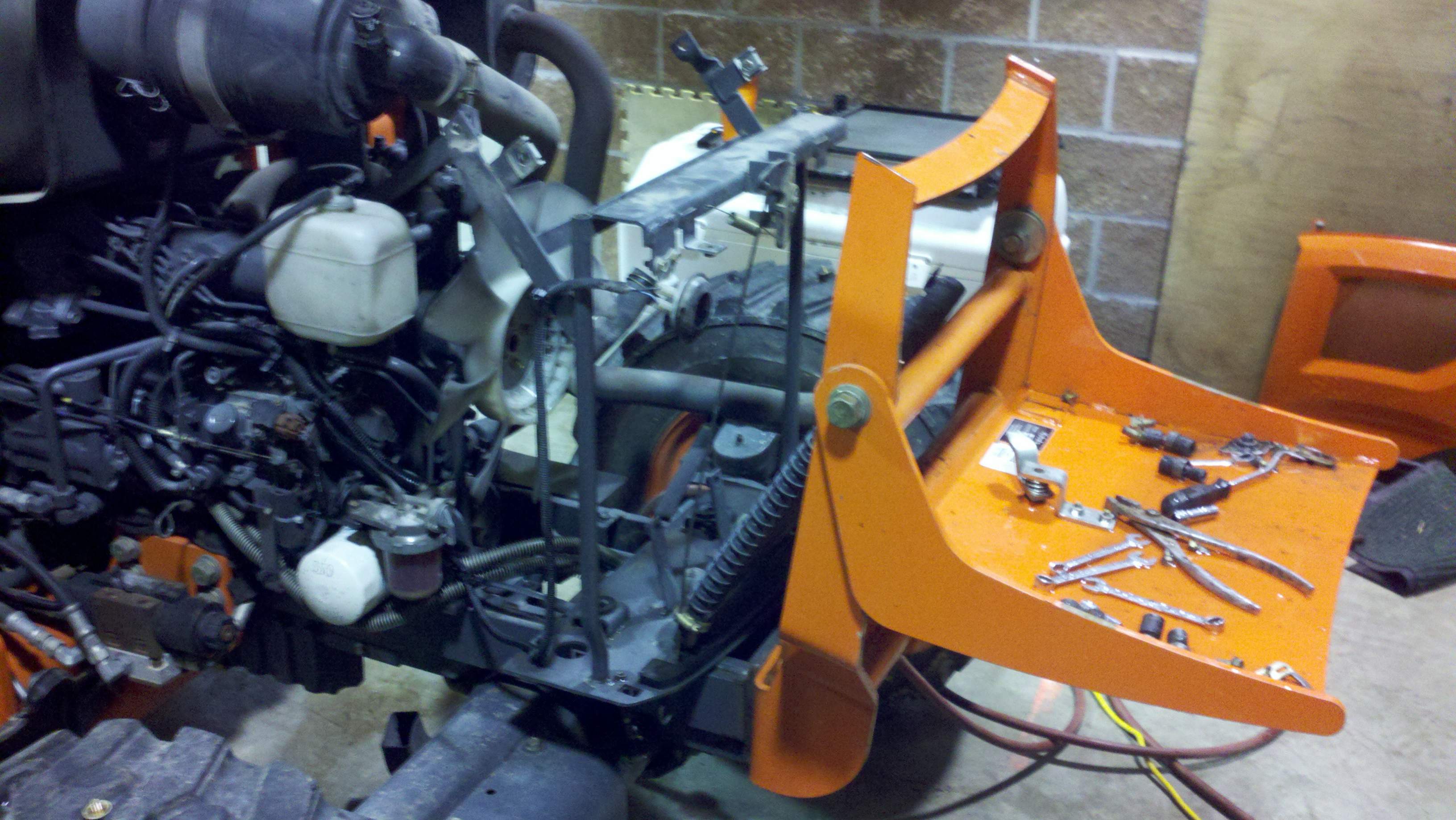

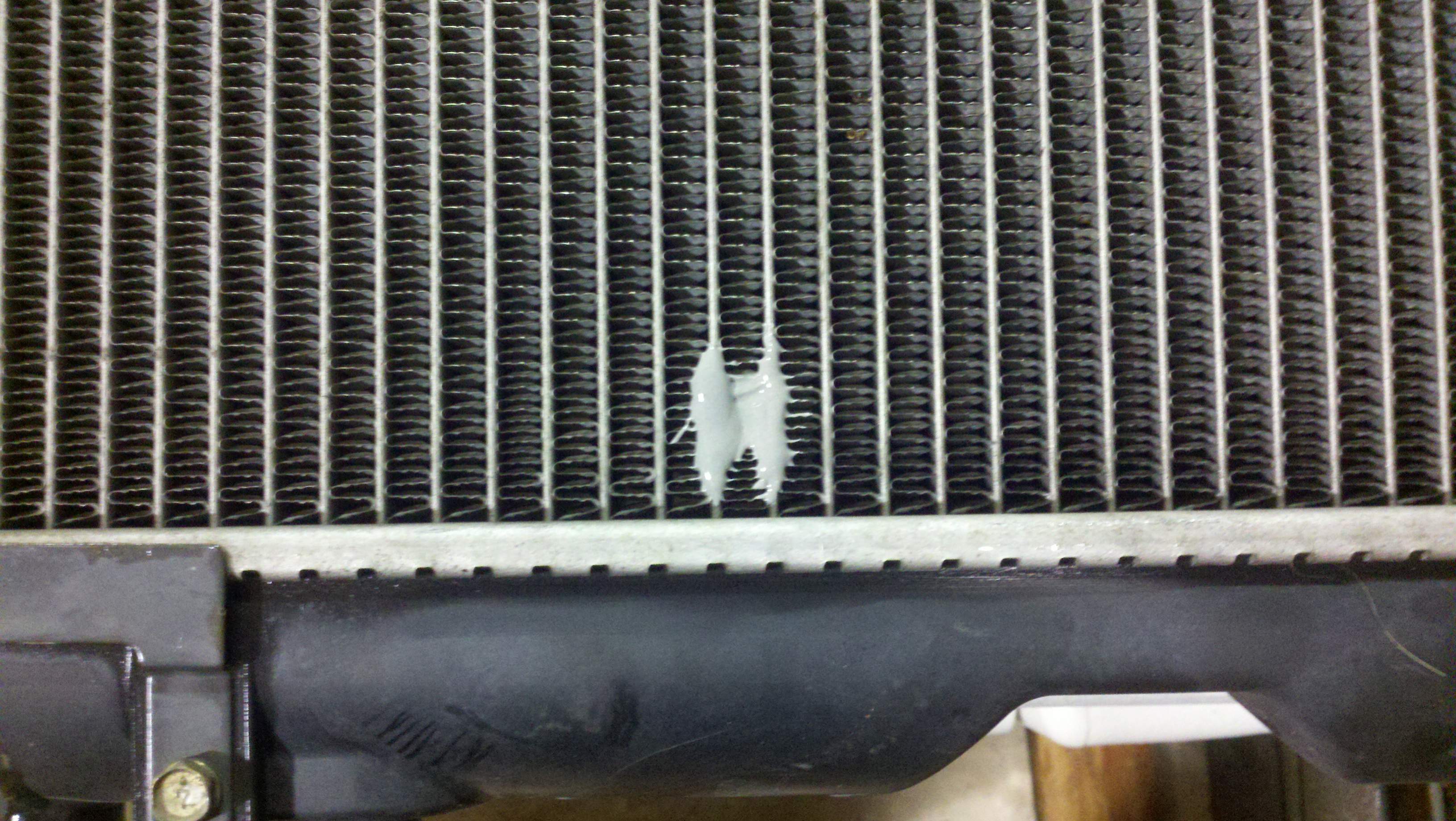

I knew it would happen one day and it did,, while stacking a brush pile with my grapple I ran a limb through the brush guard and into my radiator..The good news is the radiator is easy to remove, I JB welded the leaking tube and going back together with it this evening. I am looking for ideas on how to prevent this from happening again..
Thanks, Chuck.

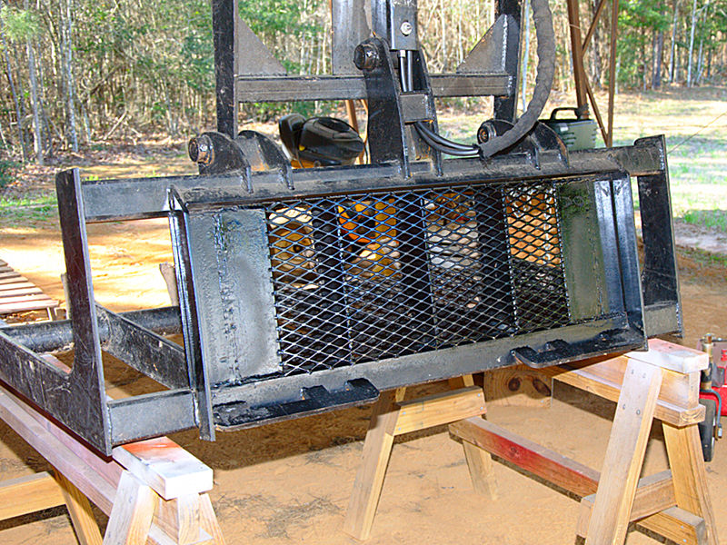

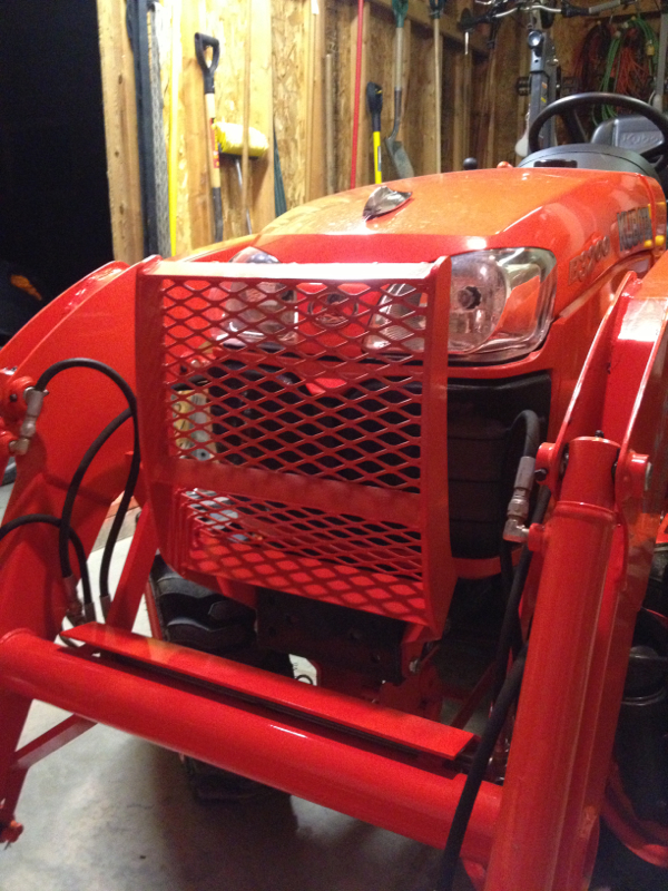

Here's my B3200 with some expanded metal and an extra cross bar welded. Not sure how much it will affect the lights. Want to add some lights to the ROPS anyways
/ Any one Modified their brush guard #8
That looks nice, Now you have me thinking about my B2320. It lives in the woods for the most part.

Yep, and I did it for the same reason, but before the problem actually caused real damage. I also did expanded metal on the back of my grapple for the same reason. That helped the grapple work better too as having a backstop to push against meant things got scooped up better. You can see that in one of the pics too.
http://www.tractorbynet.com/forums/welding/219535-grill-guard.html

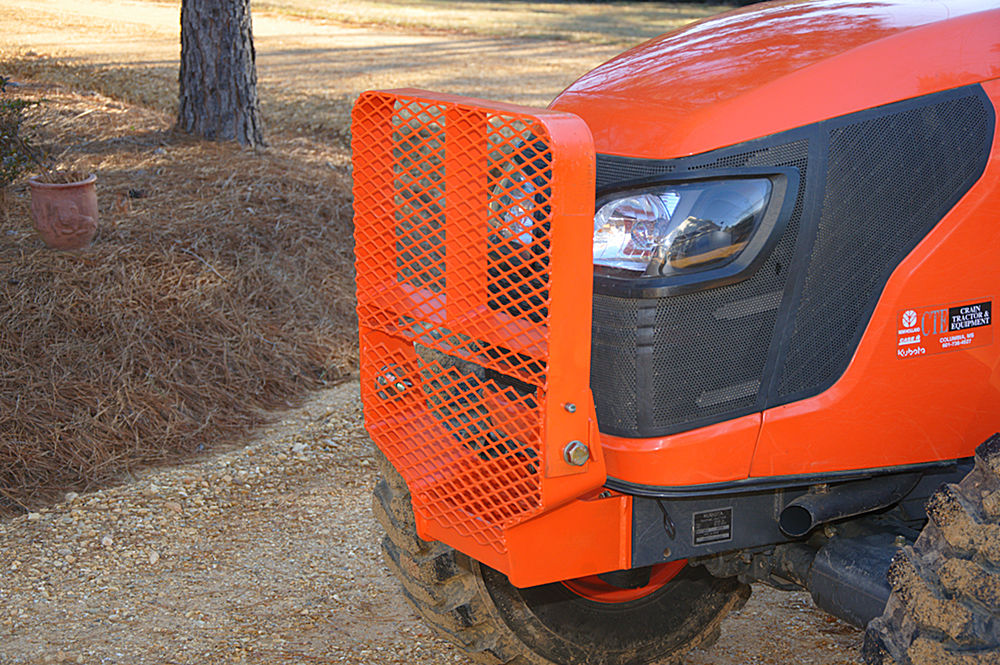

I had to do my grill guard a little differently, since the frame is hinged on my MX5100. But like the OP, I learned I needed one the hard way after I poked a hole in the plastic nose of the tractor. And like dstig, I added expanded metal to the back of my grapple after an unfortunate incident occurred while using it in heavy brush (chronicled elsewhere in these forums).
Jay

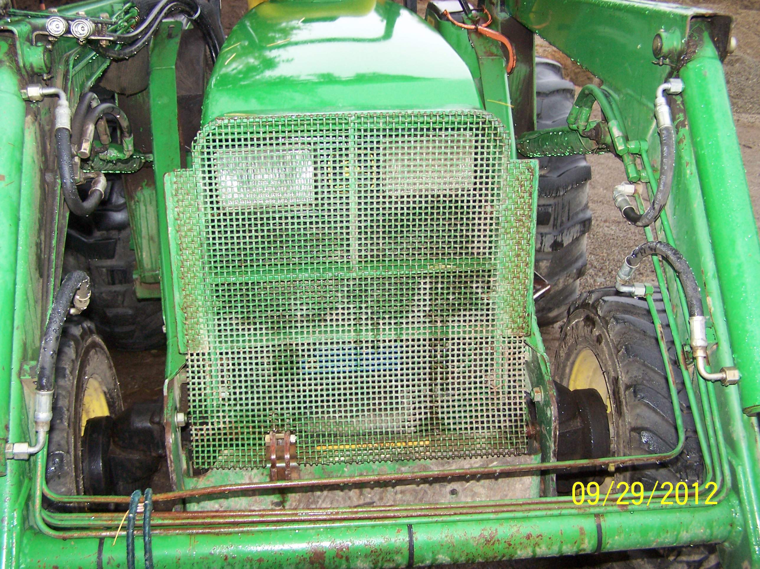

I've used #9 gauge expanded metal. It is very strong compared to what you will find at TSC, HD, Lowes, etc.

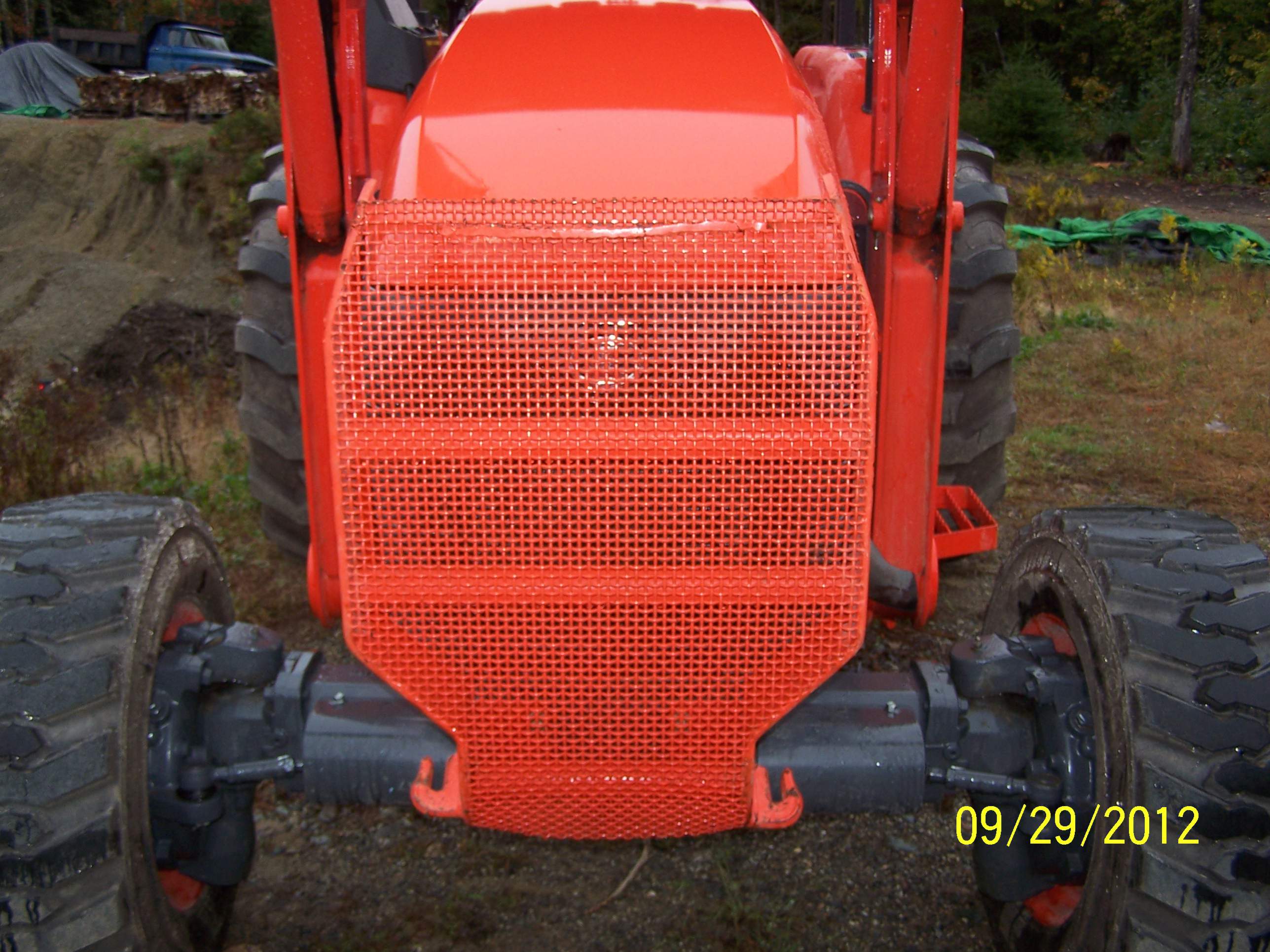

That expanded metal doesn't hold up as well as woven wire, trust me I know. I had my welder put on 3/8 inch. screen with 1/4 wire. I do screening of gravel and loam so I had the screen. You could go to an outfit that does this and ask them if they have any screen pieces laying around. The wire in these screens are hardened steel so it is strong and lasts.

Finally a picture.. got the idea looking at my brother in laws dozer..IMAG0206.jpg

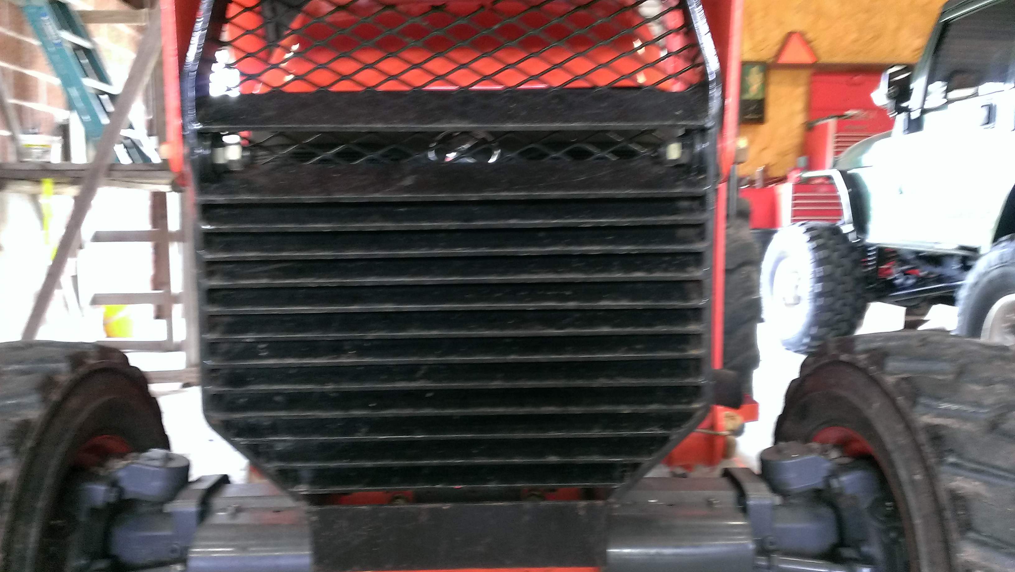

Here a couple pics of the addition to my brush guard. It has already saved my judging by the large dent in it over the middle brace. My brush guard also hinges so I still need to add some to the lower fixed part. When I was done welding I decided there was to much orange up there so I gave it a few shots of flat black followed with shaker can clear.
