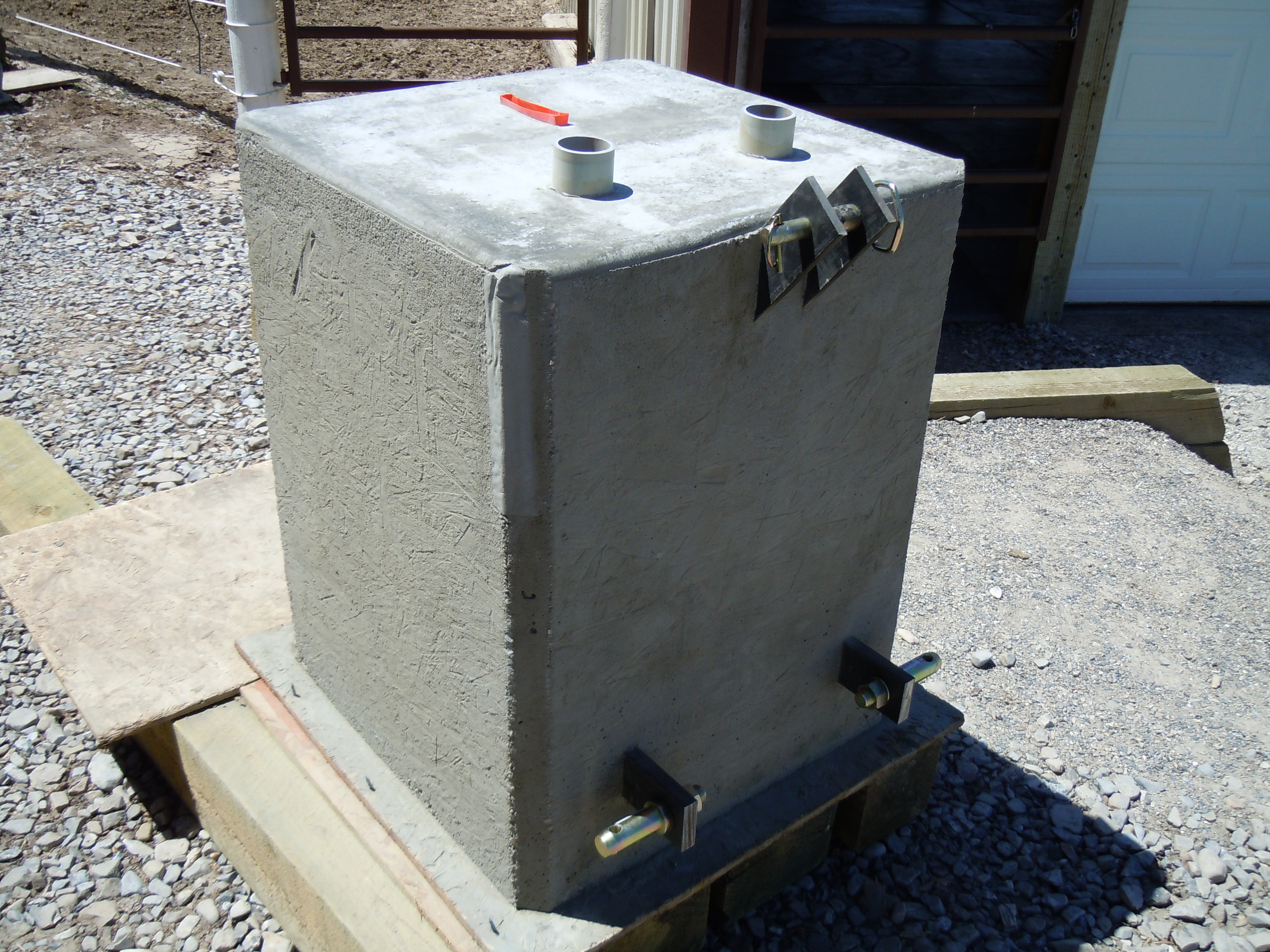

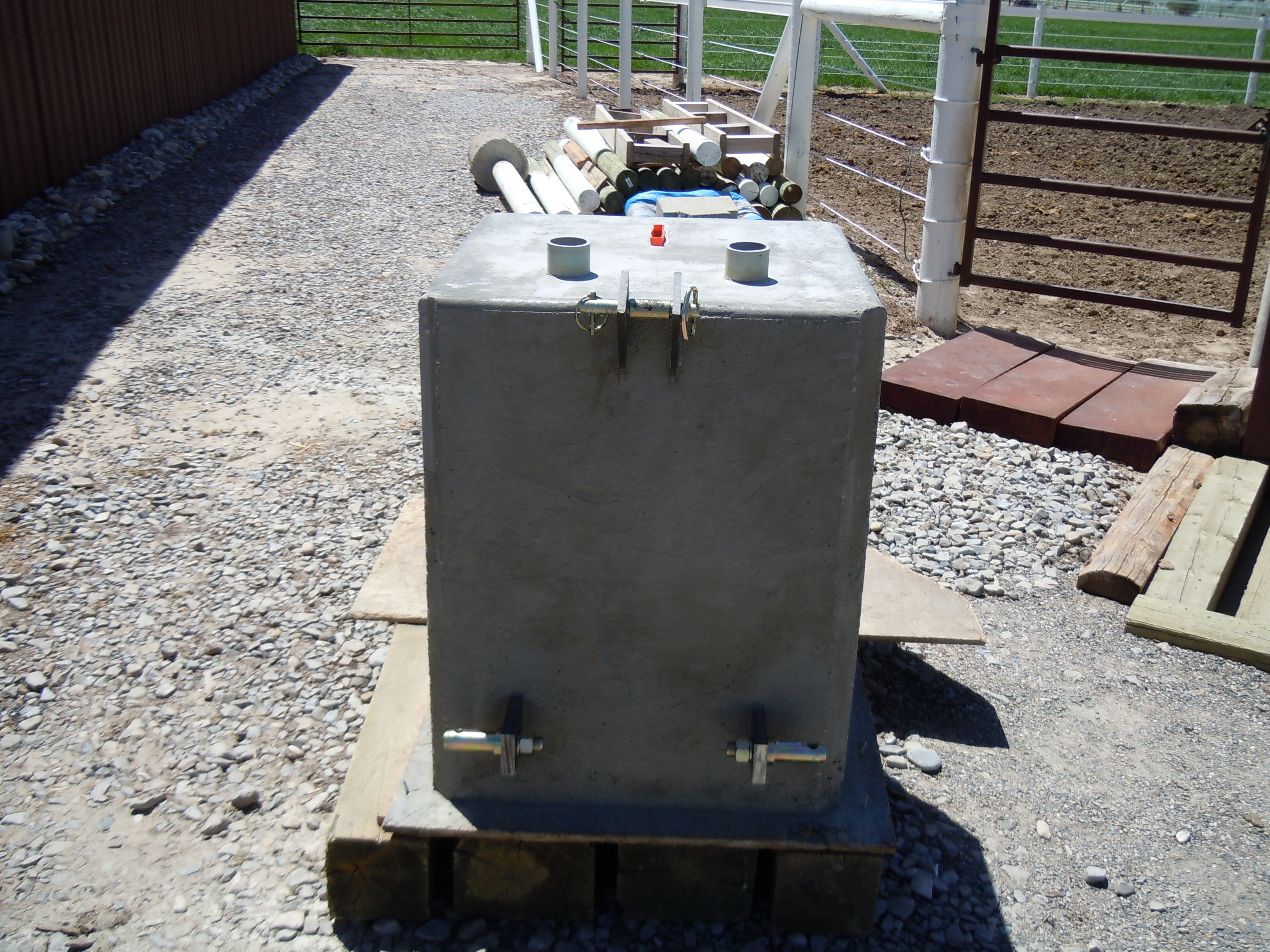

If you look at post #25 I said I was going to build a ballast box. Here it is, 10 cubic feet so around 1500 pounds plus the steel.
It is now in the barn waiting for a paint job.:)

Thanks, I just did what other's have done. (copycat)
Looking forward to using it.

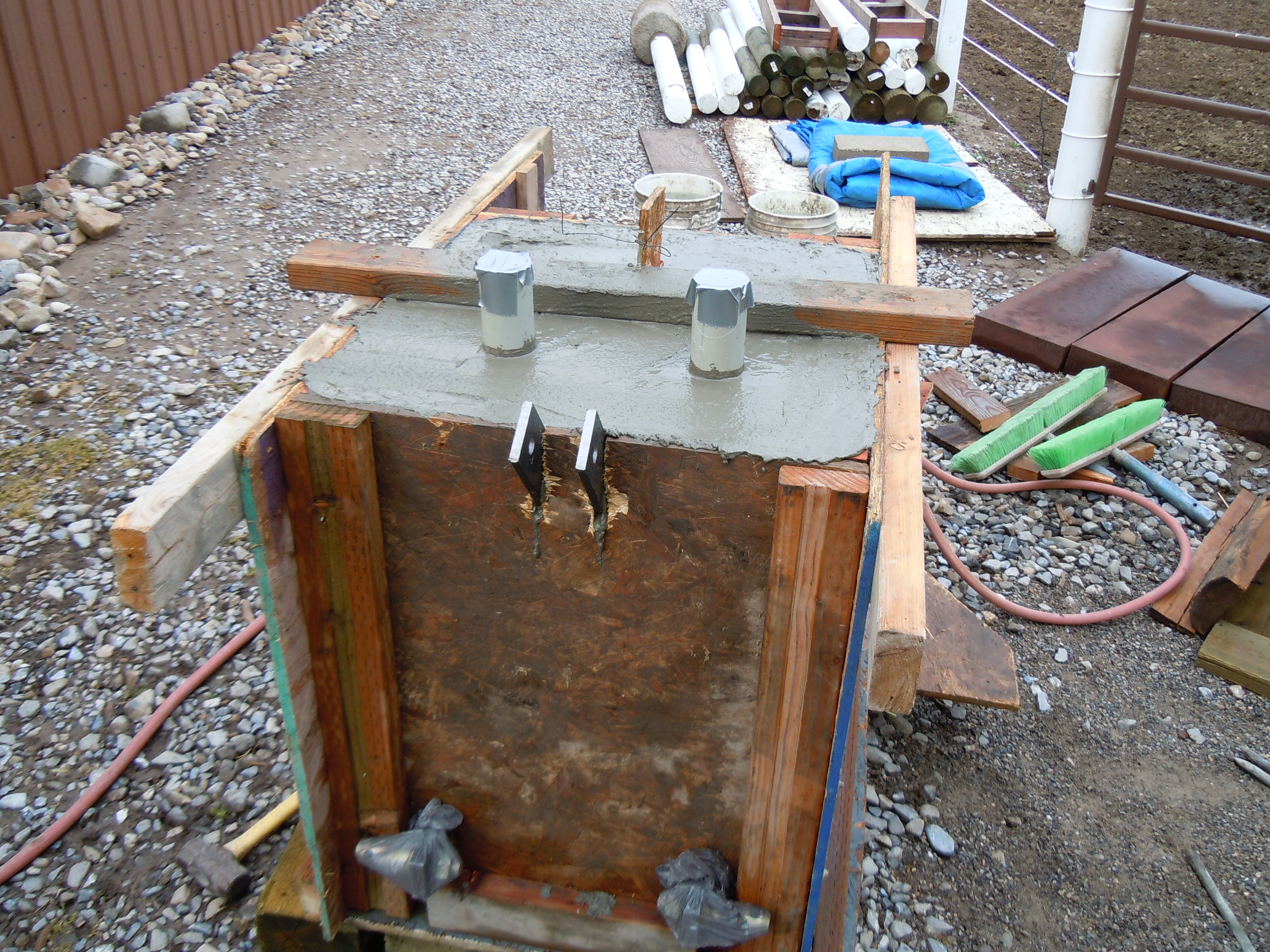

Yup, but I was pretty proud of my scabbard idea (at least I think it was mine :D). :drink:
That's great! Missed it on the first look. Did either of you have to stuff the scabbard with something to support the wet cement pressure?
   / Any Ideas for a Cheap Compact Rear 3 Pt Counterweight? #77
Absolutely. I believe I used plywood (maybe 3/8" or maybe 1/2"). Also used a lag bolt to hold the bottom in place and also to provide a drain hole once the concrete set and I screwed it out.
