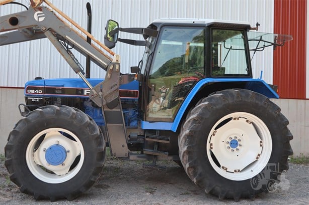

So I am considering this tractor again:
Is 8160 hours on this tractor about time for some major repairs or failures? It also does not have AC, never came with AC from the factory. Is that a costly addition to add in the future? Everything else on it looks like it was taken care of from what I can see in the photos and they did send me a video and it sounds like a tractor for 1995 but my ears arn't that trained either.
/ Any feedback on a Ford 8240A? #2
It is an SLE meaning it has the 16x16 powershift transmission. If it was well taken care of, this would be a good price. Looks pretty nice in the pictures.
A/C will be expensive to add and would probably need to go aftermarket system
/ Any feedback on a Ford 8240A? #3
If it is an SLE it will also have the closed center load sensing hydraulics. Just be aware that it can cause difficulties in some situations. The one that springs to mind is that an older JD pull type forage chopper built for JD closed center hydraulics will take out the pumps in a load sensing system without the proper modifications.
I am surprised that it doesn't have AC that cab will be an oven on sunny days year round, and it will be hard to remove the humidity from in the winter.
/ Any feedback on a Ford 8240A? #4
It's an SLE. The E has multiple meanings. Extensive Expensive Electronics. 8000 hours tells me it's been through some problems and changes in the electrical systems. They were no bargain to begin with, and probably won't be all original at this age. Then finding someone with any experience working on them is another challenge. Most of the switches, sensors, and such are still available. (at a price) The controller may be a different story. There was a place in Canada that could repair them, but that was some years back and I don't know if that is still an option, or if anyone else still does that. Without a functioning controller, the tractor is yard art. You might give that some thought before making a final decision.
