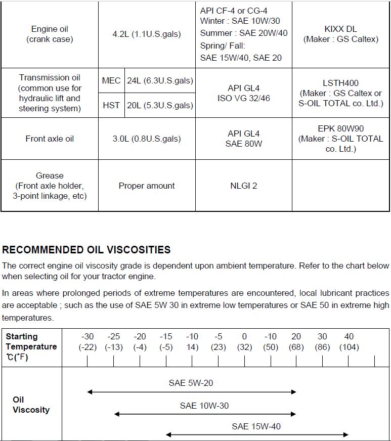

Going to go ahead and change it tomorrow along with everything else. Might be just wasting some time & $, but at least i will learn how it's done and be more prepared next time. Taking it home after work today and doing everything in my driveway vs out on my property that has limited tools and no utilities. At least if I run into problems I am better equipped to deal with them that way.
Local Kubota dealer is pretty close to my work so ran down during lunch yesterday. The Super UDT2 was $101 for a 5-gal pail, so just a hair over $20/gal. Single gal jug was $21 so not much difference there either. Thought that was a fair price vs what I saw online for it. Sucks compared to the yellow bucket 303 my old backhoe took :) But I don't expect this to leak hyd fluid by the gallon either...
If performance and HST whine are better/worse/exactly the same I will at least know for next time what I should consider using.
Tom - I think it was you - in another thread recommended the Rotella T-6 for engine oil. I wondered why T6 vs T5 or T4? T4 & T5 look closer to what the manual calls for to me, but it has lots of overlap. It doesn't say 5W-40 anywhere though. 15W-40 range seems to match the NC weather best which would be T4. 5W full synthetic > 10W synthetic blend > 15W is reason for T6?

I used the T6 as it is a full synthetic. I could of went the Amsoil way as well, but I knew that T6 was readily available. For the 1st time I bought Amsoil for the vehicles thinking there may be improvement over the Lucas I was using in one of them. Will I continue to use Amsoil? That remains to be seen. I live in reasonably temperate area and don't require the lower winter rating of the T6, but it does no harm. Much like the lighter winter rating of the hydro oil. In changing the whole enchilada, I had 1-2 quarts left over.
