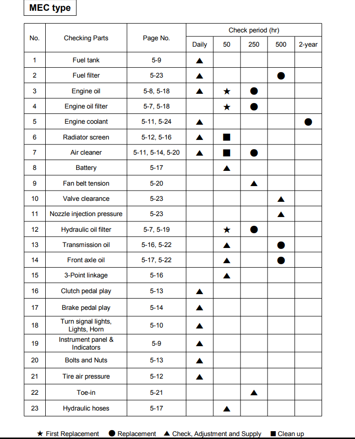

Got all my filters & fluids to do my 50 hr service. Would there be any benefit to changing the hyd fluid at same time? From the recommendation here for Kub Super UDT-2 I did some more internet research and have read about it quieting down whine, giving smoother operation, etc on other machines. And if it's written on the internet it must be true :) Manual doesn't call for change until 500 hrs service. So before buying $125 or so of fluid figured it would be smart to ask if there would be a good reason to switch the factory fluid @ 50 hrs for that Kub fluid or would there be 0 difference and I should just save the $ and just change the filter?

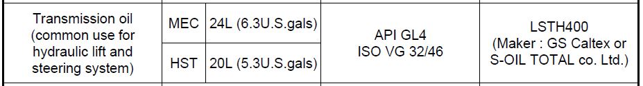

/ Any benefit in changing hyd fluid? #11
Good catch... I just grabbed the image from the online manual after doing a quick service intervals search, didn't look at the trans type.

So it sounds like I *might* waste a little time and the cost of fluid, but there would be no harm changing the hyd fluid this weekend as part of the 50 hr service even though the manual doesn't call for it yet. I *might* benefit from getting some foreign material or condensation out early.
But I should probably expect no noticeable difference using the Kub super UDT-2 in place of whatever the factory put in there? Sound about right?
