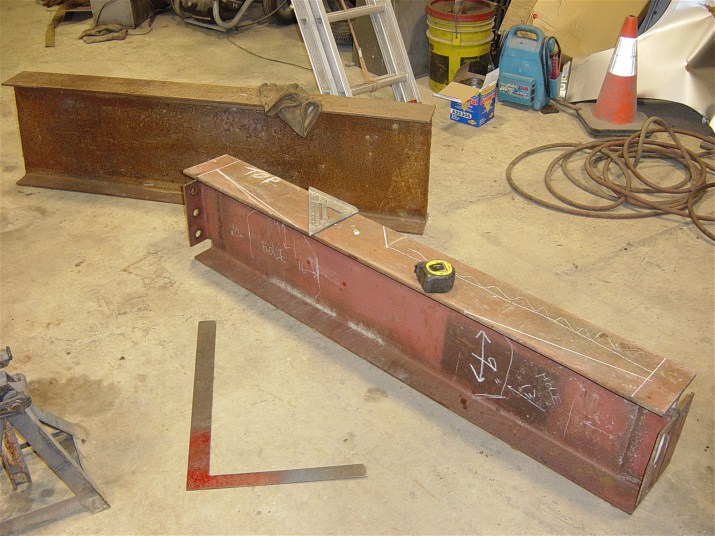

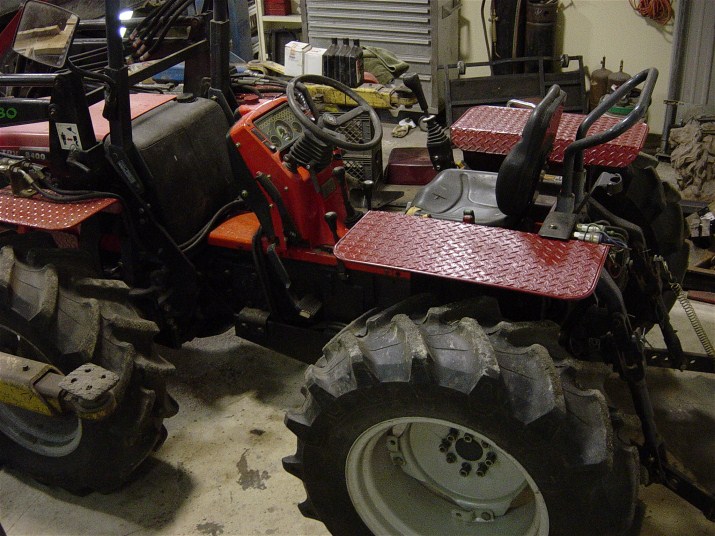

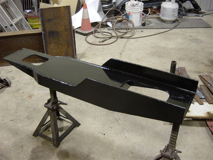

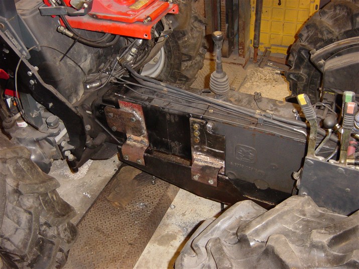

Well, folks have been requesting an update/resolution...
I put the tractor back together this winter.
It took about a month - Some all nighters to get it done so I could work with it before my deadline to work.
Long story short. I used a piece of bridge I beam to cut out a form for a skid plate to bridge the rear and center section together. Then bridged the top and bottom together to the rear of the tractor. Then got rid of all of the plastic bumpers and made better, lower profile, diamond plate bumpers....
Welding the center section sucked - many dealers (including the headquarters) didn't really know what metal it was made out of. When we did comparison tests of known metals vs this metal, we were dumbfounded as to how it behaved!!! Most said cast steel and a few said cast iron.... We tried welding, migging, tigging and brazing with about a dozen methods on some lone pieces not attached to the center section....
Almost all of them would peal the cast off of the piece as the weld would cool, no matter how short the pass. Brazing just would not stick to the metal - simply amazing to watch - No matter how hot the metal got, the brazing material would just sit on top of the metal and roll around, bounce off or peal off... I just didn't have the money to do a metal analysis.. I got the center welded together, but will never trust it. I am only assuming the fix to be the equivalent to a spacer.
I have been using the tractor since Mid February with no problems. This includes logging with the tractor through March - Yeah, AND lifting the front end of the tractor up with the front end loader to put my tire chains on!!!

Wow! Great band aid. With a new casting it might be strong enuf to do hard work with utter abandon. I am amazed at that spare center section considering the forces it would reasonably be called upon to bear. Fasteners are an extreme issue in making that design viable.
larry

Yes there was a resolution. He had to fix the tractor himself. Look at the pictures.
