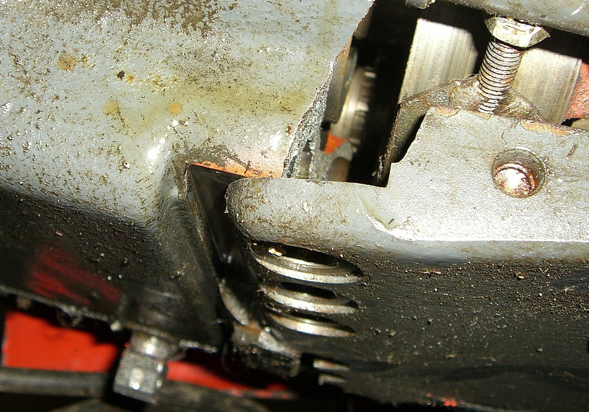

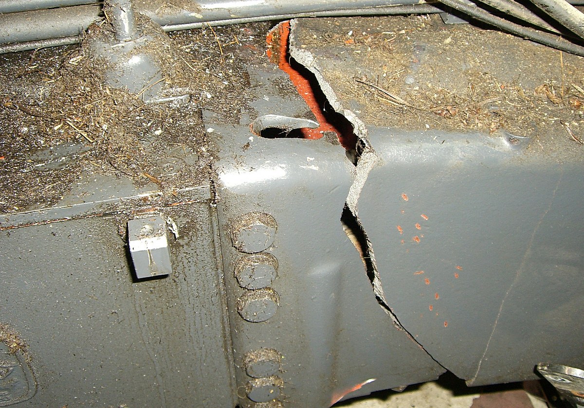

Help!!!
I have an Antonio Carraro TRX 8400 68 HP tractor with a front end loader. It's 2 years old...
I was lifting up the front end of the tractor with the front end loader (like I have done with all of my tractors) to put jacks under the frame to perform maintenance.... I heard a groan and then the whole thing just pop, pop, popped in half in a sickening sag and then a pool of hydraulic oil.... I wasn't even on the tractor when it happened, just standing to the side working the levers.
I am convinced that this is a manufacturing defect and am not getting much of a response from the company... The dealer thinks the repair would run about 18,000!!! Oh yeah, the warranty expired a couple of months before this happened too... figures...
Any advice, answers, comments appreciated.

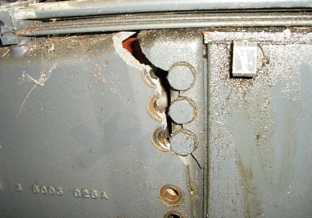

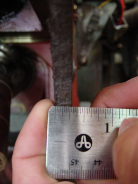

PS: I believe that the casting is defective. When I looked at how thin the housing walls were, I was shocked. Barely thicker than 1/4 inch in spots.
They also skimped on the metal around the threaded bolts that hold it together. That's where the casting initially failed as well. When the shoulder casting around the bottom bolts went, the rest just went for the ride.
I'm sure that if the integrity of the metal wasn't compromised by any internal defects and the shoulder metal was a little more substantial, the failure would never have happened.
I had to bring it back to the dealer for the 100 hour servicing and we discovered that the cast metal bumper guard weight had cracked in half... I had never hit it. This is a 1" thick chunk of metal that protects the engine... We sent it back and the one that the dealer got was ALSO broken... no damage to the box it came in either. Third time was a charm...
You know you might want to spend a couple of bucks more and have the metal analyzed by an independent testing lab to make sure the metal isn't substandard...;)

I believe that the casting is defective. [Bruce Clark] Then you should send this part to our office. They then could examine the part. If in their expertise and examination they find it a defect, I知 sure they would help you even if your warranty has expired. On the other hand, be aware that this kind of failure would be very remote. When I looked at how thin the housing walls were, I was shocked. Barely thicker than 1/4 inch in spots. [Bruce Clark] The design is very sufficient
They also skimped on the metal around the threaded bolts that hold it together. [Bruce Clark] Please do not insinuate that there is a design fault or that the company is skimping on metal. Such accusations are very damaging if publicized and would be defended in a court of law. Antonio Carraro Tractors are of the finest quality and their reputation for producing a market leading product with a great reputation is very important to the company. That's where the casting initially failed as well. When the shoulder casting around the bottom bolts went, the rest just went for the ride.[Bruce Clark] I would suggest that you look for wear in that area that would be uncommon. Loose bolts can cause this in tire rims. I would look to for loose or missing bolts to contribute to this failure and not a design flaw.
I'm sure that if the integrity of the metal wasn't compromised by any internal defects and the shoulder metal was a little more substantial, the failure would never have happened.[Bruce Clark] A full investigation then maybe required
I had to bring it back to the dealer for the initial 100 hour servicing and we discovered that the cast metal bumper guard weight had cracked in half...[Bruce Clark] I am a little confused, what dealer was this and where? I had never hit it. This is a 1" thick chunk of metal that protects the engine... We sent it back and the one that the dealer got was ALSO broken... no damage to the box it came in either. Third time was a charm...[Bruce Clark] hmmm
I would like to think that the company received a bad batch of cast iron from one of it's suppliers.... My tractor should not have broken in half under it's own weight.[Bruce Clark] It did not. The only other possibility is that some one vandalized it. [Bruce Clark] Please explain The dealer noted that almost all of the major bolts holding the housings together were not tight and 3 were missing. [Bruce Clark] Dave, this issue is finished. If after 2 years those bolts have become loose and or lost, then of course this explains the failure you experienced. If you allowed operation of this tractor with or without a front loader on it, with loose or missing bolts on the bell housing, you were risking a failure due to neglect and lack of maintenance that could have resulted in causing major harm to the operator. He thinks that they were present at the time of the break though.[Bruce Clark] You stated that 典he dealer noted that almost all of the major bolts holding the housings together were not tight and 3 were missing? Please do not contact our department on this issue. Please do not make statements about flaws in the tractor.

Bolts dont come loose in correctly designed and properly torqued assemblys. One or the other is the problem. Id guess it was improperly assembled, but it could certainly be in combination with design shortcomings.

It certainly is a curious design , instead of the usual bell shaped flanges which bolt face to face . I don't think i would have chosen to slide one housing inside another and then bolt through the sides which would require the brittle cast housings to pull together to become tight . And in regards to not being able to lift the front of the tractor with the loader , what difference would that make to the housing other than reverse the load as compared to lifting a bucket full of dirt ? And if while pushing dirt , snow , whatever and the bucket rides up over a mound and lifts the wheels a little would the tractor break in half ? Maybe the loader arms should only have single acting rams so no downforce could be applied :rolleyes:.

There is no way even a meth head could mistake front end loader bolts with frame bolts.... The frame bolts (except for a few) are completely inaccessible because they are hidden behind the body sheet metal... The bolts that would have shown any tool marks must have rattled off of the back of the ramp truck on the 4.5 hour drive...

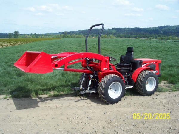

I would like to show you why I got so excited about buying this tractor.... I spent 2 years looking for a new tractor and I was in a position to buy new. When the dealer I had been working with sent me the Antonio Carraro Tractor People magazine, I saw the tractor I wanted... The TRX set up with the forestry package!!!
I also took the dealers advise and bought the Sigma loader that was designed for it.

If I were on the jury, I'd think that the bolts were never tightened in the factory. That's a heartbreaker of a story. Any possibility that the guys that installed the loader had to remove and replace those bolts? Jake
/ Antonio Carrera Tractors #37
I don't think that there would be a chance for that since half of the bolts are completely inaccessible due to the fact that the body sheet metal completely covers the frame. I'm not sure how one would be able to inspect all of the bolts for tightness either... Thank you for your sympathies.
