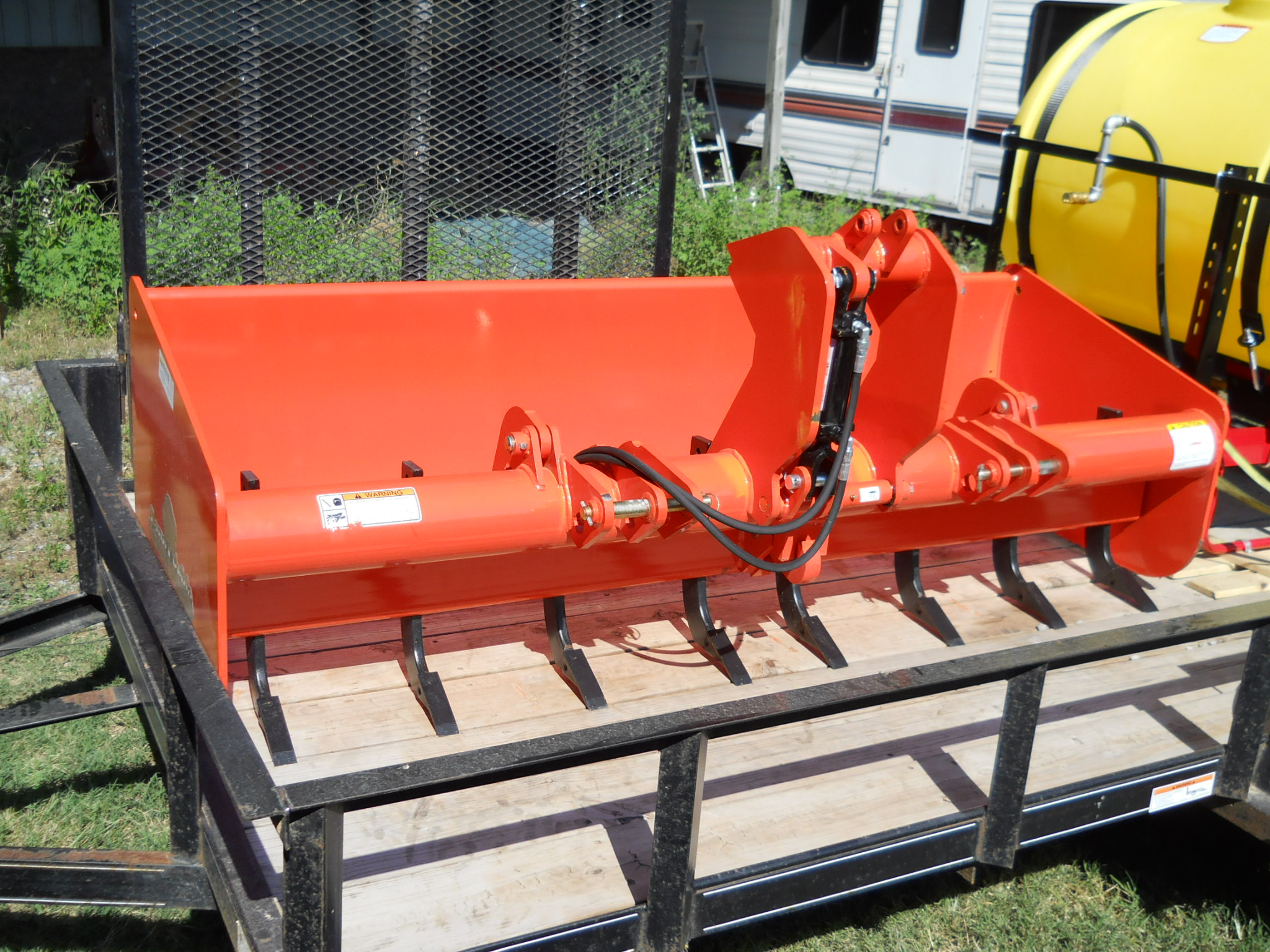

Seems like this has drug on forever (pardon the pun!), but I finally got a box blade:
After determining that my rear wheels were set at their maximum width that meant that a 6 1/2' blade would have just cleared and that a 7' blade was in fact the better choice. The scarifiers look like cheap chinesium; hoping that they'll hold up for a bit (I don't have much in the way of hard stuff anyway). It'll be a while before I get around to setting it up and using it.

Yeah, on one hand it'll be great ballast, but on the other hand I'm cringing at the thought of what I'm going to, eventually, hit with it! To-date I've done really good about not hitting my implements on things I don't want to hit, but as I get older I know that this will become more of a struggle! I've sought to mitigate this by installing cameras (and a monitor)- but, I suppose, these are yet more things that one can get distracted by! :laughing:
What is the thickness of the square tubing used for the scarifiers?
Looks like a nice box blade hope it lasts you forever.:thumbsup:
