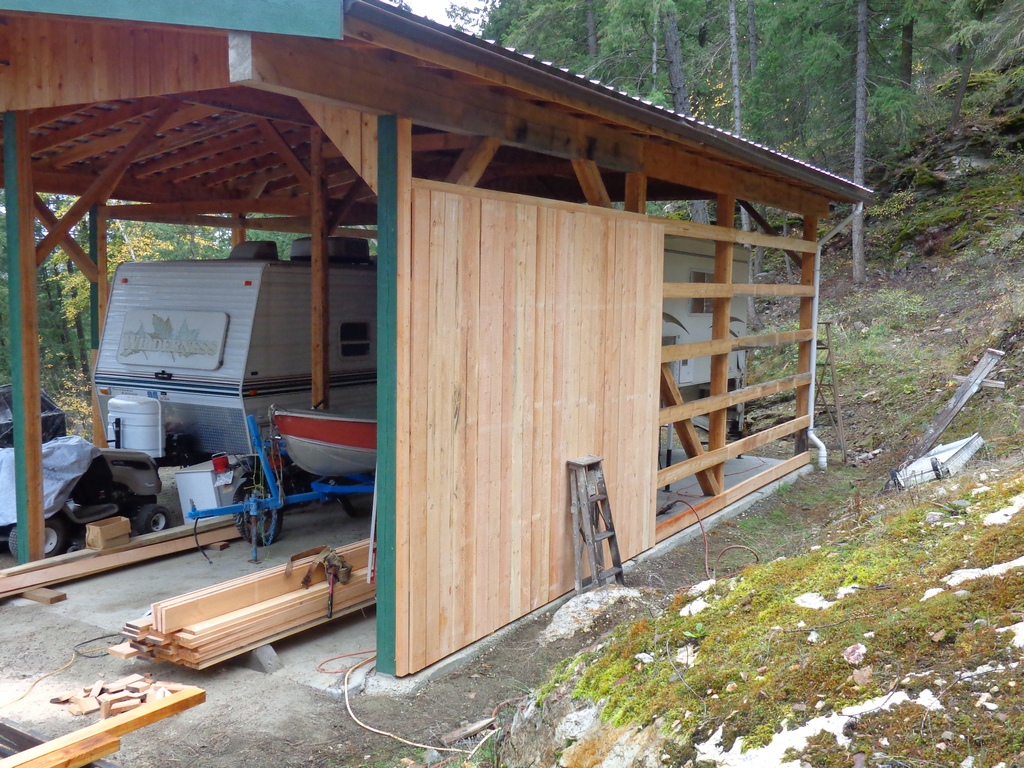

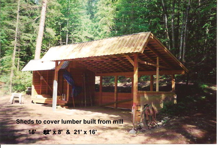

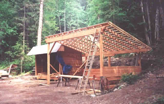

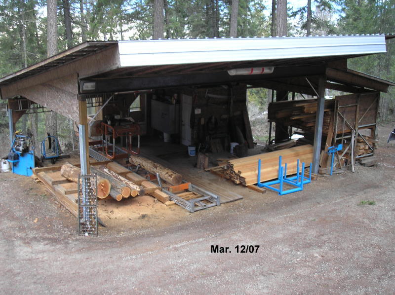

Here are a couple other stiles that could be implemented for storage sheds accessed from the front .

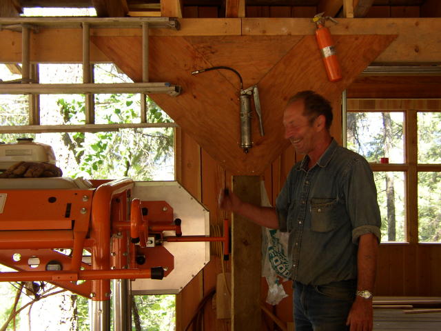

In this one you can see the plywood gussets Eddie mentioned in his post.These were done with posts buried.
Nice mill setup. These will be very helpful for my eventual mill setup. Thanks a bunch.
