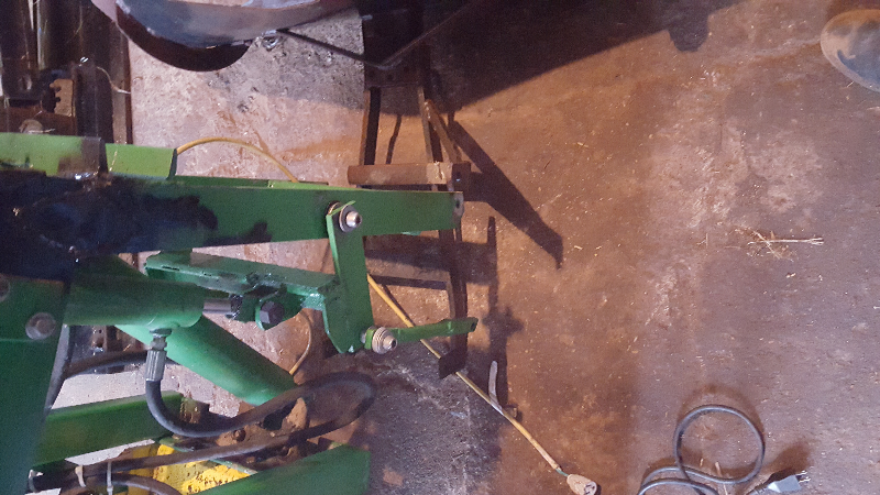

The loader arm will go right where the washers are
Frame made from uni-strut. Now just need add the supports
I'm thinking for some casters to use the wheels off the bed frame

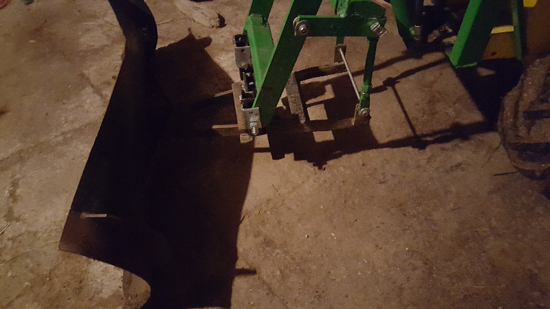

Got they plow mounted and used it to level some dirt and some driveway work

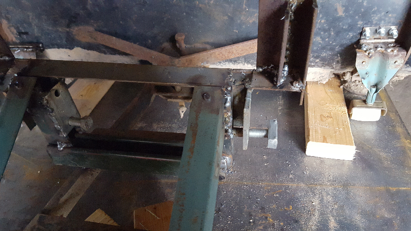

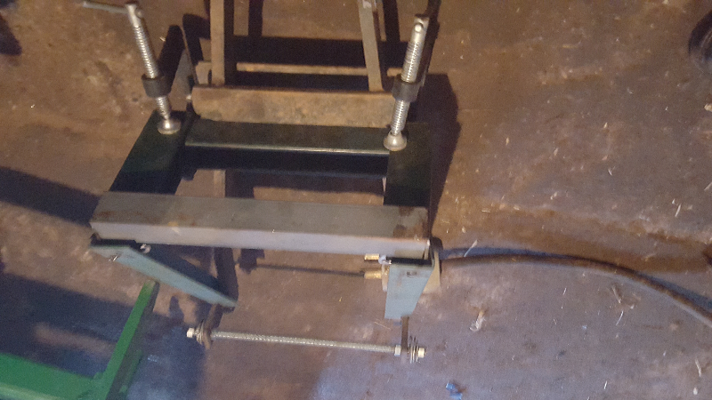

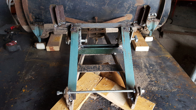

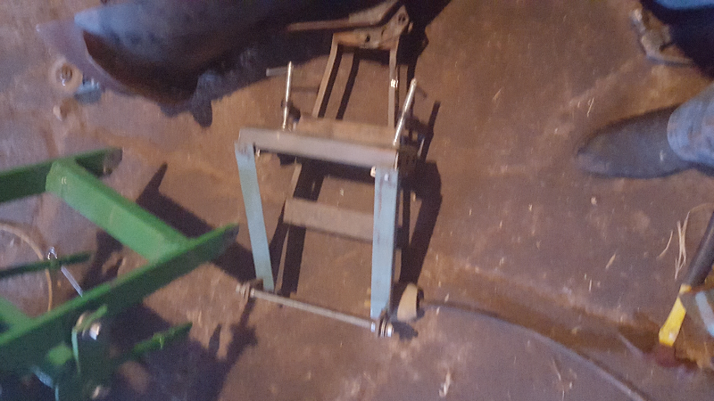

Just got alot more done for welding done. Finally tried my turn at welding. Spent about 2hrs on the shop welding and grinding.
Had to redo the curl mounts. I tried to use the old mounts on the plow but couldn't get the curl needed for lifting the plow more then 1ft let alone stacking 5ft. So made it the traditional way
And used some bed angle for supports (baby blue ) and decided why not make some casters incase. Got one bolted on and other ready to. Just need to build a latch system. Any ideas? ?
