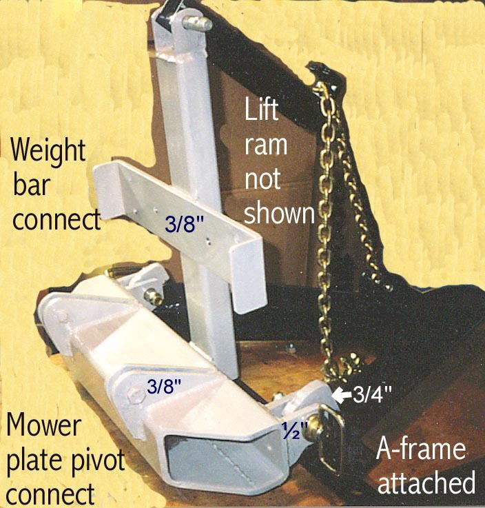

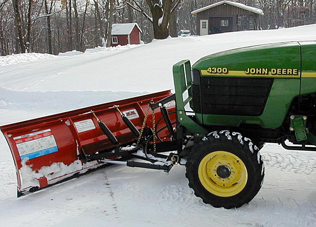

Picked it up today. It's a Western plow, 7 feet, and all the mechanicals appear to be in order. The guy even threw in the pump which was used on the pickup truck it came from. I got everything for $125 (plus another $20 trailer rental) which seems like a pretty good deal to me. I don't think I will need the pump, I will use the tractor hydro.
I didn't realize how big this thing was until I saw it in person. It's huge. I hope it's not too big for the B7800, i can see now why cutting down the frame and keeping the weight closer to the pins would make it easier to manage. Now I just need to figure out a way to mount it.
I have a 7' Western on my 32 HP Deere 4300, and it handles it very well. I'd think your B7800 would as well. However, I mounted the plow on the tractor, not on the FEL. I think that being farther out front, it may move the tractor a lot more when attacking snow. Mine also has the short A-frame that brings it up closer.
Without the FEL, leaves the FEL hyd. couplings and joy stick free to control the three rams. Another plus. :)
Thanks for the info and pic... I know you may not be able to see my pictures because photobucket wants me to pay them now. Looking at your pictures, my plow looks beefier. I have 3 springs and what I believe is a shock absorber where-as you seem to only have 2 spring and no shock. Any idea what the weight of your plow?
Good idea about mounting directly to tractor and using FEL hydraulics. I did not think of that. My FEL is supposed to be "easily removable" occording to manual, maybe it's time to find out!

The weight is 575#.
My FEL is very easy to drop off and re-attach (most time is taken just disconnecting or connecting the hyd. lines :) ). I made the plow hitch so it is easily tilts up on pins in the MMM front brackets, and then with two bolts, attaches to the weight bracket. I keep the plow and hitch together, and have casters in the plow skid brackets, and a 4 wheel caster dolly under the A-frame. At most, a 10 minute job to switch from FEL to plow, or back again.

beenthere, can you take some more pictures of how the frame is mounted to your tractor and how the plow mounts to the frame? I like your setup.
There are some previous pics and discussions about front plows, and a search on Western Plow may give you some of the insights of several on the front mount.
Here is a pic of the hitch (plow adapter) that I had fabricated to connect the front end of my Deere 4300 with the Western plow short A-frame that was available around year 2000 when I put it together. This pic is after fabrication and white primer paint. Does this help?
