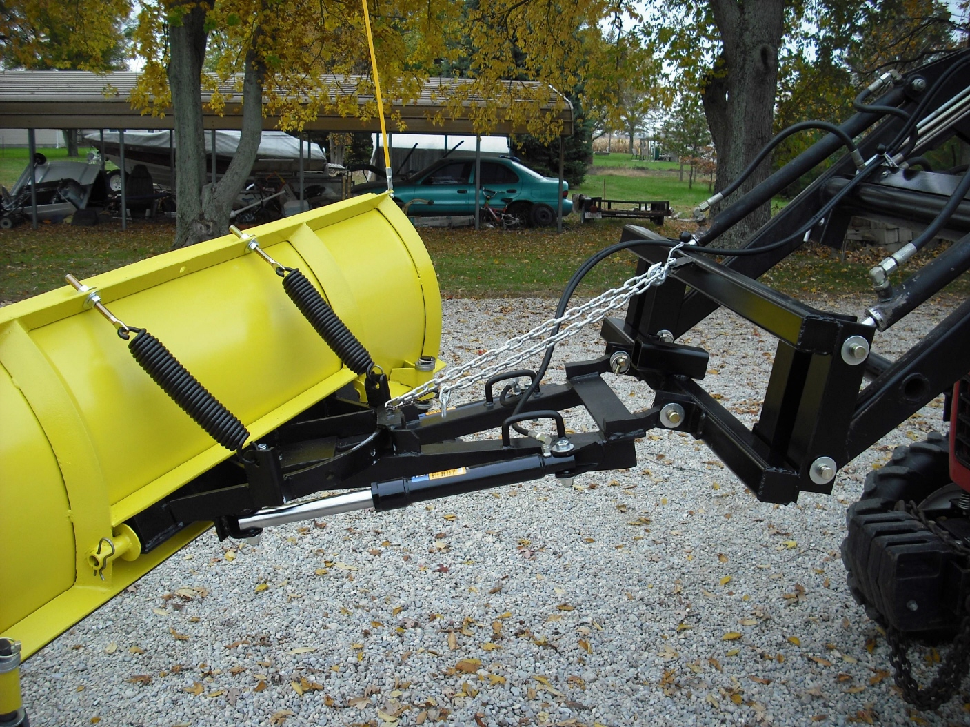

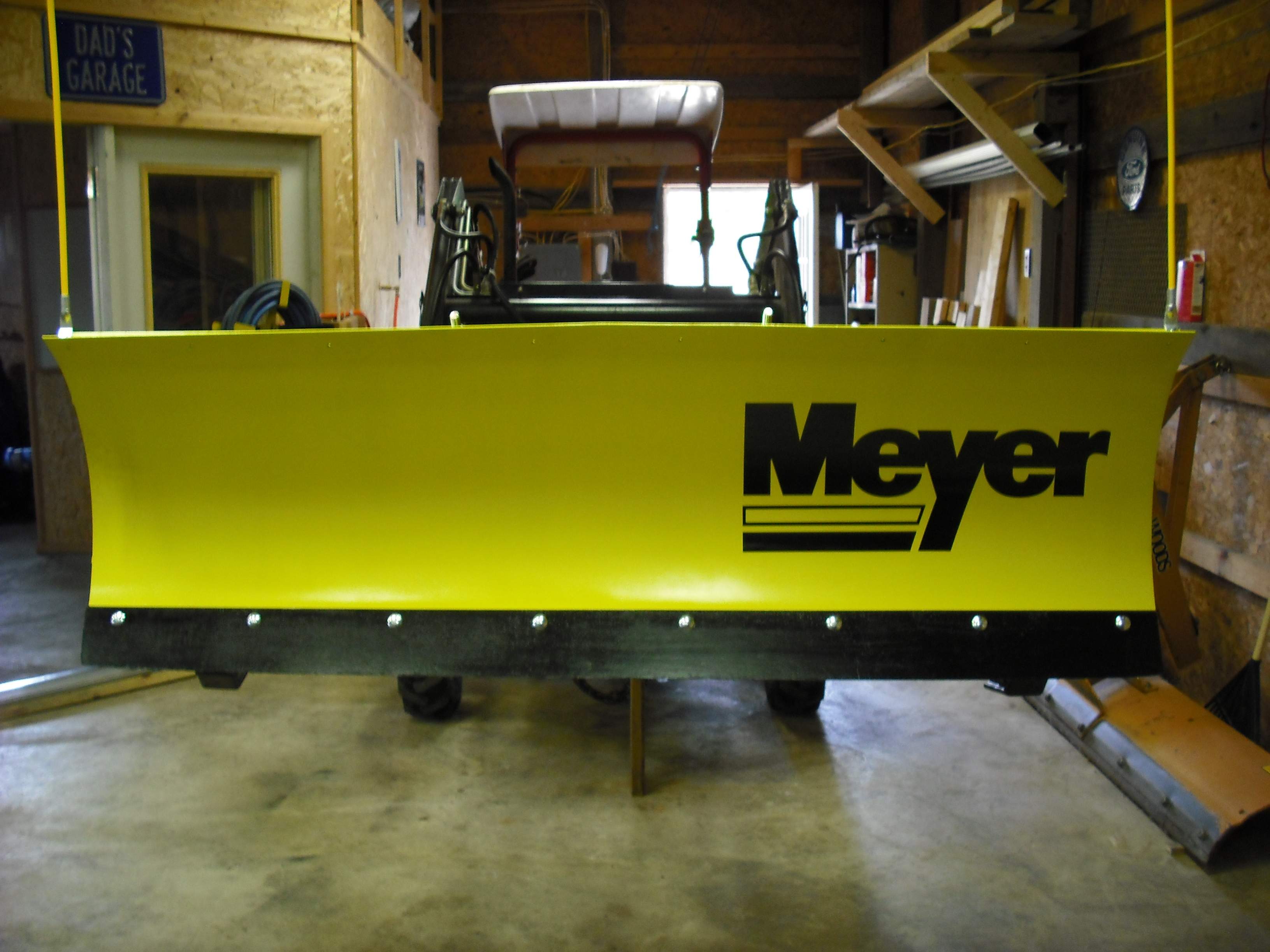

Just completed my plow conversion the other week. Really proud of it as it was some time in the thinking department. While I was thinking my farmer freind did the welding and did the job. Standard 3pt config. put some rubber top and bottom to make it easier on the fancy driveways. Just got the chains in the other day to give her some bling:D
Hey BC...,
What kind of Tractor is that? Have you modified the seat to face backwards, or is that the way it is? Very interesting looking machine.
Phill

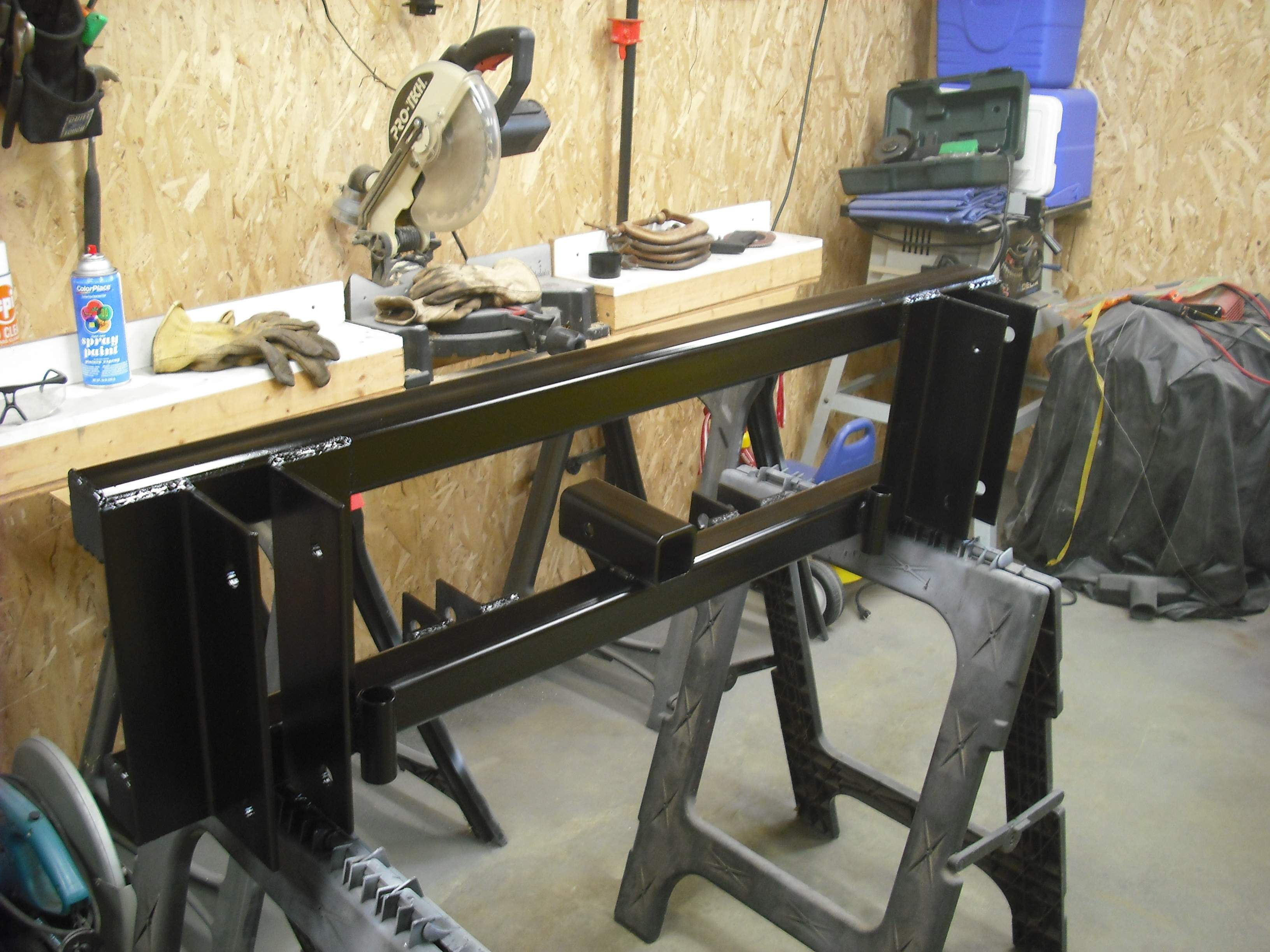

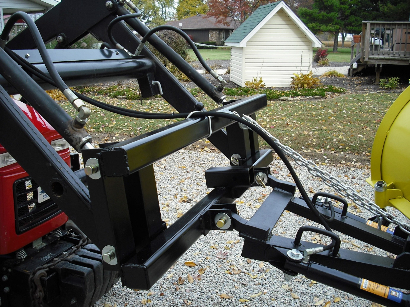

I was wondering if you think an adapter designed such as the one pictured below would be sufficient to mount the frame. The "lift arms" would be adjusted to the width of the A frame and the A frame pins used through the "lift arm" holes. A chain toplink would be used for additional support.
Link to Picture Of Adapter Plate
   / another snow plow adapter thread - b7800 & weston #27
I think you'd want 4 adjustable lift arms otherwise your pins will get all bent up as well as the holes elongated.
I have bent 4 in pins on regular fisher mounting set ups, also you'd want to lock them in place as the plow will end up slideing from side to side when angled. (spacers could accomplish that function)
