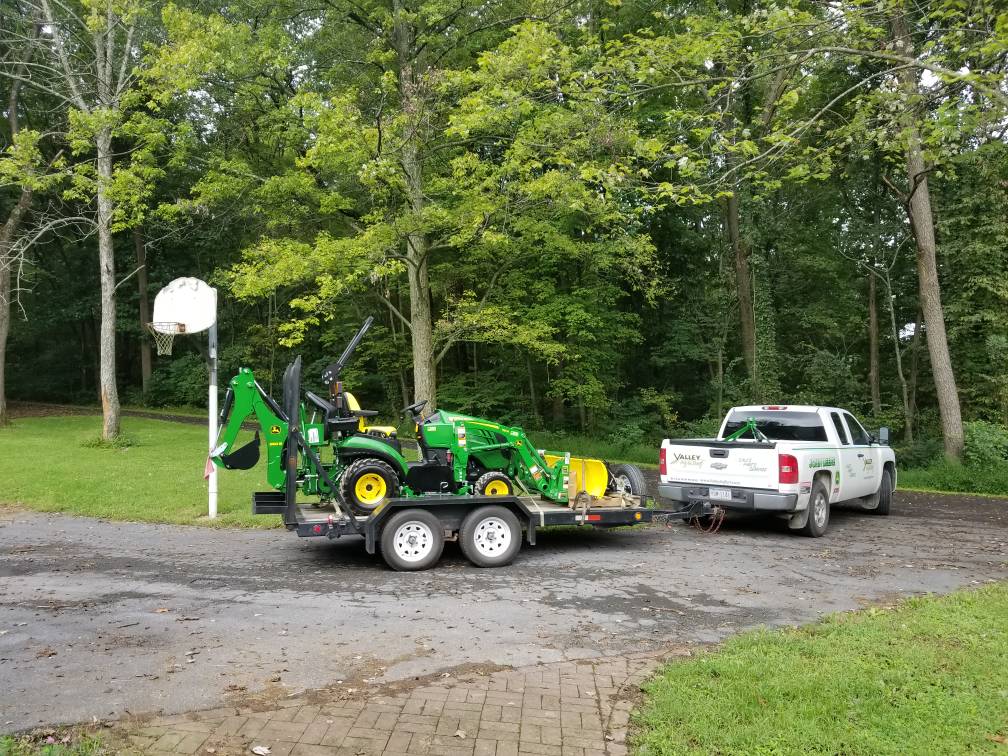

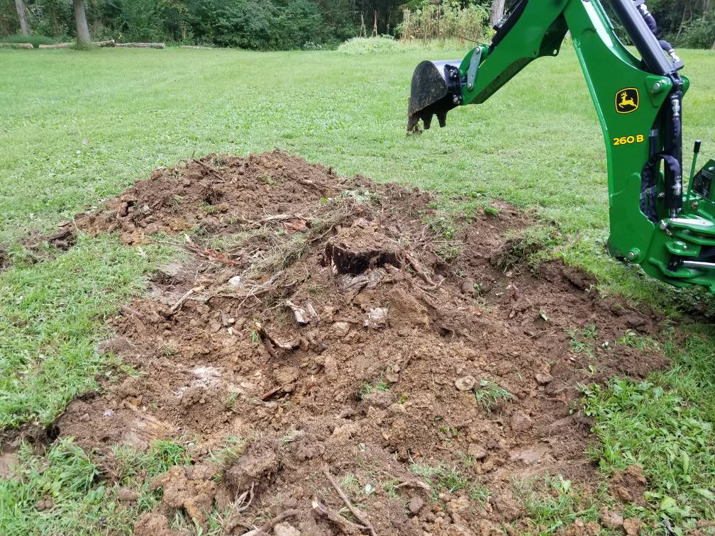

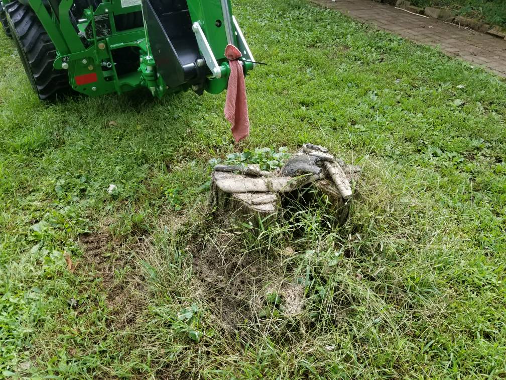

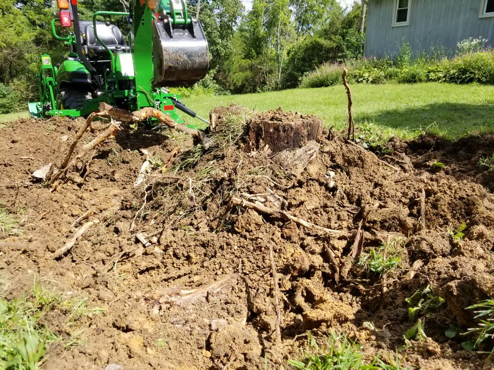

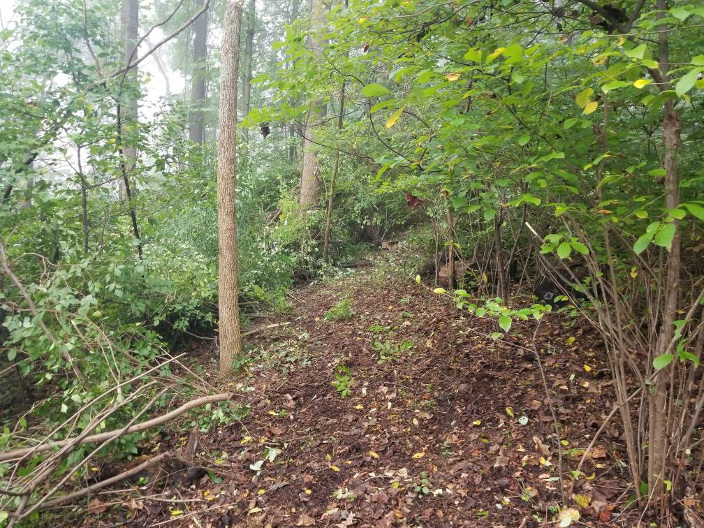

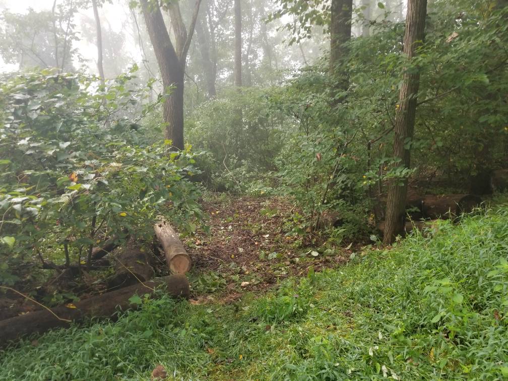

1025R arrived on Saturday sans tiller, grapple and third function hydraulics. Almost immediately set to work on removing a large stump in front of the house.
Also got the lawn mowed and did some unplanned trail blazing after getting stuck in the mud between my sand mound and the woods. We had nothing but rain for about a week straight here in Central Pennsylvania so low lying parts of my yard are still a mucky mess.
Having fun so far but really looking forward to getting the grapple. I think it will make quick work of the brush around my property. My end goal is to clear the bulk of the brush and scraggly trees, leaving only the large healthy trees. I'll also end up moving and replanting some saplings around the property.
Planning to spend some more time tomorrow on the stump.20180915_112403.jpeg20180915_120925.jpeg20180915_133313.jpeg20180915_134517.jpeg20180916_085848.jpeg20180916_085922.jpeg
