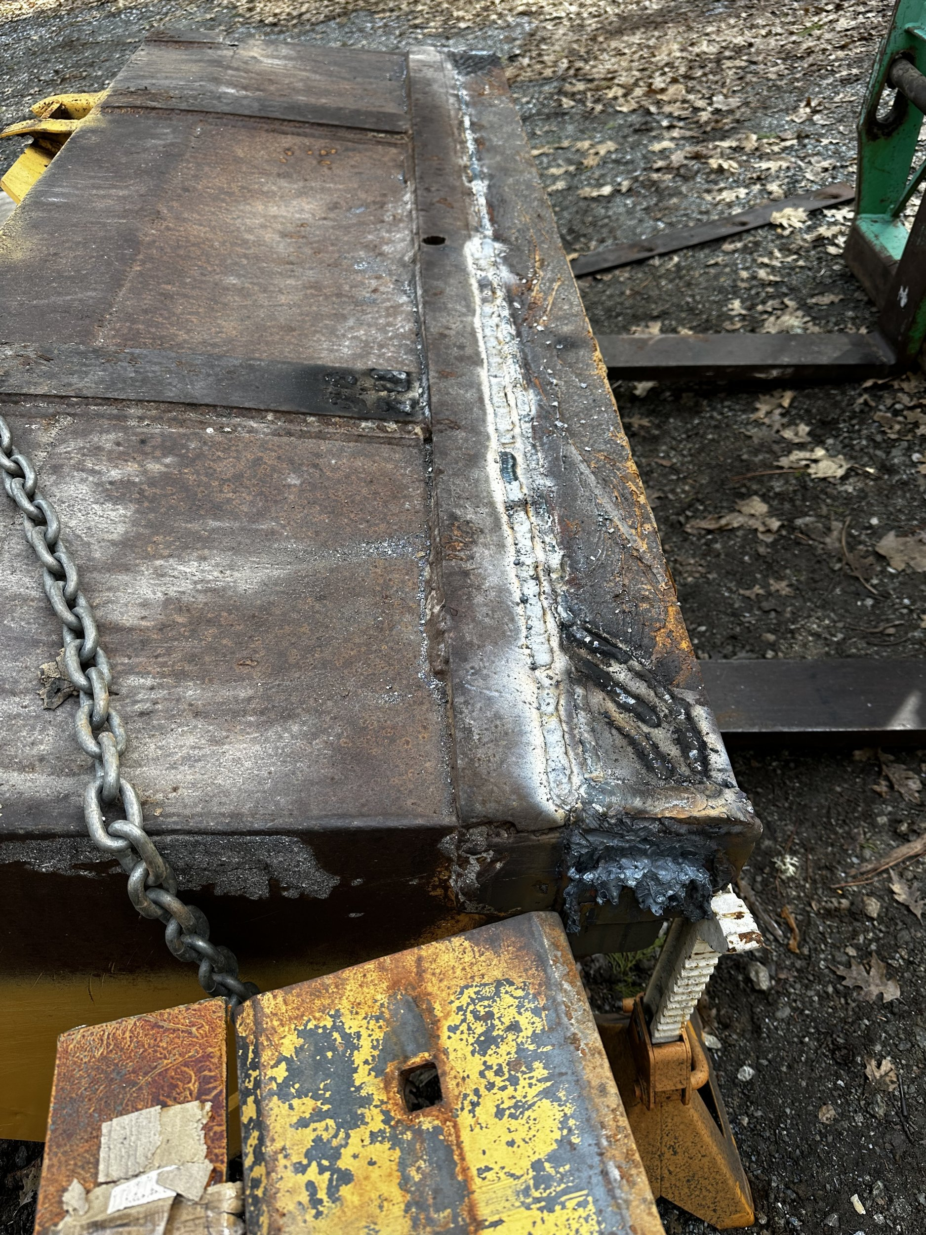

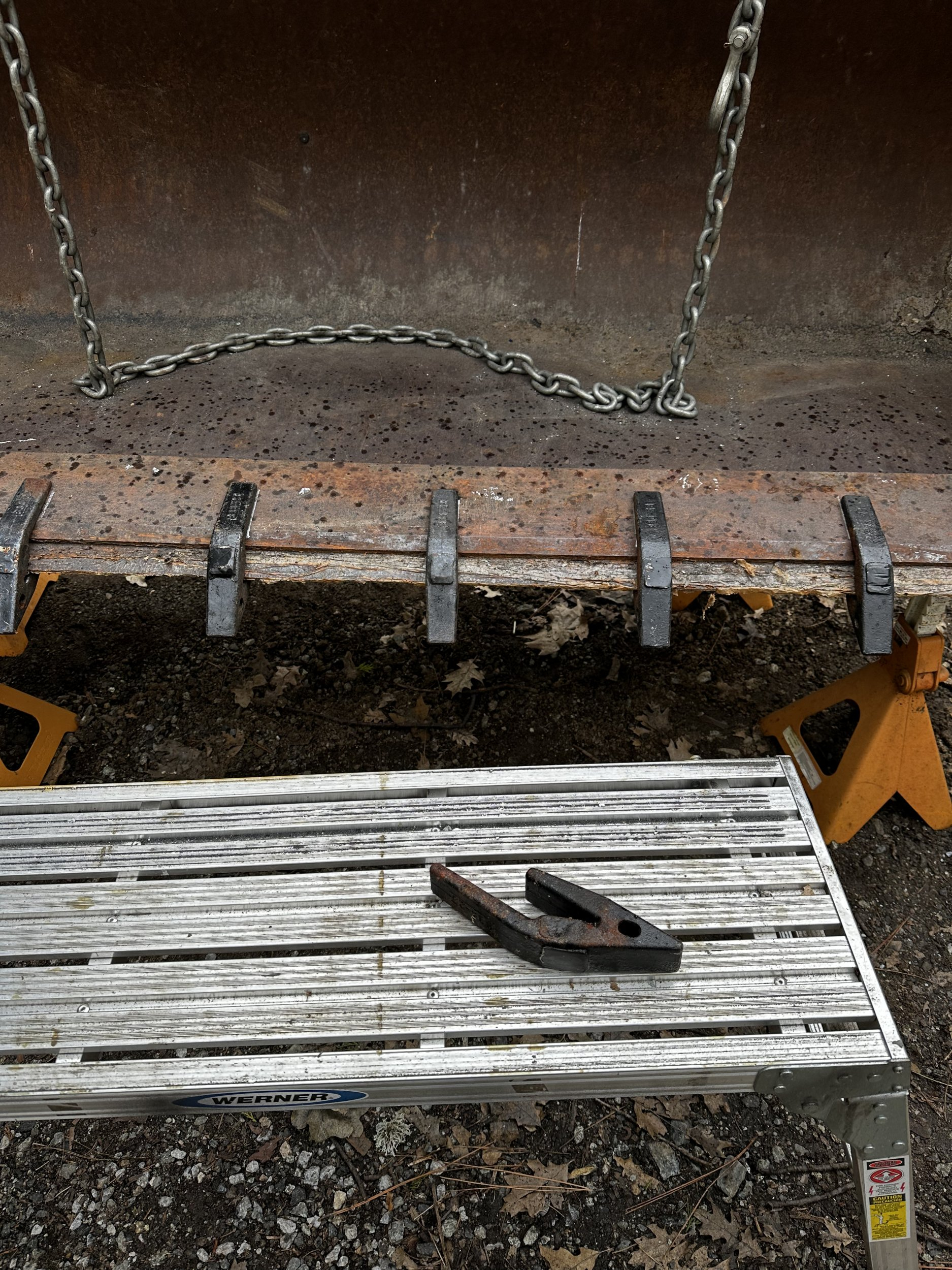

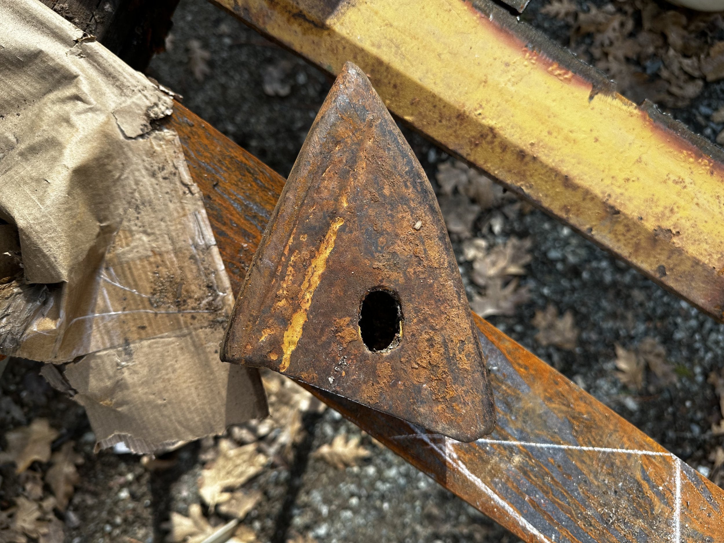

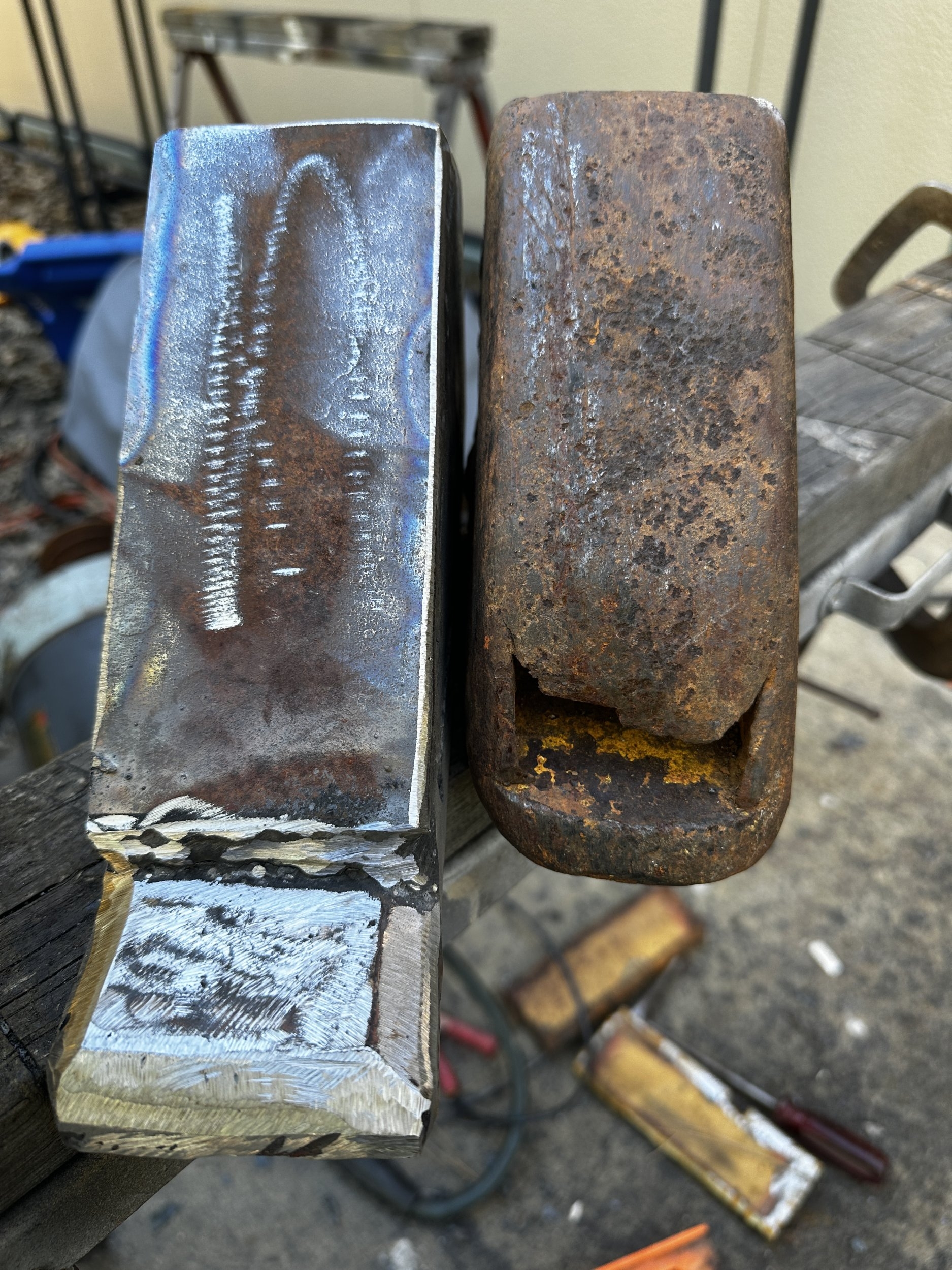

Here is the latest excuse for delayed progress. Road work, vehicle maintenance, helping neighbors stuck in the mud, rain, burning tree limbs collected last year.

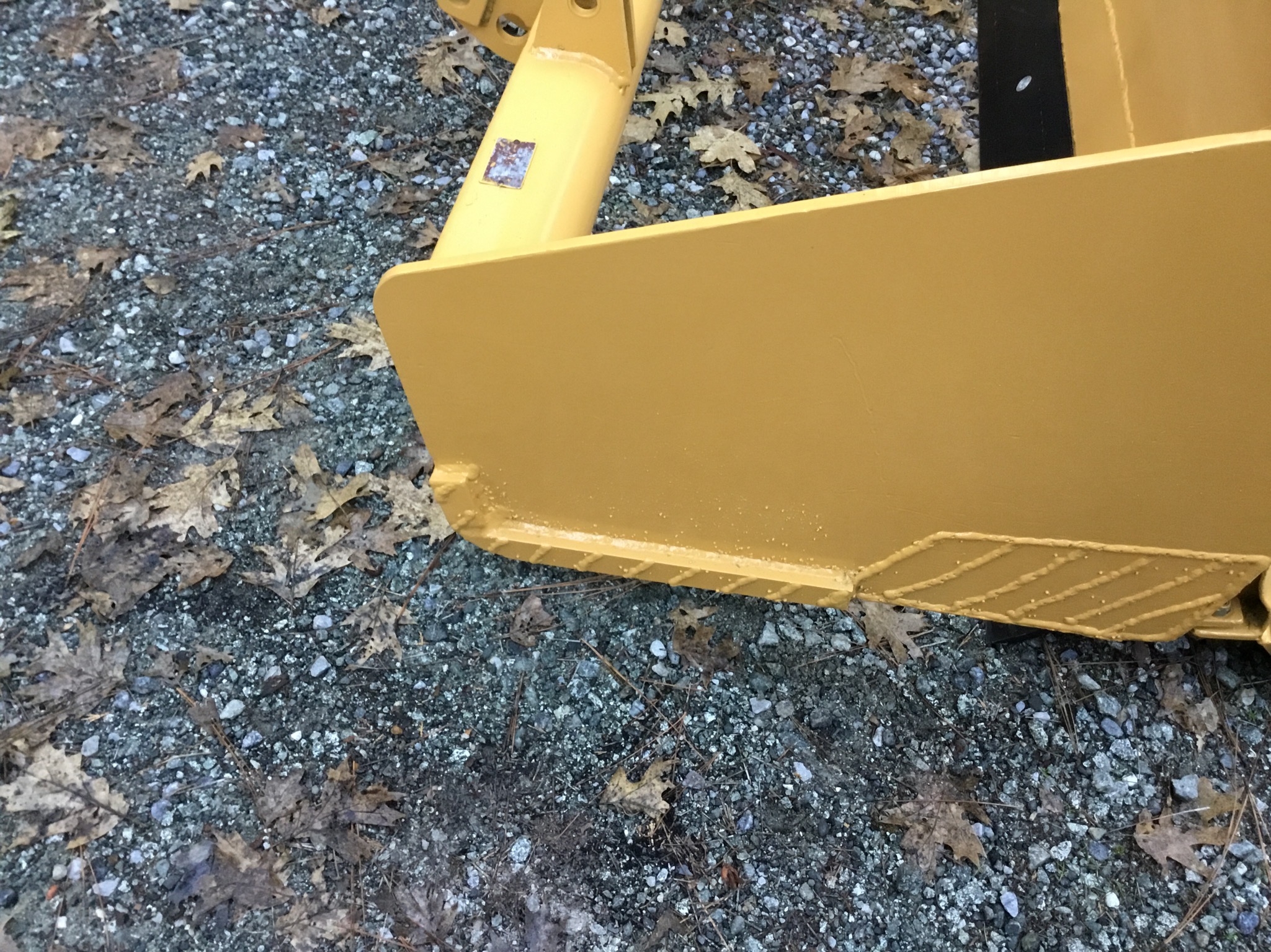

Ok I am cutting some steel to make the three ripper teeth. I am using cutting edge stock to make them. I have a loader/scraper box tractor that I restoed a few years ago shown on this site. I wanted to work on the loader bucket and remove a 3/4” thick large cutting edge and a curved cutting edge from the bucket. That derelict setup made it so the tractor was trying to push a 1.5” surface into whatever one was scooping. It’s only a 10,000 pound tractor. So I am using a portion of the 3/4” material for the extended cutting portion of the tooth and some 1/2” material from another cutting edge I had for the sides. I welded a new cutting edge on the little loader bucket and while I am there I am making a tooth attachment for it. Got rained out again yesterday.

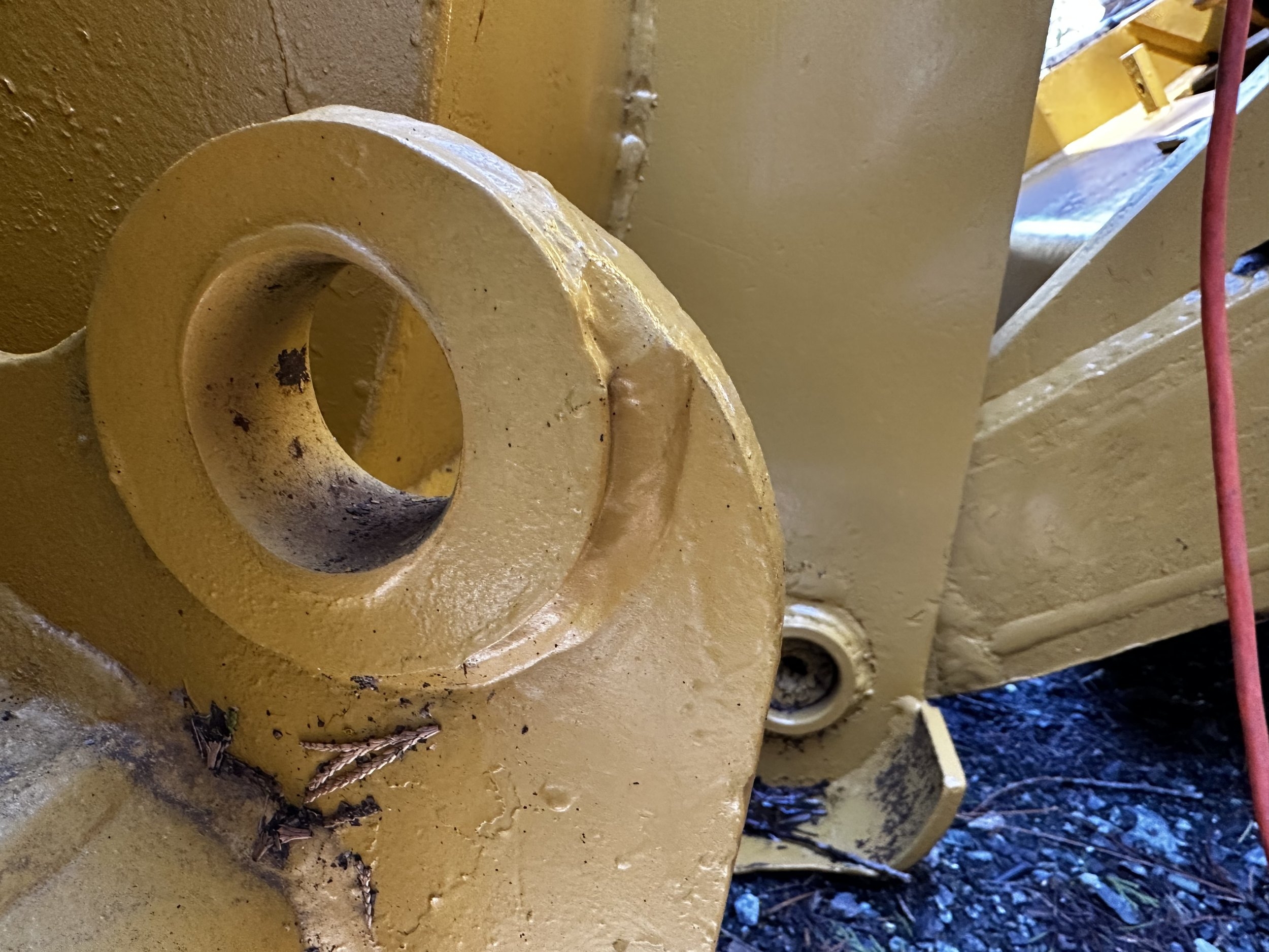

Small update, been busy cutting downed trees from the snow.

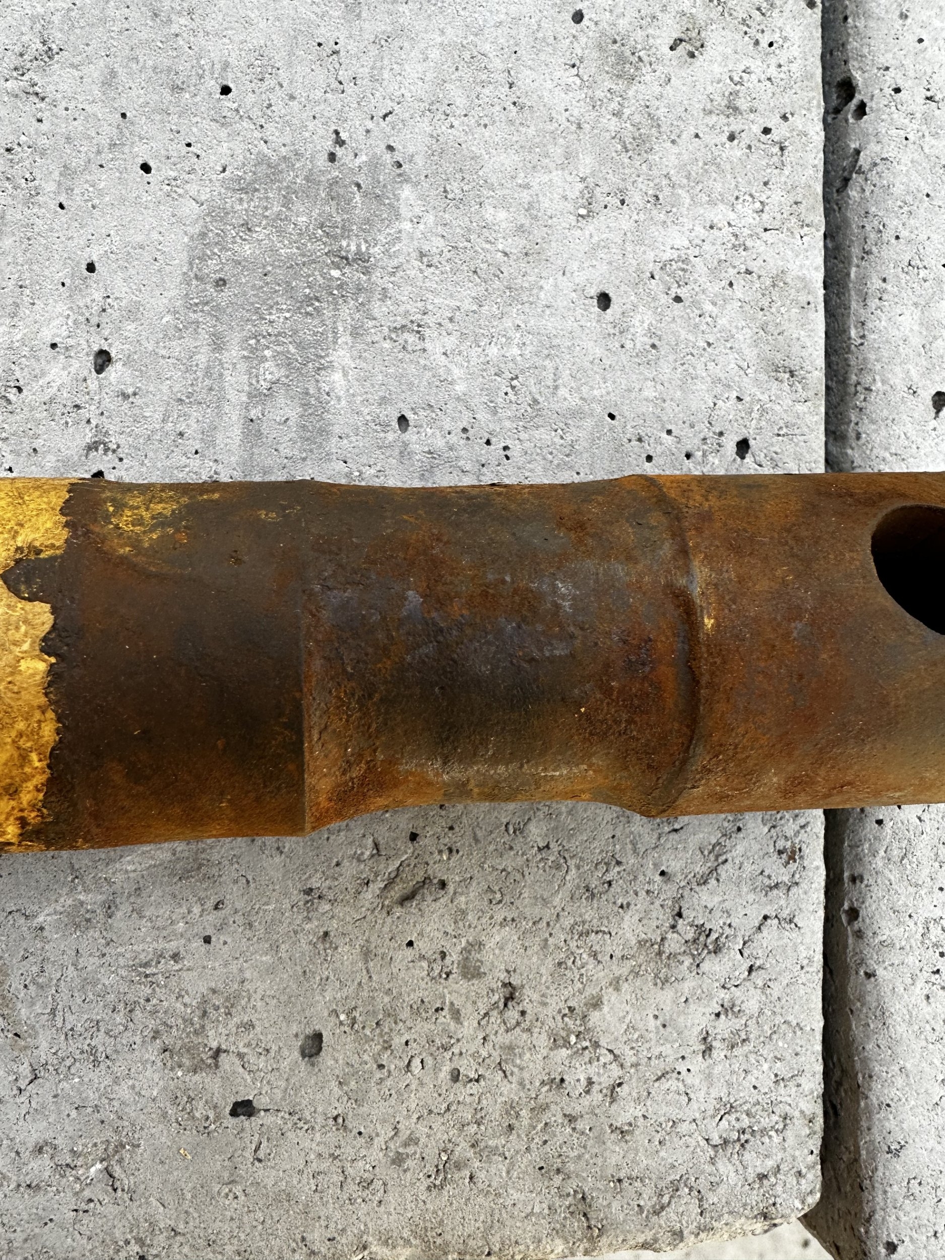

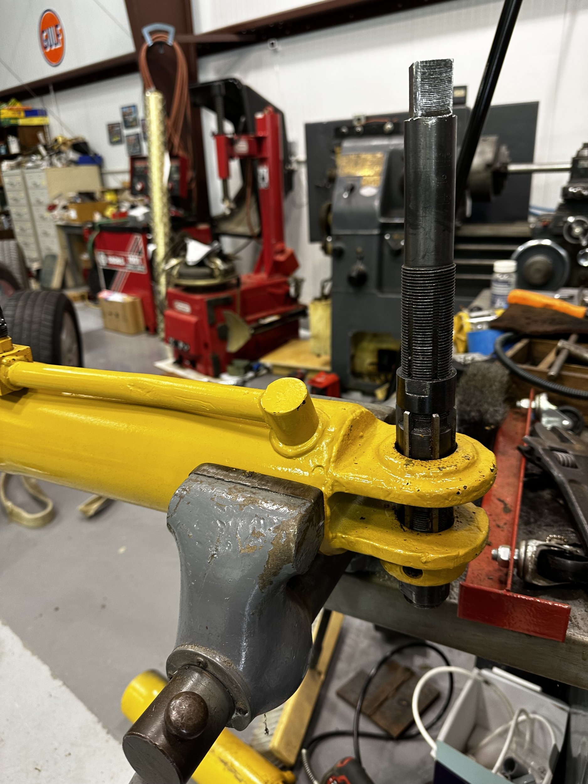

I had some egg shaped holes on the clam cylinders and lower mounts. I used an adjustable hand reamer to make them round then I am going to make some oversized pins.

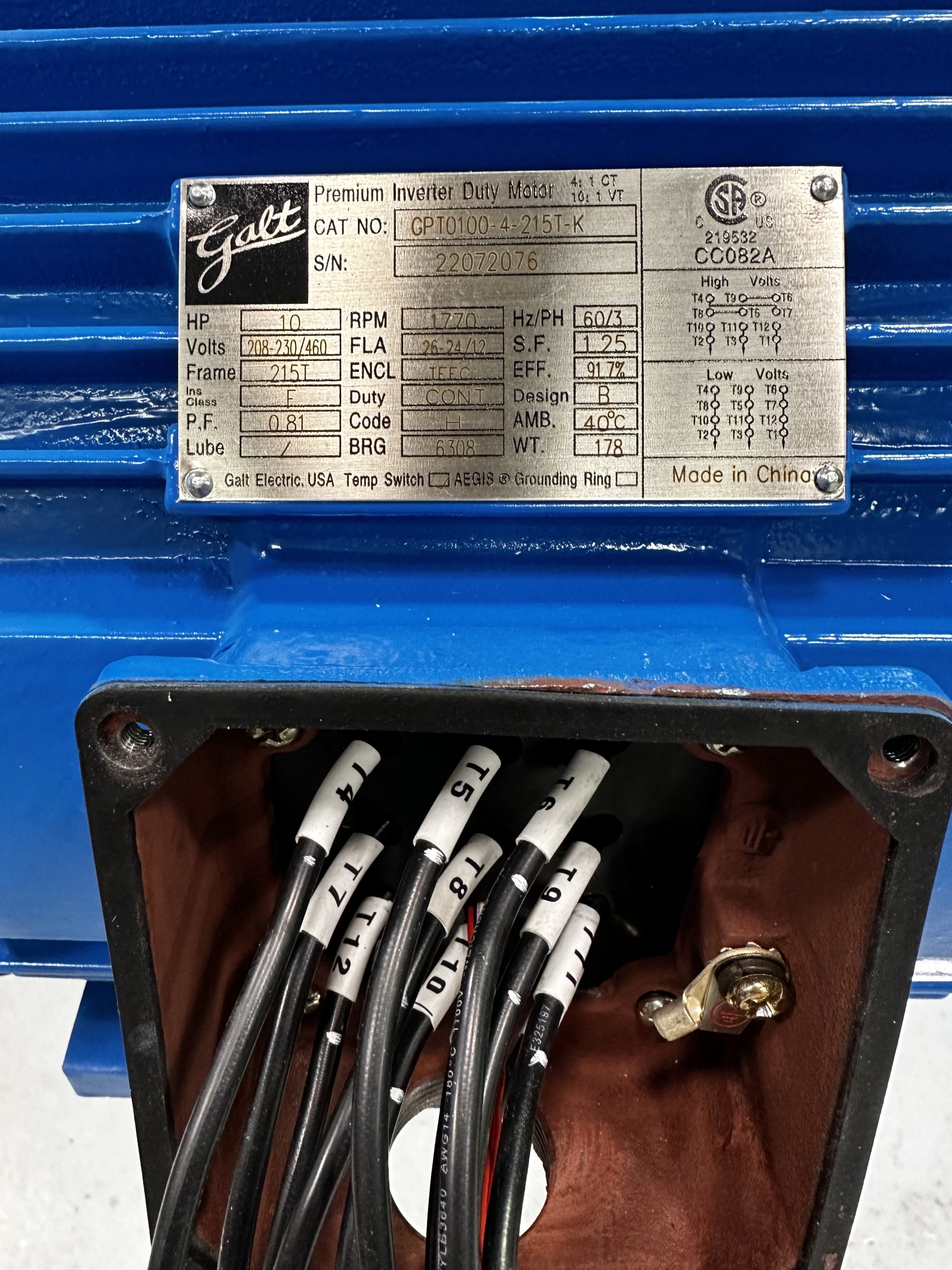

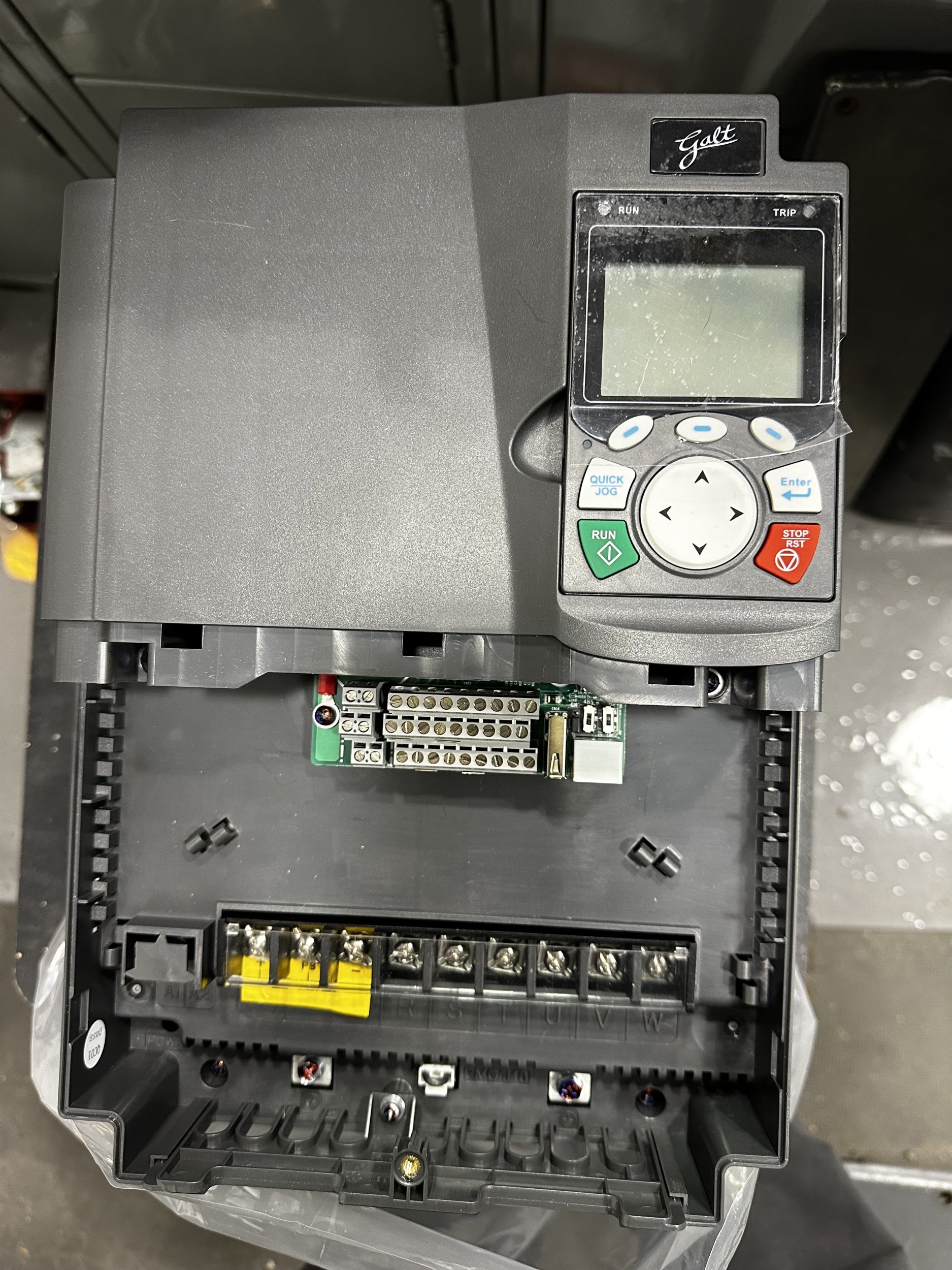

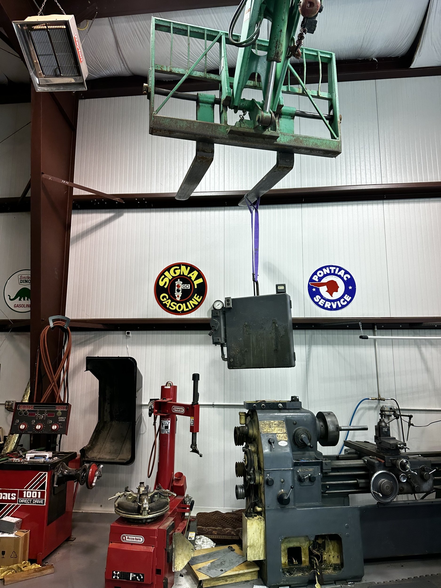

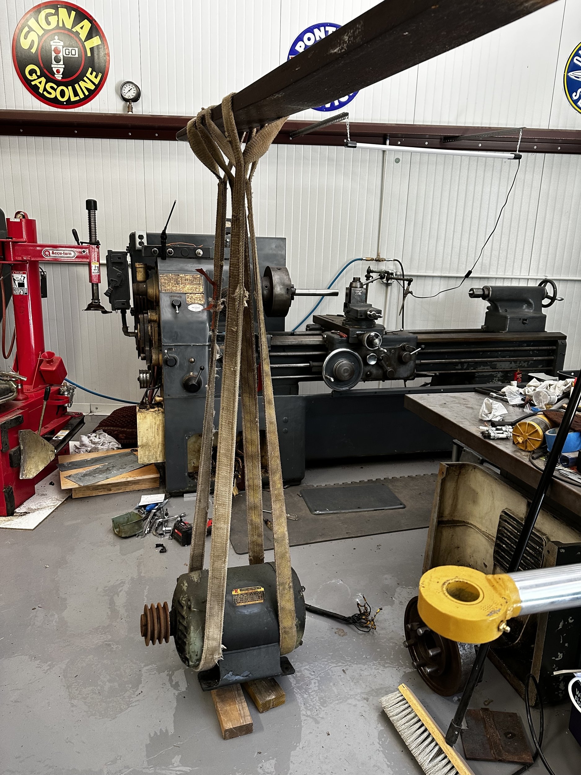

I have my lathe apart replacing the old style electrical system with a VFD. I had to change the motor for one with better insulation to handle the VFD and a braking resistor. The motor had a different mounting so I had to make a mount adapter.

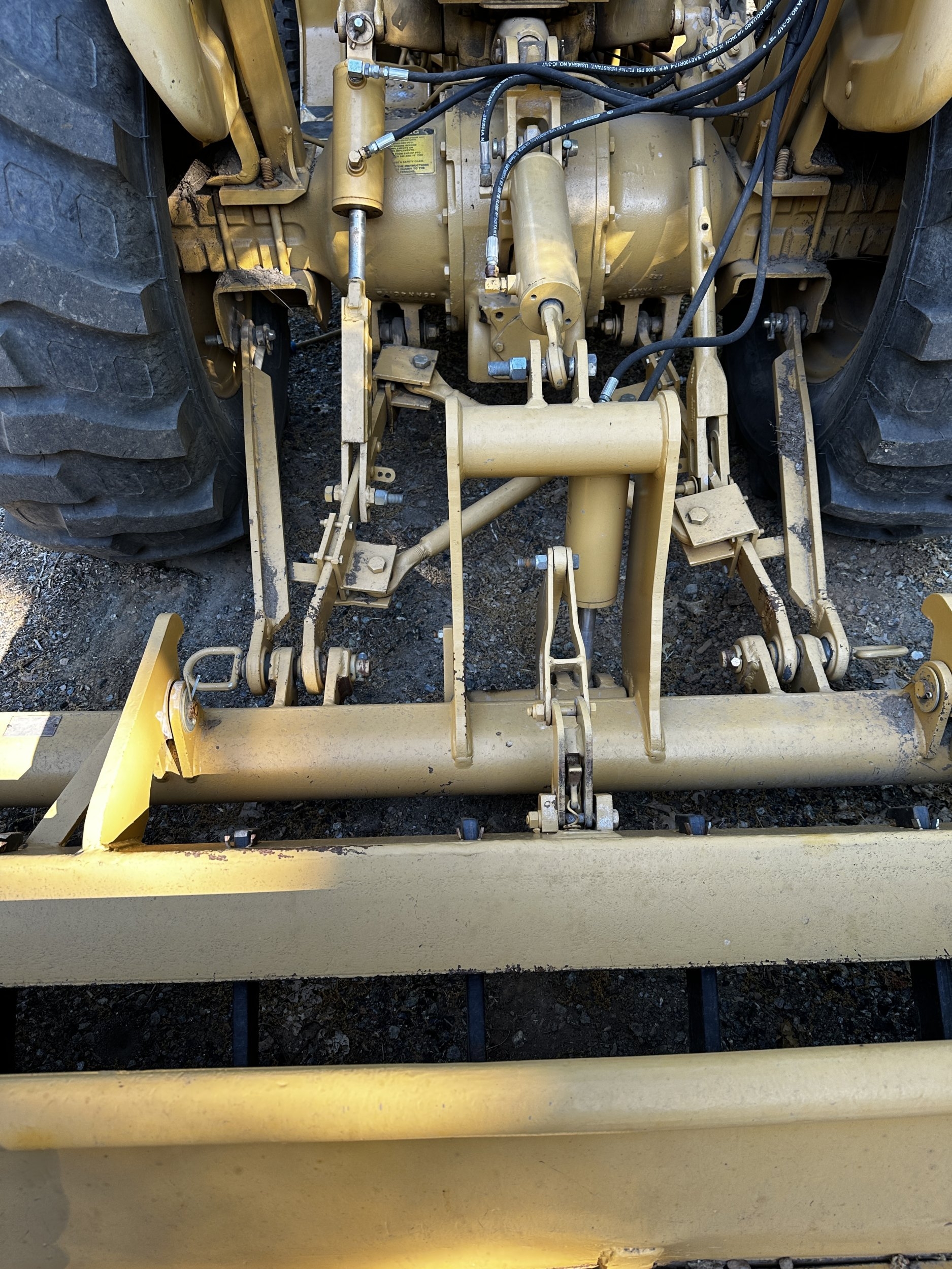

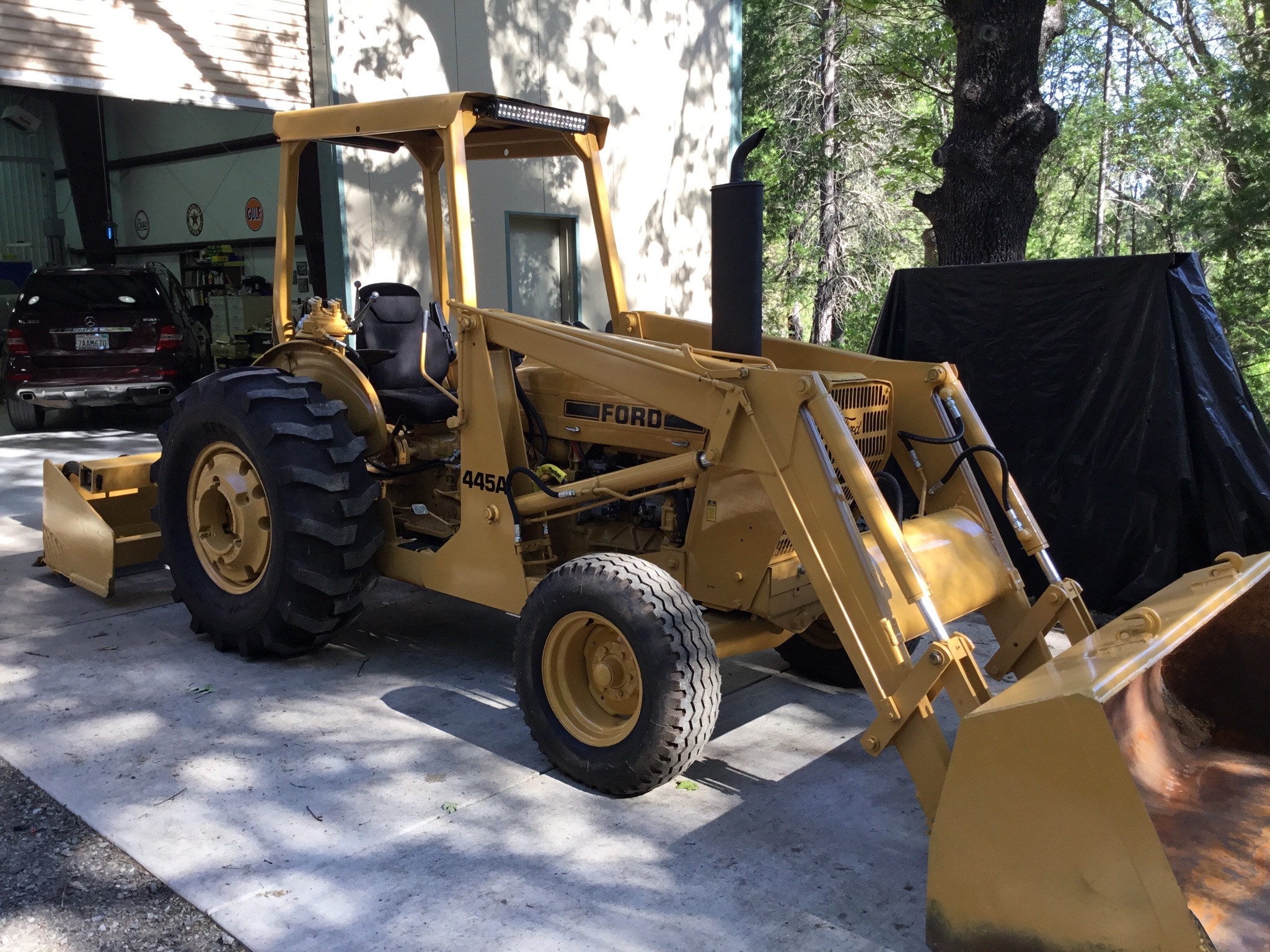

Not yet. But I do plan to do some work on a previous restoration that wasn’t finished.
This is the order of the plan.
1. Clean the shop, organize too.
2. Rebuild the engine on my 445A Ford loader/scraper. Replace one of the two hydraulic pumps and replace seals in the three point hitch.

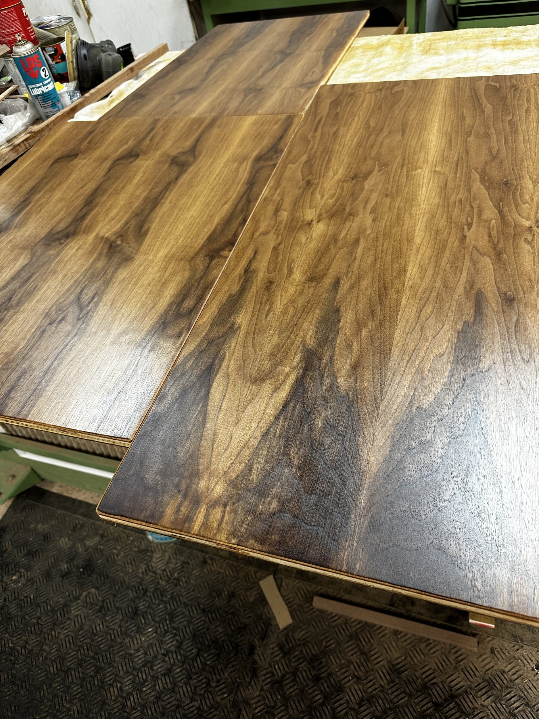

3. Make the rest of the interior doors for my house ( making two right now)
4. Decide on which two other vehicles for restoration sitting around here.

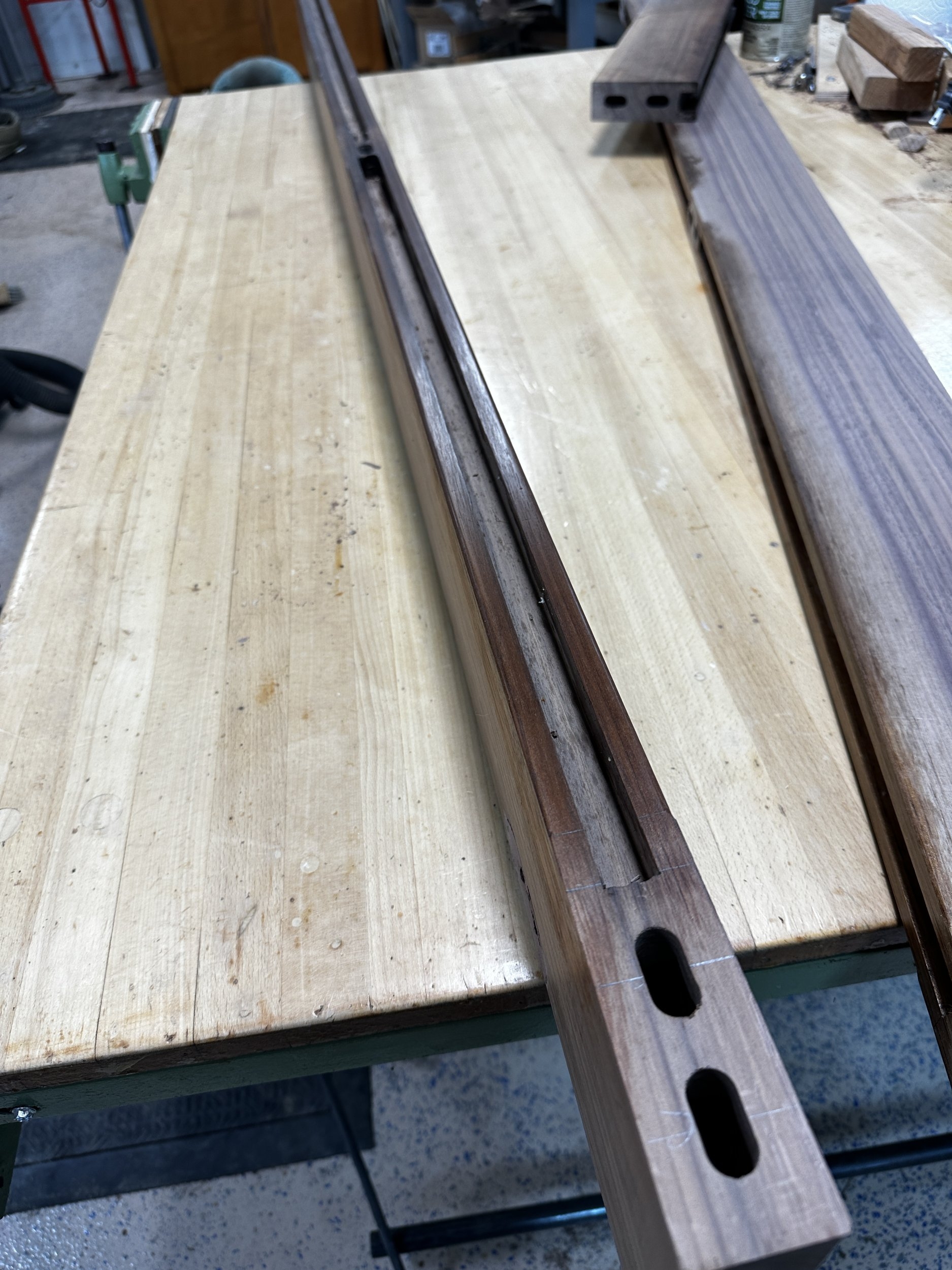

A few of the 445A and a heavy duty scraper box attachment. A couple of doors in process using 10 applications on each side of hand rubbed oil I get from the UK.

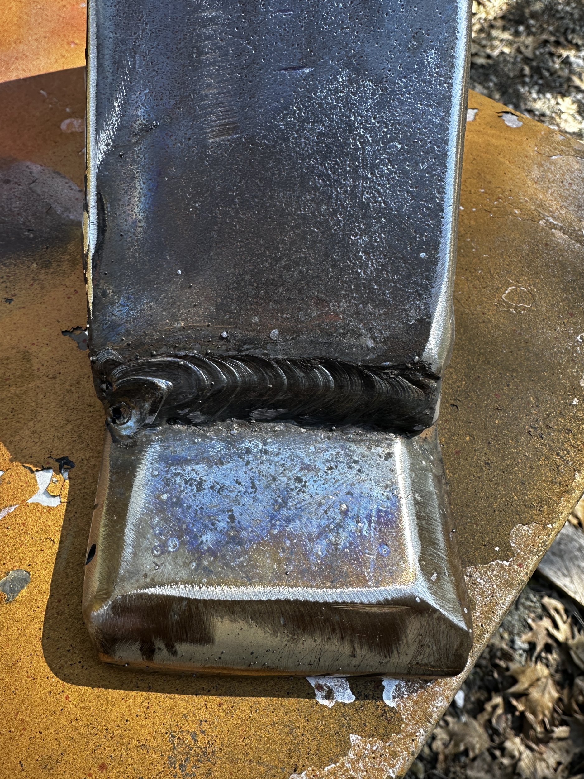

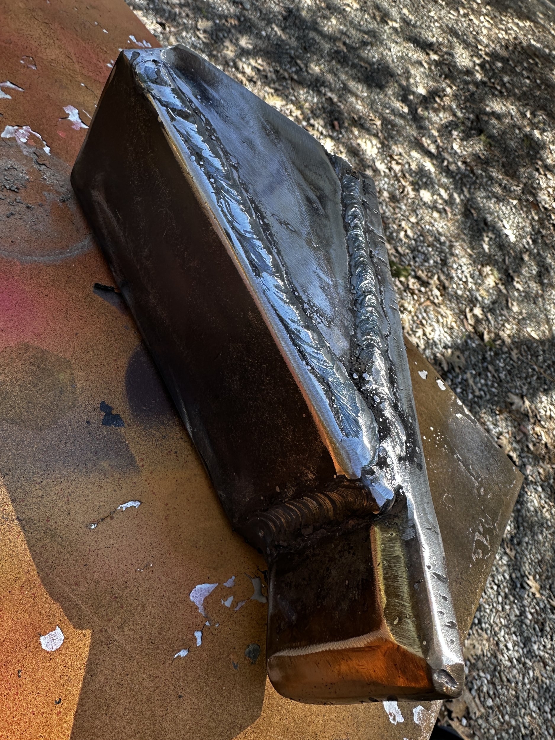

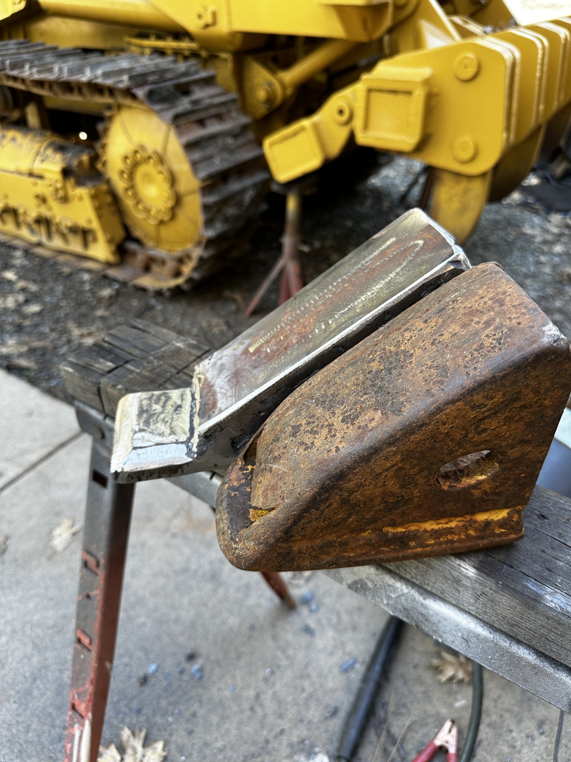

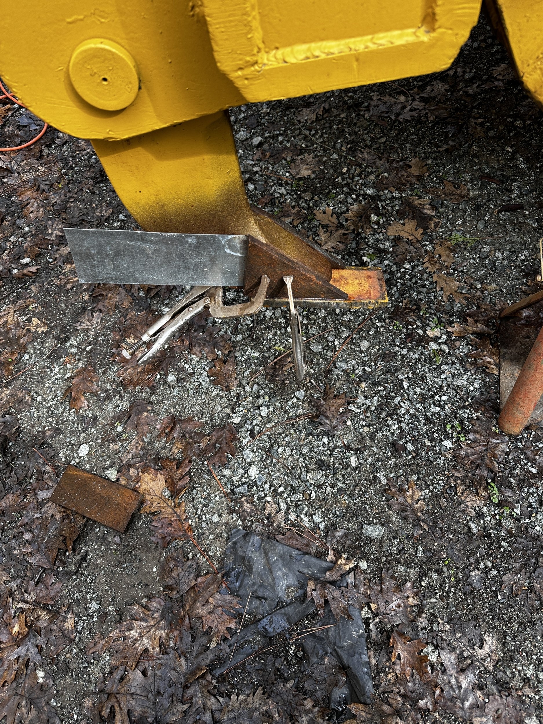

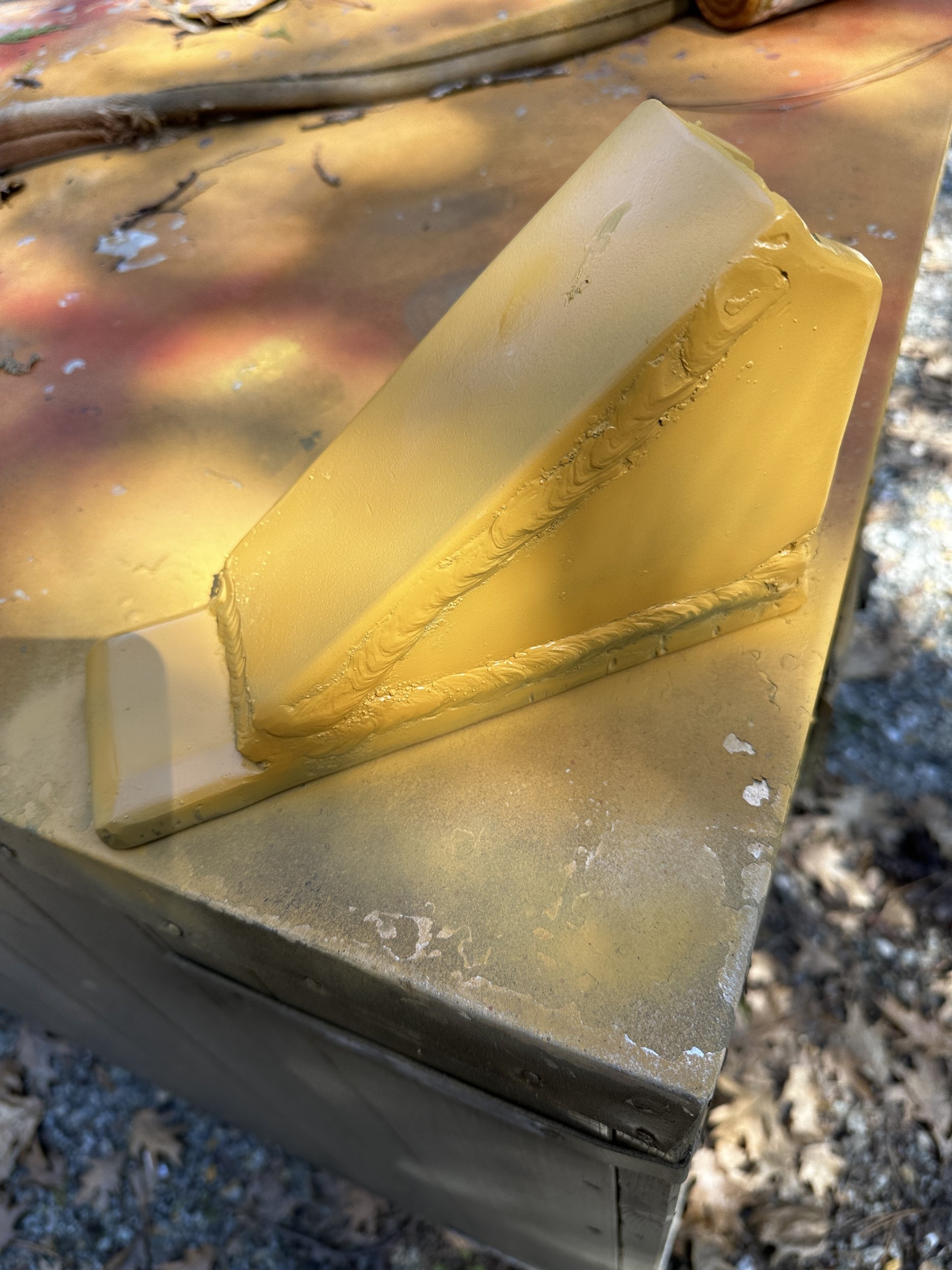

Finally getting back to the Massey. I decided to resume by starting with the ripper teeth. I don’t like to do heavy welding and grinding outside once it dries out.
I am making each one separately directly from the shank because someone has used the ripper with two teeth missing. While they may interchange I will never wear them out around my little place. They are fairly thick with the bottom being .75” and the sides and the top being .5”. Since the material is cutting edge stock it isn’t easy to grind. I weld them with my Ln-25 pro feeder. I have a few more things to finish on my lathe VFD programming and reversing switch then I can make the clam cylinder pins.
