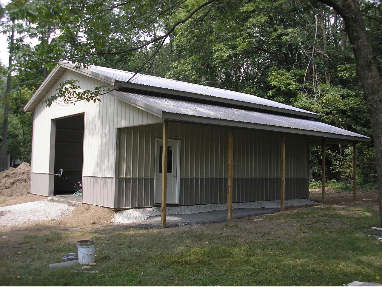

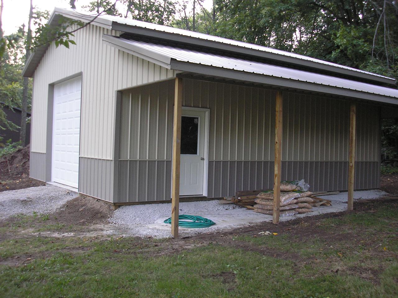

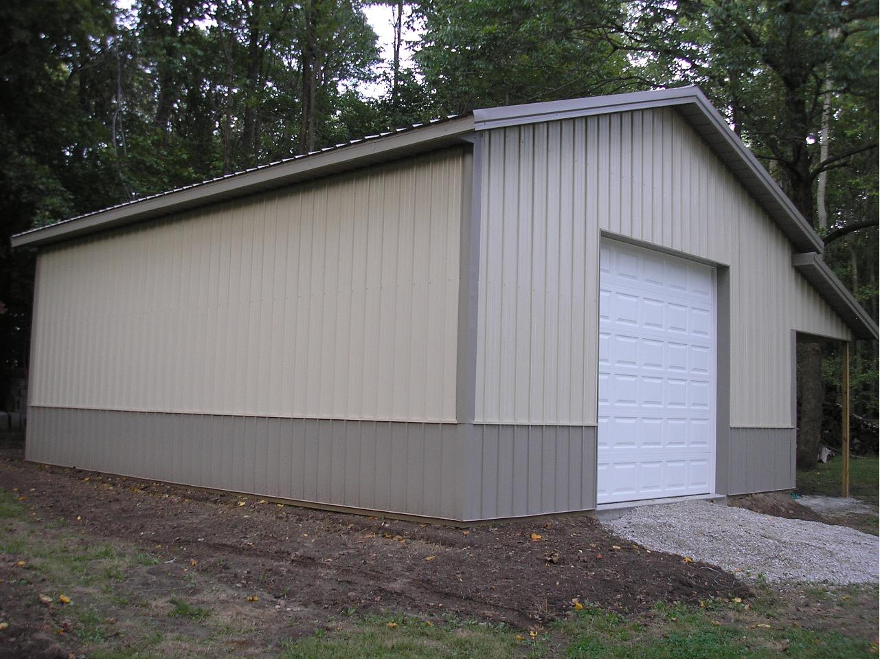

Finally got around to taking pictures of the finished barn, Last week I got the floor sealed and I started pricing my electrical service to the barn, thanks to this great site and others who posted on there wiring questions.

I love it! Very similar to mine, only nicer looking :cool:

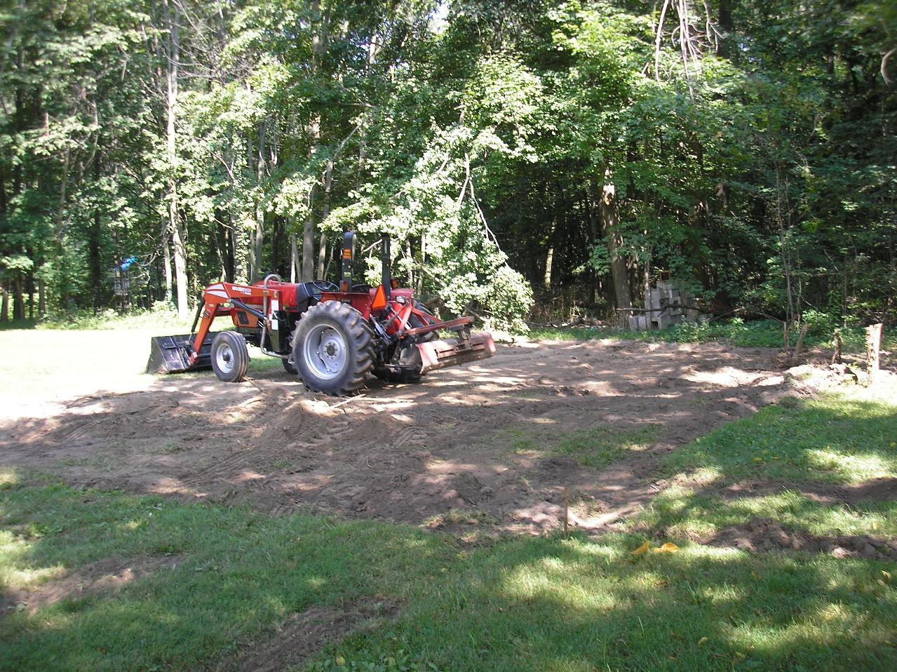

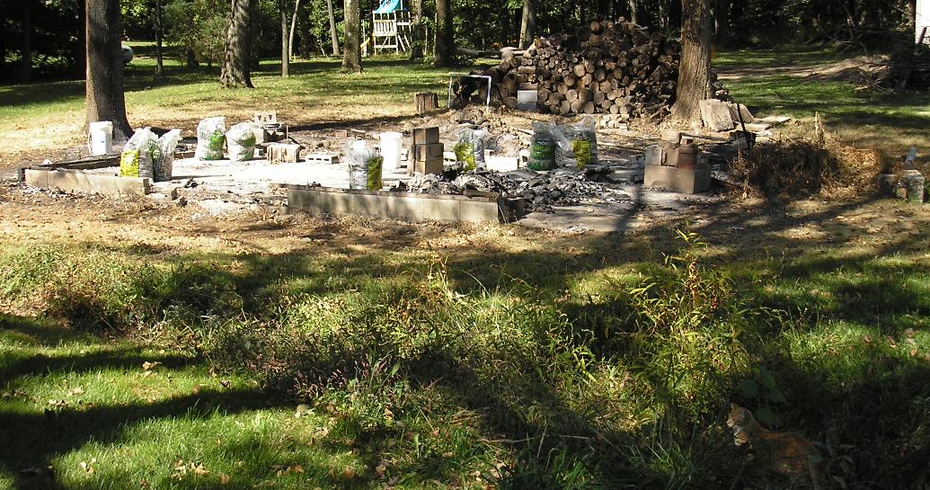

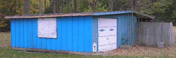

I started tearing down my old shed (picture 1)
and ended up burning it to the ground (sorry no pictures)

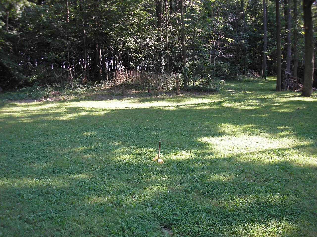

Then i cleaned up the slab (picture 2)

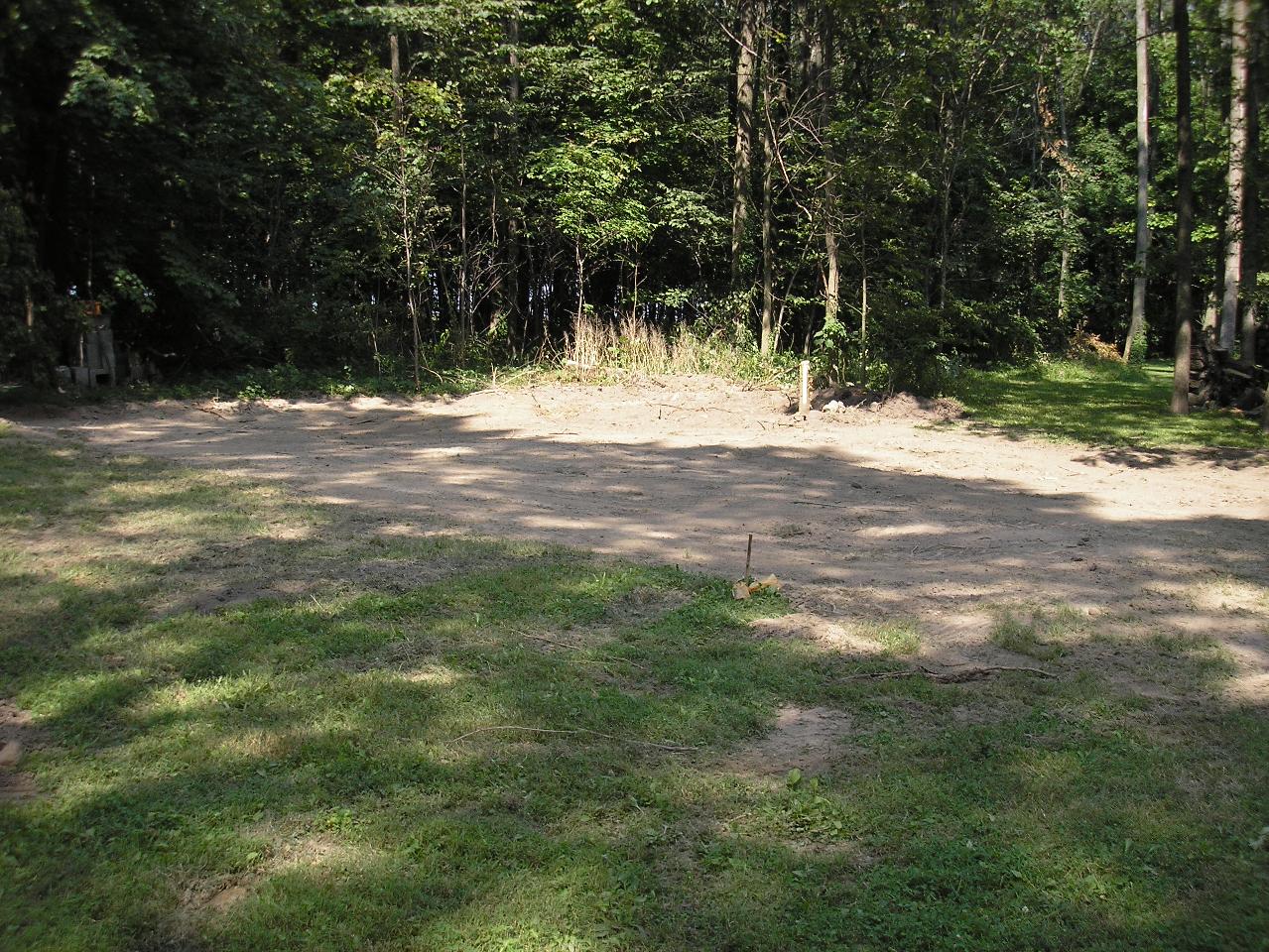

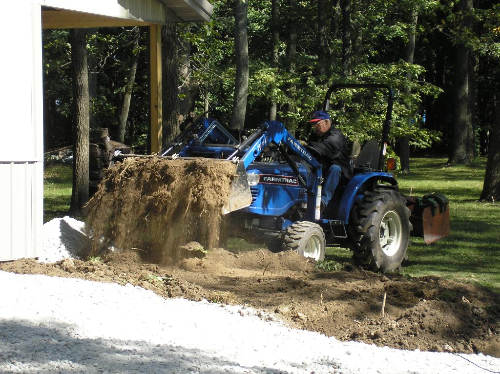

oct 4th a friend of mine came over and brought his tractor, we moved 15 tons of 53's and the pile of dirt from excavation. (picture 3)

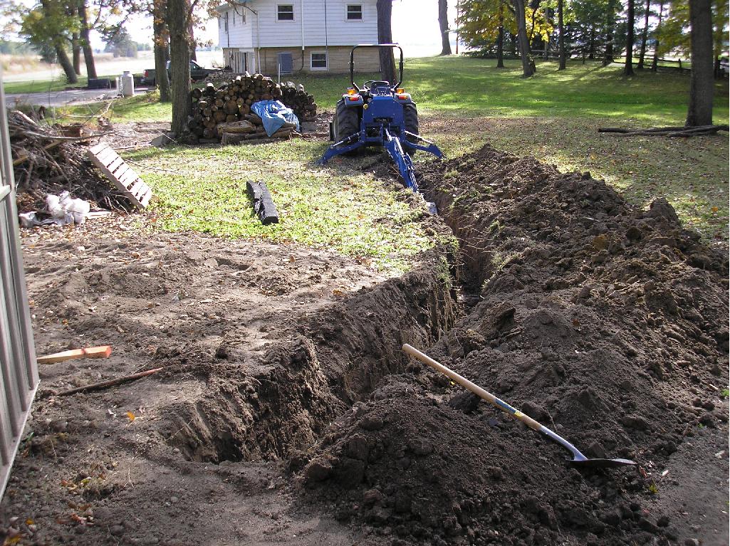

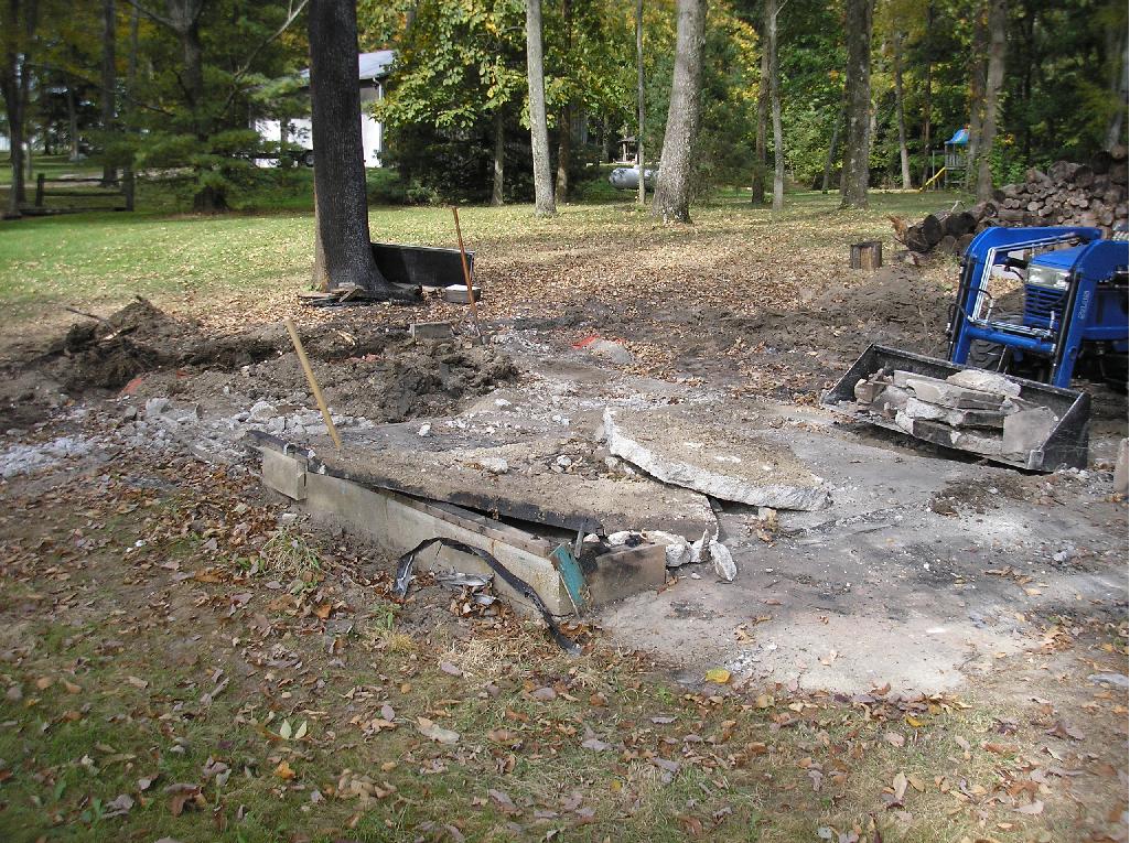

then monday i rented a TBL do tear out my slab (picture 4) and dig my trench (Picture 5) for power and water.

when digging with the back hoe don't let the tractor fall into the trench.
I started at the barn and dug a ways then turned around and started at the house, while i was digging i realized i would have to drive over the trench already dug to complete the trench. I was digging along great each time pushing the tractor back with the hoe. I wasn;t watching and the left tires fell into the trench and there i was sitting at an angle, I tried using the hoe to reposition my self but i was tired and it was now dark out.
(sorry no pictures)
Tuesday morning i got up at the first light, i only had an hour or so before i had to return it, I got a railroad tie under the bucket and was able to push the front wheels out, i then placed boards accross the trench and set the wheel down on it, and then using the boom and right outrigger together i was able to pick the back end up and place boards under it. I then slowly picked the back up and inched it over untill the rear tires were on solid ground, i placed more boards over the trench and drove it out. in all i was impressed that it only took maybe 20 minutes to do.
Overall i was really impressed by the backhoe, It dug great and could move the machine pritty easy.
