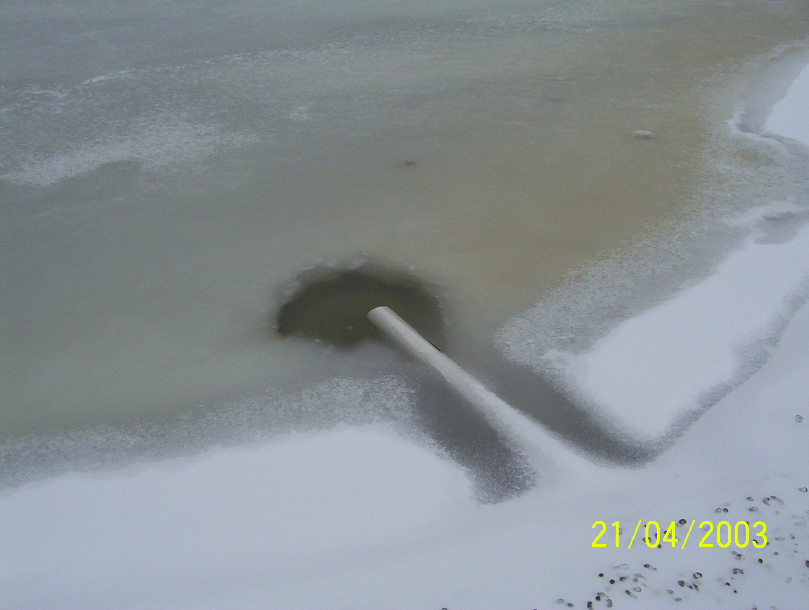

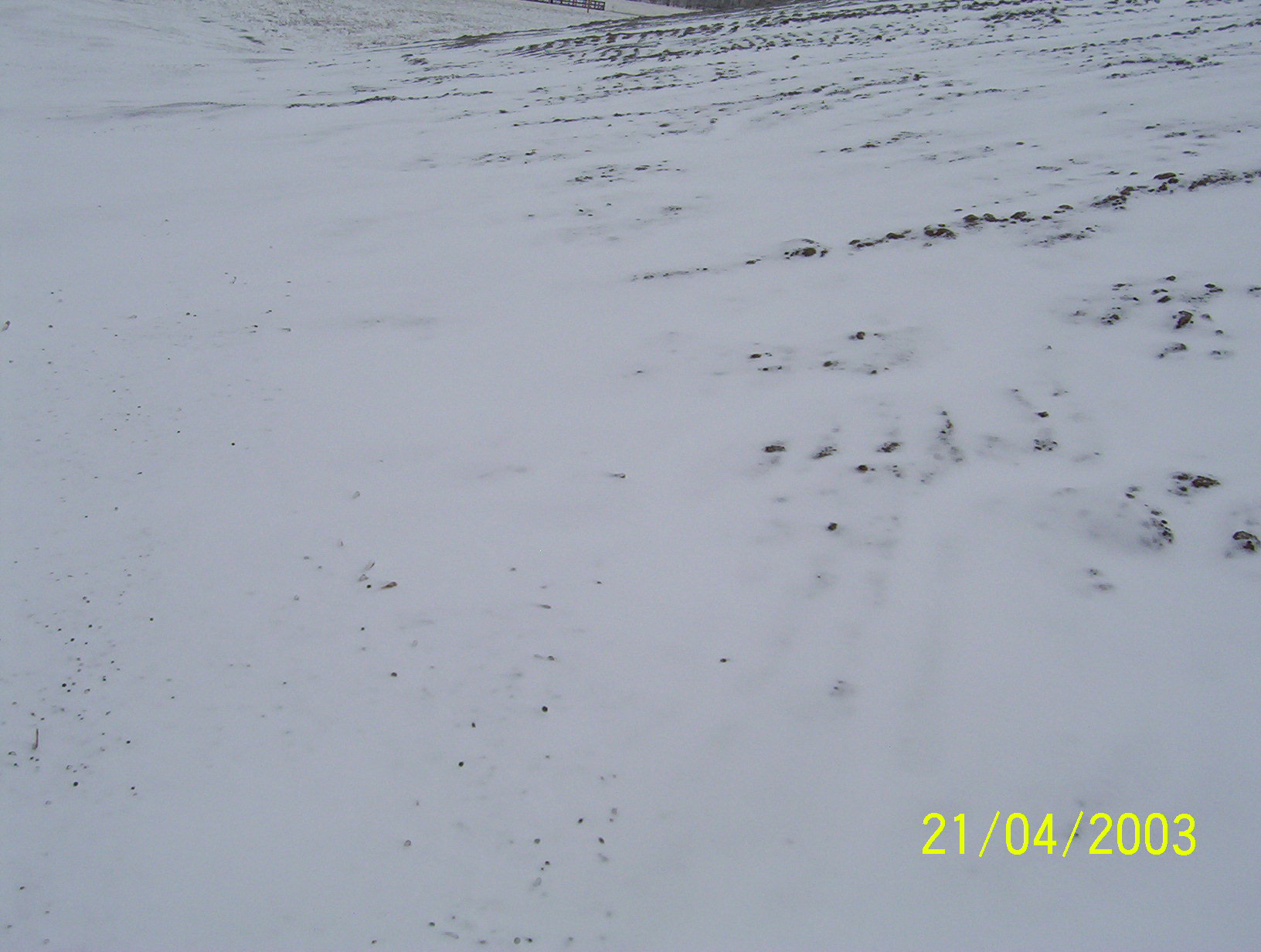

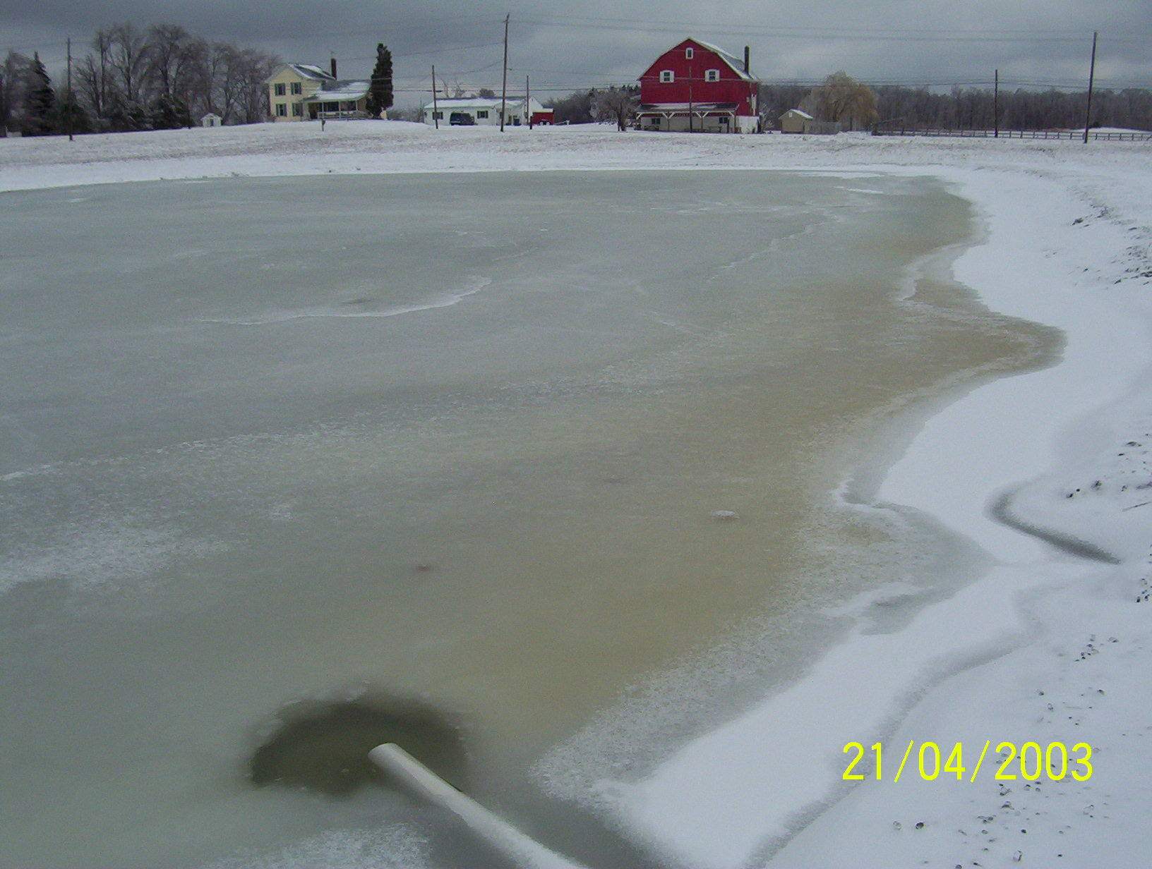

Well I went out today to take some pictures,,, and after just 4 pics, the memory card read full. So, this all I could come up with for you guys. The pic of the entire pond, is from up on the hill. Then took a few of the overflow pipe, which is still running at full tilt. Then of where the hill ties into the pond bank. Can't wait for summer to get here, and get the peddle boats out there !!:)

Yeah Toro,, the clay hill is pretty big. Would be an excellent sledding hill,,, except that you'd end up in the pond. LOL Sure makes for a great observation point up there though!! :D

I'm concerned about your overflow pipe. First of all it looks inadequate. What size is it? What happens during a very heavy downpour. Around here the standpipe is sized based on the size of the pond. You also must have an emergency overflow in case the pipe can't handle the flow.
The pipe is also vertical with a screen over the top so it can't be stopped up by leaves, etc... I have a feeling that you'll have problems keeping the fish in your pond, as they can swim out the pipe when the pond is full.
We have a 1 acre pond that averages about 6' deep. Our standpipe is 10" necked down to a 4" pipe going through the dam at the base. We then have two 24" diameter pipes 1' about the standpipe that go through the dam as an emergency overlow.

Hi Chris,
Thanks for the input, and compliments!! Not sure on the pipe, the contractor laid it in there. I know its either a 4'' or 6''. We've had a tremendous amount of water already this winter with the heavy rains,, and snows, melting,,ice etc... so far its doing its job. "crosses fingers":rolleyes: Actually, ya know I never thought about this fish swimming out the pipe,, thats a pretty good point!! I think I'm gonna make it like yours with the bigger standpipe & some type of screen or grating.

Hey there, nice looking pond.
Is that "road" still running through the middle of the pond just under the ice? It seems like that could be a problem in August when your pond level drops a couple feet. You dont want your pond cut in half every summer.

LOL,, yeah the shallow hump is still there. Actually, that was a cost saving move, because obviously the more dirt the contractor had to push, the higher the cost. So we settled on that design with the intentions of using it as a shallow swimming area. Plus I figured if it presents a problem, I can always have a trackhoe dig the rest of it out. But, it's 6 foot in the middle, so hopefully we'll be ok.

One thought I had is it may present a problem if you decide to stock the pond with fish. When the pond water is close to 90 degrees in August and there is only a foot or two of water over that shallow area the fish may not want to go back and forth. It may make the temperature of your overall pond a little higher.
Of course it may also help, fish are hard to predict. Anyways enjoy
