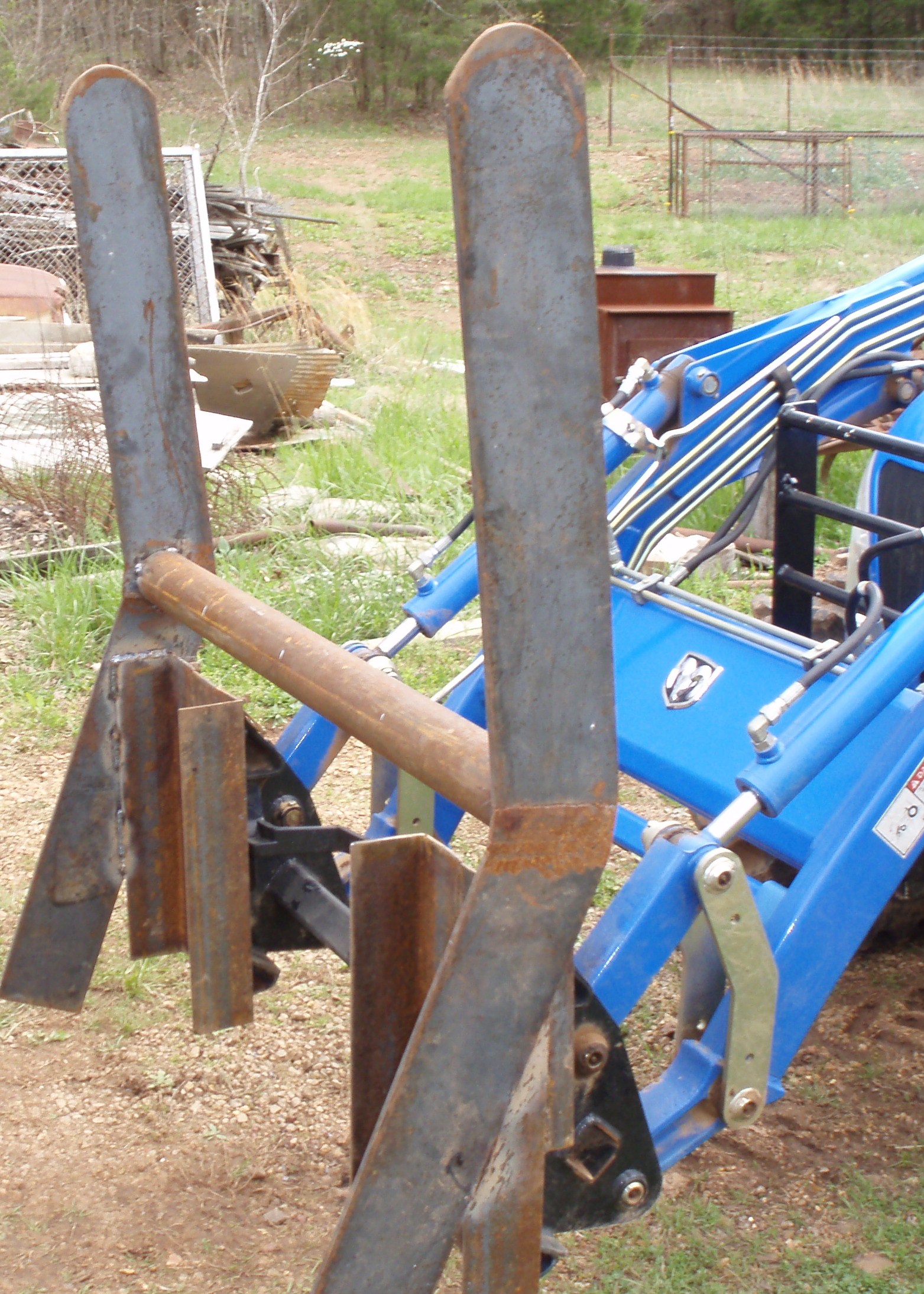

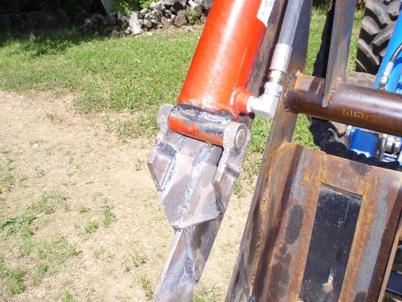

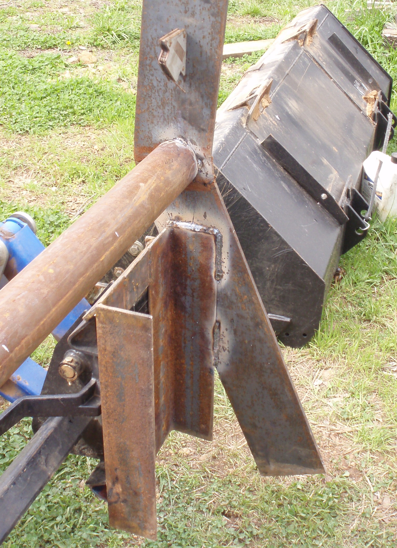

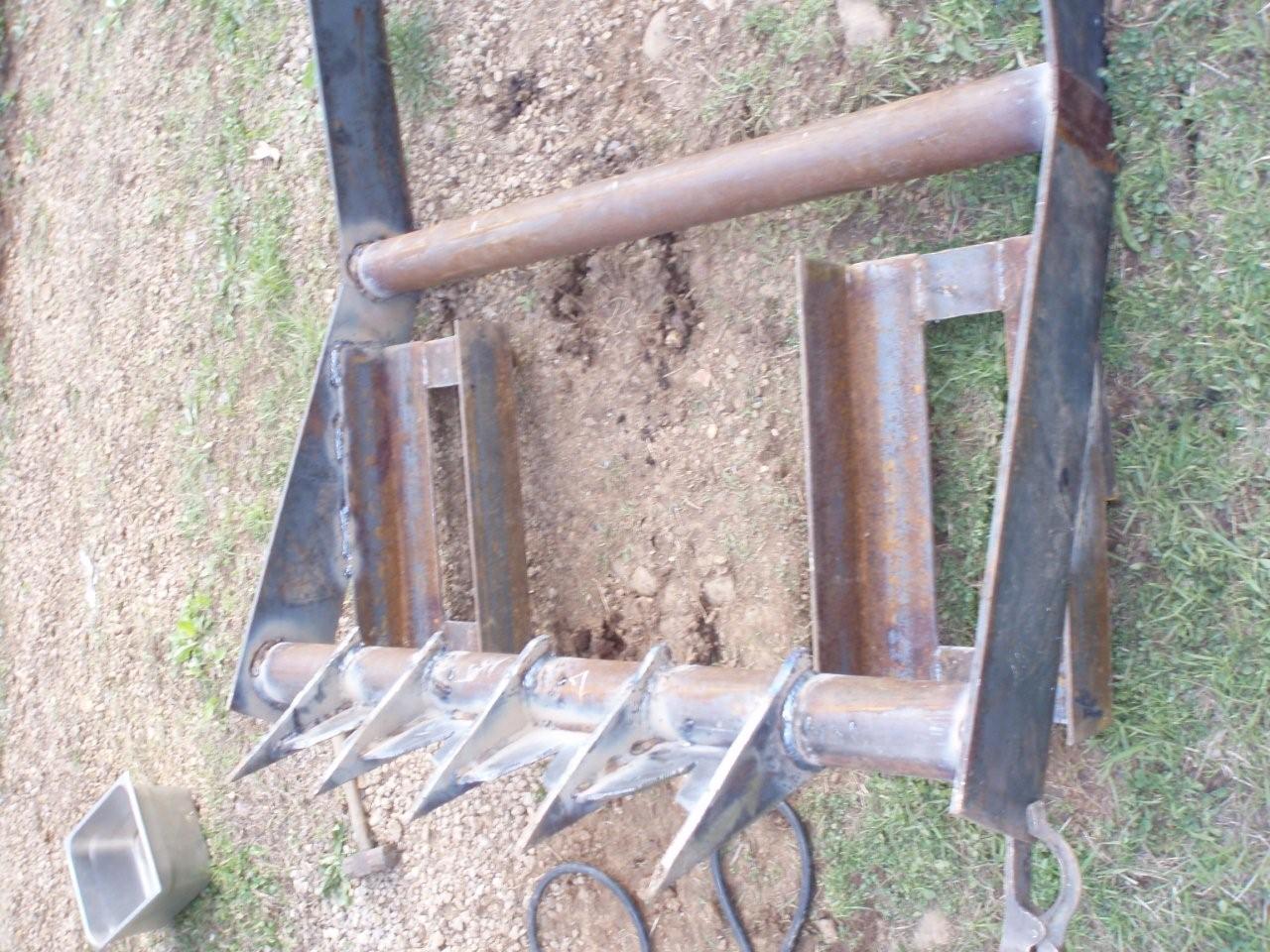

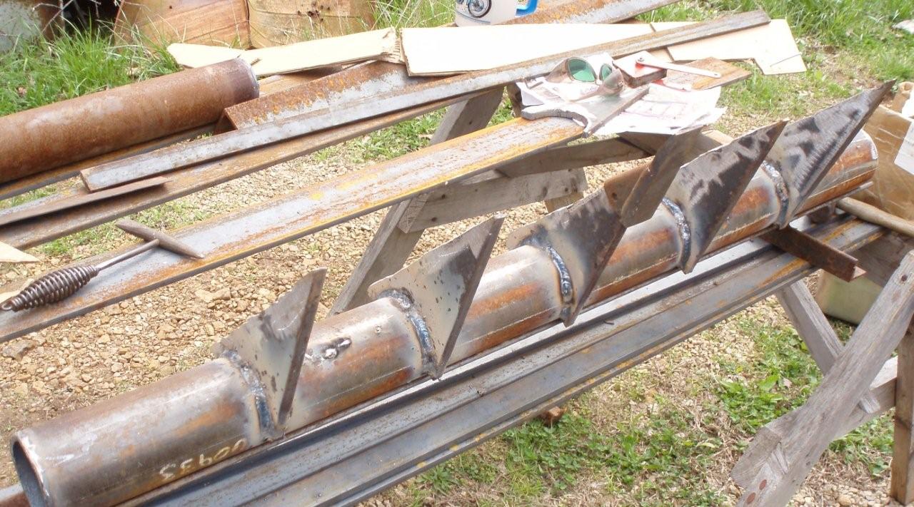

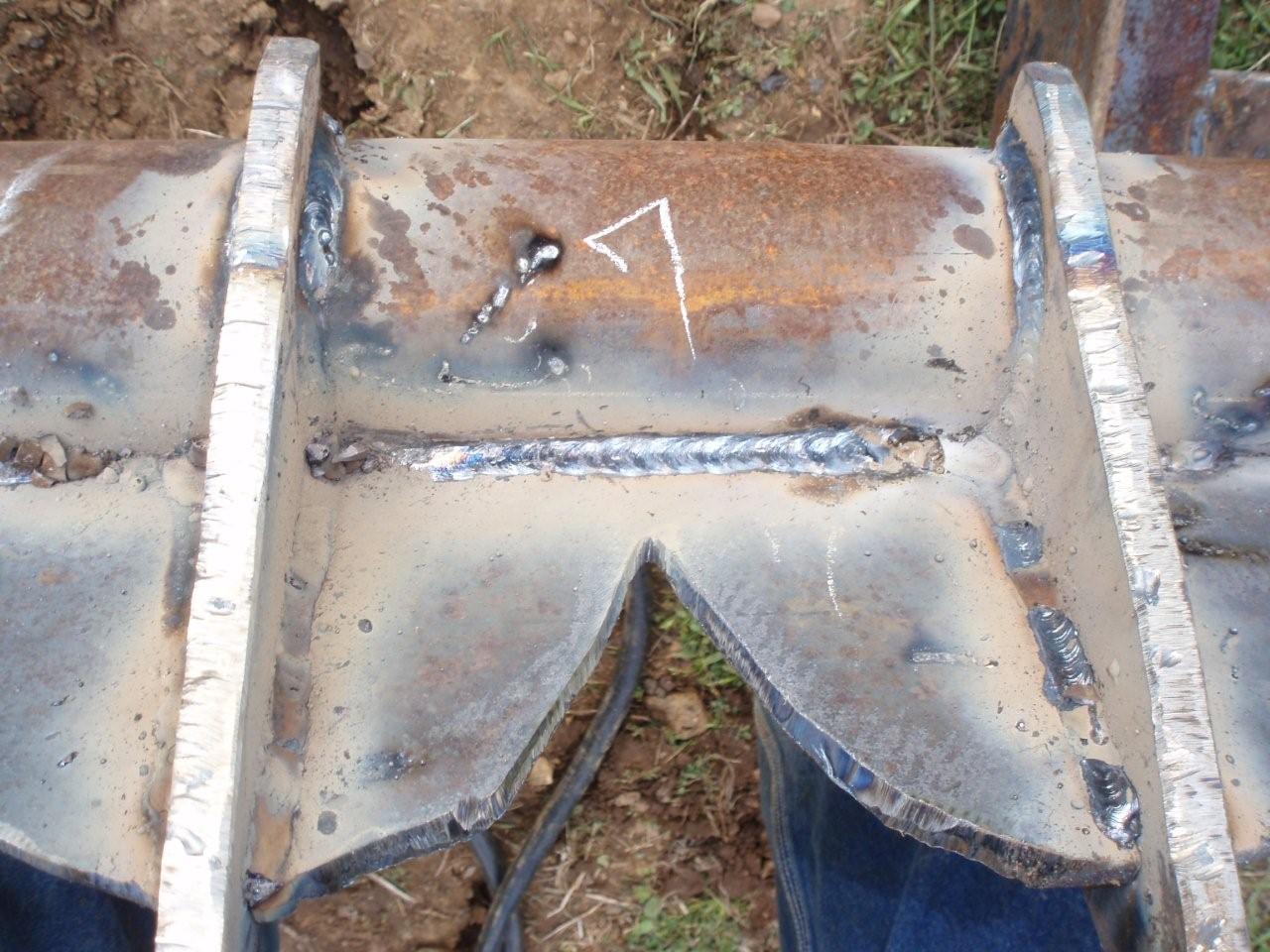

Finally got around to building a Grapple for the TC55. I looked around at many different types, before deciding on which design to go with. Decided to go with a "CLAM SHELL" design.
Here are a Few pics of the project just getting started. The cross tube is 3.5 Diameter 1/4" wall thickness, the teeth are 1/2" thick. All other steel is 3/8" thick. All welds are made with 7018 5/32" rod DC 200 amp welder.

deerhunterf350,
Those welds look nice. Much better than I with my shaky hands and poor eyesight.

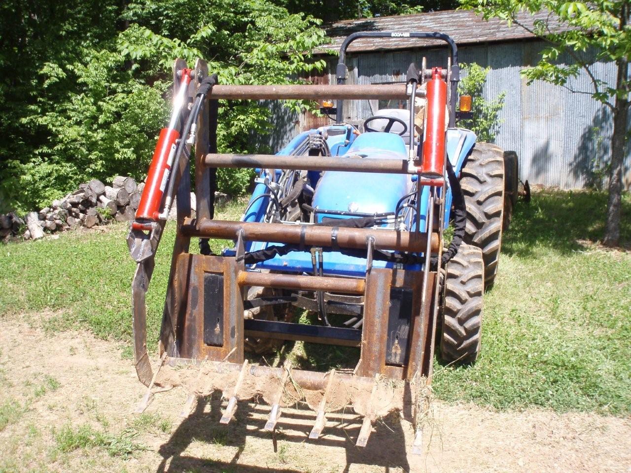

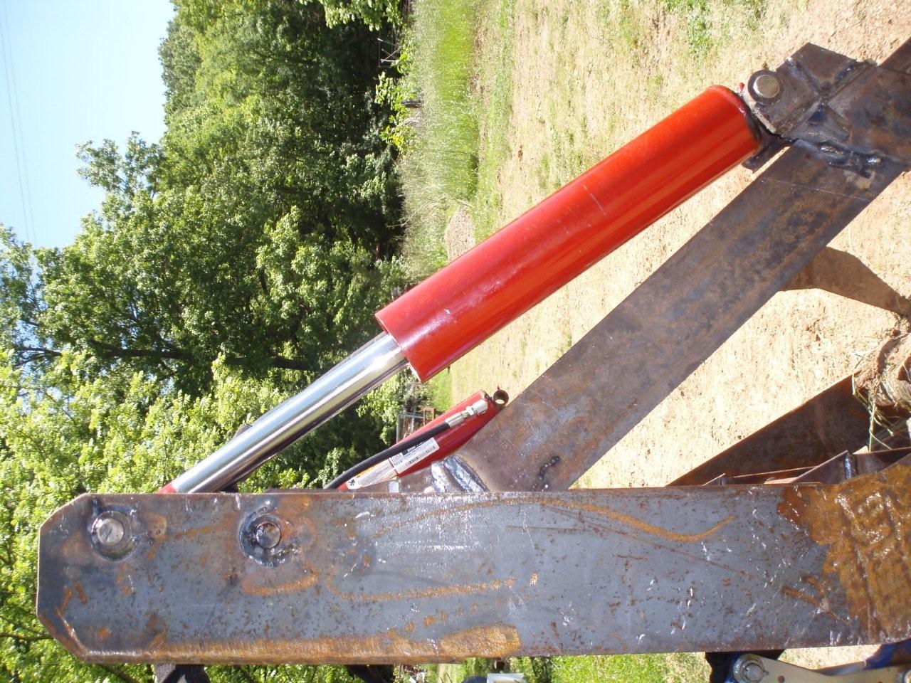

The bite at full open is 91". I still have cross tubes and bars to weld into the upper jaw. This was a trail fit to make sure the Cylinder placement was correct.
/ Another Homemade Root Grapple !!
Cylinders are 3" Dia , 8" stroke , 1.5" Rod.
To keep weight down and lift capacity at max for the TC55, I decided to only make it 4 foot wide. Thoughts were that 4' would grab hold of a big bite of brush.
/ Another Homemade Root Grapple !! #8
If it were mine, I would turn those cylinders around, so you aren't dragging those hoses across anything. On most grapples, the rods extend, pushing the grapple down, and hoses stay in place.
#9
I wanted the wiper seal of the cylinder facing downward so when the Grapple is open and being stored the Seal is not subjected to weather or sunlight.
When the upper jaw is completed there will be a plate that runs along the upper edge of the jaw protecting the hoses , fittings, and ram.

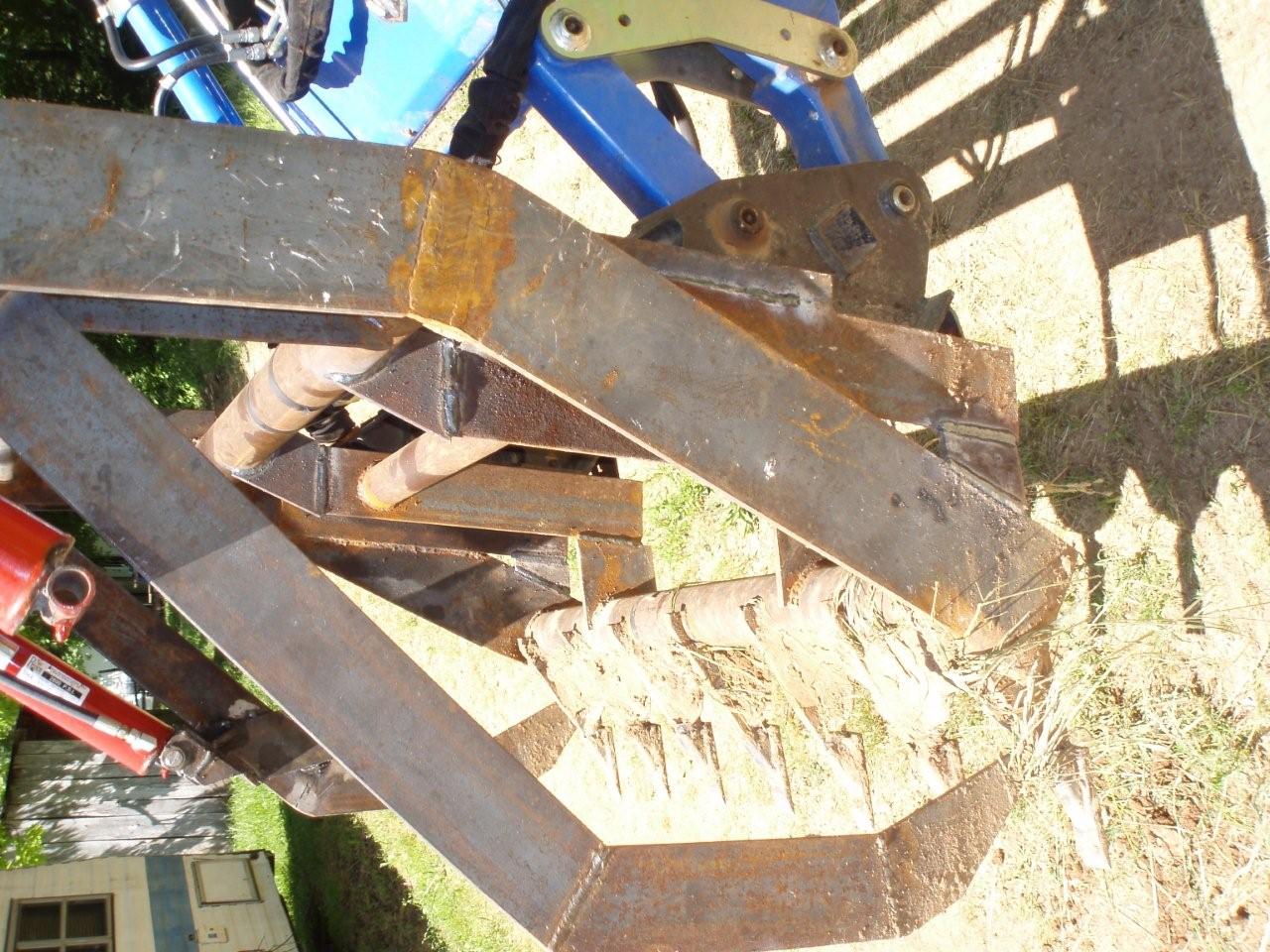

Had a chance to work more on the grapple this past weekend.
Added lateral tubes on the upper jaws for support. I still have plans to add 3/8" x 1.5" bar on the face of the jaws and a couple pieces between the Lat Tubes.
Here are some pics of the progress.

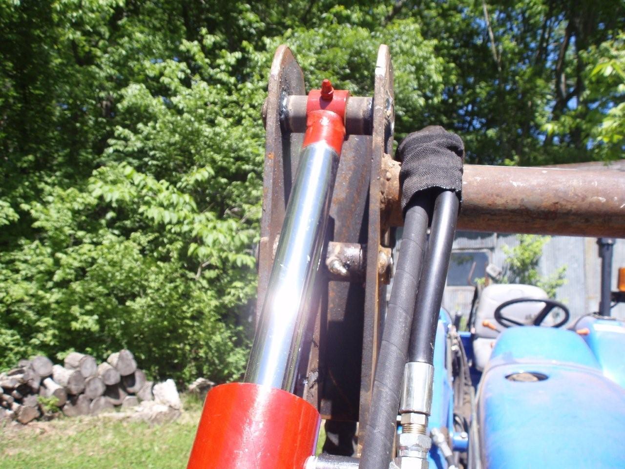

The Cylinders came with grease fittings installed. I had to make a Grease fitting for the pivot point on the Upper arms.
I tucked them back in a "Protected" area so hopefully no Brush will find them.
1st pic is the jaw closed .
2nd is the jaw open ready for a bite.
