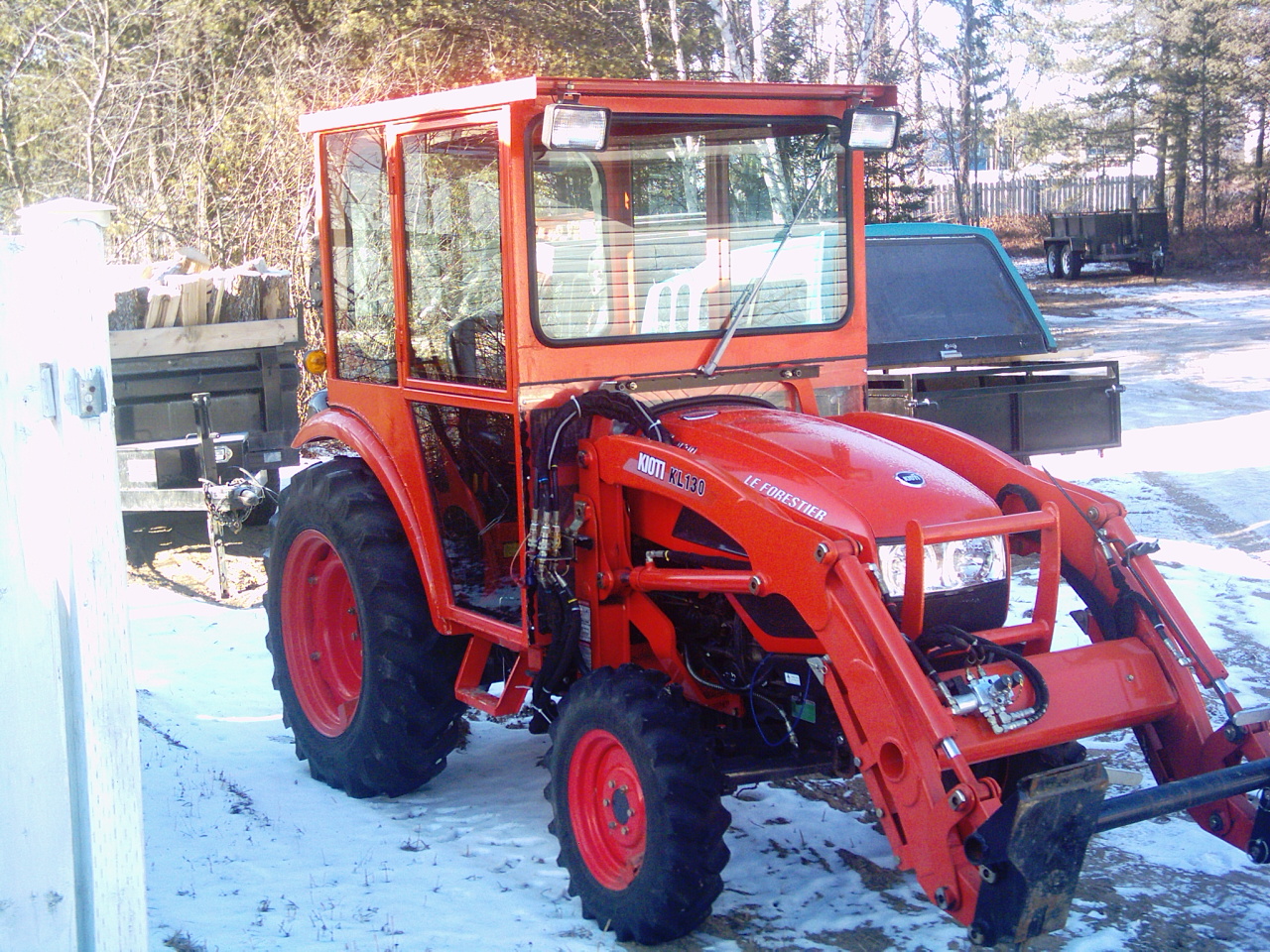

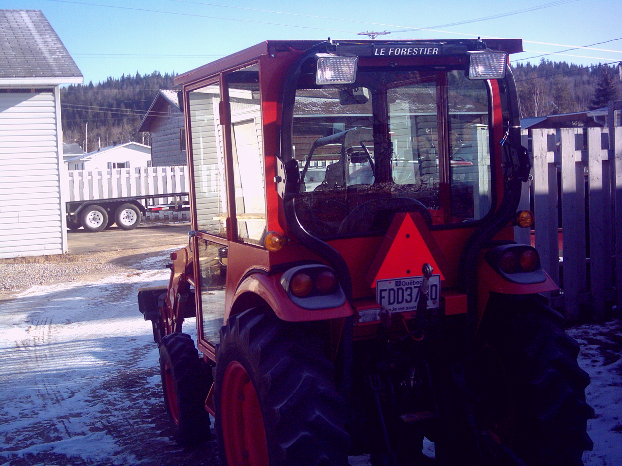

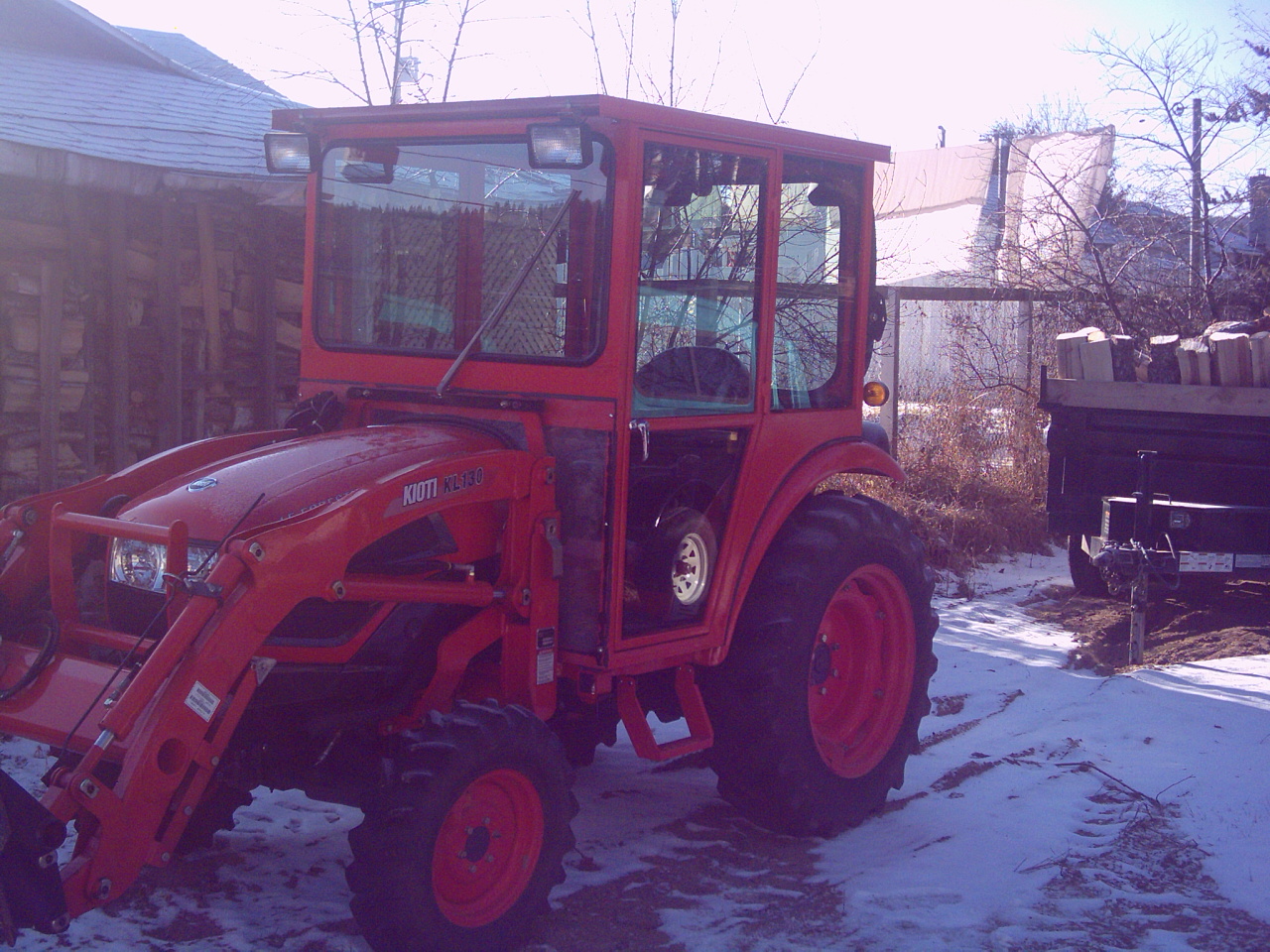

Ok now that i got my tractor back with windows installed, i guess that means i'm pretty done with the project, thanks to all the help and advice. :):thumbsup: Now where is the snow...:confused: can hardly wait to start plowing:laughing:

Looks great, now if it ever snows this year you will be lovin' it........Craig

Very nice Karl, you made much better time then I did on mine. Every right to be proud of it.

That's got to be the nicest home made cab I've seen.
Looks as close to factory as you can get.

I bought the handle and latch from the auto parts. The company selling these is Faucher.ca. I will post pics later, it's too dark when i get home to see something.
- Locking outer handle#670-1002
- Inner latch/handle # 692-2210 (left)
Personal i will be changing these this summer when i take the cab off, it will be more expensive, but work like on an OEM cab door.
The left window has a home-made L shaped handle, parts were back ordered and i needed to finish the cab. Will also change this during summer.

i'm actually proud of the cab and the fact that i actually built it from top to bottom. Many hours involed but enjoyed every minute of it, and got a chance to tryout new tools:)
