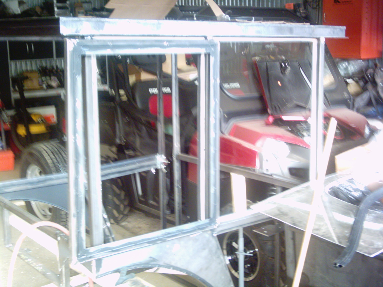

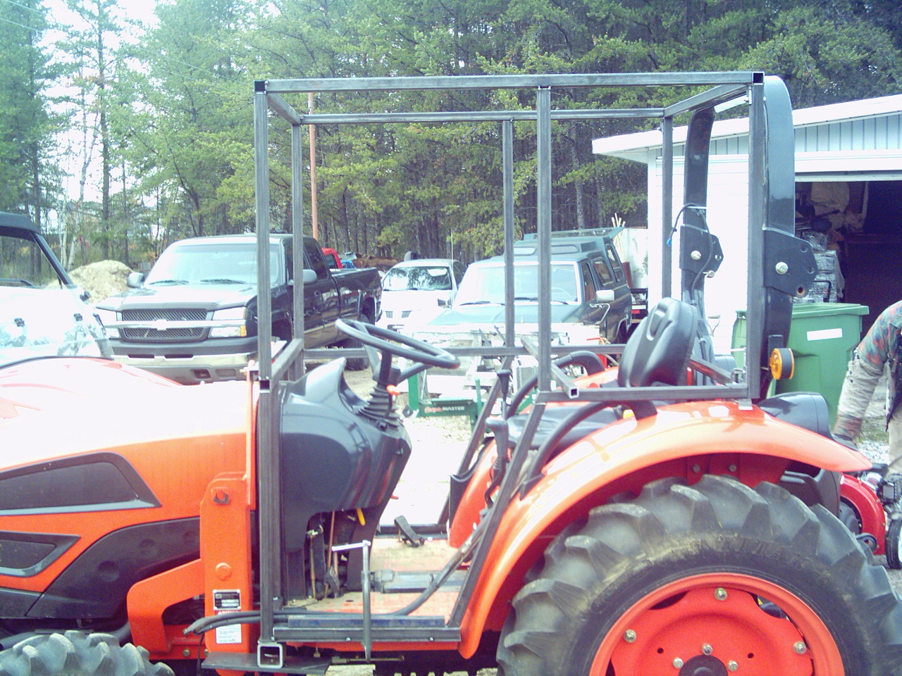

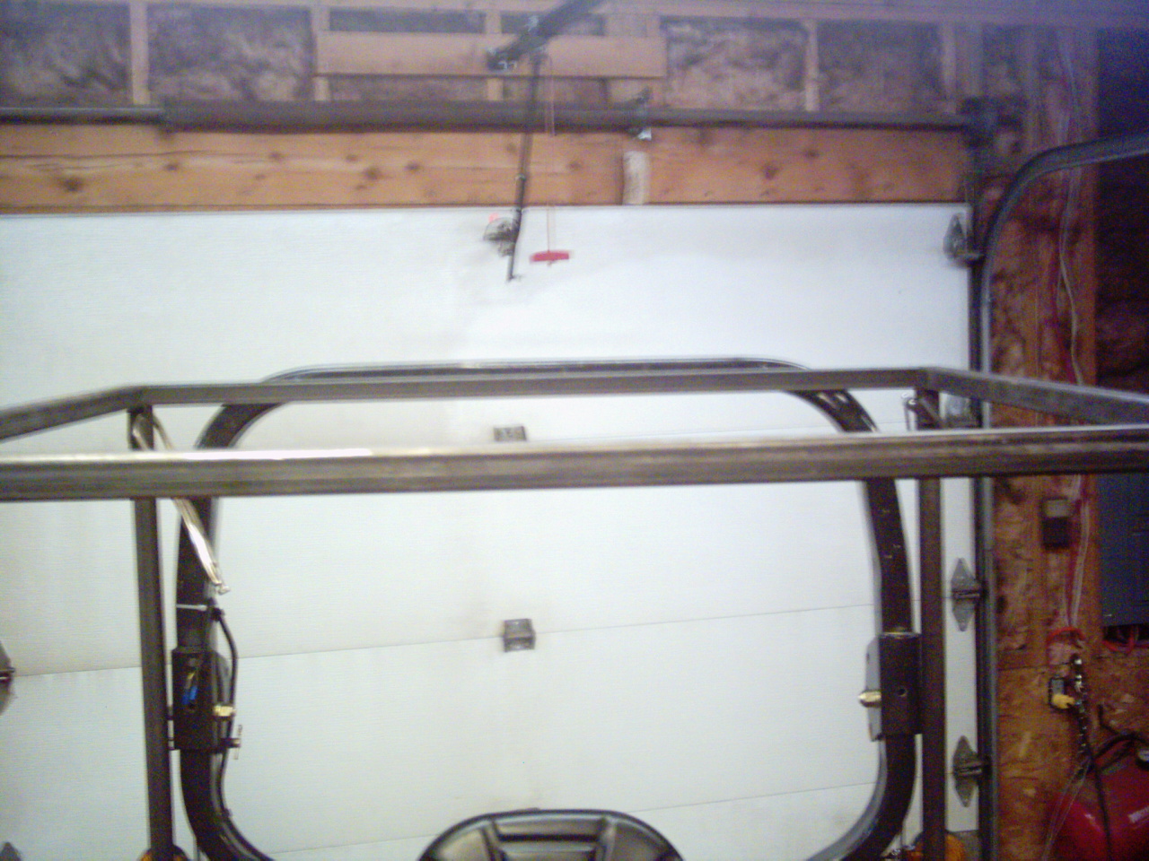

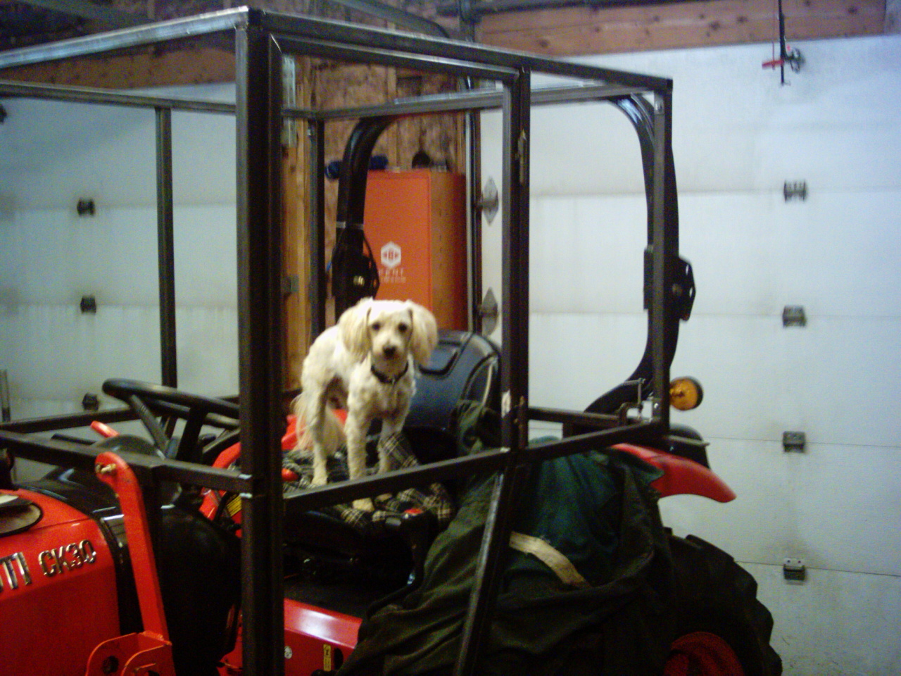

With winter on it's way, and having sold the DK45SEC i had no other option than to custom build a cab. My cab will and must have the following;
-Heater
-Front and rear wiper
-Front and rear cab lights
-Dome lamp
-Lower than the Rops ( Rops cut down 11 inchs upon purchase)
-A radio
-Must be easily removable
-Wide enough to allow to bring a friend along:laughing:
Having seen many others build their own cab, i felt inspired to give it a try. I have lots of tools for the job, but lack the experience (cab 101:confused2:) So far this is what i have come up with, any comments/advice is more than welcome:thumbsup:

A link to my blog which has a pretty detailed article about building a cab very much like yours. It was written with the idea of helping someone just like yourself. Translated, learn from my mistakes.(-:
Life on Highway 9: Building a tractor cab.
I like your door opening, nice and wide. I might have gone a size up on your square tubing.
Best tip I can give you is on weatherstripping, go to a old fashion junkyard that will let you wander around and check into the weatherstripping between the hood and the fire wall. Also check the trunk for weatherstripping. Some nice stuff cheap.
Fellow just posted a build on Bobcat tractor cab he built, study his build closely also, very nice.
Wipers, marine supply or 93 Dakota.
Sounds like you had cab before? Are the rear wipers really that helpful? Curious.
Headphone radio is the most practical in my book, noise level is going to be high, least is in mine.
Can't quite see your mounting points. Mine mounts down low on frt. then has rubber mounts at back, other then those points no contact between cab and tractor other then weatherstripping.
After finishing mine I noted a utility body in our shop which had very nice weatherstripping which sealed the side doors. This stuff would have worked good for sealing my door and window, never found it on the net but the utility box company is just down the road so could have got product or at least name from them.
Checkout those junkyard hood and trunk seals though. All kinds of different ones, 180 degree, 90 degree, big ones, small ones. You will be much happier with your cab if it seals tight.
Also take note on the blog of method used to seal under and behind seat, the rubber matting worked very well, simple, cheap, looks great.
Also note in the blog about building the door and window, tack weld shims in the openings, fit the window using the shims as spacers, clamp the four pieces into place, tack weld then you can pull it out and weld on the bench.
Happy building. Roy

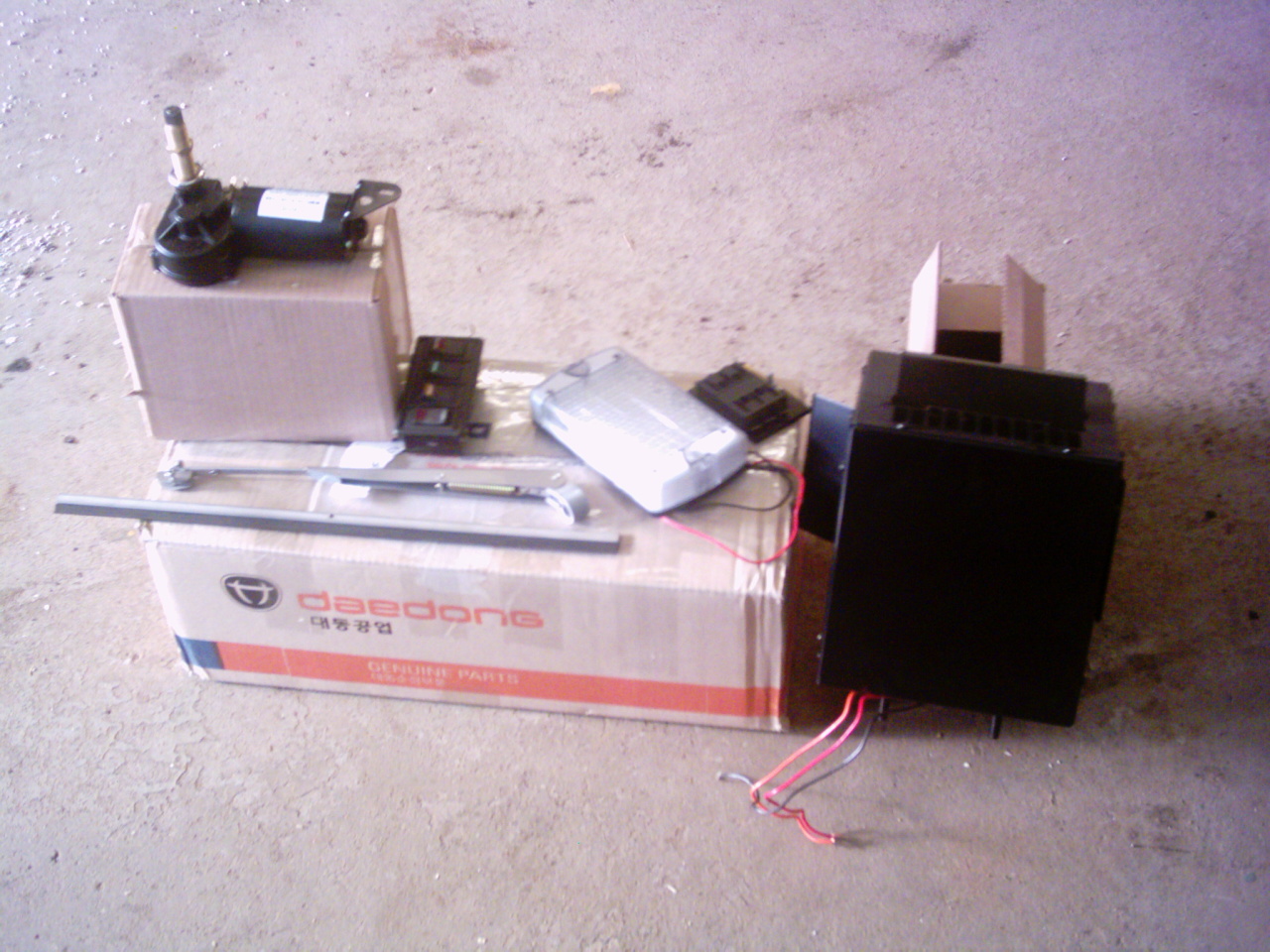

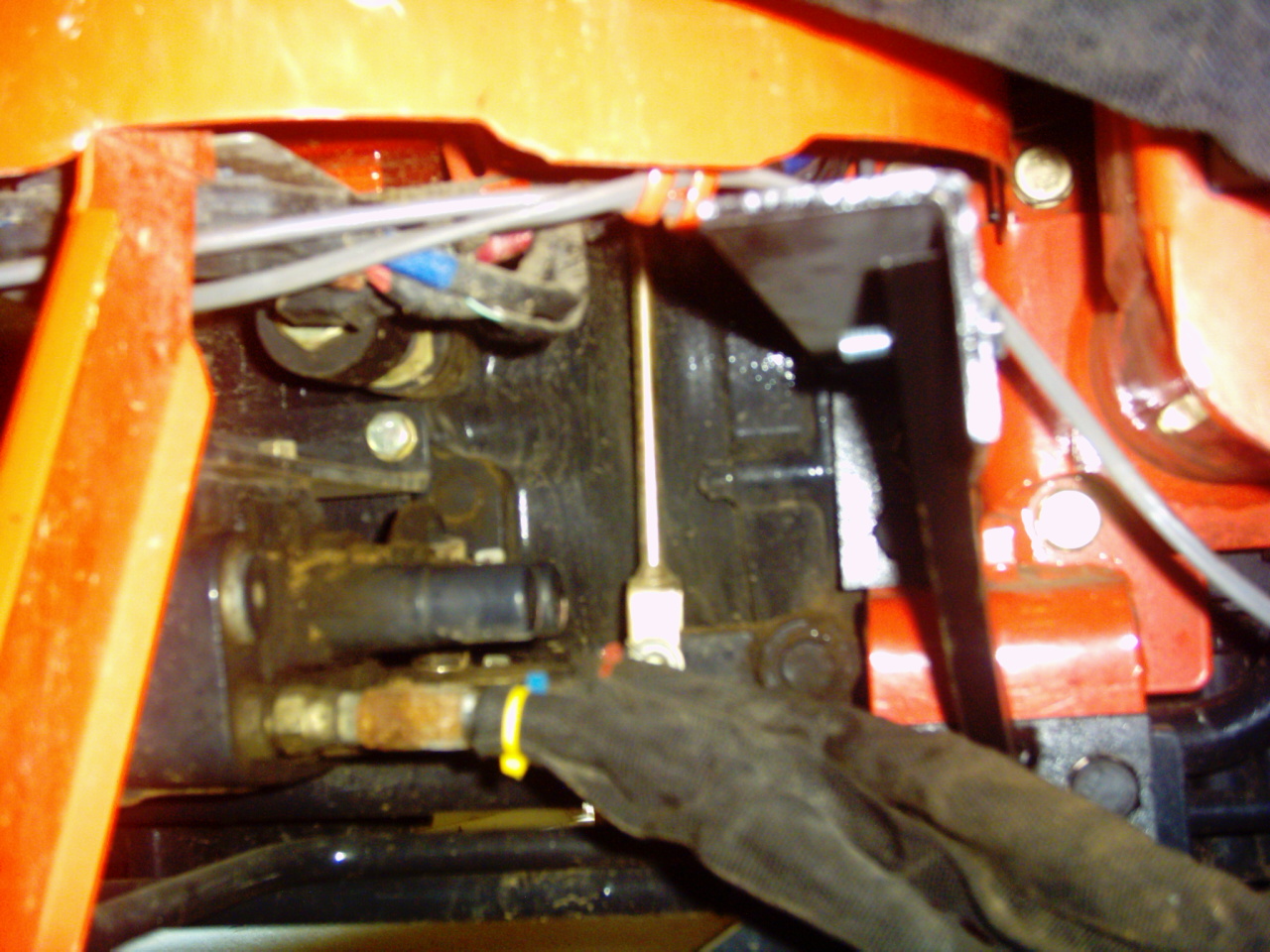

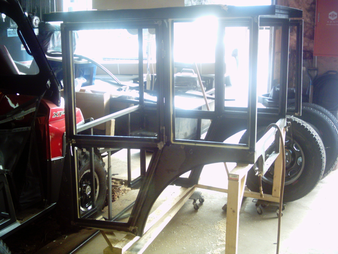

Thanks Roy for the info, great looking cab also:thumbsup:
I will use weather stripping from a Ford Ranger for the door and side window. For the cowl/hood section it comes off a Dodge Caravan.
I did purchase the heater and wiper kits from the auto parts store, very expensive:( but worth it. The wiper motor is 2 speed, and ajustable swipe.
I did make cab mounts which are bolted to the FEL/BH brackets.

Hey, good progress, like the way your fill in around the fenders is coming out. Again, envy the space you have for your door, mine was so tight. For sure keep the updates coming, gets my blood pumping.

can you tell me the brand/model# of your wiper. looks like something i could use to replace my crapped out surplus center wiper. also which auto parts store did you find it at. thank you and good job so far on your cab. something to be very proud of every time you use it. will enjoy following your build. we are still waiting for snow here. never snows enough once you own the right tool to deal with winter conditions.

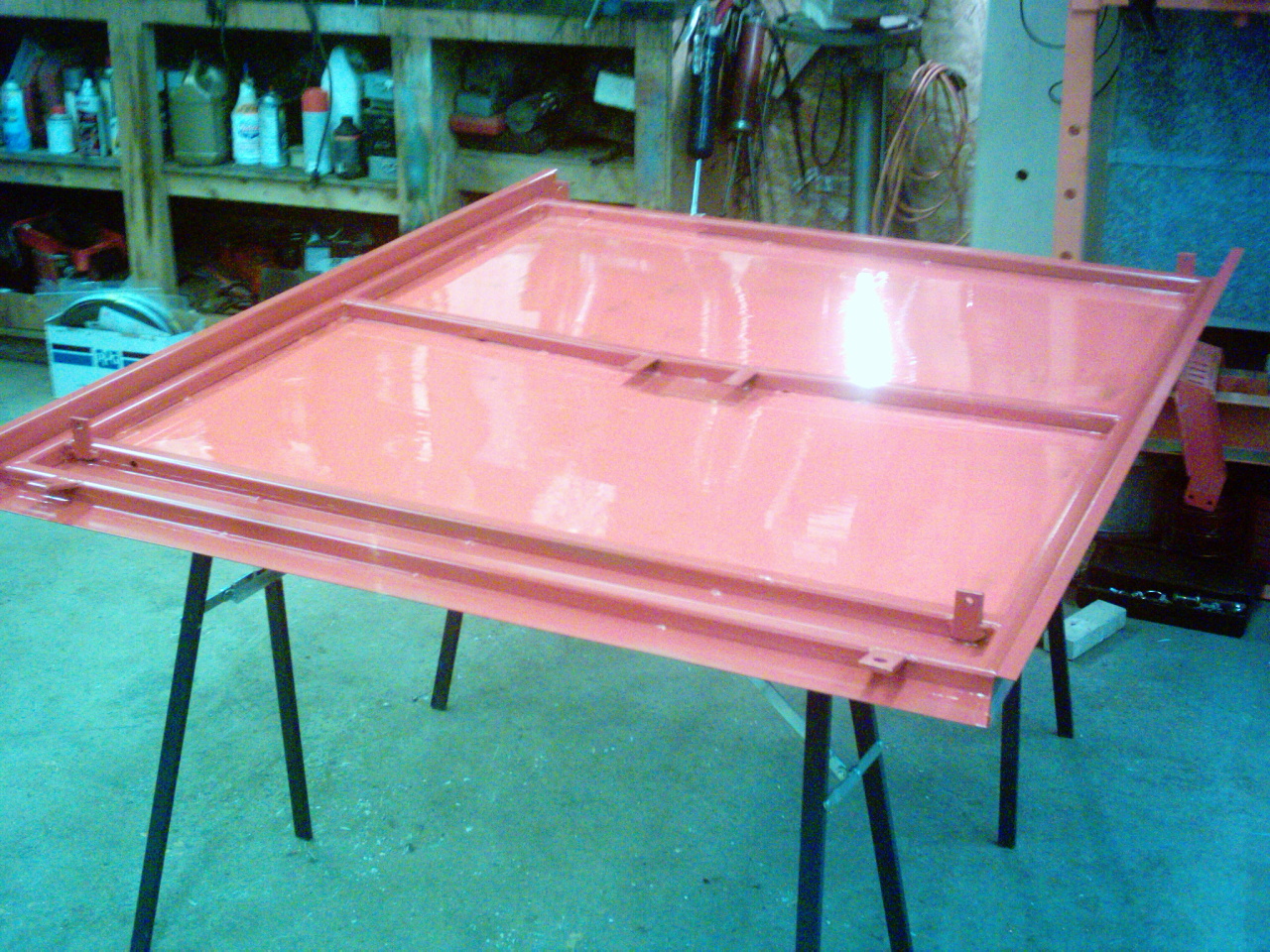

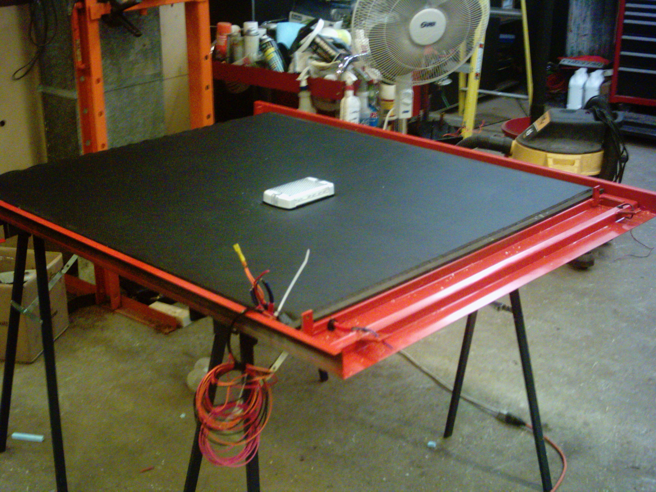

Update on the cab project, have the top done and wire ready for lights and all. Got the led dome light installed. It's almost paint shop ready, i did the cab interior myself.
Now to answer a few questions;)
The wiper motors are from Cadel (uni-select auto parts found that on the net, could of done that myself.)
Motor #WWF12C18720S
Wiper blade arm (ajustable from 14-19 inchs) #LE5810222S
Wiper blade 18 inches # 134000000
Don't know if these are the right part #:laughing:, but thats what is on the bill;)
I also got the switchs installed and the fuse box.
Thanks so far for the comments.

great job so far. i found a wiper motor similar to yours ongaro brand on amazon for 90+ ship. may take that one. any snow your way yet? nothing accumilating yet here.
/ Another home made cab tread
#14
No snow yet up here either, Good thing since my cab isn't ready yet. :( Bad news, no paintshop can paint my cab before 2 weeks, then it has to get to the glass shop:confused2: I'll run out of time, so it will get paint brush for now and when i remove it this spring, the bodyshop will have all summer to paint the dang thing:laughing::D. Still have to shop for a blower and build my snow plow.
As for the wiper motor, i really like the ability to set the swipe, oe set for 110 degree right park, i had to set it to 85, and prefer left park.
Flood lamps are in, 55 watts (30 feet long 50 feet wide) maybe i should've bought 50 long by 30 wide:confused:
Anyways, paint is drying should mount on tractor for the weekend.

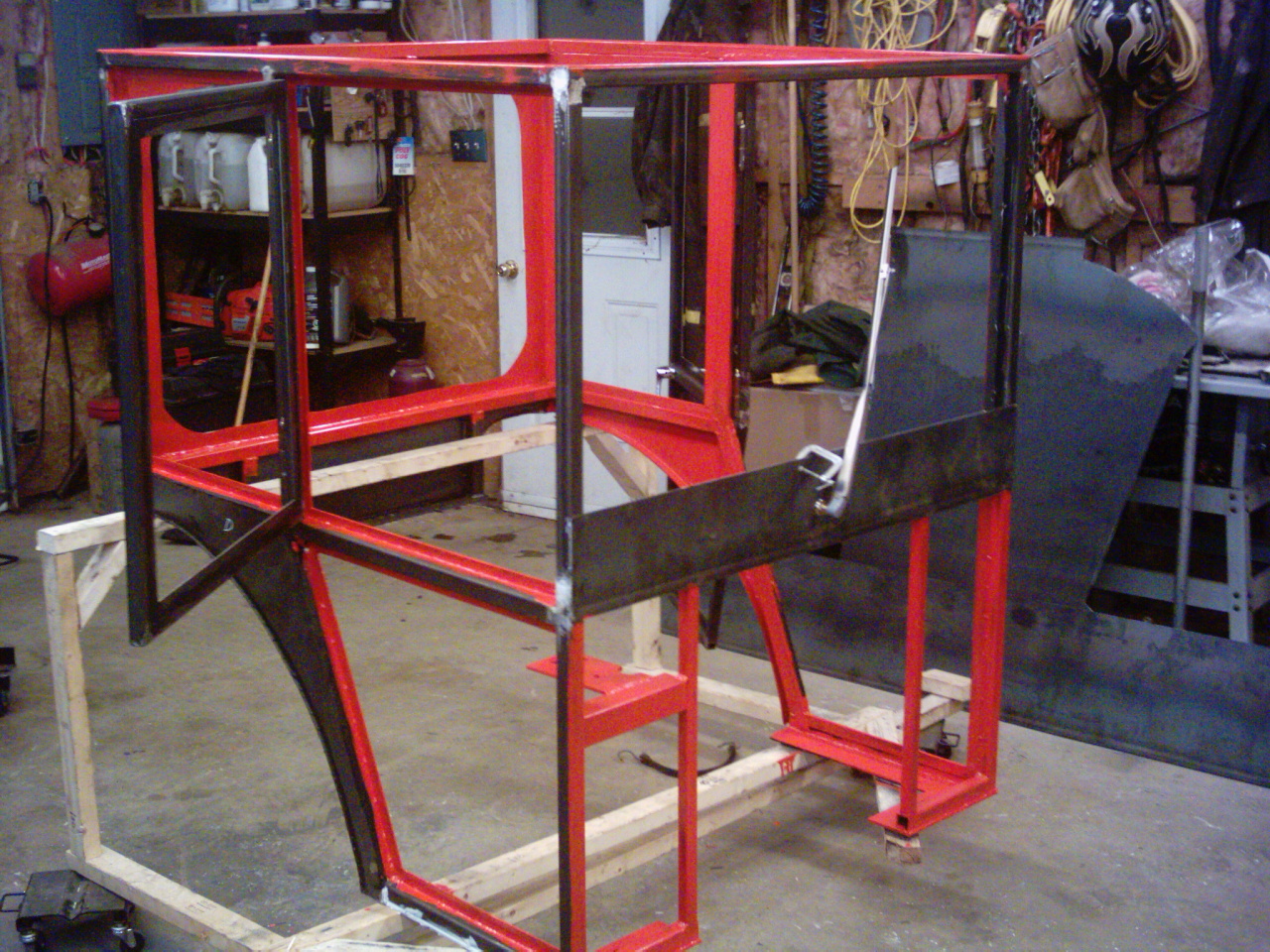

I have the cab installed on the tractor now:thumbsup:, Snow has arrived so i'll be wiring the lights and heater in a hurry. next week it goes in for windows. Will post pics of finished product. I will have to modify the fel hose bracket due to clearance.

Finished installing the lights, floor mat, and cab mounts. Had to relocate the left foot step, since my cab is wider than the platform. Should be getting my tractor for friday, dropped it off this morning to get glass installed. Only thing left is to get the radio installed. I did installe a door switch so the dome light turns on when the door is opened and off when closed:D
