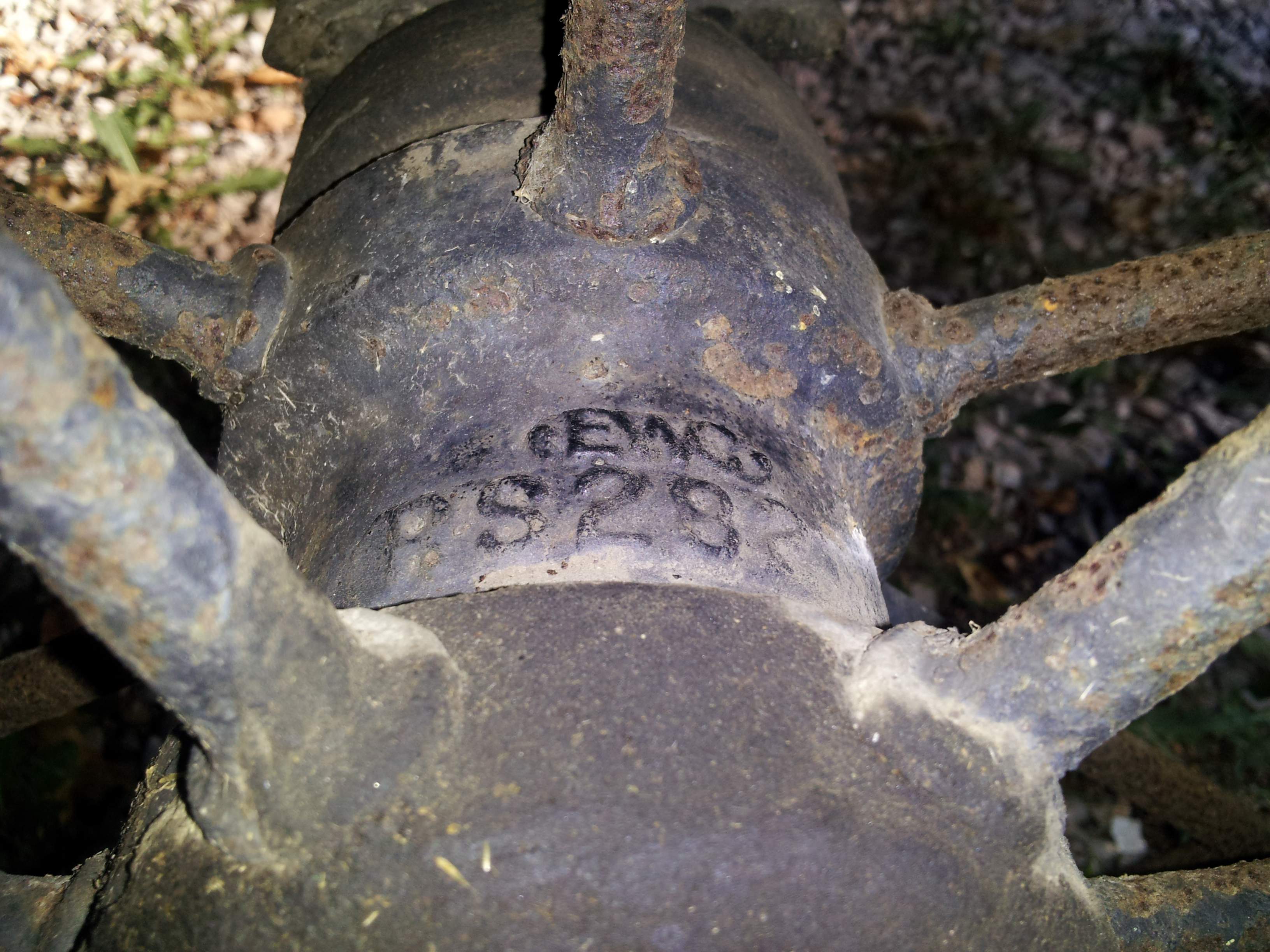

I bought an old hay wagon recently and already started the rebuild process.
I am pretty sure it was made by the Electric Wheel Company. The spoke hubs have a stamping in them that says: EWC.
There also is stamped: RS282
Does anyone know what the RS282 means?

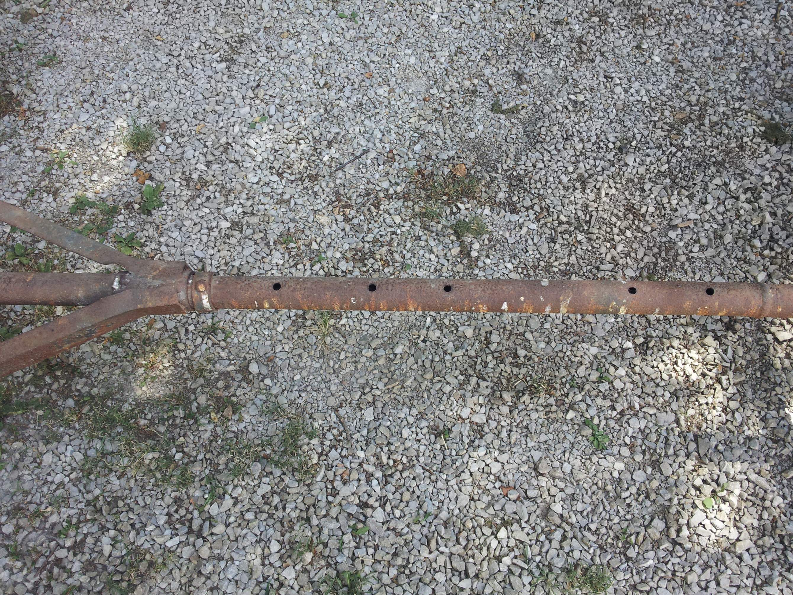

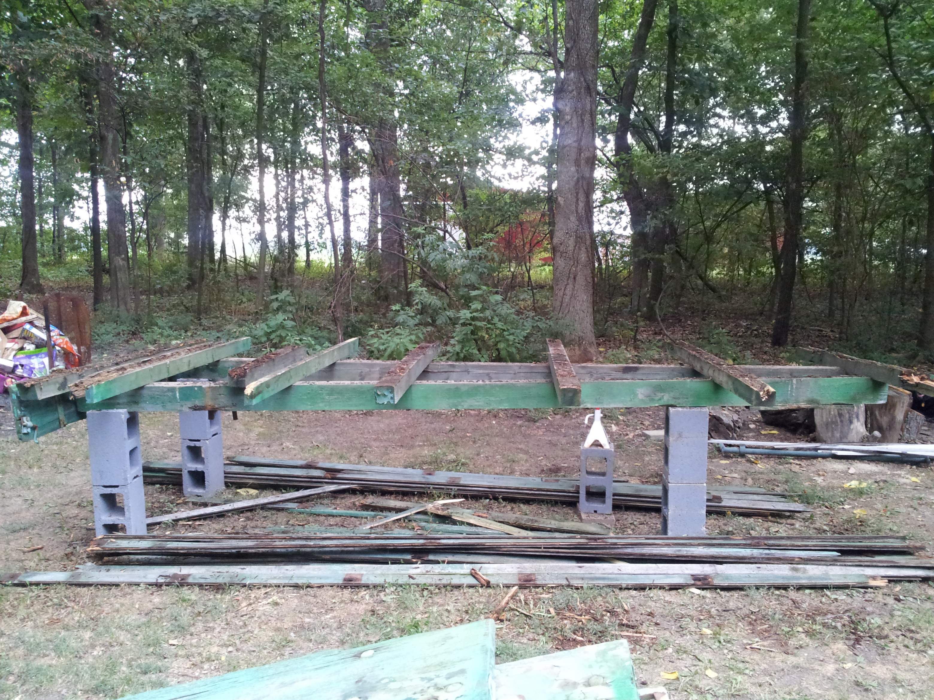

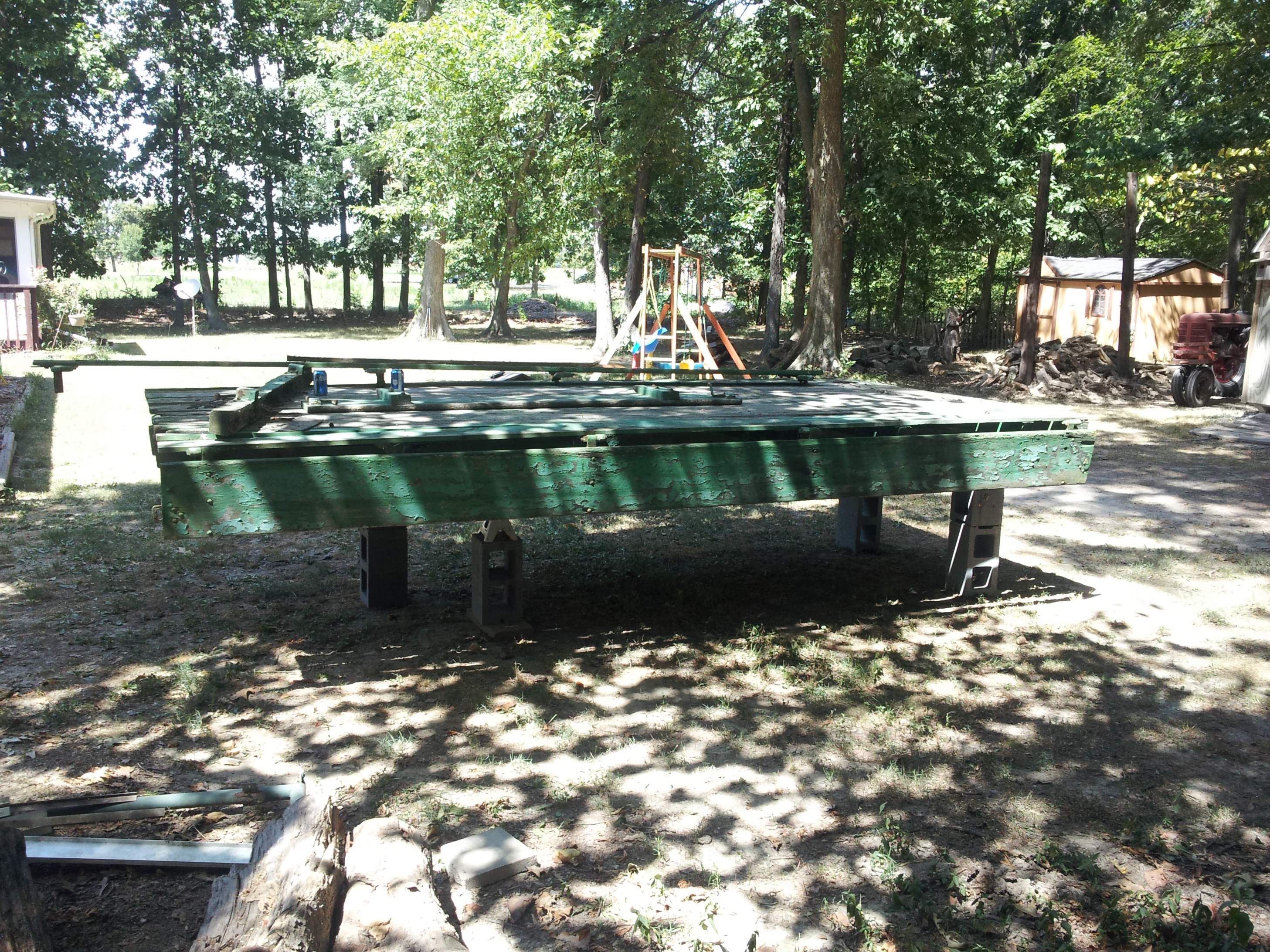

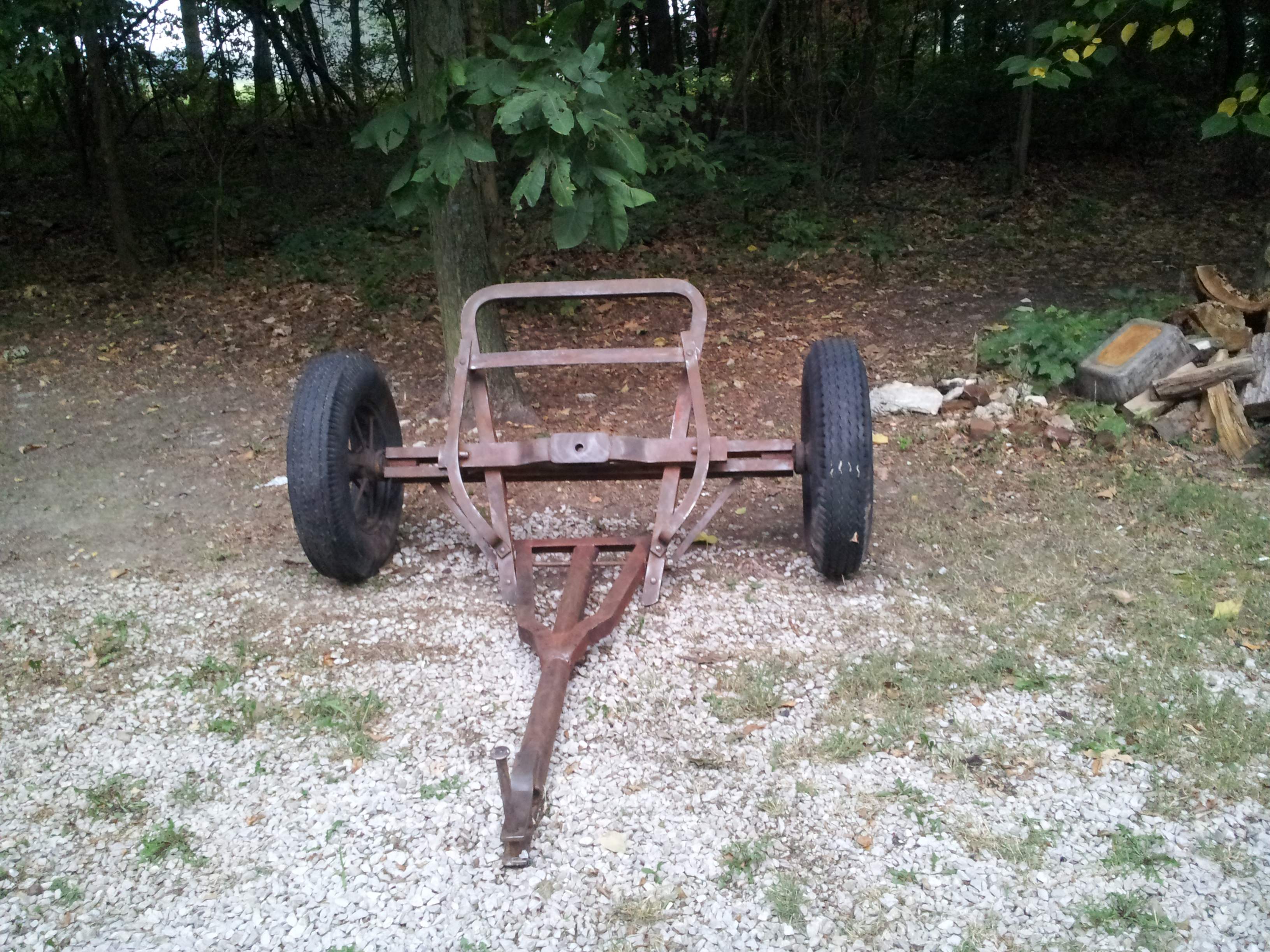

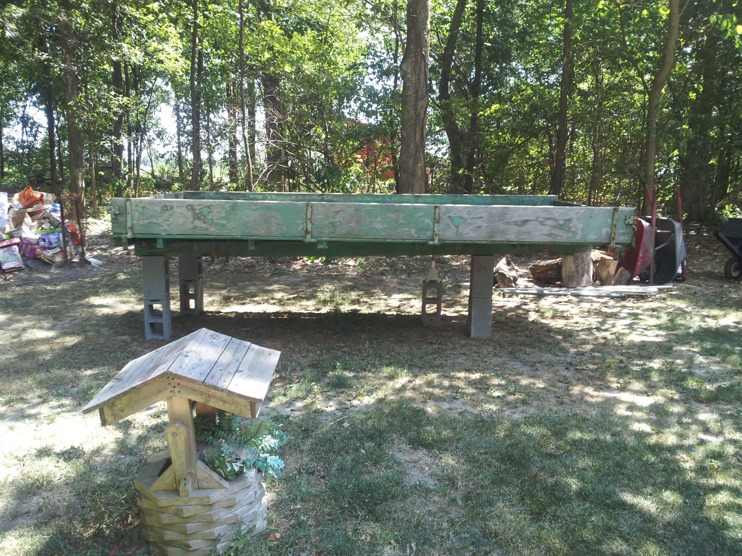

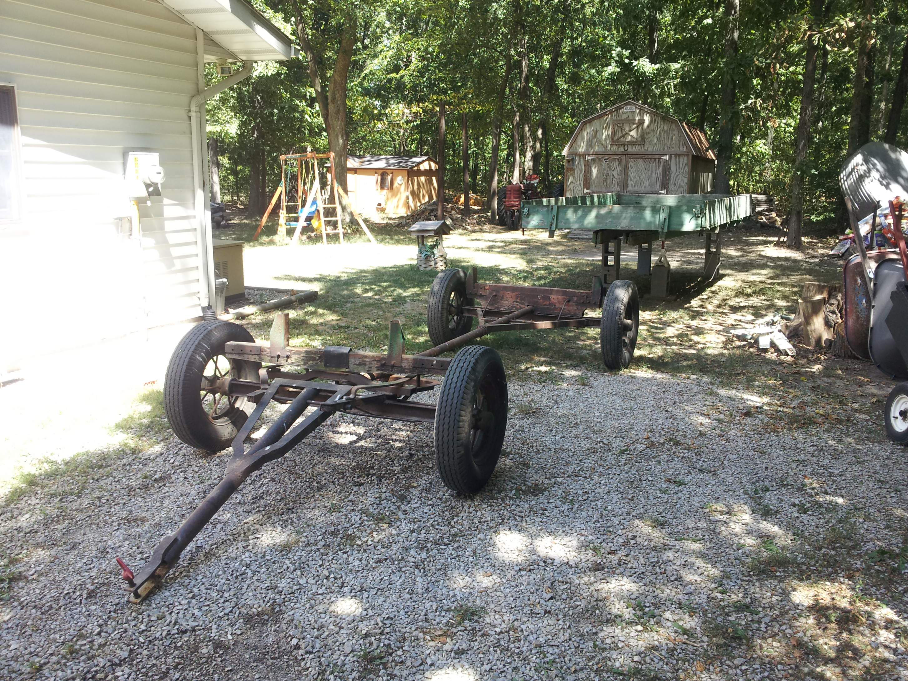

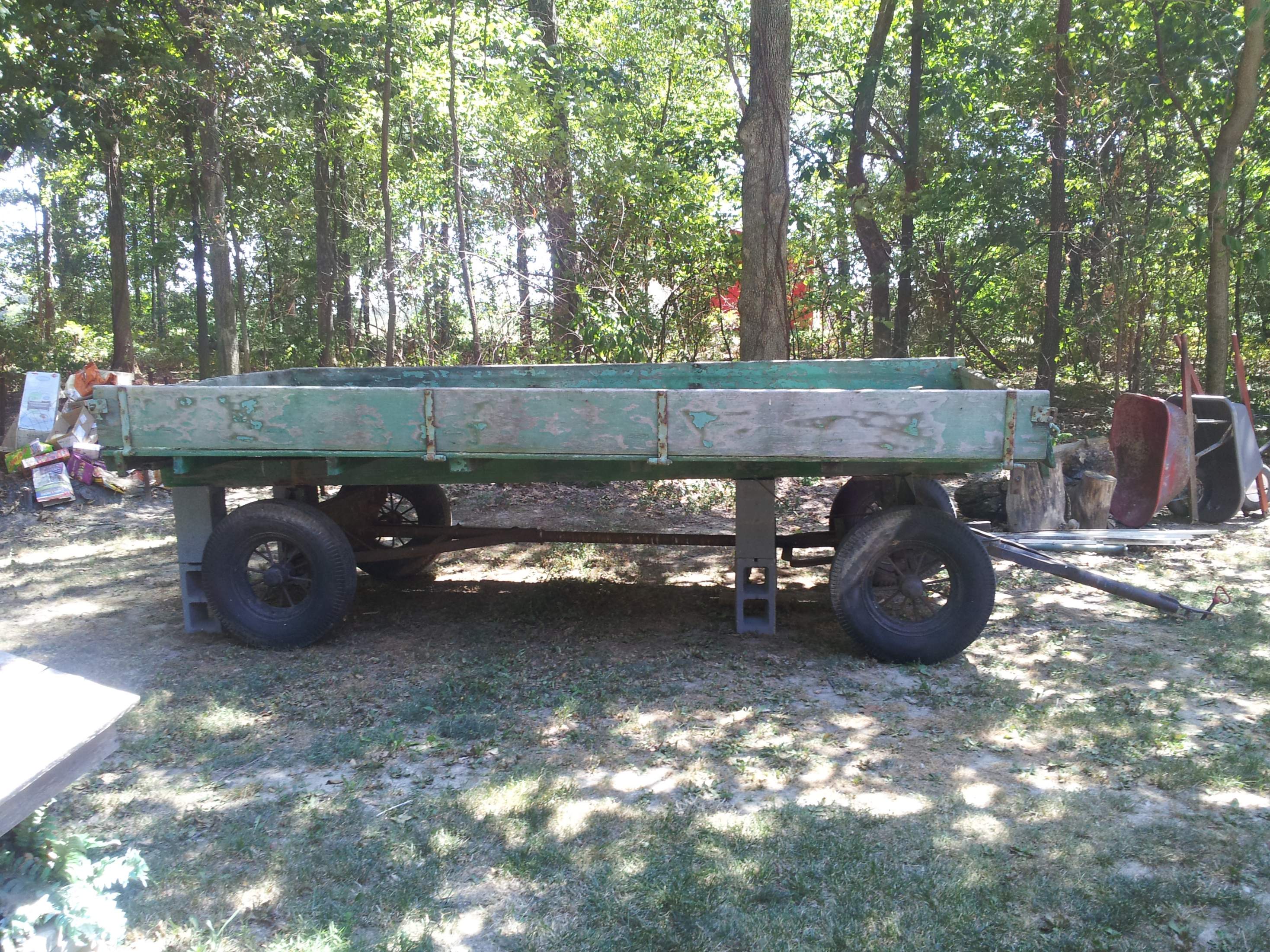

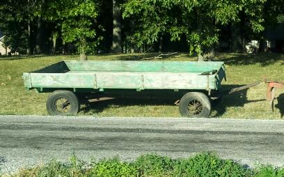

Starting to remove the running gear. The sill boards run at an angle from wide in the back to narrower in the front.
I wanted to block both ends up from the outer edges of the 4x4 cross beams but there was so much rot that the sill would just drop
Pulled the gear forward about half way.
Here is a pic with gear removed.

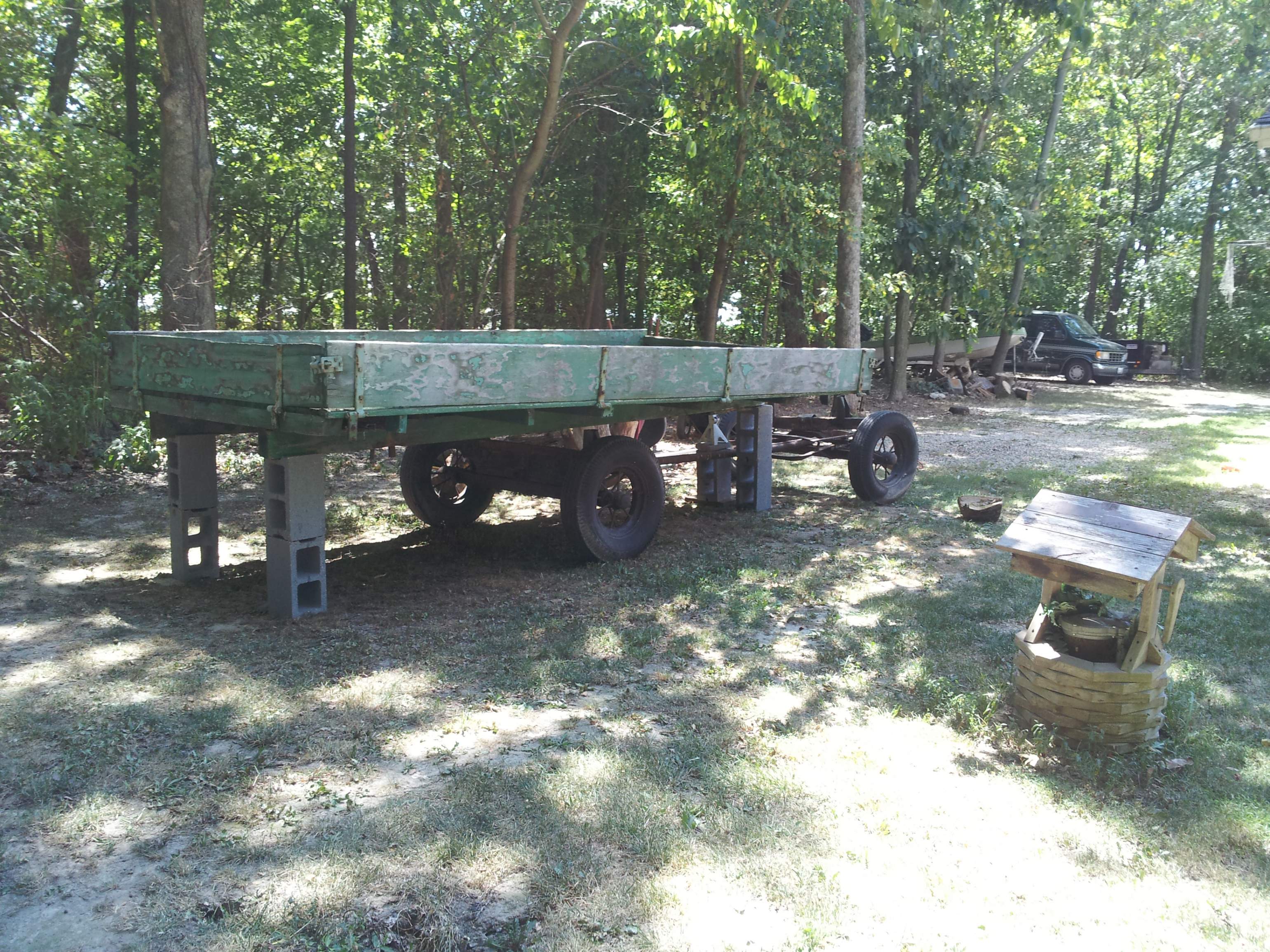

Had to reposition the front blocks until the gear was past half way such that the wagon would not tip forward.
A little wood rot...better shown in upcoming pic...and pretty much just surface rust. Have not seen any rusted through spots, even on the underside.

Still wanting info, if anyone can help, as to what the "RS282" stamping might mean on the hub...picture in previous posting.

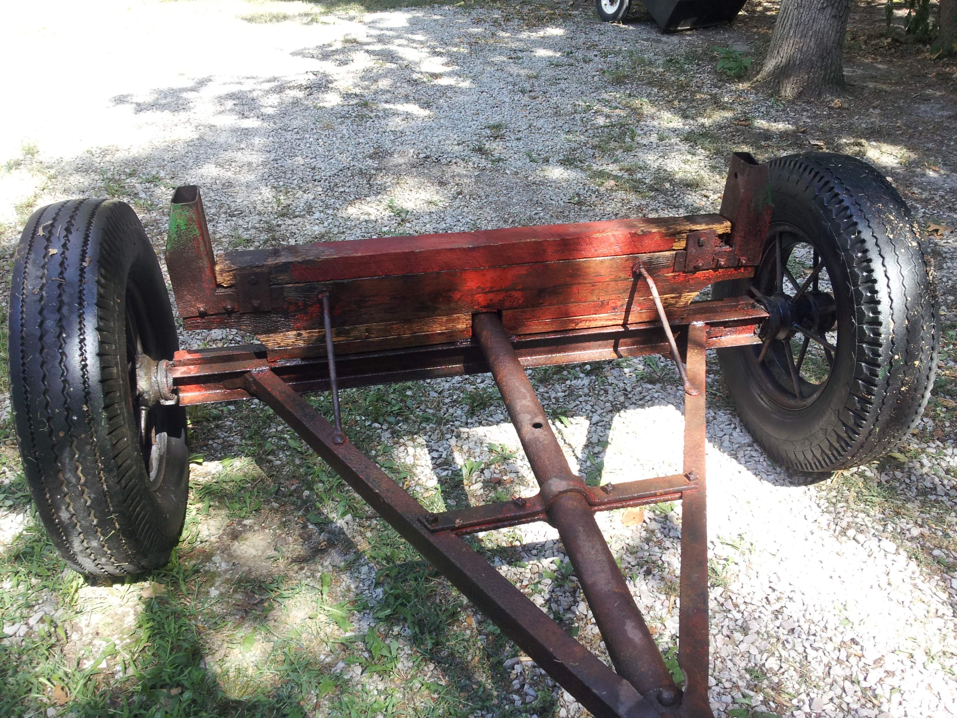

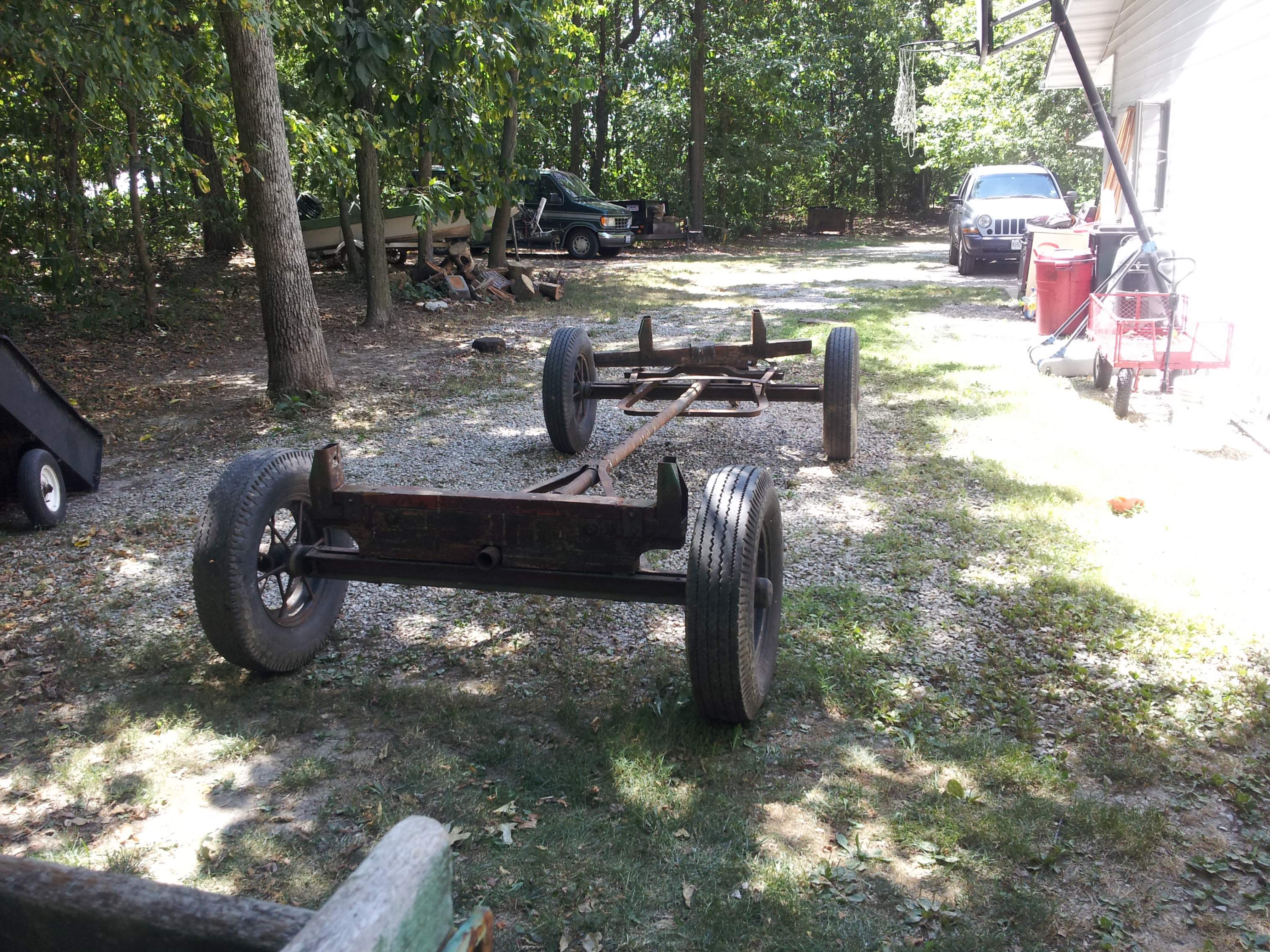

Never saw a wagon with that type of steering and a straight front axle. There were probably many different manufacturers applying their engineering skills for the best application. Looks like the transition period between steel and rubber tires.
/ Another Hay Wagon Rebuild
That is why I think the sill boards are narrower in the front. When you turn, the tires would hit the boards had they been made wider.
The gear is adjustable but I'm just gonna leave it long.
The deck was make of 1 x 3 to tongue and groove. Does this help date the gear?
It had drop down sides and back. The front board was set in stake pockets. I think the rebuild will still have drop down sides and back but I want to make them taller. It will strictly be used for hay rides and some light hauling.

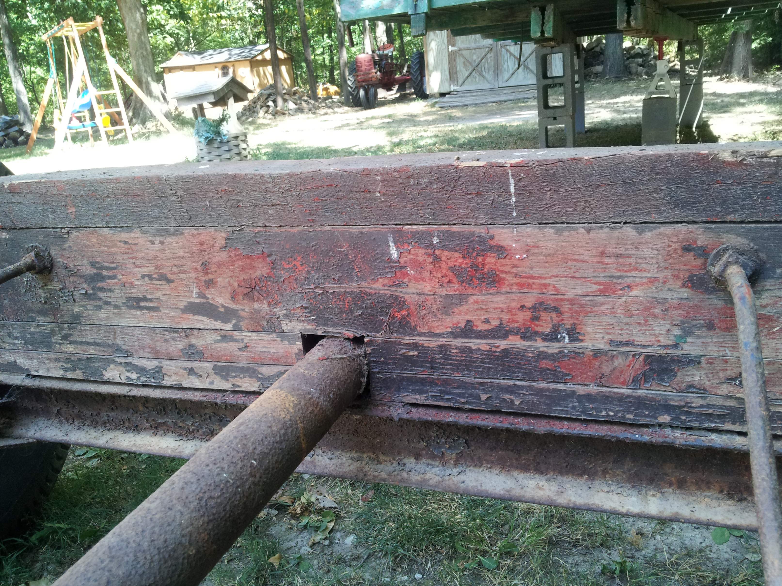

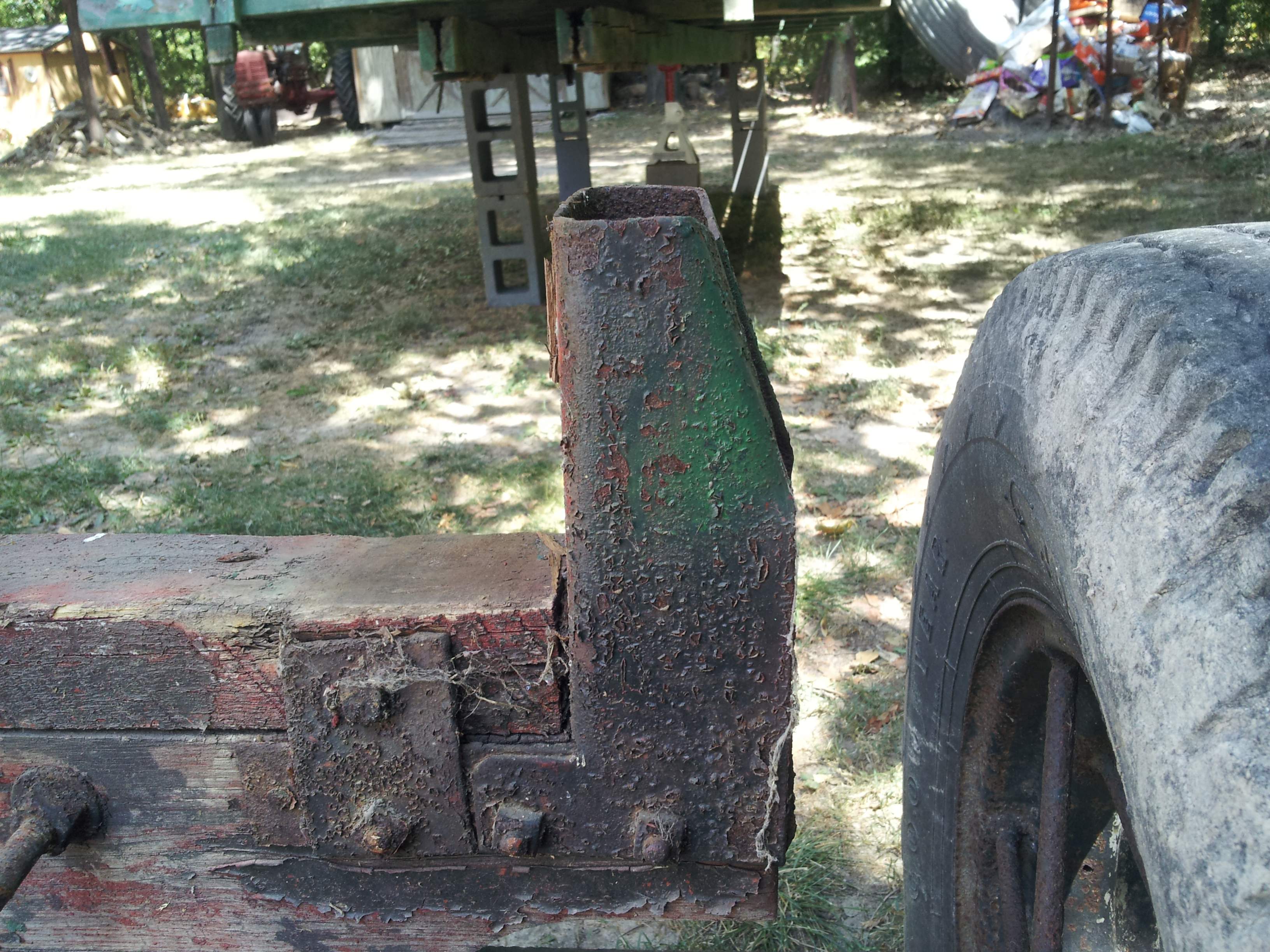

Close up of rear axle.
Close up of front axle.

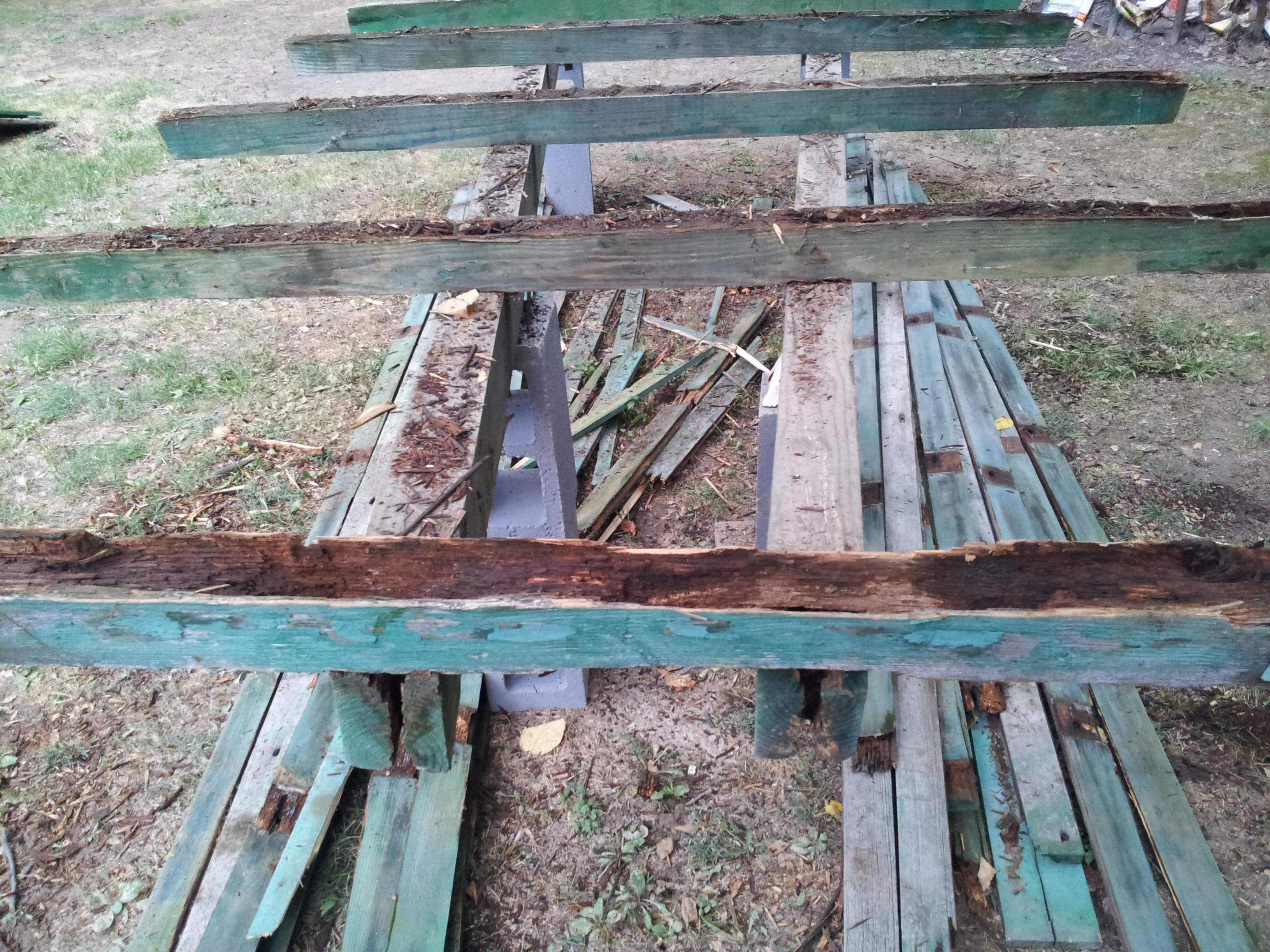

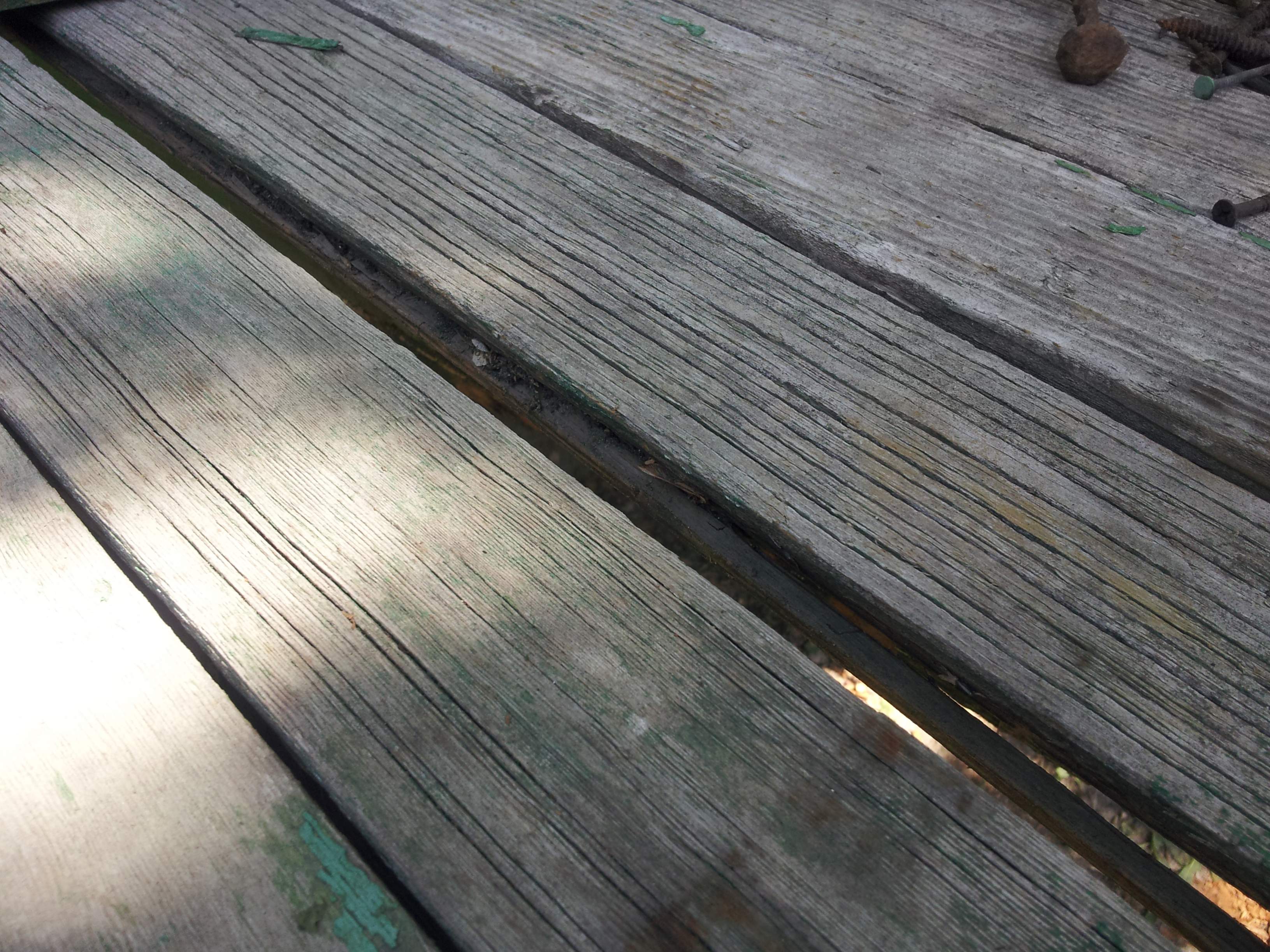

Starting to disassemble wagon to see how it was made. Boy...lots of rot.

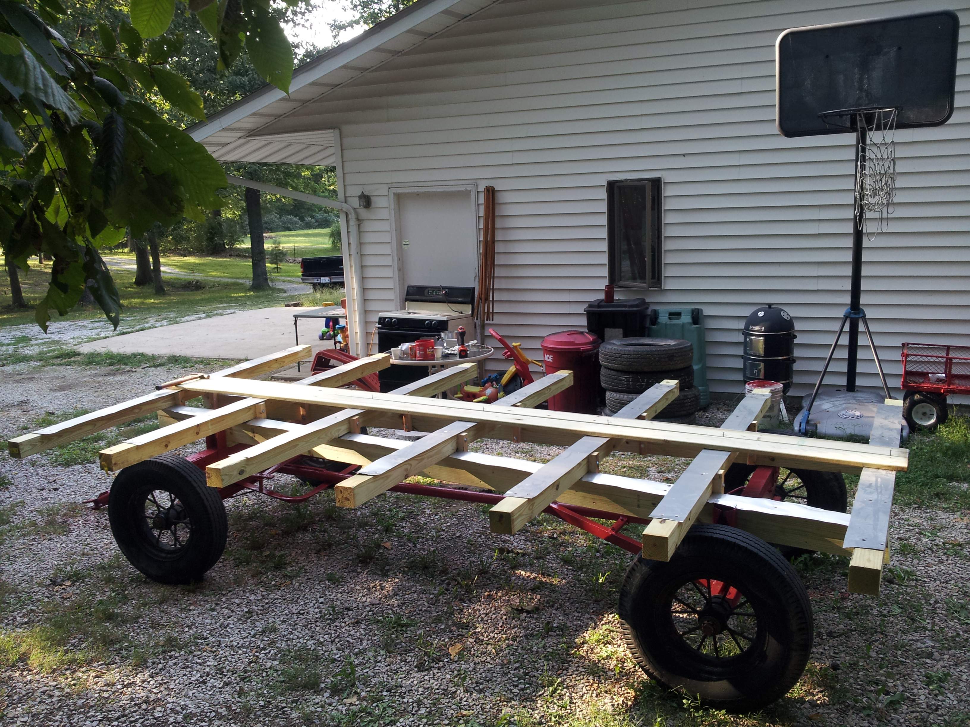

Bolted rails on frame. 2 2x6 boards for each rail glued and screwed together.
Cross braces just setting in place to see how they will look.
Will remove cross braces and put a piece of aluminum flashing on top of the rails to help protect against rot.
Then will lag bolt the cross braces in place and cover them with flashing as well.
I plan on using 5/4 x 6 boards for the deck.
Question: Should I use 2 or 3 screws to fasten the deck to the braces? And if the wood is somewhat cupped, should the cup face up...like a U...or down...like a sad face?

Looks good. The Electric Wheel Company was in business from around 1890 up to 1957 when Firestone bought them out. My guess would be that it is from the 1950's judging by the tires. The older wagon utilized 4 x 28 tires and the ones that are your wagon look to be the later 7.5-20 tires.
The front tires are 6.5x16 while the back are 7.0x16. The back tires are Goodyear while the front are Allstate. I googled Allstate tires and they were sold by Sears. Both sets of tires are very much dry rot and I have replacements that were given to me by Dobbs Tire Store. A little bigger with lots of tread but still a little dry rot on the side wall. They will do until I can afford better ones.

Bolted cross boards to main rails using 2x2's and lag bolts.
Added aluminum flashing to rails and cross boards. Started to put deck on.

If the U is up would that not trap water unless the wagon is always shedded.
