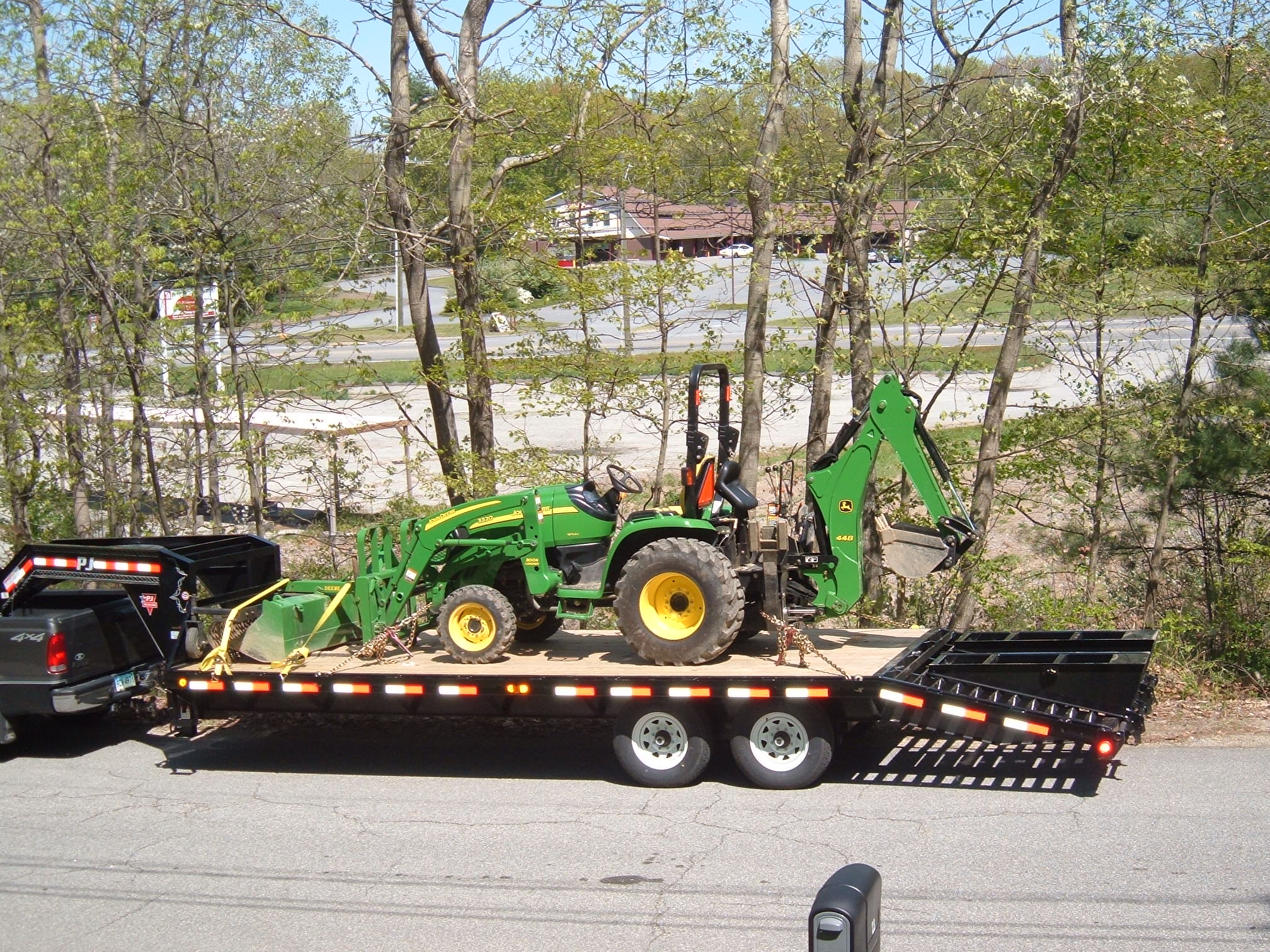

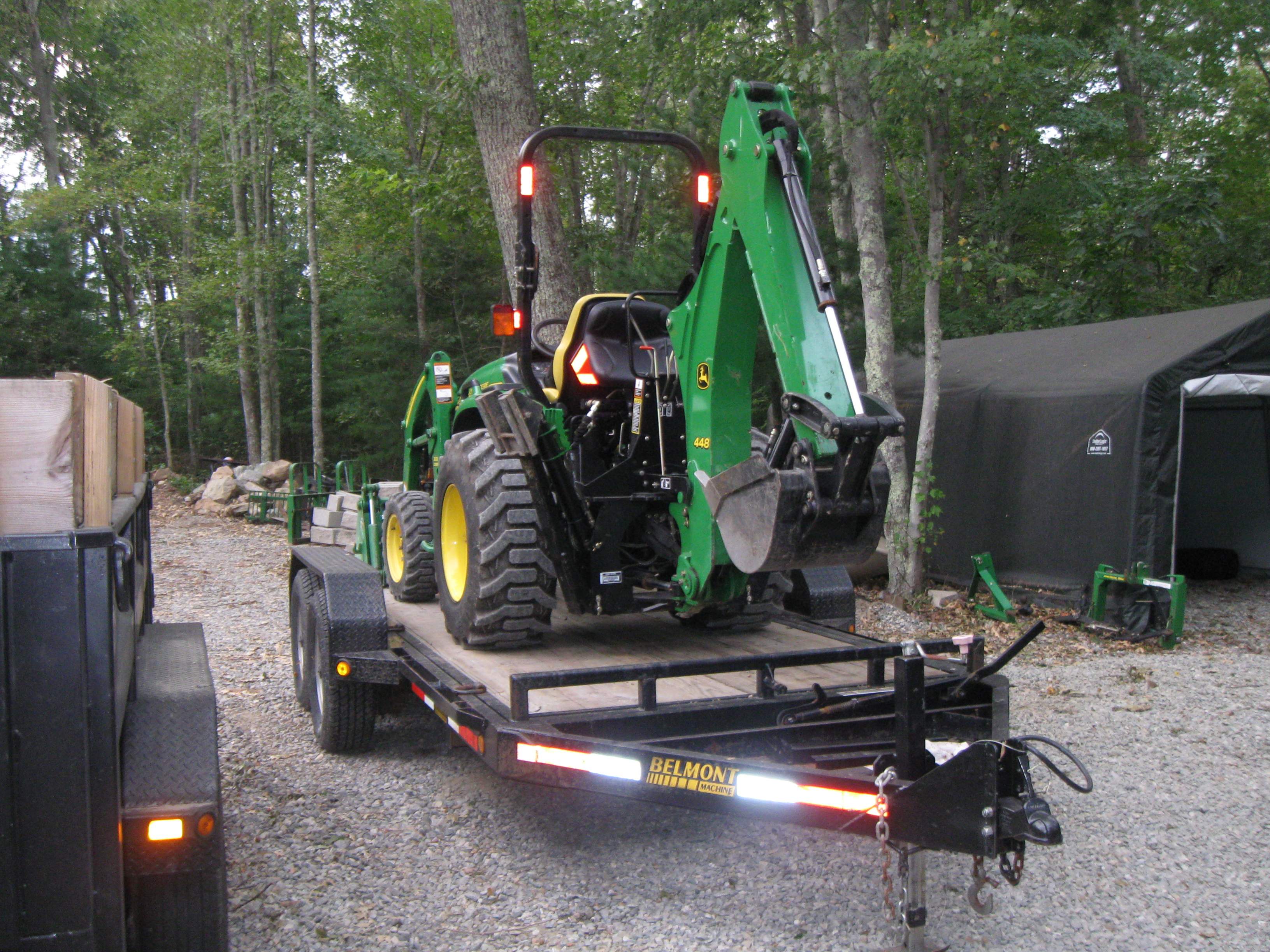

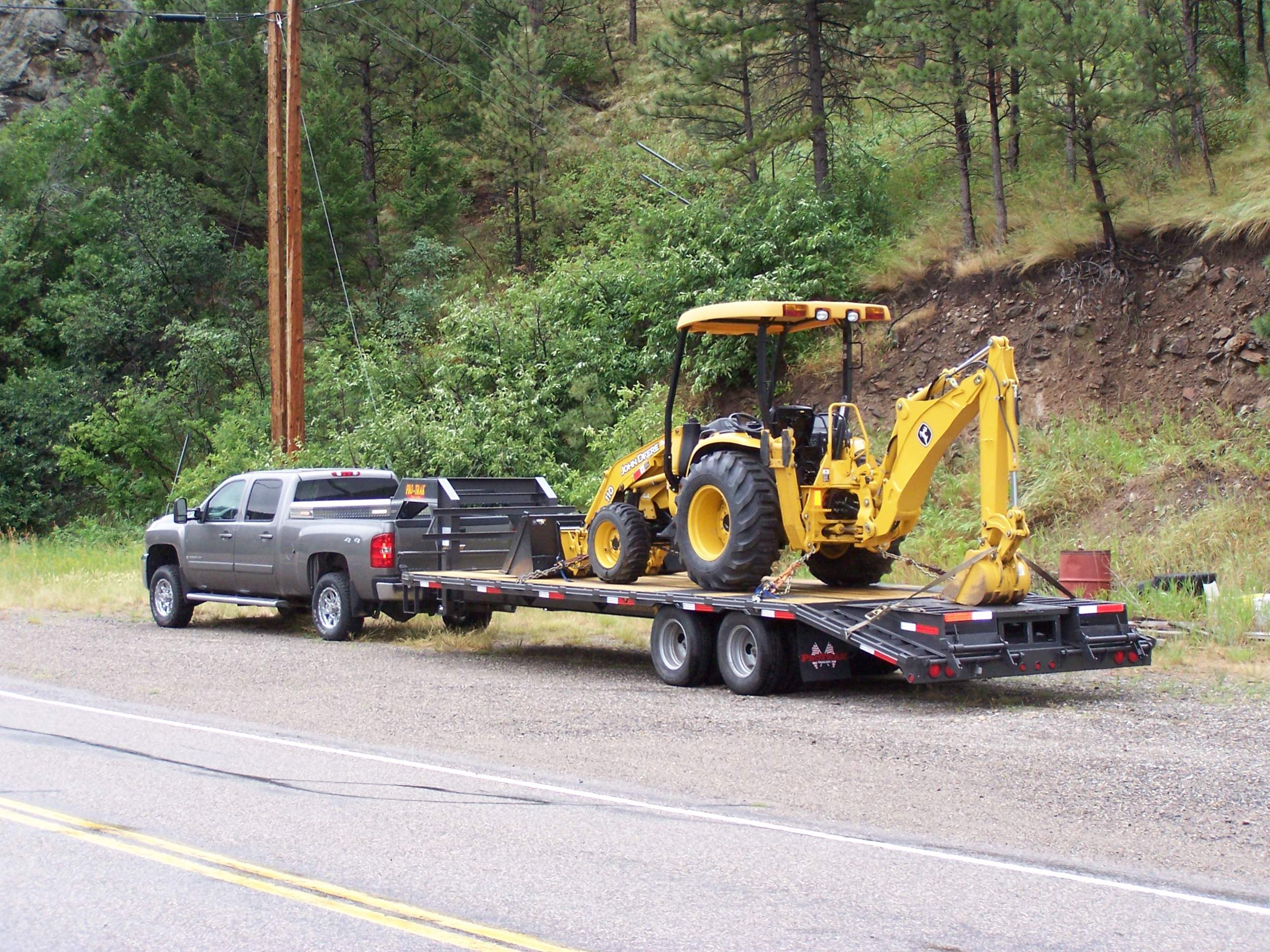

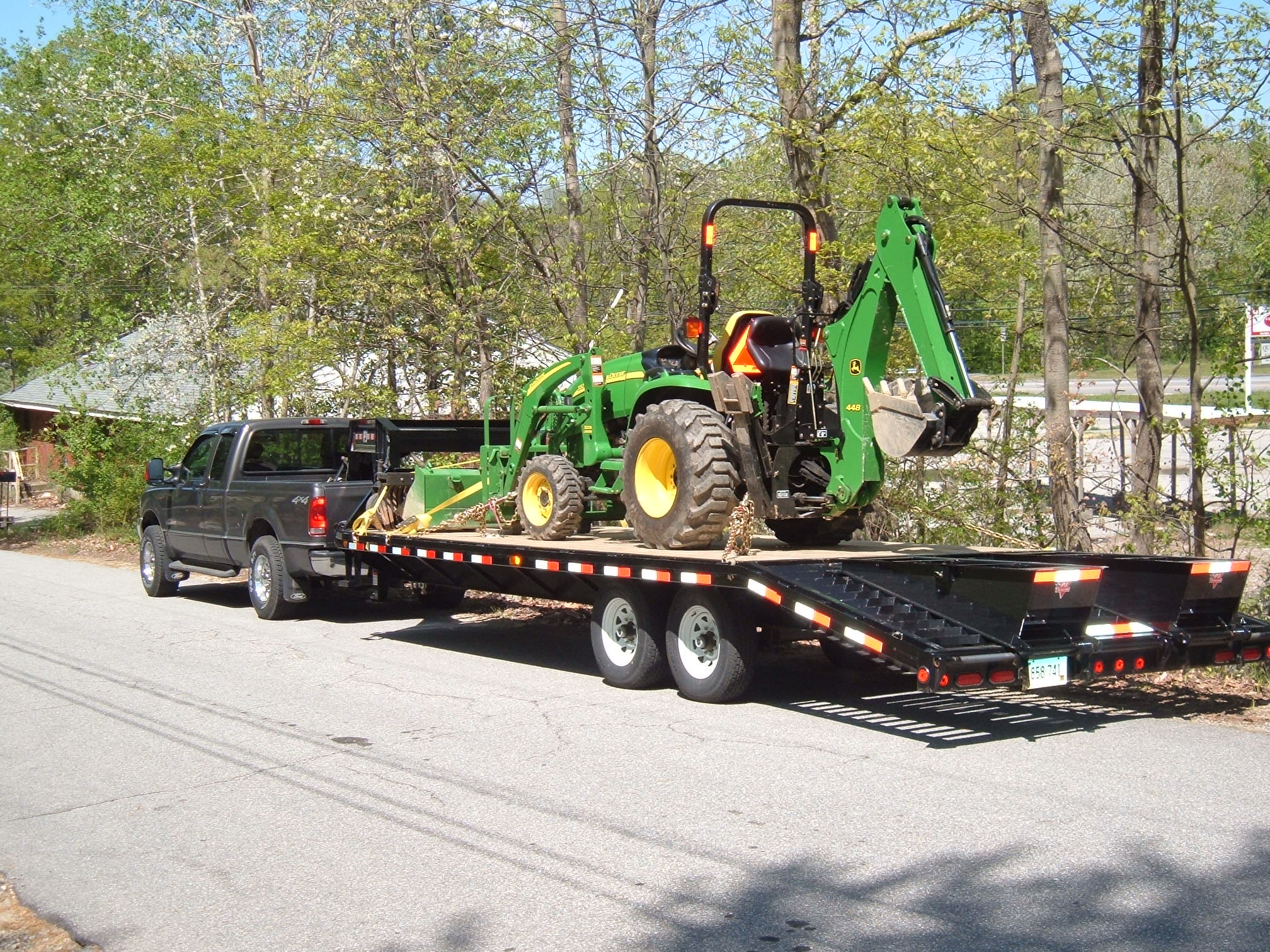

I have a 3000 series with lots of attachments too. I had purchased a 15600lbs gvw 20+5 gn to haul it. It's amazing how fast you use up space with attachments. Plus your able to shift your load around if needed. As far as tandem duals, do you need them well no but will it hurt? I doubt it. I ended up selling the gn since I couldn't store it on my property and picked up a BP tilt bed. As you can see it's a much tighter fit than the GN. Here's a few pics. (the one with the 110 isn't mine)
