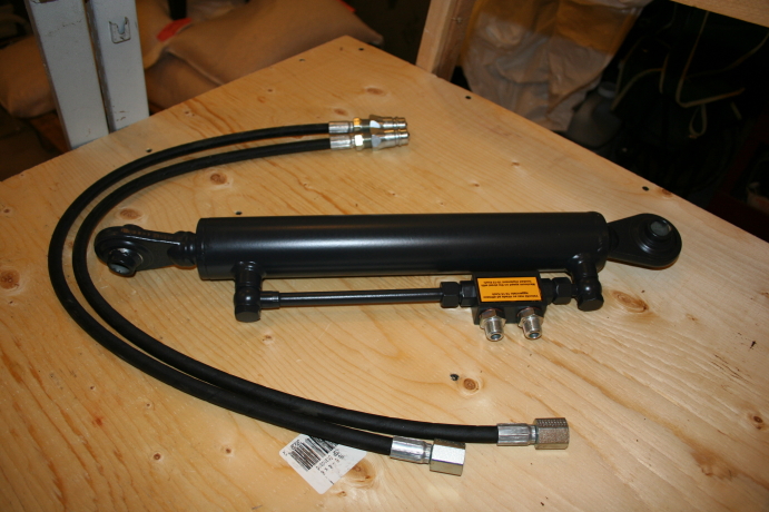

I received my hydraulic top link from CCM today. The hose ends and cylinder openings were not sealed when it arrived. Should I clean the hoses as I have read here in TBN before installing?

You could either blow them out with air, or pull a small lint free rag through the hose.
If it doesn't look dirty, I'd put it together and not worry about it. You're gonna love that HTL.

I gave the hoses a blast of air right after I took them out the of the box. I was thinking about the post which mentioned using solvent to clean the hoses.

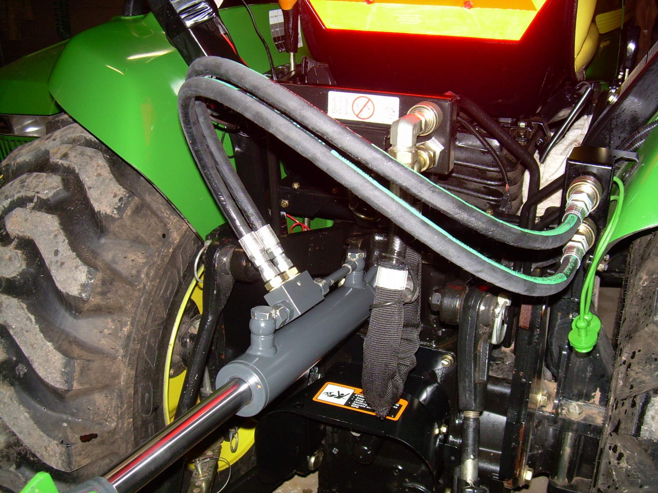

Don't know if you can tell in the pic or not. I bent the stock top link holder 90 degrees and it know hooks onto the cylinder fluid outlet that is at the closed end. Works great. I had to do some major reworking of my stock top link holder on my 7520 so that it would hold the hydraulic top link on that tractor.

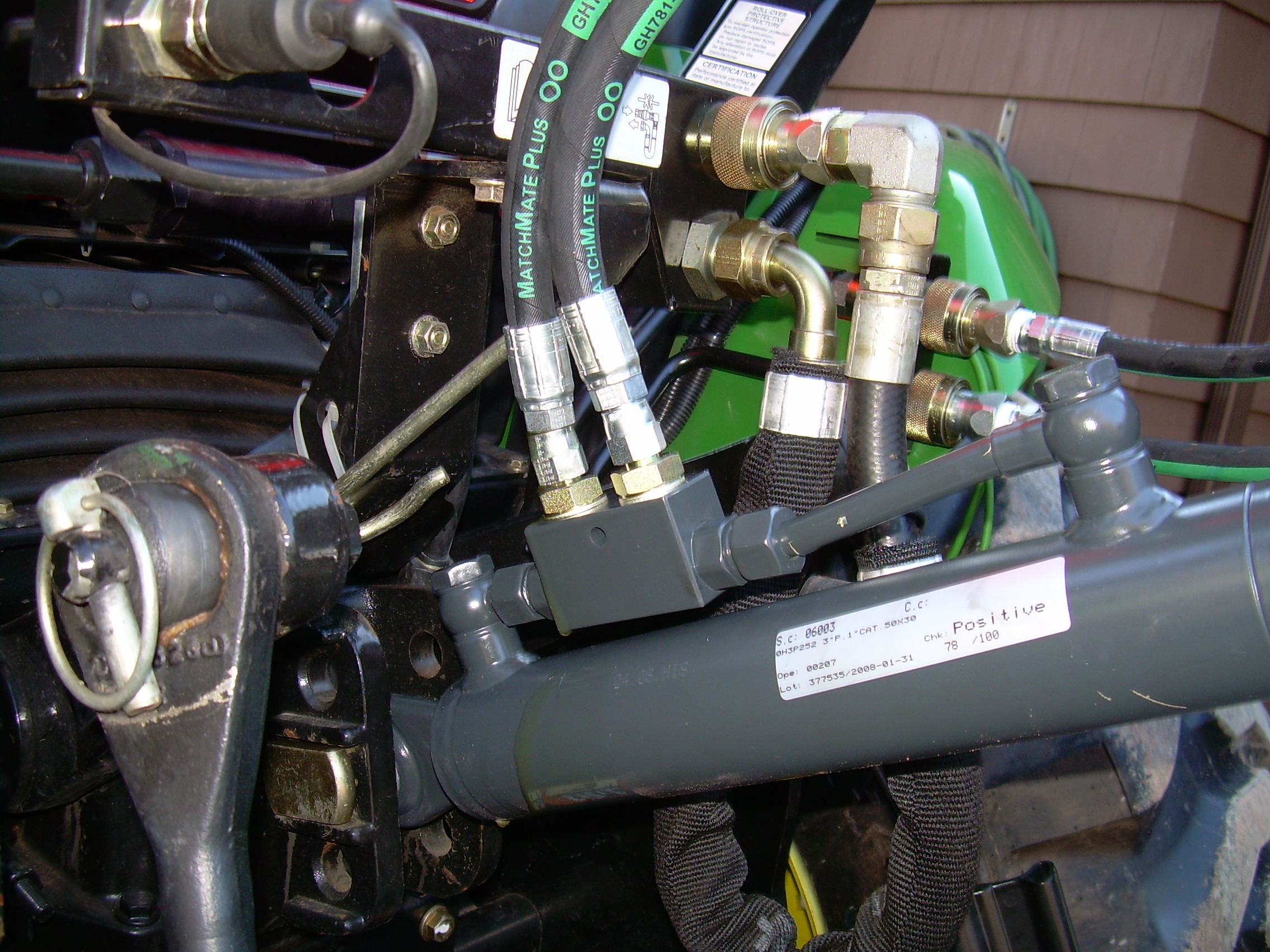

Just watch the fittings/hoses clearance/orientation, those hoses are stiff and cannot come in contact with anything close to the cylinder or you'll end up with what happened to me. First time I lifted the 3 point the hoses made contact with the PBY frame and bent the hard lines so bad they leaked.
Felt like a real bozo :(
Doesn't seem to be any best way to install, some put the hoses down, some up, some out the side etc. I changed the position of the valve and turned to the side a little, for the length of my hoses this has worked out best for me.
Good luck, JB
Good luck, JB

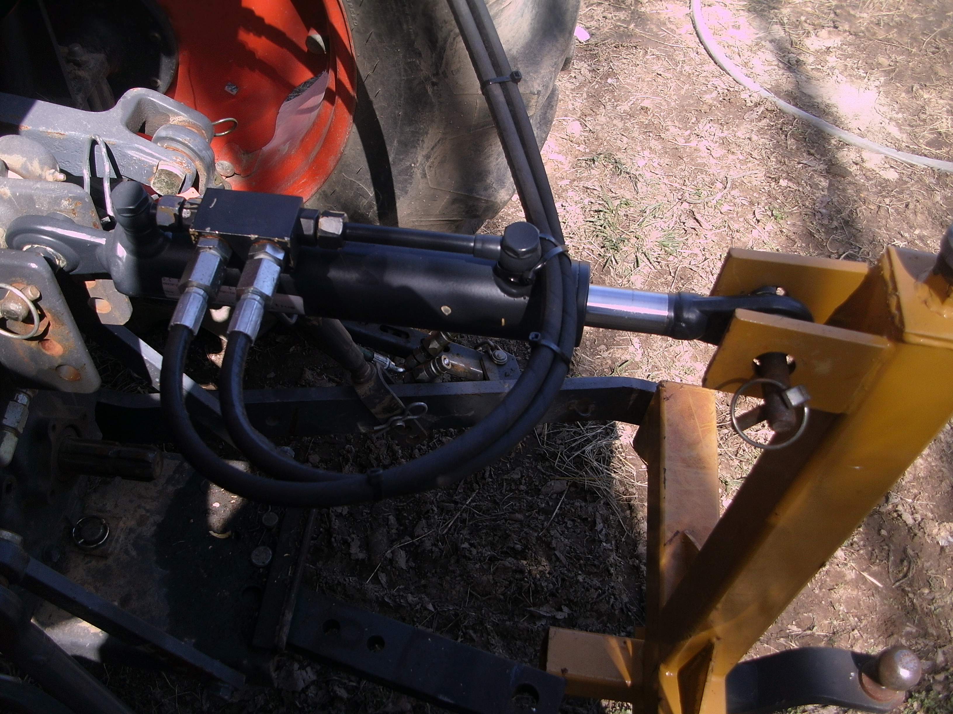

I got mine installed a couple weeks ago, but just got around to taking pictures yesterday. I ordered the 36" hoses so I could turn the check valve to the side.
I ordered it on the 17th of Feb, they shipped on the 18th, and I got it on the 19th. I installed it on the 20th. Now that is service!!!
