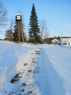

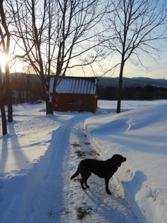

First 3 images show paths leading slightly downhill and West to barn. Snow in foreground, at intersection of paths, is 30" deep.

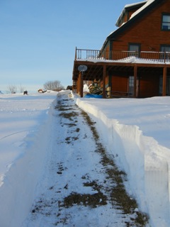

Path leading steeply uphill (North) to back of house through 30" of snow.

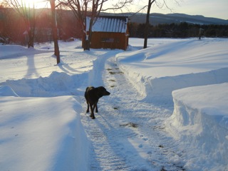

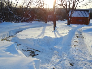

Path leading to East, up gradual hill, about 20" of snow, turning North and connecting to driveway.

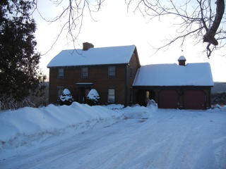

Driveway. Originally plowed. Big bank on left was knocked back with FEL and cleaned-up with blower.
The BX25 stays in the barn, so after a big storm, the need is to be able to remove snow while moving back up to the driveway. With the BX series, snow throwers are a way to reliably move through snow like this. The snow thrower is Model 2750D. BX25 has 2-link chains on all wheels. Rear tires are loaded with the beet juice -- no other real ballast. So far, so good.:)
Thanks to all who have contributed to this thread. Very helpful in coming to an effective decision.:thumbsup:
