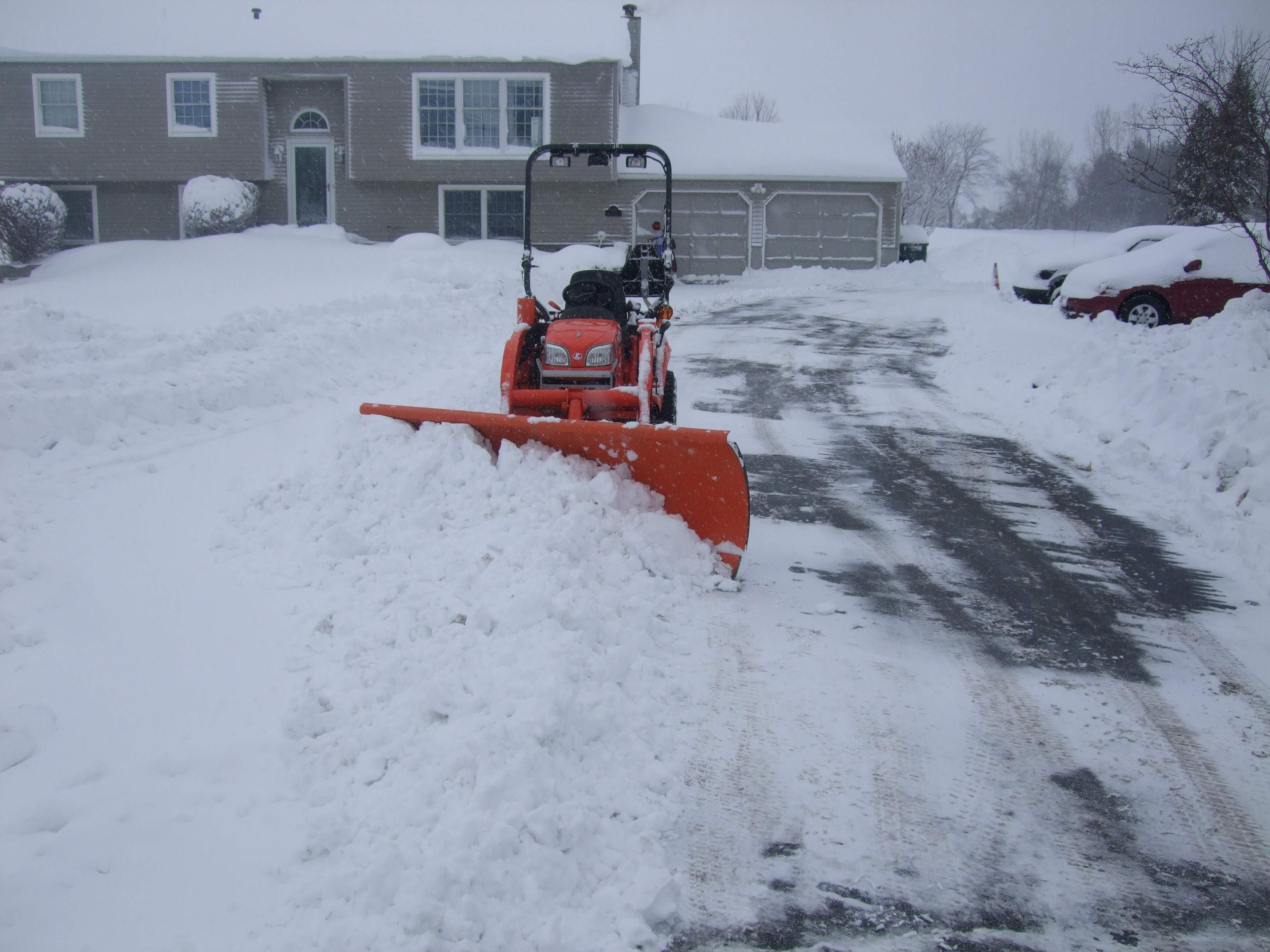

This is my set up that I purchased from another member it works great.
No digging into my dirt / gravel drive. Fast enough for me to go switch to the bucket to move the piles back or bring in firewood.

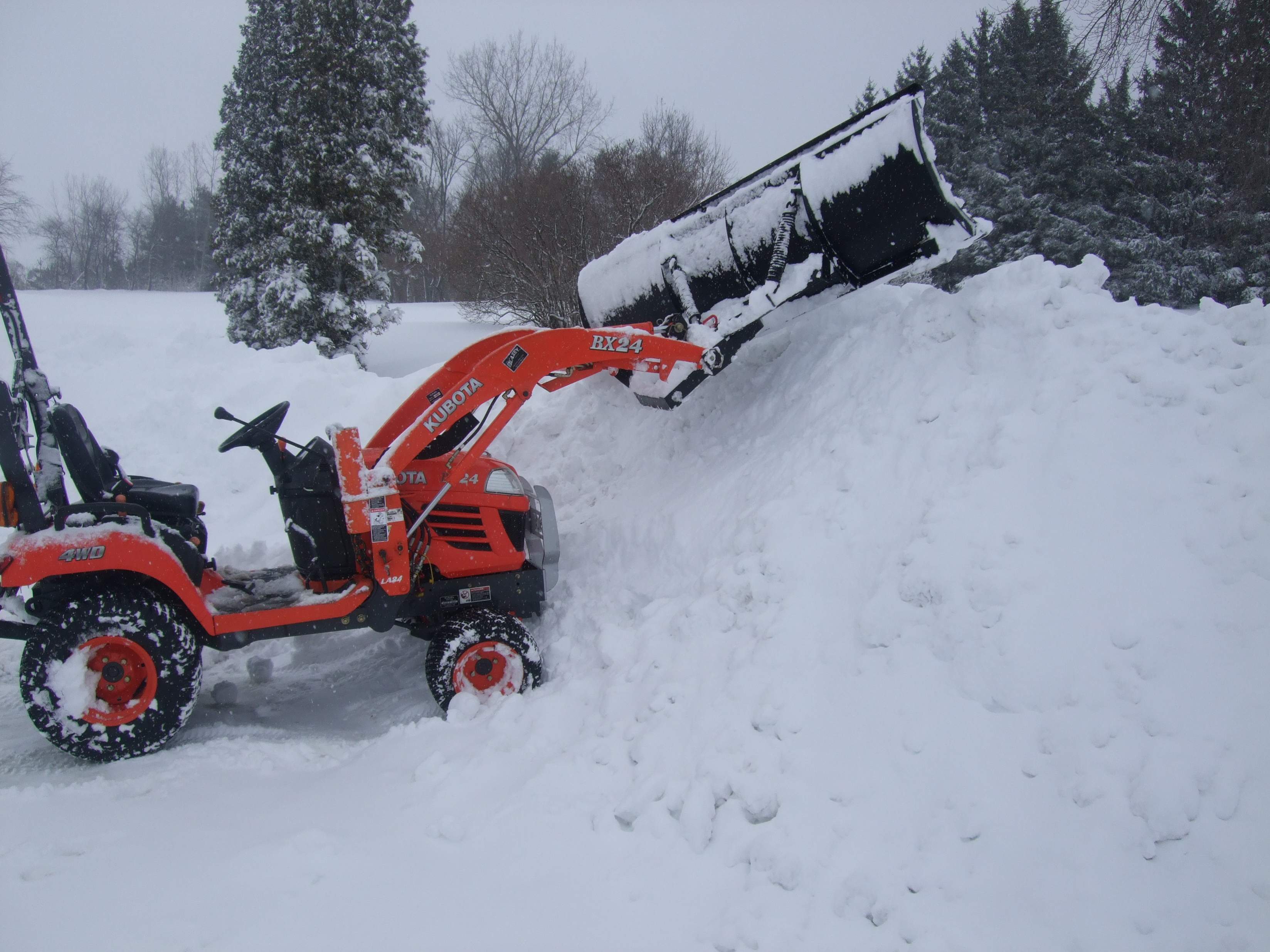

Or maybe this

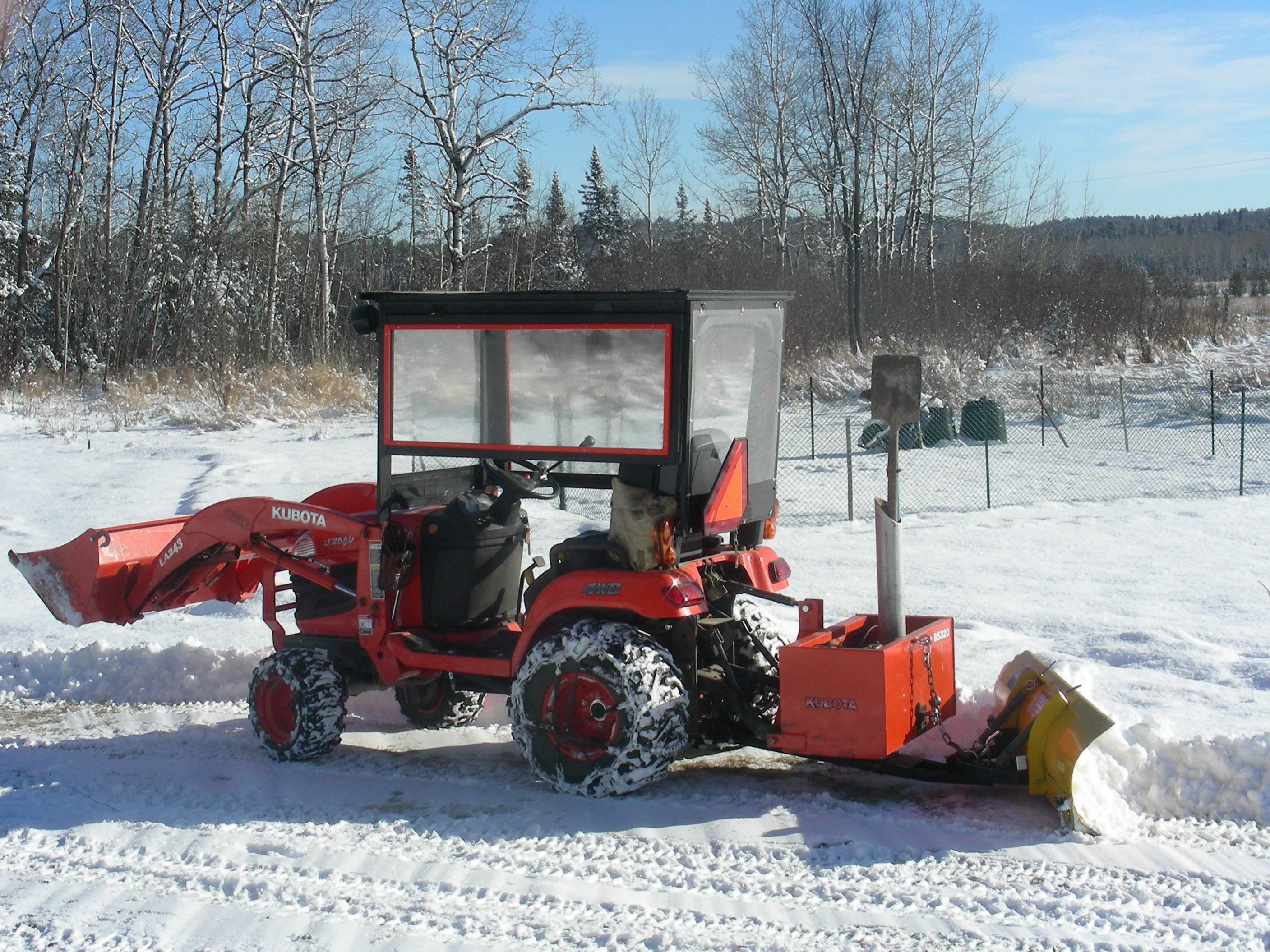

I'll put in a vote for the front-mount blower. Yep, it's definitely the most expensive way to go.
In my opinion, it's also the best way- certainly works for me. It's not as fast as plowing, but much faster than using FEL to move piles-- there aren't any! One pass, moving forward, and that snow is history. No high banks, either. I use turfs with no chains, as the machine clears its own path as it goes.
I do use the BH for rear ballast --it really works-- but the front end does get light when going upslope. Solution: one pass uphill, adjusting every so often to keep it in the center of my driveway, then the rest is simply done going downhill.
Blower will chew through amazingly tough and/or high snowplow ridges and/or drifts. Icy, crusty stuff not an issue, unless a shearpin goes. But even then, it's not too hard to replace them.
The other day I wanted the FEL to remove a pile over my bulkhead, and also wanted to grease the blower & driveline-- not a problem. Took about 15 minutes to take quick-hitch, driveshaft, & blower off, 5 minutes to put FEL on. Took about 15 minutes to swap it all back to blower duty. (With the blower, I've found that I only rarely need or want the FEL, anyway.)
So. There's my nickel. :)
