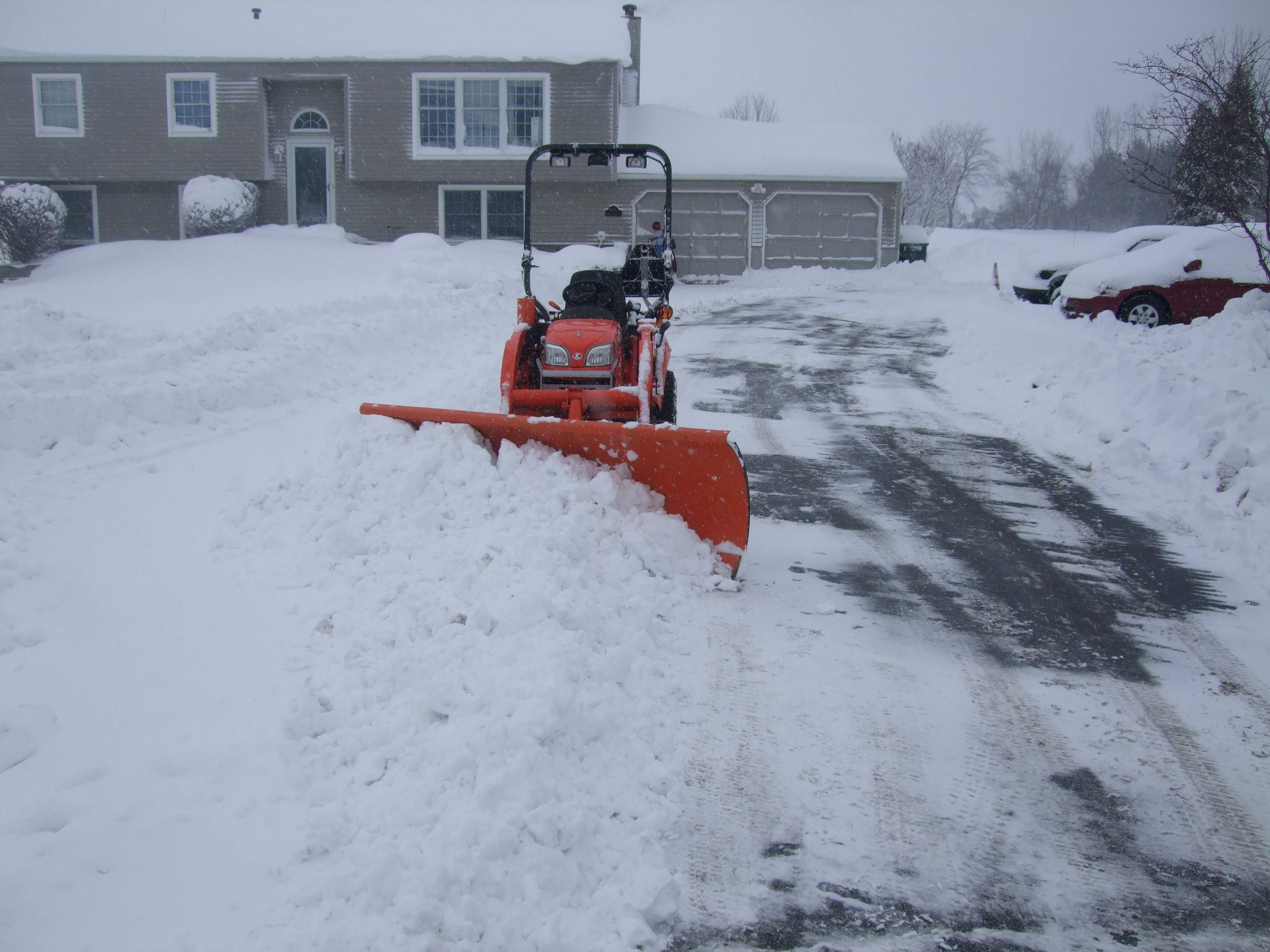

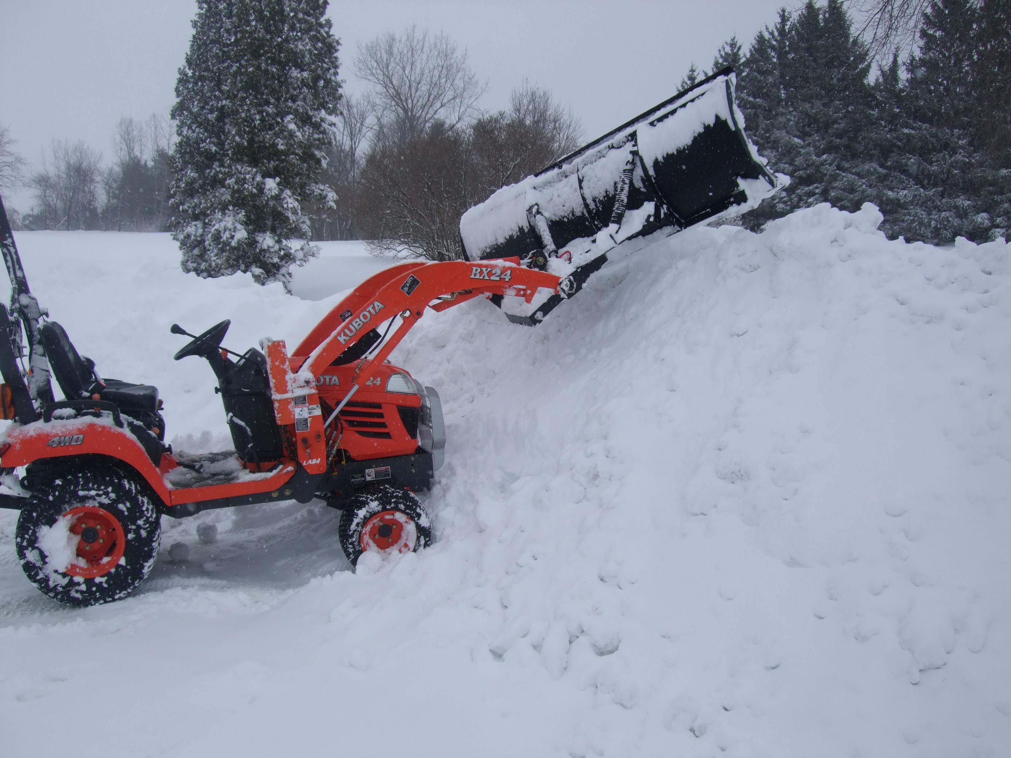

/ Another BX25 snow option question #30
JDonovan
I was not aware of the BXpanded blade until this post. I looked at the pictures on the website and it looks interesting.
Does it only hook to the bucket with the chain plus what looks like two slide on connections at the bottom of the bucket?
Does it slide around on the bucket when you use it?
It sounds like you are rather pleased with its performance. Can you give a bit more of a review?
Thanks.

/ Another BX25 snow option question #33
yes
no, not when adjusted properly.
here, now with video of it in use.

Thanks for posting the details and video. I had my first experience running the BX25 in the snow tonight. It was only a few inches, but convinced me that the bucket alone isn't much good in the snow. Your info was the final thing that helped me make a decision and I'm ordering one tonight.
yes

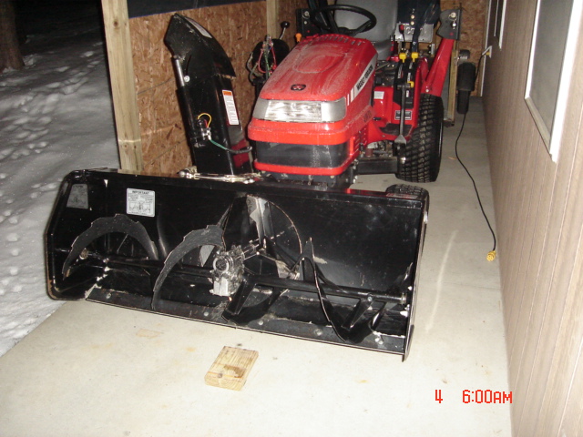

The 50" Ber-Vac Blizzard is the front mount thrower that Kubota paints orange and offers. Everyone on this blog who has one, likes it -- maybe even loves it. It is the price that hurts. In part this set-up is expensive because the mid-PTO kit and front Quick Hitch is required and, in part, because it is well made. (I won'tl need these other pieces of hardware -- so they offer me no real 'flexibility value' -- unless someone invents a rocket launcher attachament that I just have to get. Better yet, how about a reasonably priced stump grinder -- utilizing high RPMs of the mid-PTO?)
A back thrower keeps the FEL in place (good functionality and tractor balance) and costs less. The 'con' is that you are working backwards and a significant number of you have said that is less than great -- especailly if you have long distances, clear snow at night or during storms. (I have the last two.) To compare equal quality, my Orange dealer quoted the 48" and 54" Ber-Vac, PTO mounted throwers. They are as much of a beast as the front mounted Ber-Vac and the 54" is 4" wider. It costs about $2.4K and needs the 3PH ($170) that is optional on the BX25.
The front thrower costs more, $300 (@$2.7K with mechanical controls), you can't have the FEL on at the same time and you loose 4" of width. (50" is still 6" wider than the BX25.) But you work facing forward, mid-PTO has high 2500 RPM (vs. 540 RPM for rear PTO), your head lights may be good enough and because it is somewhat more popular, it may have higher resale value. With loaded tires and chains, traction should be good -- and eventually that back blade or box scaper in my future would be a good compliment (quick removal of light snow and balance).
Bring in Dich Chaney -- toss the coin -- its ... the front thrower (The $300 savings just didn't seem worth it -- projecting to the first time I'm out in a blizzard, in the dark, with no cab and auxilliary lights not yet installed.) Just shows you, the human mind can justify anything. I promiss, if this thing isn't a dream, I will report any anguish back to y'all.
Many thanks to Bob @ Giddings Equipment the Kubota dealer in Pittsford, VT for his insights and to all of you who have chipped in.
/ Another BX25 snow option question #37
:thumbsup::thumbsup:
I don't think you'll regret it.
And remember (from an expert at rationalizing:p...), in light snow --either not too deep or light & fluffy-- I can go with my blower just as fast as the tractor can go, no problem. High range, pedal to the metal. It's definitely not slow in those circumstances.
If the Kubota's anything like the M-F, it doesn't take long to switch back to the FEL-- but I doubt you'll need to.
Blow, baby, blow!
