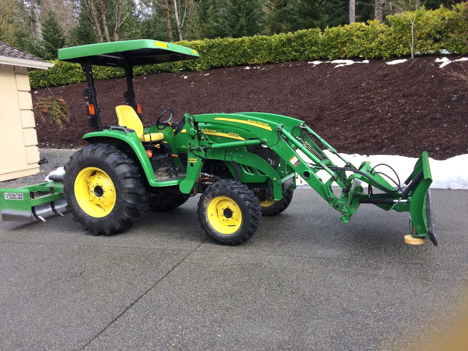

Not the best angle in the photo, but I can explain. I use a stall mat cut so that I can flip it to use both edges. Drill holes for seven bolts across a seven foot blade width. There is a steel plate on the front to hold it tight. The rubber edge lasts me years and I have a rough long drive - more than quarter mile. I also do a neighbor’s driveway. Anyway, gets lots of use. Highly recommend this solution. Happy to provide more information or photos if needed.
/ snow blade rubber edge help #31
Gary, do you typically take the rubber all the way down onto the pavement. If so, are you in float?
/ snow blade rubber edge help #32
I take the rubber all the way down and make strong contact with the pavement (asphalt and concrete) but not in float. With a 1” think rubber blade, you would be surprised how durable it is on a snow covered surface. The rubber edge extends about an inch and half or more beyond the steel blade.
Just to be clear, it works differently on dry pavement than it does on snow covered pavement. When I first set this up before winter hit many years ago, I wondered how it would work since I didn’t have snow at that time. As soon as I was able to use it with snow, then it was obvious.
