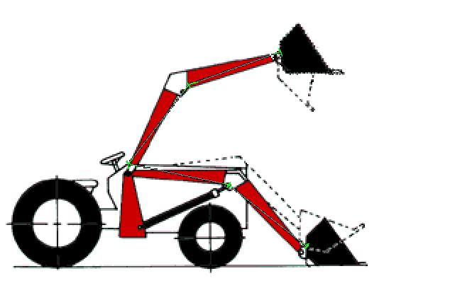

You guys got me thinking about it, so here's the "Just Gary" level indicator. I have not built one, but it should work.
You need to use two rods to get a level indicator that works for all loader arm heights. Make the first rod like you normally would, except don't put the upper end through a ring yet.
Now make a second rod similar to the first, but anchor it to the loader frame at the driver's end, and make it the same height above the loader arm pivot as the first rod is above the bucket pivot. Make a ring at the end of the second rod so that the first rod will slide through it. Attach a ring to the loader arm to keep the second arm in the same relative position on the arm (just like you normally do with the single rod, only anchor the second rod and put the first rod through the ring in the end of the second).
If you place a mark on the first rod where it passes through the ring on the end of the second rod when the bucket is level, the mark will always indicate level no matter what the arm height.
Like I said, I didn't build one, but if you keep the distance from the pivots to the rod ends the same and the rod lengths the same, it should work. Note that the ring on the end of the second rod will move on the arm, but the mark will be in the ring when the bucket is level.
The attached drawing shows an example of the principle. The rods meet at the ram pivot with the arms down, but the same length rods would meet above the ram end with the arms up.
I'm sure somebody will build one tomorrow and let us all know if it works.
- Just Gary

Would it work to simply fasten a rod to the side of the bucket (instead of the loader arms) via the bolt-hole for your toothbar and just attach a plumb-bob/string to the top of the rod? It should be fairly easy to eyeball whether the plumbline is inline with the rod at any height/angle of the loader and bucket.

I think you have the right idea, except use a vertical rod from the bucket and another rod attached at the top of that rod. The second rod swings freely and when the rods are parallel the bucket is level. Sounds simple and will work under all conditions. The rod on the bucket could extend to the rear a ways and then be bent vertical to get it where it would not get damaged when running the bucket into something loose. That would make it visible even when fully up. I may try this idea on mine.
