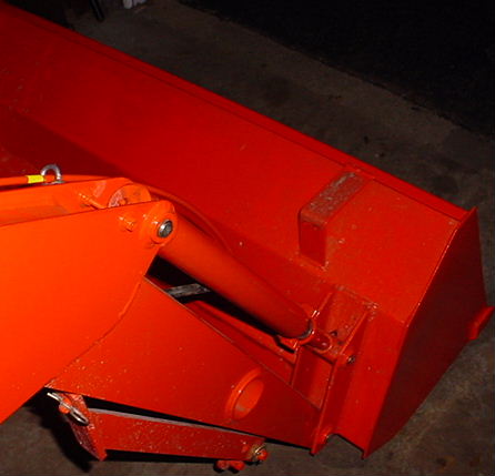

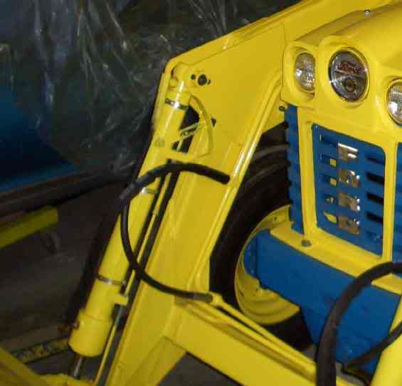

Henro I'm just guessing here but if the bucket geometry didn't change as the FEL was being lifted dealers wouldn't be selling a self leveling FELs on some model tractors, as there would be no need for one.
I like the fact that you can find the level position while the bucket is still high in the air after dumping a load of dirt and return to the digging position without lost time. Much more productive IMHO.
/ Another Bucket leveler #22
Here's the current JD leveler--looks a lot like yours!
/ Another Bucket leveler #23

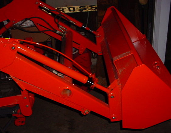

Bigdad,
Thanks for posting those pictures. I see that the level indicator tells level for only one position of the loader arms...
I guess for me I'm back to thinking that for my needs the simple kubota level indicator probably works best.
This is because since nothing is flat here, I may be working with the bucket at different heights, and not at one height most of the time. I can see how the level indicator like you have would allow you to set the bucket back to a given position rather quickly, after dumping the bucket. I guess if I were frequently scraping a flat surface, like cleaning out a barn or whatever, having a level indicator that showed level at the scraping level would be a great asset.
Anyone have a level indicator that will allow one to set level of the bucket at any height of the loader arms? The simple indicator on the Kubota bucket offers this capability, but only if my eye ball is calibrated well on a given day.

There is a way... Make the indicator a two piece arrangement. Mount one part to the loader arms so that it can pivot by gravity in relation to the angle of lift arms. The part of the indicator attached to the bucket is then matched to the swinging part of the indicator to determine where the bucket needs to be for level at the angle of the loader.
