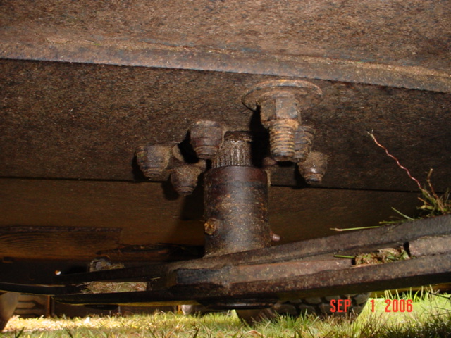

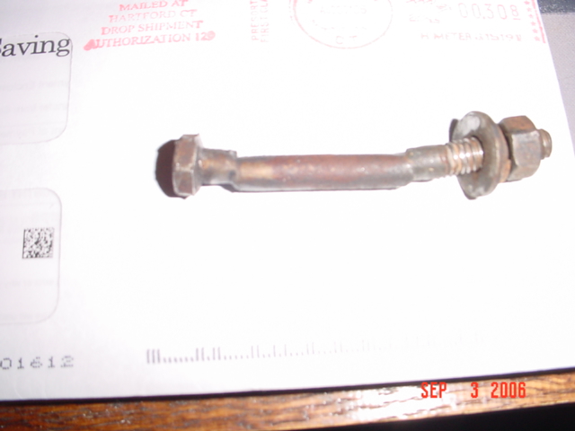

I took the blade assembly off the mower again yesterday. The splined shaft is in fact worn. I can feel a wear step on it at the top where the blade attachment stops. I also tried pushing it further up on the drive unit. It still rocks, but not as much. This unit has seen better days. I will try one more thing before just saying the heck with this unit. I am going to lift up the mower again with my bucket and try to drill the center of the shaft. If I can drill it, I can tap it and save it. If it is hardened, that would be out of the question. If not, Ill be buying a like new or brand new mower. I have put $100.00 into this one. With that, I made $300.00 mowing their fields and trees and got to do about 4 acres of my hilltop already. I also found that the two blades were bent upwards and turned up at the cutting ends. I bought a new set yesterday and tried them out hoping that the bolts would stop breaking. The unit still breaks the bolts. Here's the grade 5 5/16" bolt that I had in it the other day. You can see that it is stretched downward in two spots. This has got to be related to the looseness of the blade adapter and the shaft fit just pounding the daylights out of the bolt. I'll let you know how the drilling goes if the rain stops.
Jim, try the loctite retaining compound suggested in #15. Its a cheap experiment and may cure the problem. Yould be surprised how much stiffness this adds in a joint that has significant overlapping components. I did a 1-1/2 X 2" smooth joint on a 5" JD bushog blade drive yoke. I cut a bunch of stuff, trees and rocks included, before I broke it loose - - and the loctite was the only thing holding it! You have the splines. Filling the joint to immobilize the yoke should do wonders.

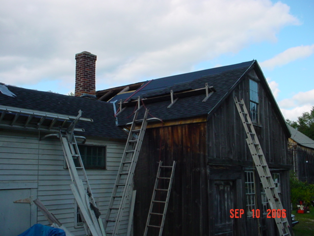

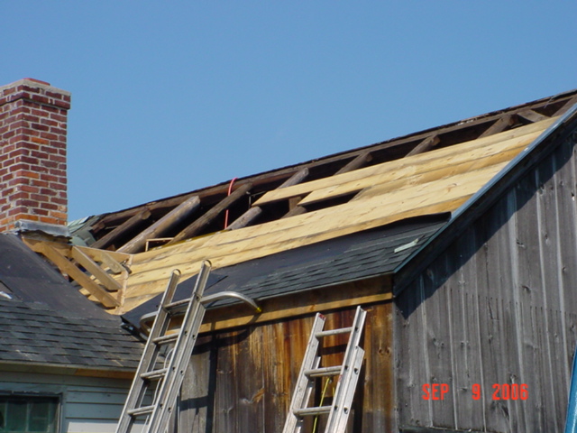

That project is on hold. I started a big roof job last week. This mower deck will have to wait. I also ordered the Loctite and it has not arrived yet. I will try the Loctite first sometime this week if I get a chance. I do have a backup plan if it fails. I just recently bought an engine lathe. I can knurl the output shaft to enlarge the metal. That should take up the slop in between the shaft and mower assembly. Loctite on them with very little clearance should hold it. Worse case scenario would be to drill and tap the end of the output shaft. Right now my mind is on getting this roof done. I still have the rest of the roof to finish on the building to the right side and the rear of the left roof behind the chimney to re-rafter and shingle.
