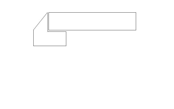

Could you use 16 foot 2x12's. That would give you the two feet overhang ( each end) on your piers for the ramp.
I could. Then I would have to build support for the ramps as well.

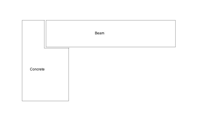

Oh yeah, I like that. :tractor:
The concrete support does span the entire width of bridge. It's a round column that supports the beam.

One thing to remember is that not all pressure treated wood is rated for ground contact. As dirt collects on top of the cement between the wood it will start to rot much quicker.
I'll be sure to ask. Thanks.

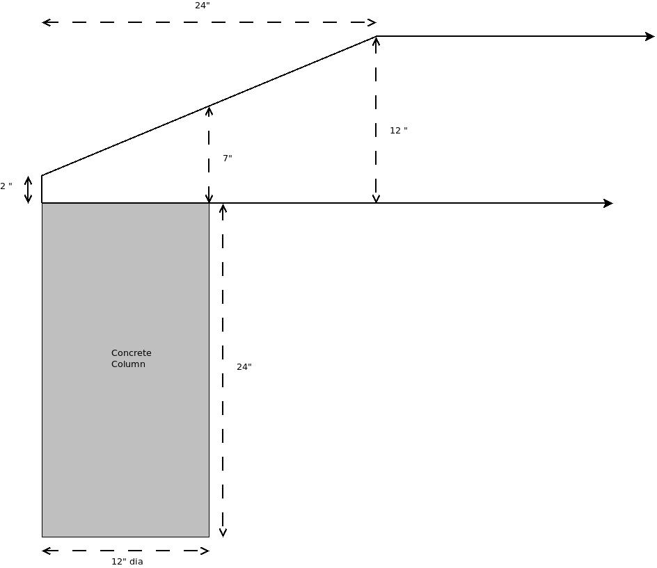

For the approaches you could build some ramps out of 2x6. They would be semi sacrificial.
You could also get some timbers to lay in front of the bridge to form a ramp. A 8x8 then 6x6 then 4x4.
The stair step idea is a good one to consider. Thanks!

For the flitch plates check with local fabricators or steel suppliers. If you have a plasma cutter or oxy acet outfit or know someone that does you could easily cut them yourself. Migh need a welder if you can't find long enough sheets for a decen price.
/ Another Bridge Thread #29
The ramps would be cut from your overhanging beams. Nothing extra to build. Under fill with gravel.
