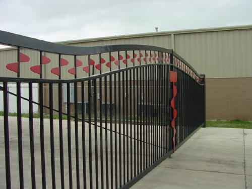

I think the three beam thing will work just fine. One in the middle and another on each side that would be under the track of the Mule. An six foot wide bridge would have beams at twelve inches in, another at thirty six and the last at sixty. The handrail isn't that much harder on an arc than it is on a straight line. And it's a whole lot more fun to do.
For the hand rail we could use either small pipe (inch and a quarter or inch and a half) or square tubing. We'd need fourteen of these pieces. They'd be shaped like an "L" with the horizontal leg going back to the beam. These would be welded into place. The vertical leg would be the supports for the hand rail. The handrail could be wood attached to the steel via self tapping screws. They could be steel with wood or just steel.

Here's a sample of what I'm talking about with the bending of the tubing.
