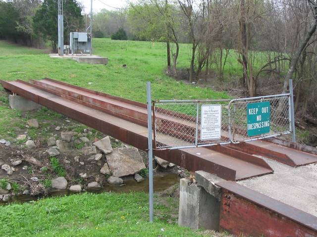

Here's a side view.

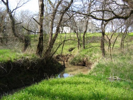

Alan, I have seen the water gushing out of the culvert and the rocks don't budge. I can drive over the bridge with the truck or tractor. Water has risen to the top once during a flood but then goes around the bridge in a high water channel which is about 2 feet lower than than the top of the bridge. I had a bulldozer cut the (flood) channel but it could have been done with a box blade. I will attach a photo of this bridge in progress, the dirt pile was used to fill in over the culvert and was tamped in. I will take some photos of another bridge (just starting) with a larger 6' culvert upstream and post it in a few days.

If I recall this bridge is only needed for a thousand pounds or so. It looks like a twenty footer will do just fine.
Here's a suggestion. I'll supply the equipment, welder, trailer, tractor, etc. The rest of ya'll norte tejas TBN'rs kick in helping hands and we'll have a bridge building one saturday or sunday.
Alan can spring for four pieces of two by four eleven gauge twenty four foot long along with whatever he wants for decking, wood, expanded metal etc. That and some posts for the ends along with whatever concrete he needs we can do it in a day. Or at least have it where he can deck it by himself if necessary.
The plan. I'll lay out a pattern on on piece of the rectangular tubing. A couple of guys can do what that requires. When they're done I'll weld that piece up and we can have someone else grind the welds. When we're done we'll have three arc'd pieces with about a three foot rise in the middle. The fourth piece of tubing will be for connectors between the three.
We'll need an M.E. to verify the load capacity for a bridge so designed. I only think'em up and make'm. Someone else has to tell me I did right or wrong.

A bud makes some of the best trailers, carhaulers, in the world using two by four eleven gauge. When you add in the strength of the arc I'll bet this framework can hold more than a Texan on a Mule.
The way I arc rectangular tubing is I lay out and cut slits with a portable bandsaw. I have my cuts on the outside of the arc. I generally go for a spread of each cut that's about twice the size of the cut itself. For a tight radius I put the cuts close together and for a slower one, farther apart. I then weld up the gaps and then grind them smooth. Folks who see some of my work just assume I have a roller with some kind of capacity. In fact it's just a little work and a lot of patience.
More important than the arc will be the footers--posts at the edges of the bridge. They have to be substantial enough to resist the tendancy of the arc to straighten out when there's a load. We could put some horizontal braces to make it really strong but that would take away from the beauty of the arc and provide a place for debris to hang up when the water's flowing high.

I stayed up half the night trying to engineer this thing. What I can see drilling 2 9" post holes on either side of the creek. Have to try to get them square with one another, which is a problem because the creek is pretty much impassible when it has water in it, and fairly difficult to cross right here even when its dry, due to steep creek banks.
The posts (some sort of metal posts I guess - something like water well casing depending on cost) would be cemented. Then about a foot-deep hole would be excavated between each pair of posts and some reoar put in there. Then, build forms to build up the footings another foot or so, so that the concrete is 2 feet thick.
Depending on design, if the beams need to be anchored to the footings themselves, then threaded studs will need to be set in the top of the footings in the exact locations needed, to bolt the beams down to.
As an alternative, using an all metal frame design, all of the frame could be welded between each pair of metal poles, and the rest of the concrete footing might not even be necessary at all. My PHD will dig about 36" deep, hopefully that would be deep enough to anchor the posts. Perhaps a 12" auger is needed.
The Kawasaki mule that I currently own weighs about 1200 pounds, so with two people in it, and some cargo, figure 2000 pounds. The bridge will primarily be for foot traffic however.
The arched design Wroughtn_Harv is describing sounds very good to me, although its sounds like a lot of sawing and welding on his part. The bridge will need some handrails also (so my grandchildren don't fall in the creek), which would seem difficult in an arched design since everything has to be curved.
I would be perfectly happy with a straight, not arched bridge as my second choice. If its 6 feet wide, it would seem to need four beams, so the decking would only span 24" between beams.
When the bridge is done, later on I plan to run a water line across the creek, and figured the structure of the bridge would be the logical place to run it, although I would need some way to keep the pipes from freezing.
Am I correct in assuming the cement anchoring the posts would need to be set up before any major work is done on the span? Assuming this, it would seem that this would need to be done ahead of time. This might only consist of setting 4 posts, no other concrete footings at all. Also, I suppose the posts could be left sticking up at lease as high as the handrails would be, then cut off later to the proper height.
Of course about July is the driest time to be working on the creek, but it is also pretty dang HOT about then.....
This is the stuff that kept me up all night......
