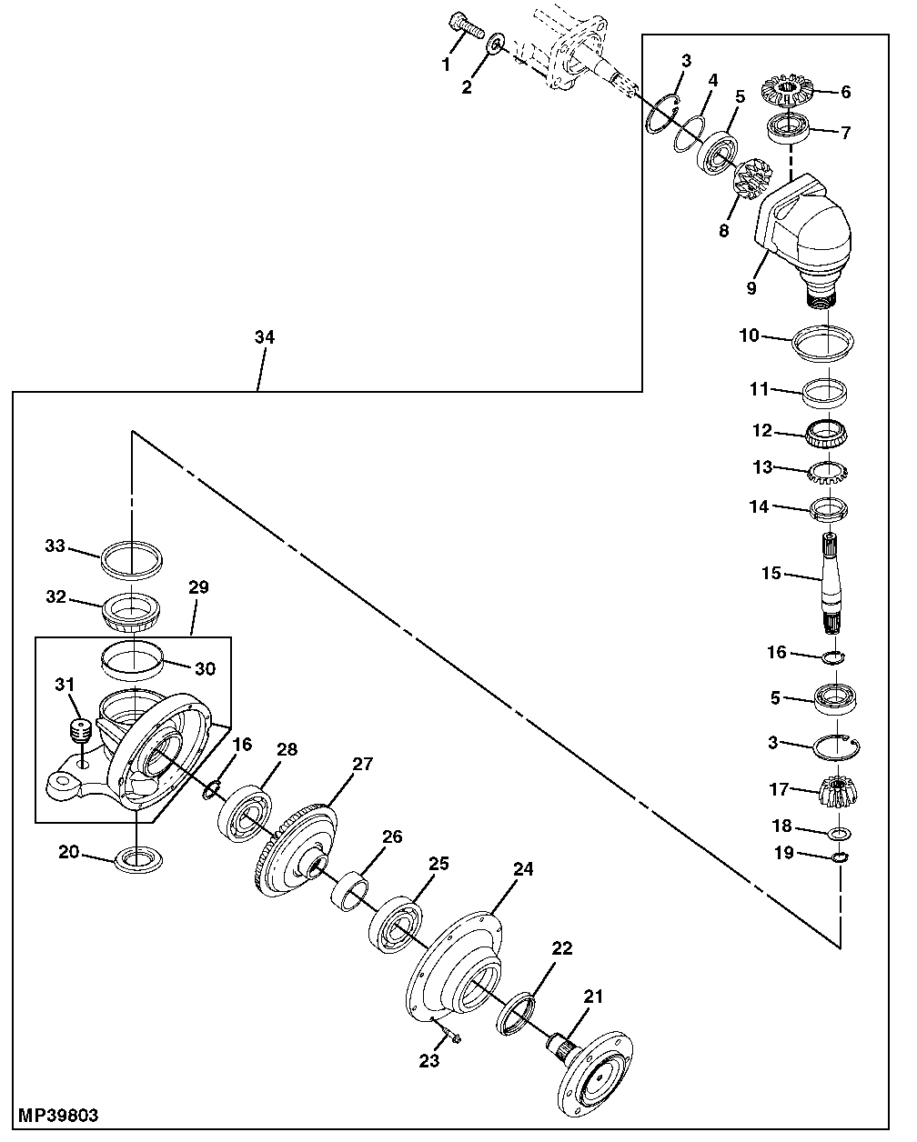

Well, it looks like the front axle seal near the wheel is leaking. I looked at the parts manual, and if I am looking at this right, just this seal should not be a big deal, with no special tools needed. Am I missing something?

It's a great time of year to sell and install axle seals for compact tractors. The axles are mostly unvented, and the warmer weather expands the air and oil within the axle. Often a little oil will be pushed out of a swivel seal or axle seal. Sometimes the leak persists and a repair is indicated. Other times, the area can be cleaned up, the axle fill plug loosened to vent the axle, and life can go on.

Yeah, the hub seal is easy, but you have to take off the #14 nut deep
inside the housing to get at the kingpin seal. After removing the
pressed in cap at the bottom.

The pivot seal on the front axle is not an easy repair.It takes a special spanner nut socket to remove the spanner nut that holds the sections together
/ Another 4400 front axle leaking! #8
It takes a special spanner nut socket...
....like this.
The photo shows the #14 nut from the above parts diagram. I made my
own special tool out of some sched 40 pipe with 2 weld beads for teeth.
This was the toughest of all MFWD hubs I have been into (4 different ones).

I agree. I have done dozens of Ford/New Holland, a few Kubotas, an older Deere 855, and one of these. The spanner nut was a PITA without the proper tool.

figures....go outside today to do some stuff...i happen to look over at the tractor and there is all sorts of fluid on the floor. looks like a front axle seal!!!!! #33 (or similar - haven't looked at my axle spec #) in the previously posted jdparts diagram. from Dfkrug's thread, this appears to be the dreaded kingpin seal.
