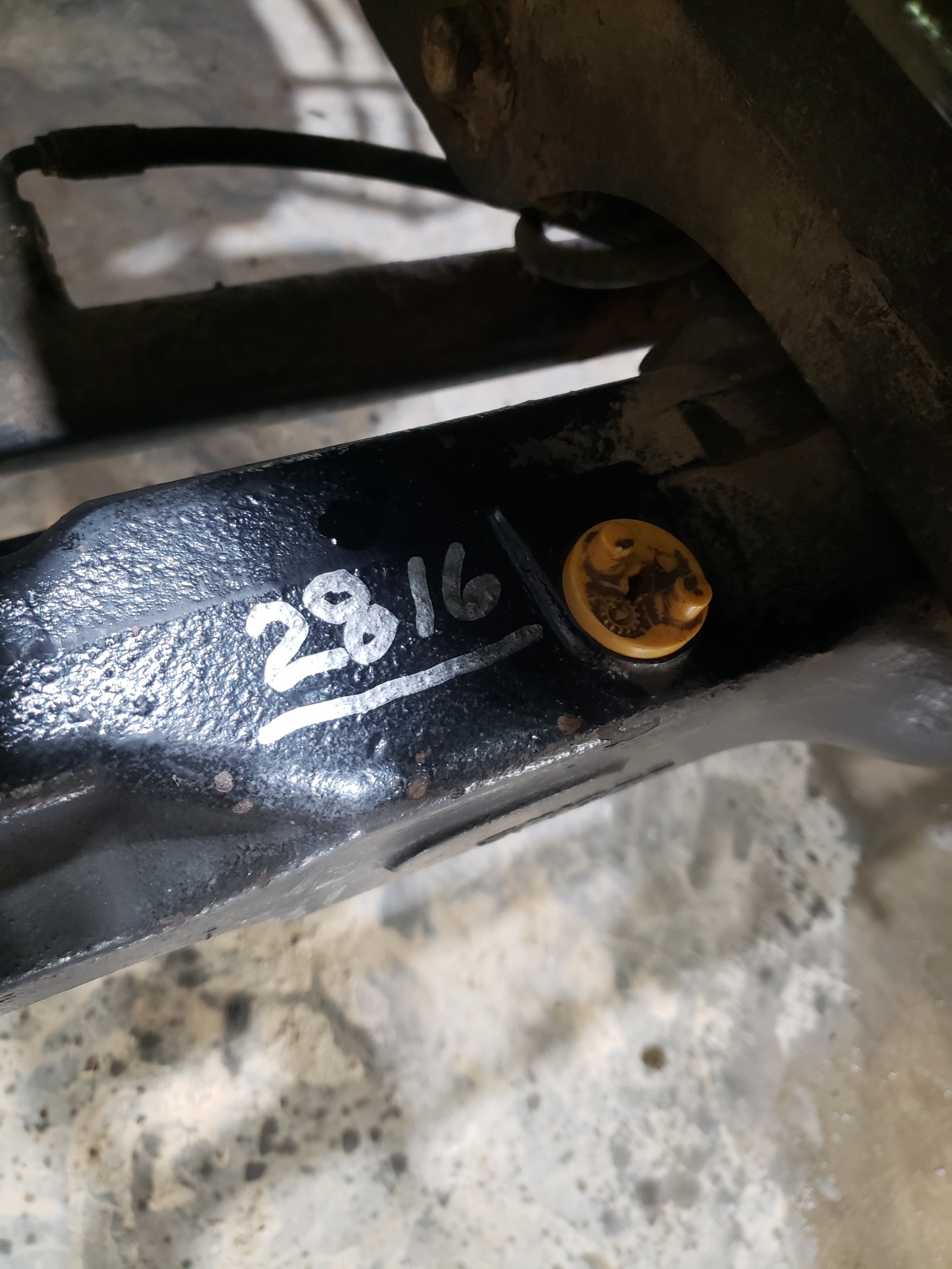

If I understand "logcabin" correctly, then fluid should be above the cap. Isn't there a drain plug (key item B in oldtimer's reply #16) also just above that cap implying that is where the lubricating fluid resides? Not understanding which "seal" is being referenced.

WOW, Thank you "been there" you hit it right on the head. YES there is a drain plug on each side. It never clicked where the plug is in relation to the cap. I called united ag in vermont, unfortunately they were not much help, I called another dealer closer to me. The mechanic said the SAME thing! The drain plug locacation compared to the location of the collar plug as it is called. PN LVU20868. Some how when puttling fluid in the axel it makes it waytot he void area where the camp is. He stresse the importance of getting the plug lined up straight when inserting it. Hopefully I have a big enough socket for the collar plug. Instead ot tapping it, I am going to try a bottle jack pushing against the socket and hopefully I can insert it by pressing it in place. Won't till early February when I return form Montana.Thank you "beenthere". You are in south Wisconsin? I believe route 90 takes us into the southern Wisconson area.

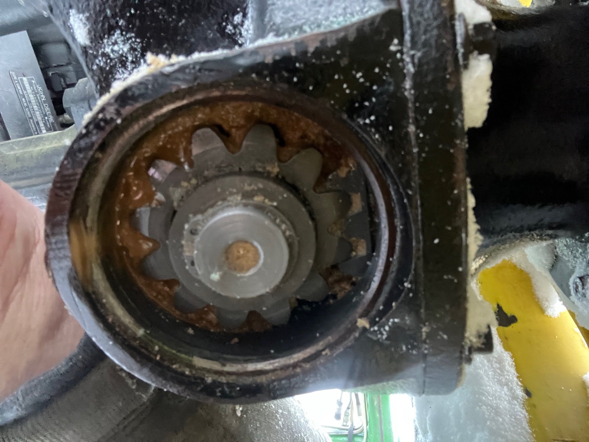

If it were me, I would remove the front axle and get it into a warm place to work on it. I would flush out each spindle assembly, maybe use safety solvent. The oil as shown is frozen because of the moisture. I would do one side at a time setting the axle on a incline. After the flush you could rotate the axle with the end caps/ plug and plug collar, Pt 30/ Pt 30/ up for assembly. Like super55 said those end caps/ plugs are difficult to install/ easily cock etc. Worst case you may have some pitting on the bearings from the moisture.
As a note, when my tractor was new, the front axle pinion seal leaked. The JD service rep said the these front axle were bullet proof except for mine. It took them 2 weeks to get it repaired. They needed a thin wall deep 1.62 socket which they order from Snap-On. Later

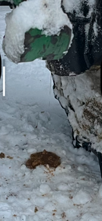

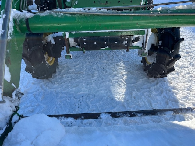

What are the odds? The left front tire where you drain the front axel fluid, I noticed a fluid leak. Brownish colored on the snow. Tractor hadn't moved in a few days. The day before there was nothing on the ground. Well ok, must be a seal under the housing. Next day there was a lot bigger spot. Two days after the left side, on the right side was the same thing!! Tractor still had not moved! 18 years old both front sides leaking within a couple of days apart. Anyone seen
What are the odds? The left front tire where you drain the front axel fluid, I noticed a fluid leak. Brownish colored on the snow. Tractor hadn't moved in a few days. The day before there was nothing on the ground. Well ok, must be a seal under the housing. Next day there was a lot bigger spot. Two days after the left side, on the right side was the same thing!! Tractor still had not moved! 18 years old both front sides leaking within a couple of days apart. Anyone seen anything like this?

Might be low temp related. One question, did you change the oil in the front axle at the recommended intervals? A lot of people have the original oil, along with all break in contamination, still flowing through the system.

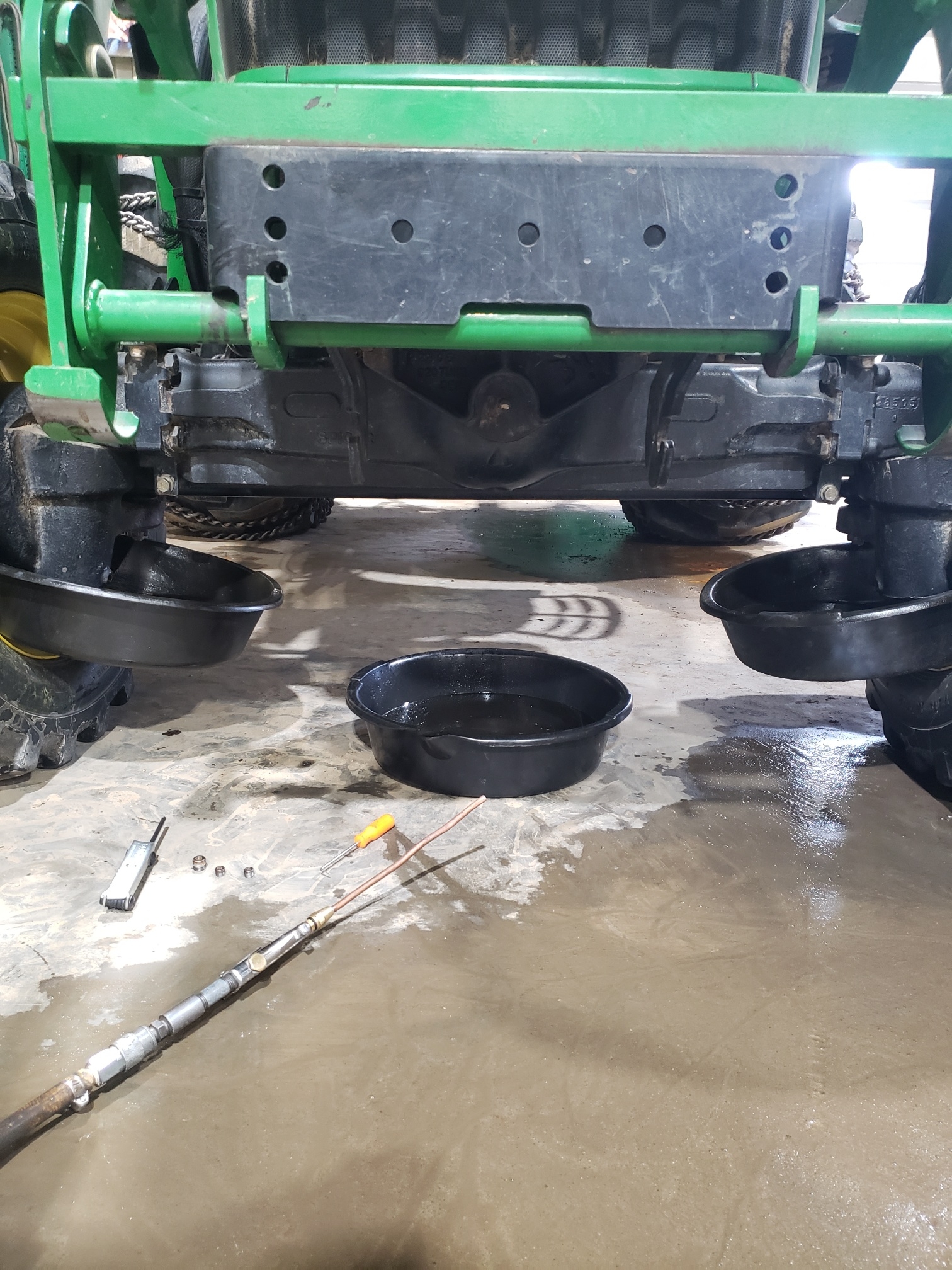

Just a follow up, I changed the fluid in my front axle. The oil that drained out looked good but dark colored. I could not notice any moisture / cloudiness. All set for another 600 hrs. It's been to cold to warm up the front axle, but the tractor was inside a heated garage. I drained the oil for about an hour and also used and air hose to force out any remaining oil. Later

Well, sorry for the delay but here goes. Putting the caps in, at least for me was no easy task. As mentioned earlier they have to go in straight. I didn't have a large enough socket to encompass the entire cap so I used a 3/4" socket which set on the flat spot of the cap. The problem was, on my back, holding the socket and now I have to tap it. Try tapping it with two months prior total shoulder replacement. Needless to say that was a NO GO!. I mentioned earlier about using a bottle jack. Had to remove tires to get jack in the proper position. I went to auto store to look for a socket. cheaper than having the delaer do it I guess. I found a 65-67 mm oil wrench which fit the inner part of the outter edge of the cap. Perfect! Everey time I got what I thought was perfect to push up in housing, it seemed to not push straight. Quite frankly it was pissen me off!. I went back the next day to try again. Same thing so I pushed anyway with the bottle jack. It went in really slick but just wasn't setting like it should. I took a hammer and gave it a tap. That sucker bottomed out perfectly! Damn, it worked. Did the same thing to the other side. It worked again. Speaking with a JD mehanic he suggested to use a dab of red or black gasket maker to give a litte extra protection. I had a tube of "seals all" which is rated for -40 - +150 F. Good for gas and oil on the package. I just put a dab on the outter edge of the cap all the way around. I attached a photo taked today. 2/14/25. The photo is two days after putting in the caps, refilling and pushing snow 5 or 6 hours. At this point all appears normal. I want to once again say THANK YOU to everyone that took time to write something that pointed me in the right direction. Every single input help me, it truly did!!!
