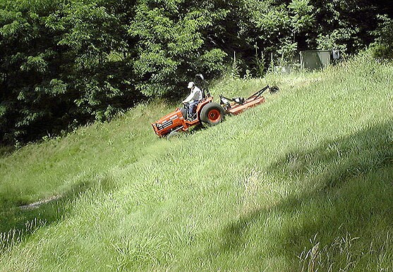

I go up and down a slope ~25° everytime I cut the grass. I have the FEL off normally when I mow. Don't have any front weights either. Hasn't been a problem. I use 4WD. I use a low gear.
Remember, with the cutter rigged to your 3PH, that's going to reduce the back roll over potential. Of course, that's with the cutter on the ground...not in the transport position.
Driving down...don't assume that wouldn't be a concern! There's a possibility the tractor could over run if the slope is steep enough. I'd run down it in as low a gear as possible, at least for the first few cuts.
The attached pic was posted (on TBN) by another fellow whose name eludes me. You can see what he does.

Roy, Thats a great shot of a good looking tractor!!!....Of course I may not be the best judge, as thats me on the tractor! And that hill is alot steeper than it looks!
/ Angles...back flip VS rollover? #9
"...thats me on the tractor!"
Hey Von!!!
Yeah, that slope looks pretty intimidating!
I'm glad you spoke up...had that pic long enough, I'd forgotten who posted it!
