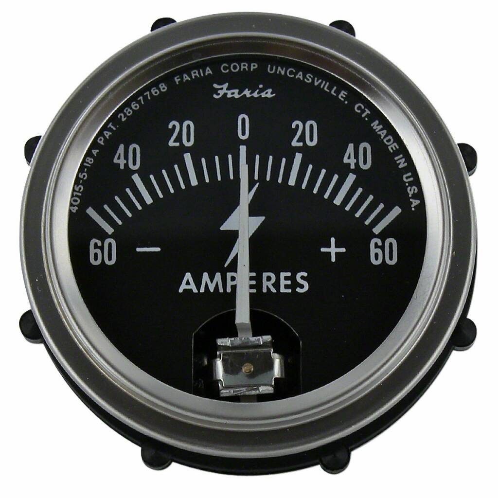

We still do not know HOW you wired the amp meter in. Please inform us!
If you have put it in the charging circuit, it will never show a draw.
The Amp meter might be only showing large draws or gains, depending on its Amp range.
It is the same principle as if you hooked up a multi tester on Amp setting. (Most multi testers can not handle the tractor Amps and can/will be destroid )
My apologies.
I rewired the entire tractor (brand new harness).... IF I recall the instructions correctly, there was a wire that came back from the alternator and another wire that came up from the starter/solenoid. As I recall, it bridged these two items. What I was wondering at the time was do the wires go "A/B" or "B/A" and did I have them backwards. I put them in as per the instructions.... I just had an uncertain feeling in the back of my head.
Well... I thought I still had the harness installation instructions. If I do, I can't find them yet.
I don't know WHICH wire that may have come from (presumption from the alternator) but I'm 99% sure the other end went to the battery.

Now, I don't know where the wire originated. The instructions said (essentially) "Wire W-174 goes to Ammeter (-) and wire Q-645 goes to Ammeter (+)"
So I can't really swear what went where. I CAN however, say that being a pretty detailed type person, I did what the instructions told me to do so I'm confident that wires 174 and 645 were placed where they were supposed to be placed. I'm pretty sure the "drivers side" (left side of tractor as sitting on it) terminal worked its way down to the starting solenoid. I'm not really positive on what wire went on the "passenger side" of the ammeter. I always presumed it was one of the alternator wires (and as the charge went through the ammeter.....it came out other side to go down to the solenoid which had a direct wire back to the battery)
I just presumed that after starting, the batteries would be down a bit so the meter would show negative as the batteries recovered their discharge from starting the tractor.
I'm beginning to conclude that I was simply in error on what it was telling me as again, it's never been in the negative (don't really think I've noticed with lights on and engine OFF)

This backs up the statement you said in your first posting. You are measuring the output of the alternator. Thus, it is wired wrong. Read the posting that Fuddy1952 made earlier.
agree....if it is hooked up like you think, then the lights would turn on with the wire disconnected from the ammeter. I think the OP should keep the ammeter and get it wired correctly.:2cents:

It sounds like you have the alternator and the battery on the correct sides of the ammeter.
Where are the lights and other such loads connected into? Those should be on the alternator side of the ammeter and it sounds almost like they're currently on the battery side of the ammeter.
if you turn on the key and turn on the lights with the engine off, does the ammeter move it all? If my suspicion is correct, it will not move because it is connected on the battery side of the ammeter so it bypasses it.
If you were to switch the wire that provides power to the lights and other loads from the battery side of the ammeter to the alternator side of the ammeter (you could even put it on the output post on the back of the alternator if that is the most convenient place to put it), you should see the ammeter start moving when you turn the lights on with the engine off and stop moving when you turn the lights on with the engine on.
Not making fun of what you said....but in a sense, I find it funny. I don't know what the lights/loads are connected to. The diagram said (making this up)
Plug wire:
41W into the back of alternator
948Z into headlights
WQ 14 into (ammeter)
63-B into (starter solenoid)
I'm fairly sure I can turn the lights on even with key turned off. I did this in warm weather where it gets dark late and I was curious how the six LED lights (2 in front and 2 on each fender) would light things up so I remember once while walking the dogs (in the dark) walking over and turning the headlights and then all lights on. I do NOT think I had to turn the key.
Since this thing is so tall and I was on the drivers side, I didn't look and couldn't have seen it anyway had I looked (without climbing) what the ammeter did.
I think my wife is leaving today to visit a couple estate sales.
If she does, I think I'm going to drag my batteries out there and get a conclusive answer to what happens (to the ammeter) with the key off.
Everything seems to work fine so I'm not bothered about that..... my main point of curiosity was that I'd never seen the meter in the negative and I expected to. However, if my presumptions on how it operated were faulty, then all could be fine and I've lost a couple stupid points with an education!!!
