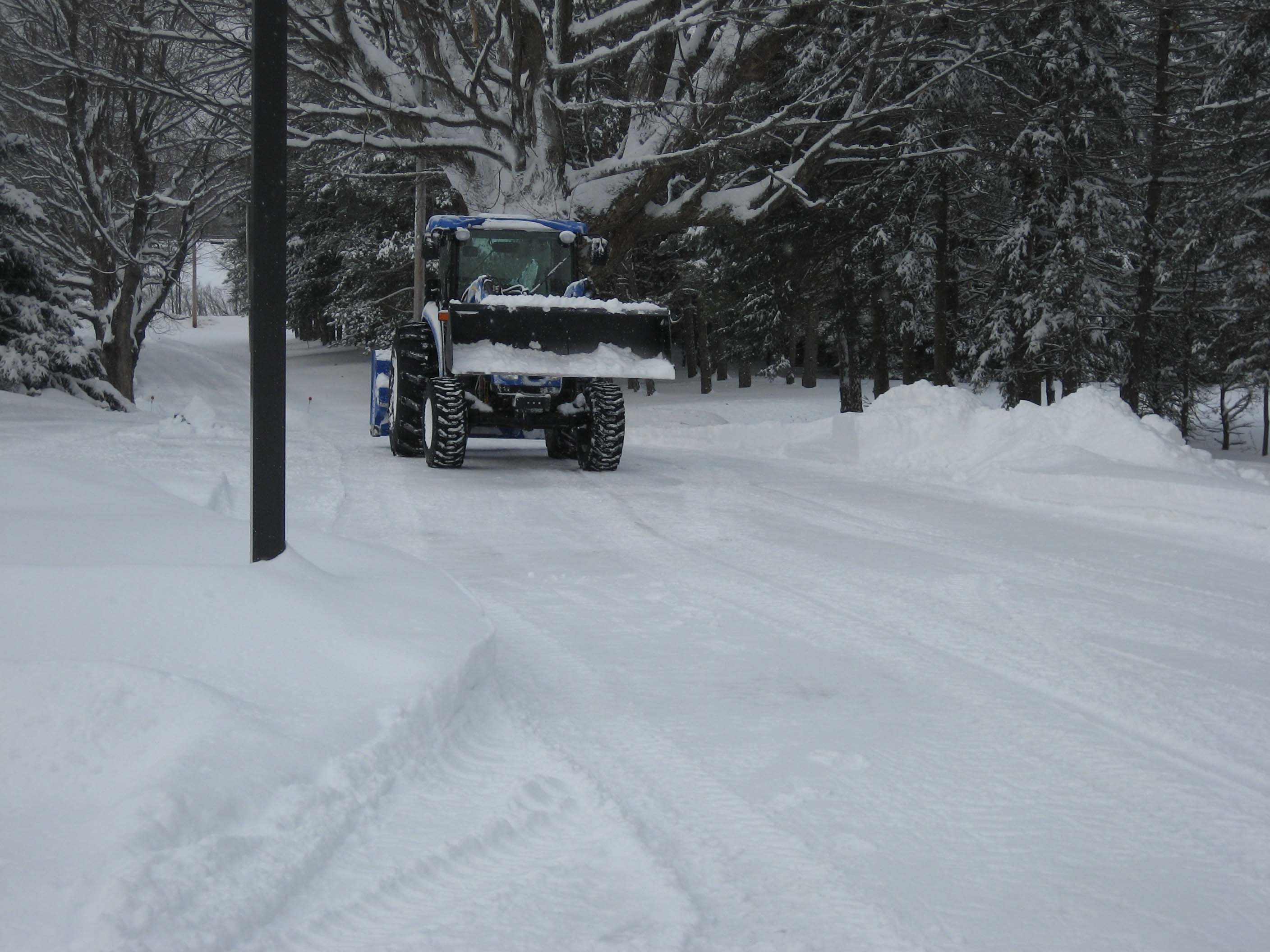

The only thing I can offer, a larger tractor 4060 , calcium chloride loaded tires, but here's my experience with R4 1400 foot driveway in the picture you can see that slight hill. Well after two years of not having a problem, she went right off to the right side of the picture into the ditch last year, How it didn't overturn I'll never know Scared the **** out of me change my shorts and called my brother with his bulldozer to come pull me back on the road, no damage done to the tractor thank God, Just my pride as my brother was laughing at me ;-). Went right out and bought chains. The next two snowstorms made the world of difference didn't even need four-wheel drive anymore. the only downside when I take care of my neighbors roads the chains rattle you a little bit on the highway I can live with that rather than being upside down in the ditch. my vote is chains you can always take them off if you think you don't need them, But you'll be cursing yourself if you're stuck or slide off your driveway Take care

Is that a snowblower on your 3PH, RADIUM?
