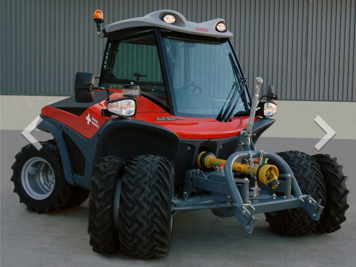

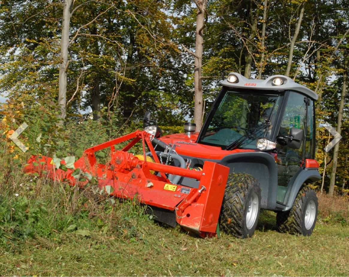

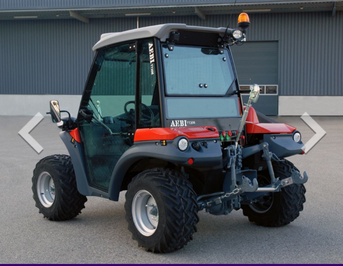

I don't know the cost, but have always liked this design: Aebi Terratrac | ASH Aebi Schmidt Holding AG

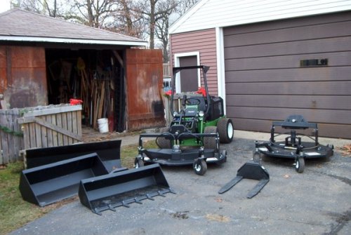

Take a drive over to Tazewell and get a tour of the Power Trac line of machines...
486821d1478218832-alternative-quot-sub-compact-quot-pt425mainpic-jpg

As far as expense... when I was tractor shopping back in 2001, the Power Trac was WAY less expensive for a comparable conventional type of tractor.

I do like the Power Trac series... but my biggest issues are weight and price.
