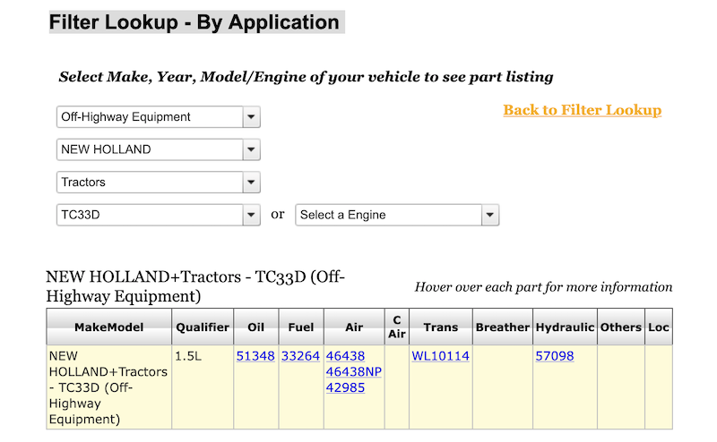

Question No. 1; Is the premium Tractor Supply hydraulic oil OK to use in the TC33D ?
Question No. 2; Is there a alternate filter I can purchase ?
Question No. 3; Where exactly is the filter located on the tractor ?

from the WIX Filter Finder

Thanks for the WIX data and the heads-up on the WIX Filter Finder. I searched a bit and I managed to find the WIX Filter Finder page. Each drop-down selection is a bit long in the tooth but I managed to find the same data that you supplied, it's very helpful.

I believe I have located both of the filters. The large one is behind the right rear wheel and the smaller one is on the left side of the engine in front of the firewall. I need to verify each of them to be sure.
