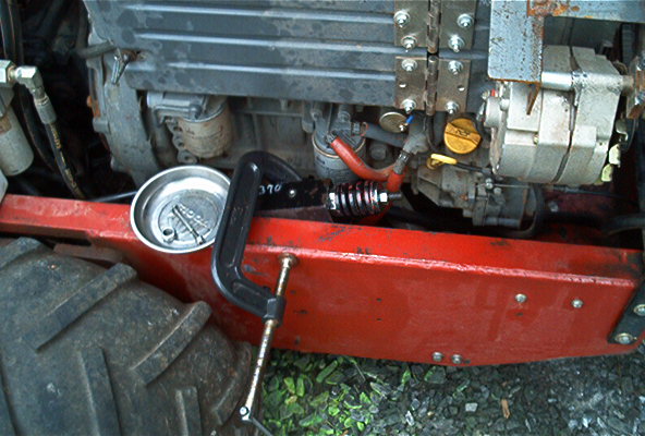

The problem is, I can't figure out why Im having so many unrelated failures. Blown hydraulic hoses, overheating, elictrical. Right now its leaking oil again. We just fixed a hose, I had just replaced the fitting on the accumulator asmbly, just before that. Today , had to send it and my crew leader home with it, it was pouring hyd fluid out of the valve with the spring in it, again;... all over a customers driveway.
He replaced th eo-ring again, I just went out to load it up for tomorrow, and its pouring fluid out again from the same box. I dont have time now to pull it back down, so I have to change the schedule for tomorrow to free up an hour first thing for me to pull it back down, and try another seal. Meanwhile, my end of month work isn't getting done, or customer follow ups on proposals I have in, or new proposal work I have to do. Not to mention the bush hog work I have lined up for the PT this week; which is supposed to be done before Friday.
Its a big problem, and I don't know what to do.

I know that you have probably done all of this , but have you checked the surfaces that mate up on the o ring to make sure that there isn't a bur or something that might be causing that part to fail. The valve that you are talking about by any chance wouldn't be a pressure relief valve just a thought since you said that hoses were bursting. Maybe your pressure relief valve is adjusted too high and not letting it open up when it needs too in order to keep from an over pressure situation. Maybe you have a malfunctioning relief valve. If the 1850 is an open center circuit you haven't by any chance for some reason put a closed center valve in or your operator maybe turning the power take off on without anything being attached to it creating a deadhead in the circuit. Another thing you don't by any chance have a kinked return hose that is causing the pressure to stay too high. I hope that maybe all of these maybes maybe a solution to your problem or help you get on track to finding out what the problem is. Another thought you said that you had electrical problems as well , you don't maybe have a silinoid that is bad that operates the flow of a circuit, say like on the brake or the pto. Maybe the valve that the silinoid operates is not opening up, and like jj usually suggests have you put pressure gauges on your system to check the pressures on your pt.I hope you can get it fixed soon so you can be a happy camper with your pt also. If your relief valves is opening and closing a whole lot or something restricting the oil flow other than the restrictions necessary for you to do your work that can cause overheating, but I'm sure there are other things that could cause the overheating and the overheating could cause premature break down of your hoses. Are you sure you are replacing the o ring with the right size o ring?
/ Altavista and the 1850 #6
Toy,
You have some good points there. We don't know if he is getting the correct o-rings from PT. If in fact he does have good pressure, it may be the reason that the weaker parts of the system are leaking. If you deadhead anything hydraulic, you will approach max pressure real fast ,but that will only be in that circuit. Do you know what circuit the brake tender is associated with?

He may be refering to the machined aluminum "shuttle valve" that is unique to and probably made by PT. If so, not related to Brake Tender. Others (Charlie Illif? Sedgewick? others?) have had problems with this item.... search postings past year or so. It is a tricky (to be polite) item!
If I were using for business, this is one case where I would get a complete new unit from PT and keep a spare on the shelf.

I talked to terry today. I'm sending the pressure relief valve back to PT for them to overhaul; maybe update with one with dual o-rings. We might get something like a toro dingo (but Ditch Witch model) for most of the landscaping work, and only use the pt for hillside bush hogging, until we phase that out of our operations (probably within the next two years). This way th Pt won't be used much, and when it is, it will be run by me, or my dad. My Dad is getting most of our current bush hogging done now with the JD it has a 6' hog and does good, but just not so good on steep hills.

heres the part that I have the most trouble from..leaking. Theres a "piston" inside behind that big spring . it has a white plastic O-Ring, which usually goes bad every 50 to 100 hours. We can usually replace it and be good to go; but not this time. Black rubber o-rings don't even last a few hours.
In th epic u can see the bolt breather on top of the assmbly, this is where fluid seeps out when the o-ring leaks.
