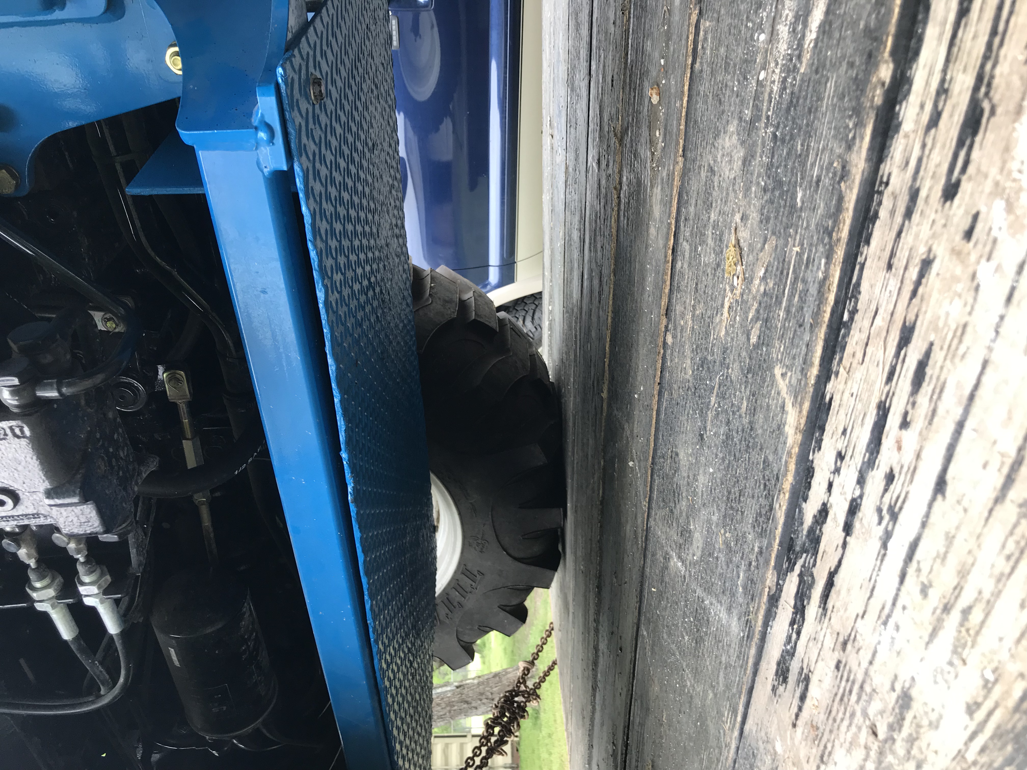

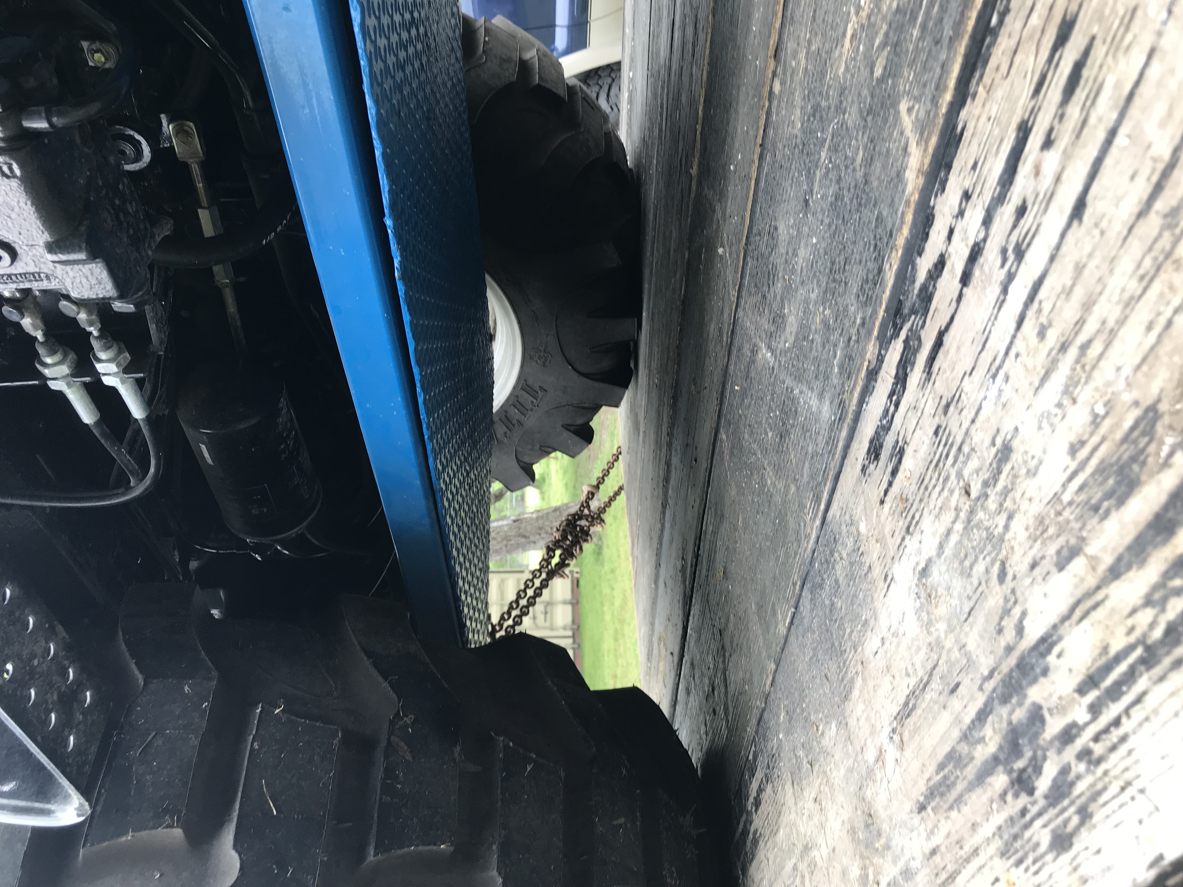

I am also considering making a skid plate for the bottom of the tractor. There is much more than just a fuel line under there. Steel hydraulic lines, fuel lines, fuel tank, rubber hydraulic lines, etc. Thoughts? Has anyone made one before? I was thinking something like 1/4in steel plate bolted to the loader frame with a small drain hole for moisture. A front lip that could act like a ski or something, for going up and over instead of though.
Where I live in the forest with stumps, stick, rocks, mud, etc and with what I do, logging, making roads, removing stumps, digging rocks, etc I think it would be a wise idea to put a skid plate on any tractor.
