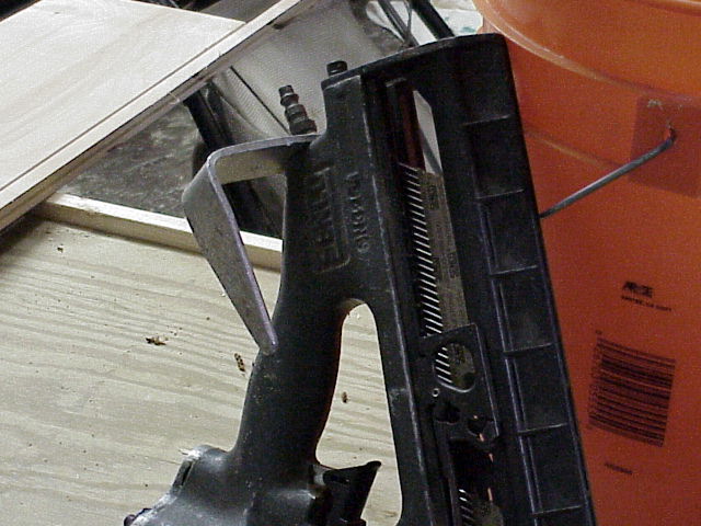

Round head it just that, the nail has a normal round head. The other is called a clipped head nail. The nail head is sort of D shaped, they can get more nails on a strip. Some areas the code doesn't allow for a clipped head. I used to work for Senco and there were many tests done and the debate still goes on as to which one is better. Senco would coat their nails with glue to set them in the wood, so the clipped head would uaually pull through the wood. Duofast had a round head and no glue but when tested the nail would pull from the wood. Seems to me like a failure is going to happen either way. The Framers likes the clipped heads because they did not have to reload as much. I love to tell how Senco came out with a 15 or 16ga 3.5" framing staple. Glued staples have proven to hold better than nails (remember staple legs were designed to separate or bend in the wood), and even with the cheaper price of the staples it didn't sell.
If you are just going to use it for a shed, the HF stuff ain't that bad and is a lot cheaper.
As far as the belt hooks, At Senco we had a company make up bent piece of aluminum and it was held on at the air coupler. It would be easy to make one up. Years back I found a guy on Ebay selling these and I bought all 5 for $20 or so.
Good Luck,
Rob
