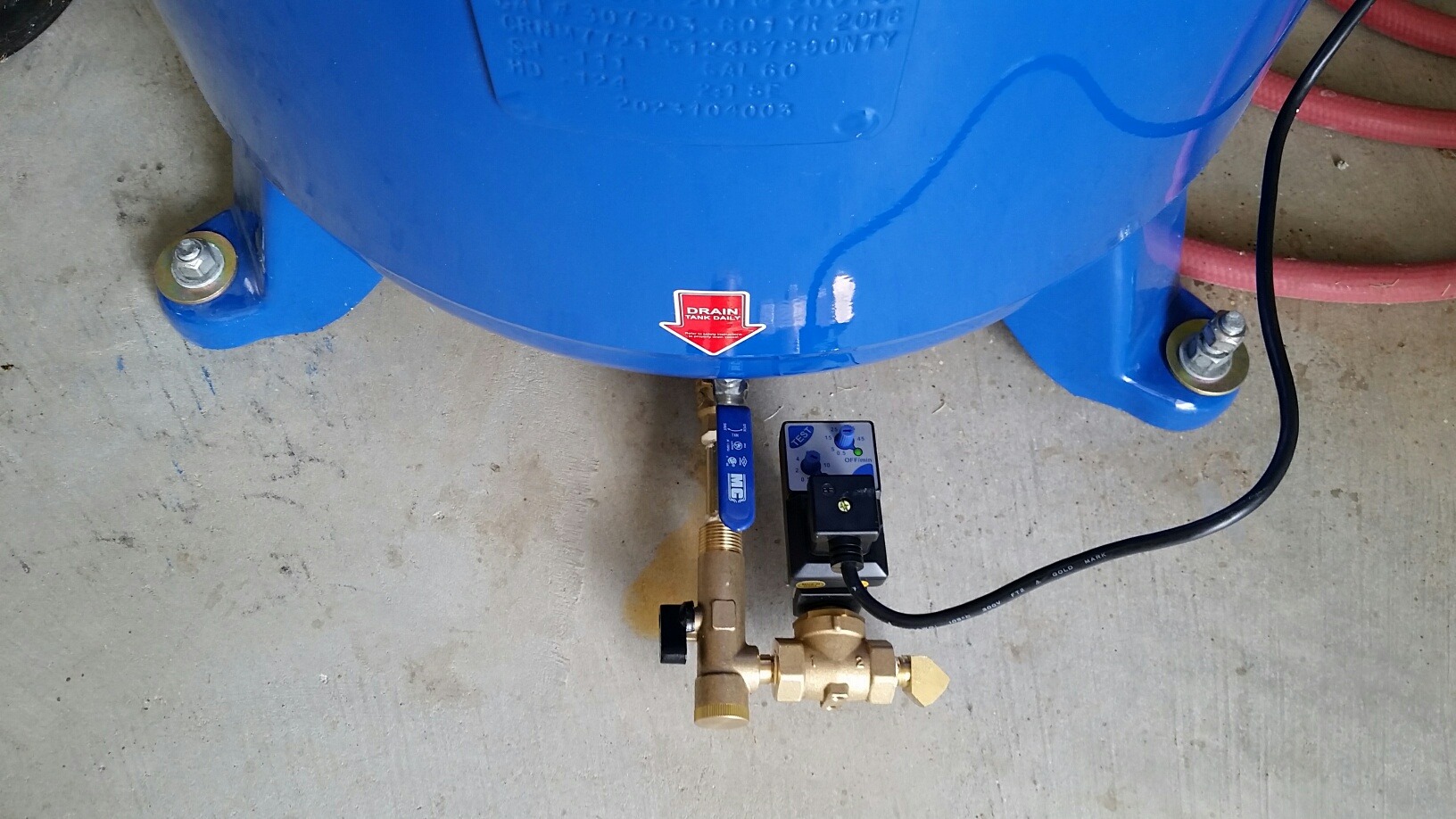

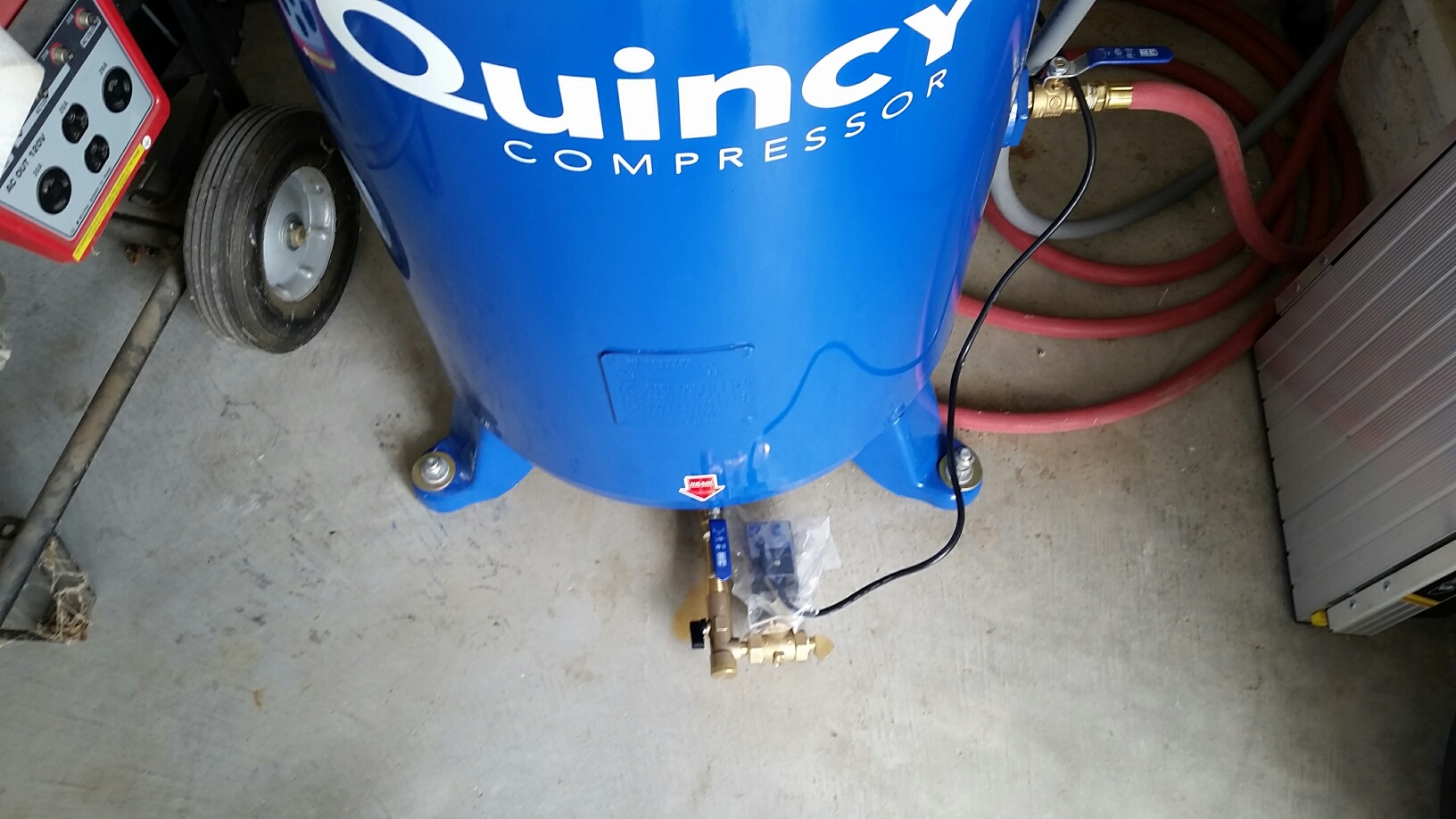

Here is another update.
I called Quincy for a recommendation for an electric condensate valve. I ordered it, and got it put on this week. I set the timers for a 4 second spritz every 45 minutes. The tank is 4' away from the overhead door so to try to keep the timer clean, I put a plastic bag around it and loosely taped it so the wind wouldn't blow it off.
Does anyone else have a condensate valve and what is yours set at? A factory authorized technician told me to set it for 10 seconds every 15 minutes but that drains the little 60 gallon tank down enough for the pump to run every other cycle.
/ Air Compressor power supply #47
I suggest drilling a hole in the floor, and with a piece of clear vinyl plastic tubing, route the drain end of the valve into that hole, so it drains under the slab.
You avoid having water, and rust stains on the floor.
Plus, it's quieter.
