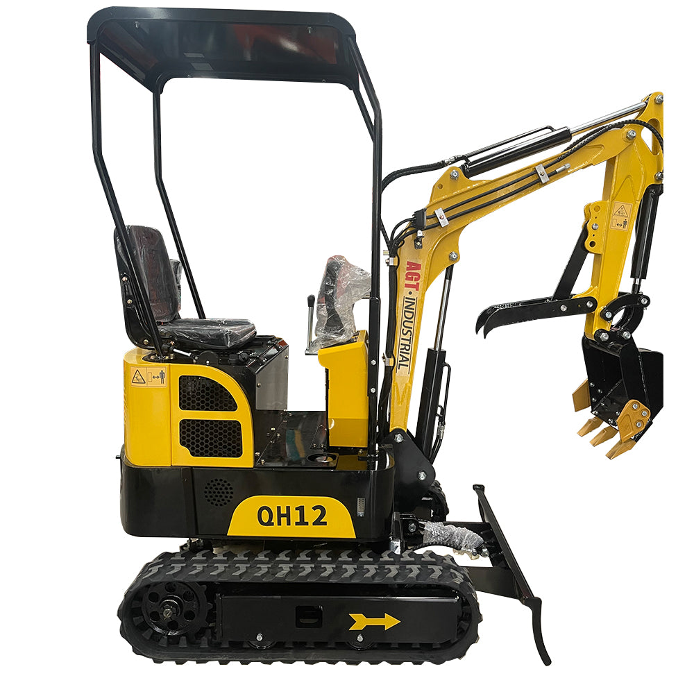

Well, AgroTK now has their QH12 1-ton mini-X on sale for $6199 + tax, including US shipping. Shipped from Chicago.
That is an amazing price, but does not include many attachments or spares. Those willing to brave a direct import can score attachments and spares for much much less. With all costs in mind, you will probably not do much better than $6200 per unit, however.
The AgroTK website has a minimal parts diagram, and there still seems to be no hyd oil filter or cooler, and no wheel brakes.
The QH12 Agro TK I purchased at the same sale as my SDLooL 380 Mini Skid, Does have a Hydraulic Filter, but no Cooler or Wheel Brakes. It is an Exact Copy of my FF Industrial FF12 I purchased last spring.
I am still trying to figure out the Origin Company, but I believe Yancheng Cross i the closest I have seen. Oil Tank under the Floor is the hardest one to spot

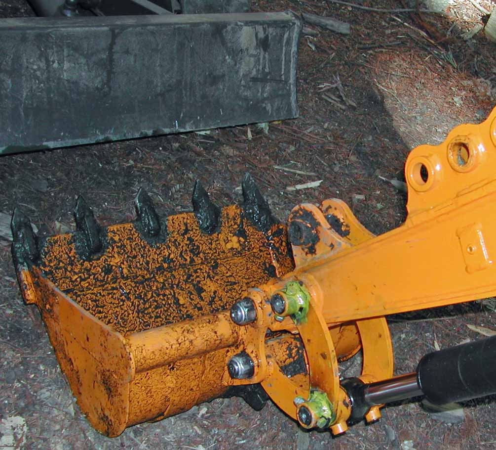

Another thing I ran into was the grease fittings! NONE of the ones they put in at the factory will take grease! gotta replace every one of them with known good ones! Of course they METRIC chit too so gotta go buy more stuff!
Bucket side plates gotta come off,--- all the big bolts stickin out interferes with dumping the bucket and the tooth bolts are kinda in the way so looking to drive carriage bolts in them with nuts on the bottom side OR just weld them on since I will never wear them out in the rest of my lifetime.
Track tighteners need to be converted to bolt and spring instead of using grease gun! Thats a real crock!

Instead of removing the side cutters consider doing what I did which is to weld them on and then remove the bolts. I also ground a bevel on the face to help with root busting.
