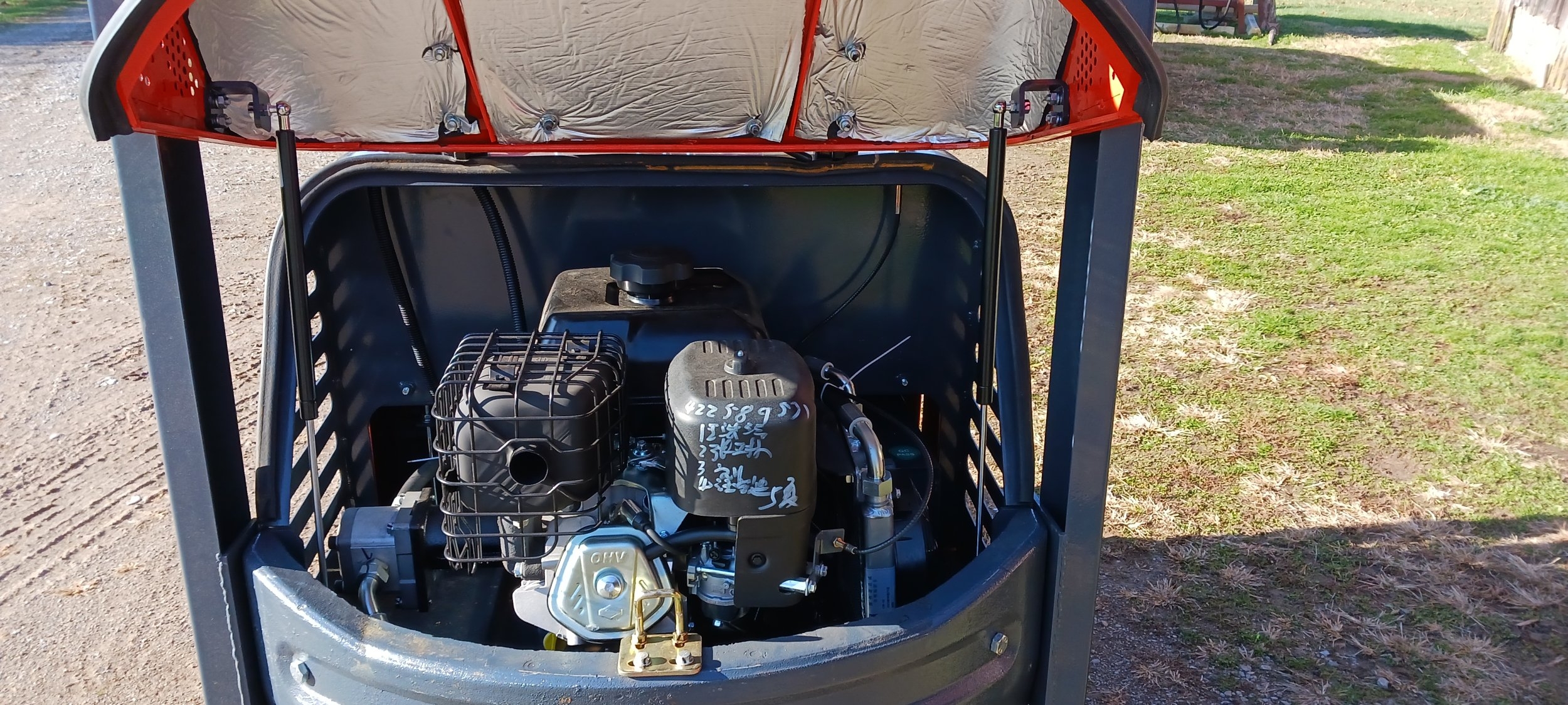

My Agrotk is now finished. Oil filter, oil cooler, forced air to cool the dog house, hose swap to backhoe controls, hose wrap and ,last thing was enlarge track adjustment access.
Impression after all the cutting, drilling , making grates, etc.
If it had cost between $750 to $1000 dollars more I would pass. Too many little things to take care of before use not to mention fit and finish leaves something to be desired.
Happy I have it but buyer beware, you will need to put some sweat into it.
   / Agrotk excavators: Does anyone have one? Opinions/comments/critiques? #35
I do not know which factory makes the AgroTK minis, but there is a large range of quality and features with the Chinese 1-ton minis.
I have not seen any AgroTKs personally, so your pix are the first I have seen inside. Not the best of the choices out there. Thx for posting.

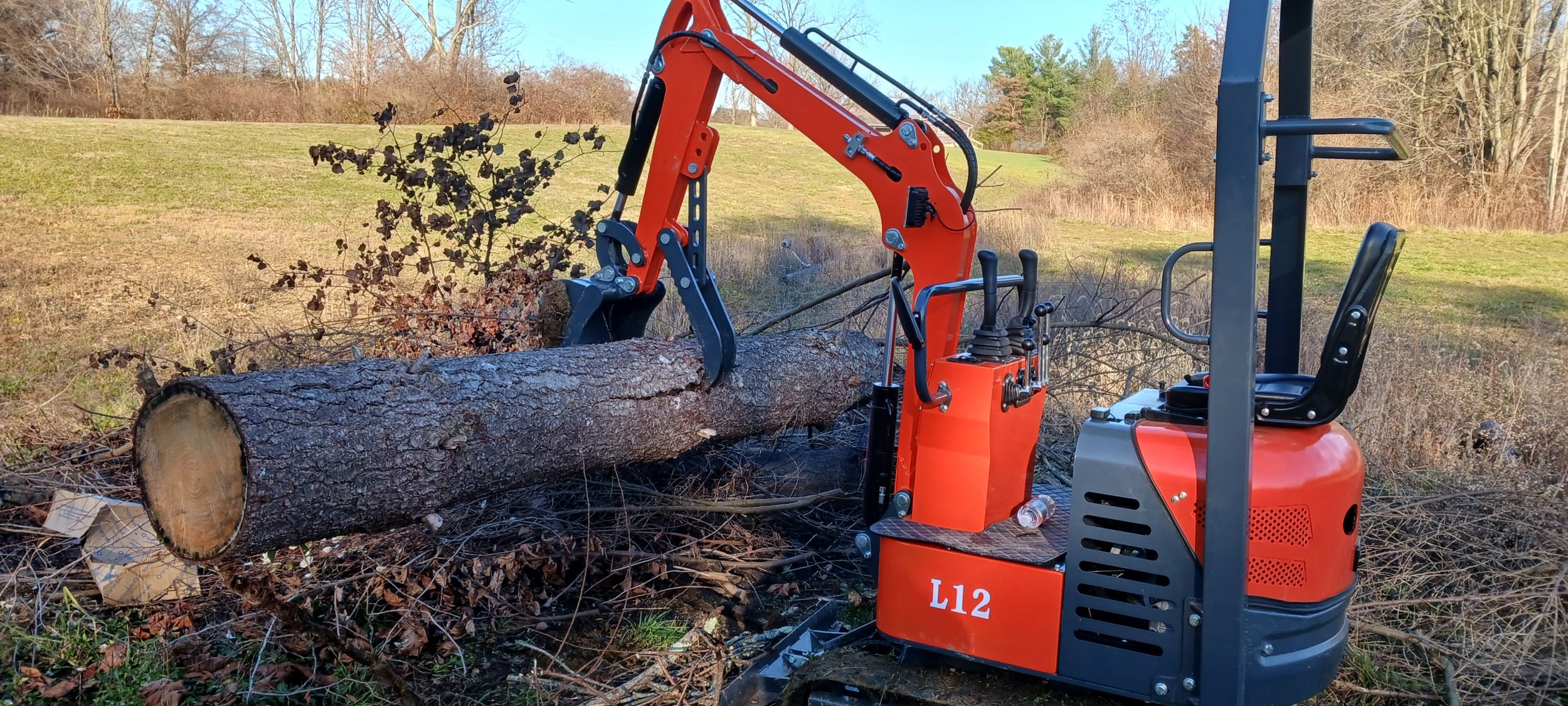

hi looking for a mini excavator for simple tasks like lifting logs and brush clearing? The 2023 Agrotk H12 seems suitable, with a power thumb for easier log handling. While it's gas-powered, diesel engines are often preferred for heavy equipment due to efficiency and durability. The 12,000 lbs lifting capacity is decent. Consider comparing prices with similar models coz there are way better excavators available in the market or you may consider for a rental
   / Agrotk excavators: Does anyone have one? Opinions/comments/critiques? #37
I do a lot of log stacking with my Rhino 1T. The lifting capacity is enormous, considering the light overall weight. They use an under-boom cylinder, which trades off digging depth for lifting capacity.
By the way, I tried the mechanical log grapple attachment, which is lousy. I use an hydraulic thumb. Sure would be nice to have a swiveling grapple...
